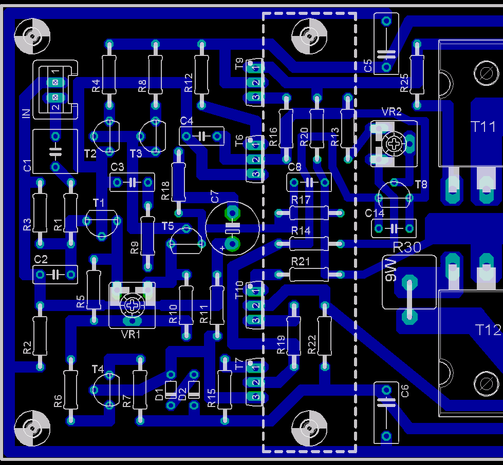

Hari,
RegardingPost #2249 and nmos 160a.pdf I have discovered these initial issues that may uncover more issues:
1) Your nmos 160a.pdf R17 and R18 appears to be R18 and R19 respectively on the NMOS200 schematic.
2) Your nmos 160a.pdf R19 appears to be R17 on the NMOS200 schematic.
3) Your nmos 160a.pdf R17 (appears to be R18 respectively on the NMOS200 schematic) has a link that ends near R31 looks orfaned with the move of L1 to to the C13 side of PCB. That link I believe should be at the L1/R35 PCB node.
4) Your nmos 160a.pdf R11 still shows 27K0 on the PCB silkscreen, and should be 22K per quasi's Post #2230 and Post #2239.
Excellent moving of C7B to avoid T7 thermal coupling to C7B, and the centering T8.
Big thanks for putting up with my observations/comments.

You sure have gone through the layout in great detail. Thanks a ton for doing so. But you seem to have forgotten, I'm using the nmos350 schematic and not the nmos200. In fact, the two are same except for the component values.
I've moved the wire link also to the right side, its for the NFB.
Thanks again for cleaning up my design.
Cheers
Hari
Hi Hari,
Yes you are correct I was referencing the NMOS200 scehmatic. I thought, though it had been a while, the part numbers of the NMOS350 and NMOS200 were the same at least to the driver stage. Clearly my "aging" memory was incorrect.

Hi Hari,
I only have a few minutes right now to look over "today's version of my pcb layout".
You may want to move the rectangle for the L1/Output node a bit more away from C13. The main reason for the suggestion is to reduce ark potiential and also allow a bit more room to make the connection to the output terminal. I am only suggesting moving the large pad. The size and dimension is just fine.
The "OUT" text was left over VPOS track that should of been moved when the L1/Output pad were moved to the C13 side of the PCB.
I really have not spent any time checking the parts/nodes to see if all is in order. It may of seemed like I had with my last comments, but it was driven by the stray under PCB link that you have corrected that caused me to make the part numbering comments I had as I tried to figure out if the stray link was still required.

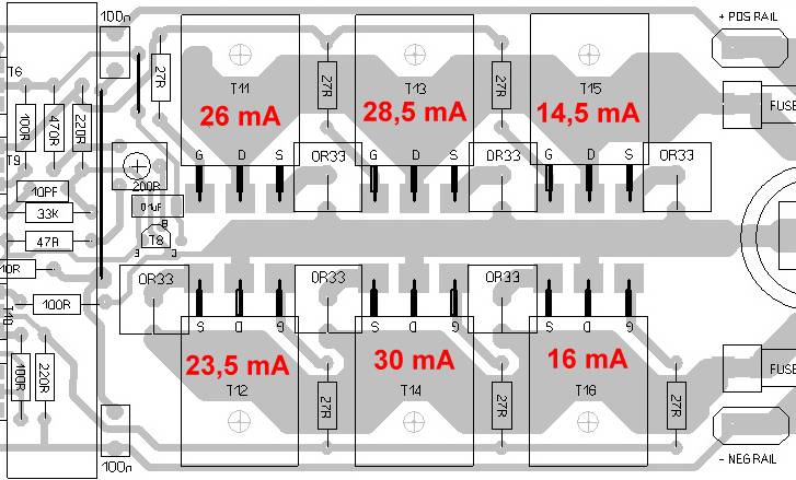

I finished the second channel ...
Someone please tell me if i'm right with the secifications ?
did you measure and match the source resistors?
If they are +-10% tolerance then that could account for upto 20% of your variation.
The remainder of this enormous variation is due to using unmatched FETs.
In a stereo pair one would have 12FETs. These can be arranged in four groups of three. Each group of three are inserted in either the upper half or the lower half of the PCBs.
