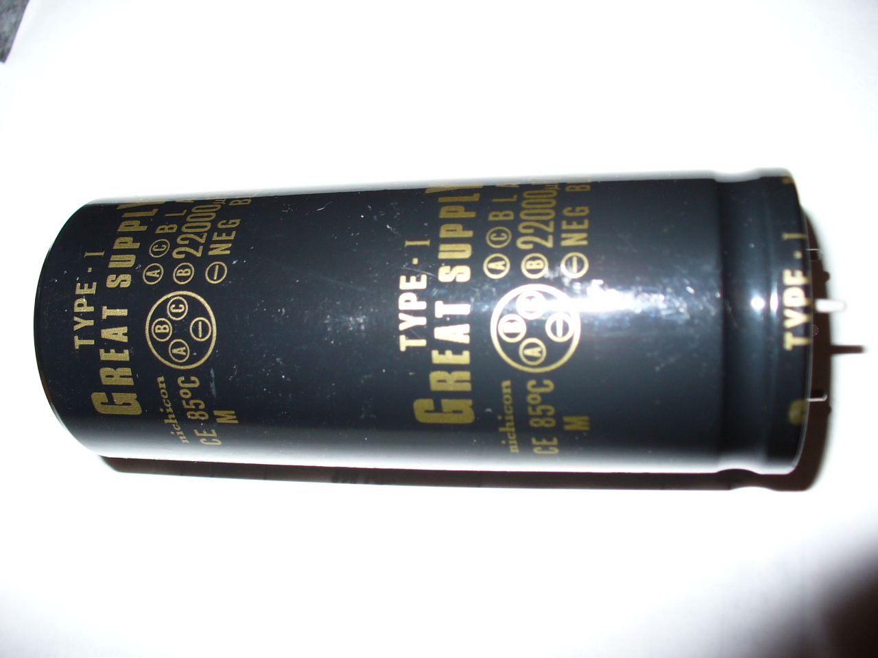

I have the supply cap here elna for audio 8 10000uF, 4 12000uF and 4 nichicon 22000uF 71V type-1 great supply, I don't found the datasheet of these cap. If I remember correctly I found these caps in a receiver Yamaha RX-V1 and I'm not sure if they are good cap see picture.

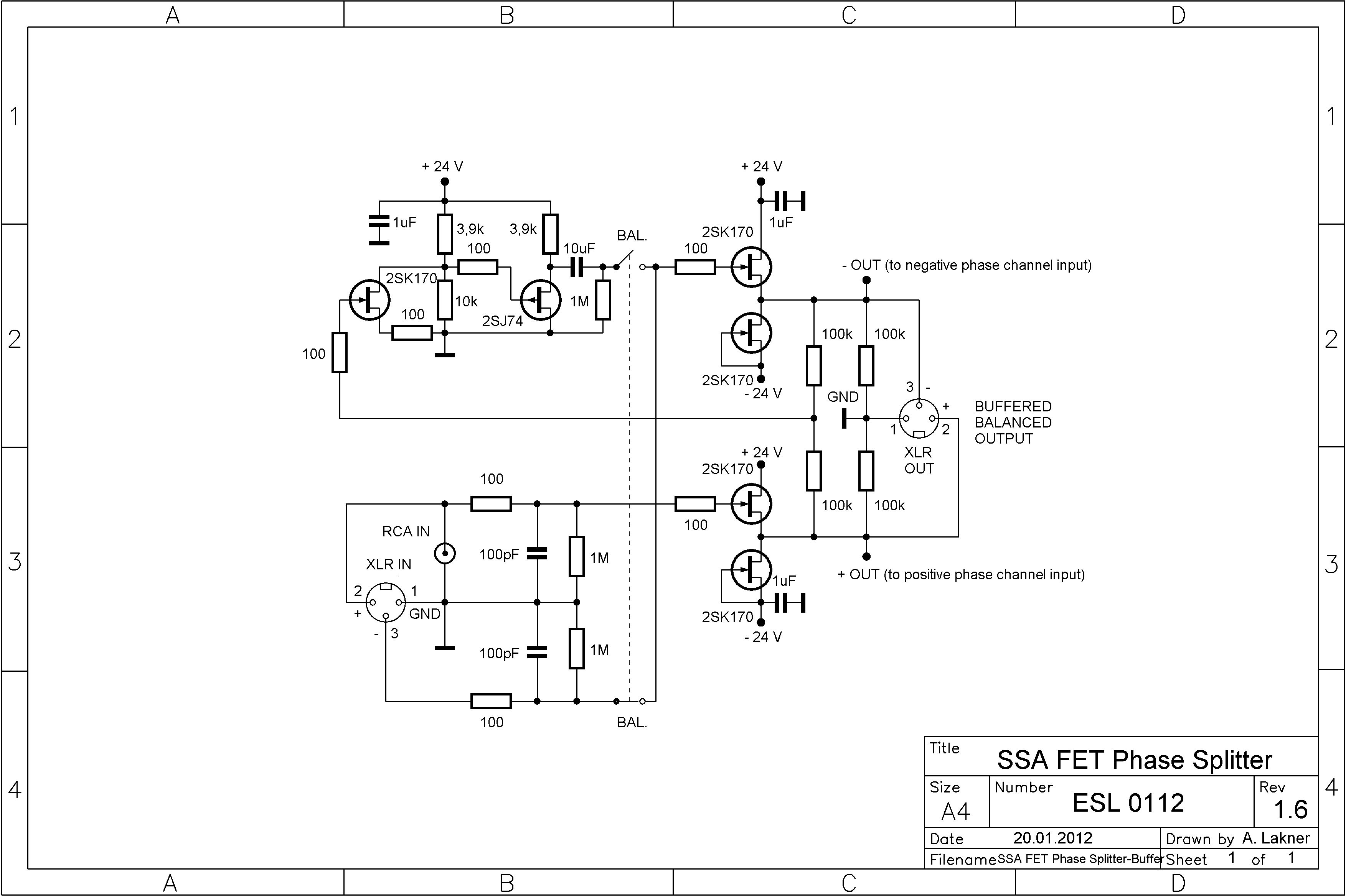

Hi Lazy,
can you explain the two switches (one NO & one NC) that are labeled BAL?
Hi AndrewT
As drawn in the schematic the switch is in "Balanced" position, meaning XLR input cable (balanced) is allowed to be connected to the input of a bridged amplifier. When switch is in inverse position from drawn (upper closed, lower opened), than RCA input cable (unbalanced) could be connected.
What does the upper left circuit do? Is it an unbal to bal voltage converter?
Two mosfets on the left are forming simple unity gain voltage inverter. Four mosfets on the right are double unity gain non-inverter buffers, serving as impedance matching buffers of each phase of the drive signal to the bridged amplifier inputs.
Can you clarify where all the various GNDs connect to?
Yes, all GND points in this schematic forms star ground structure connected to the star ground of a bridged amplifier.
Regards, Andrej

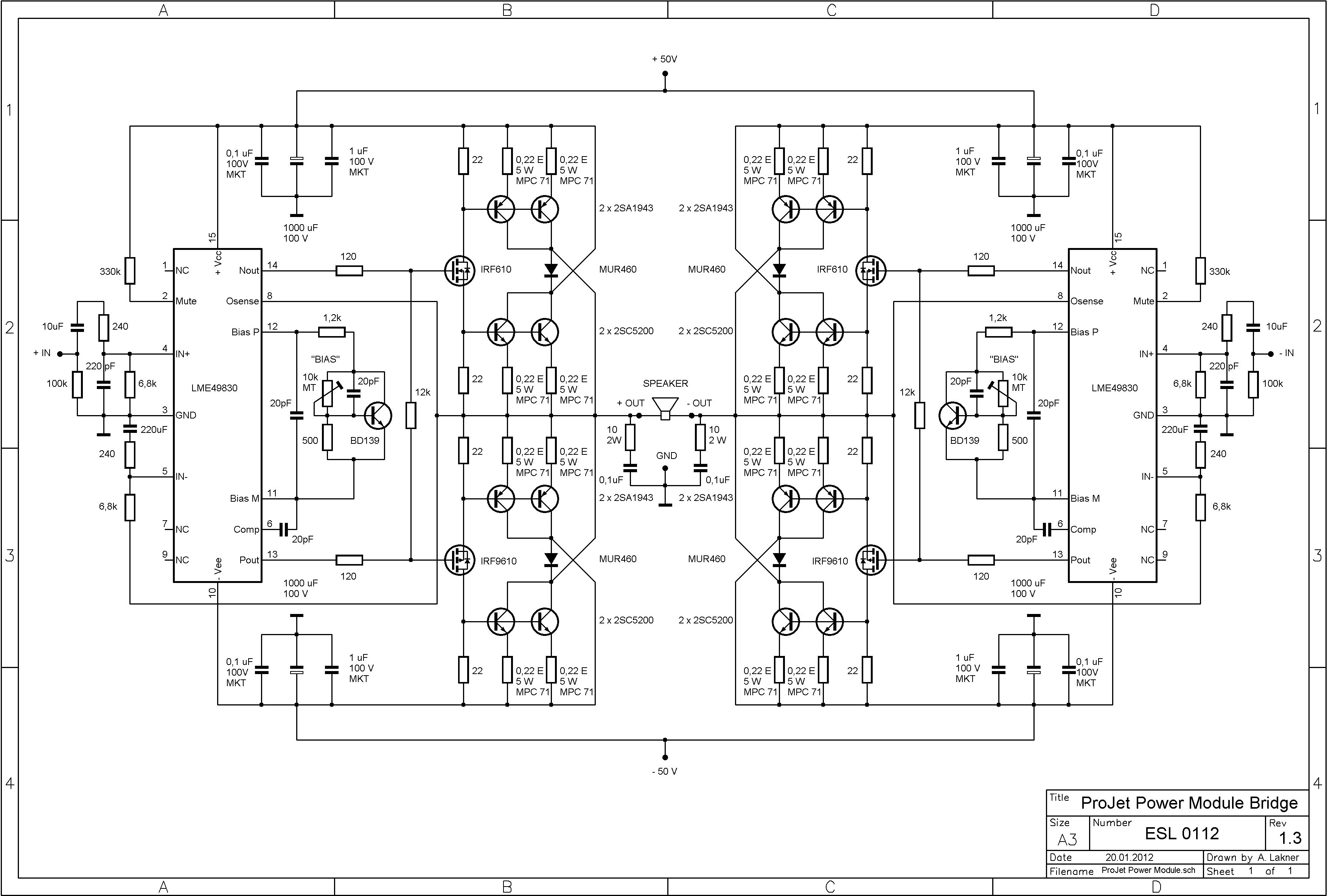

... and here's my schematic for one bridged-channel. It consist of two identical channels with LME49830 voltage driver plus 8 standard BJT outputs in BIGBT configuration. It is cheap and dirty.
Aha maxpou, the power of this bridged amplifier is realistic 400Wrms/8ohm or 800Wrms/4ohm, times two channels like this (stereo) is exact match to your super power transformer.
Thanks for post28.
Post29:
Is each half of the bridged amplifier capable of driving a 2ohms speaker? and 400W into 2r0 and ~750W into 1r0? To result in a 800W amp suitable for 4ohm speaker.
But he has run out of devices. Your stereo suggestion uses 32 outputs and he states 8pairs of NPN/PNP outputs.
Post29:
Thanks for post28.
Post29:
800W/4ohm is exactly 5Ap (3,54Aeff) collector current per one output BJT. With this types of 2SA/SC this is possible withot any problem, also in a SOAR point of view. Child's play.
Correctly, for stereo amp he will need 32 of outputs, so he will buy some more pieces since these are really cheap. He will also need four LME's but these are cheap too. I don't see any problem to make this amp real as real could be.

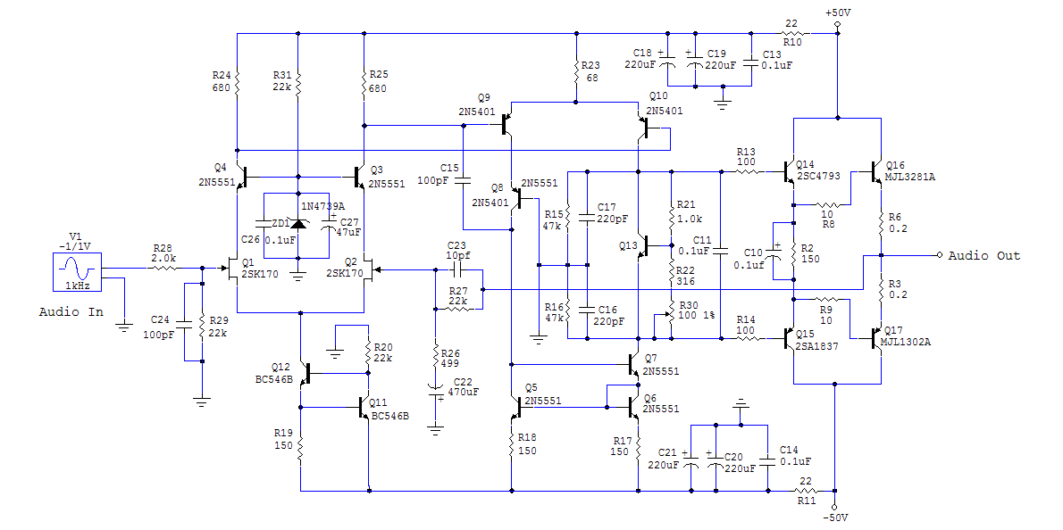

Hi Guys,
after several days of reading on the power amplifiers here I chose the symasym 5.3 with the input cascode JFET, but I would like to know it is a good choice if I put 8 outputs pairs? I will make some mods like replace R31 by CCS, replace some transistor model. Somebody have a comments? Thank you! Maxpou
HI Andrewt,
I read the threads of Ostripper on this power amp topology he put 4 output pairs without big mod. What's the problem you see? Thank's Maxpou
The 5.3 symasym you post uses a low current VAS +EF2 output stage.
2-pair is about tops- here.
The forums "Badger" is also an EF2 , but the VAS is to-126 and can be
run at near 10ma plus be generously heatsinked.
Most of the other EF2's (forums most common output stages), are under
rated with to-220 drivers running 4 or more pairs of outputs.
The "slew" series is an EF3 with outputs !!!... for drivers. Here , you could run
10 pairs if you wanted and have driver SOA left over.
The EF3 also "isolates" the VAS from the current stage - having 100K
current gain.
You would have "droop" and higher distortion just doubling the output
pairs on the original 5.3 symasym.
OS
