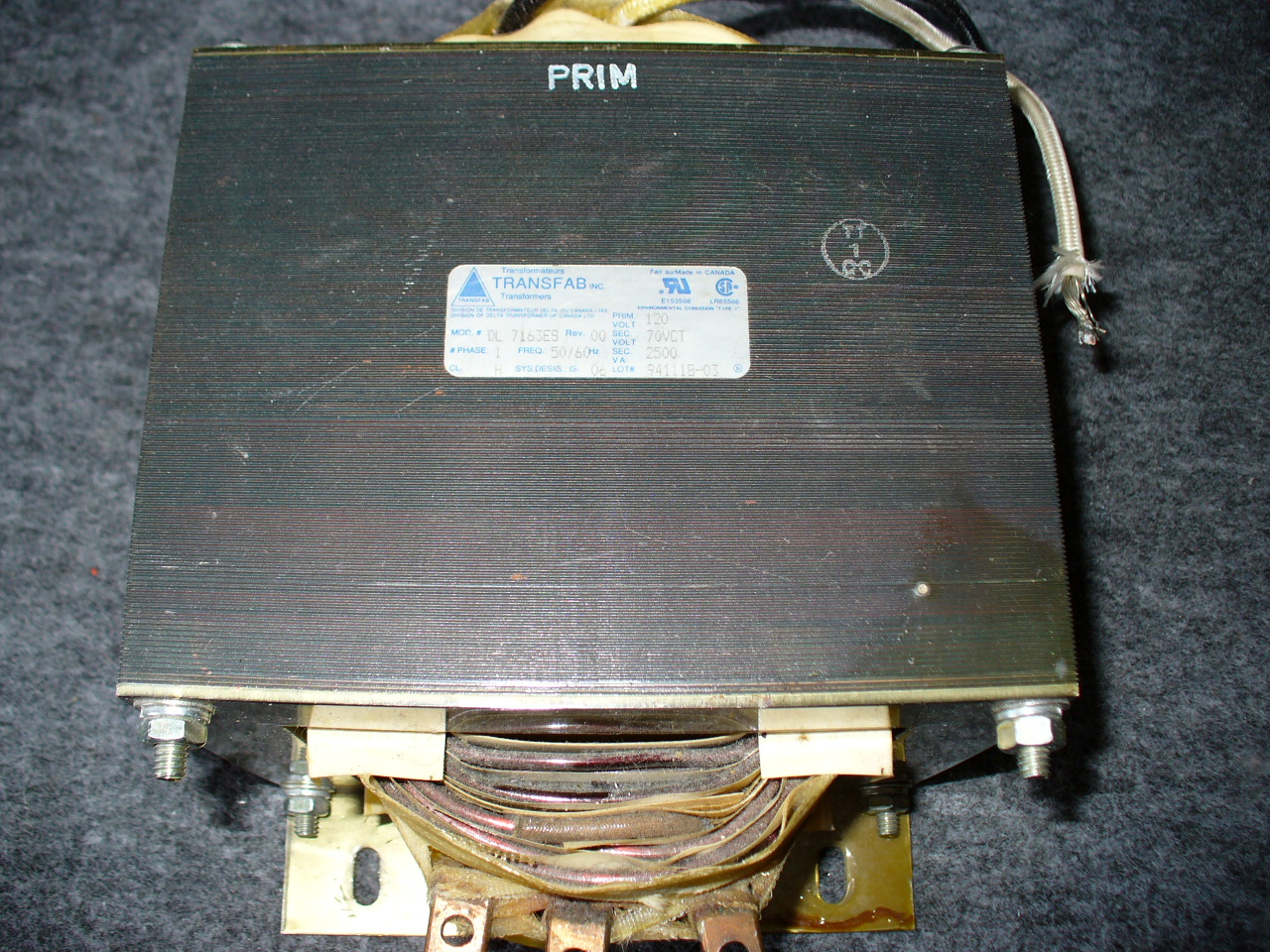

Hi Guys,
I would like to built a new power amp. I have many parts here, 2 xformer 35-0-35 Vac 2500VA, Bjt output 8 mjl1302 and 8 mjl3281 onsemi, driver toshiba 20 2sa1930 and 20 2sc5171, 10 2sa1381 and 10 2sc3503, 20 MJE15030 and 20 MJE15031, many 2n5401 and 2n5551, many BC546B and BC556B, many 2sa970BL and 2sc2240BL and many 2SK170BL and 2SJ74BL.
I want can put a Dunlavy SC-IV on this amp without problem. Somebody can suggest me? Thank you! Maxpou

With such a transformer , the poor devices on the left

Max,
You have the trafo, so why not use it.
It's only going to give you a little over 50V rails which is fine for a 100W//8R amplifier, which needs, for flexibility, three output pairs of the transistors you have chosen, which have a Vceo of 200V.
The only problem with the trafo is the inrush current. It will likely take out your household circuit breaker, as it's about five times the max current. For a 2500VA trafo at 120Vac mains, that's around 105A, so you might want to use a soft start!!

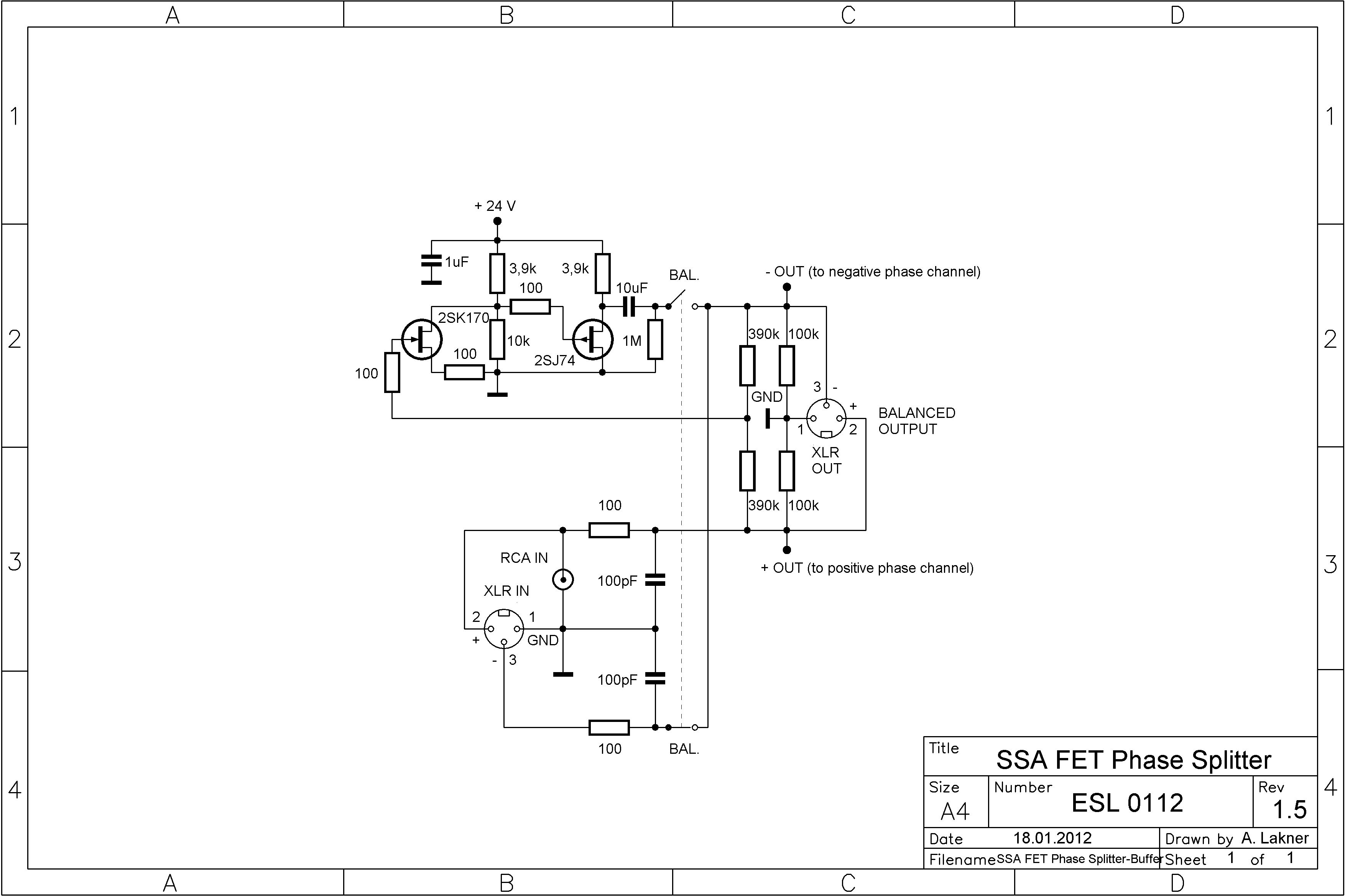

Fully balanced amplifier for 2,5 kVA transformer
Hi maxpou
Look, my suggestion and potential support will be very reasonable for the circumstances (transformer) you have.
Make fully balanced power amp, practically meaning to build four completely identical channels with 4 BJT output pairs per channel, 20mF rail caps per channel and for the input you will use XLR plus RCA connector, so really universal use with un/balanced preamps. Input phase splitter schematic attached.
Aha I almost forget hehe, the power will be 500 Wrms on 8 ohm or in the best case 1 kWrms on 4 ohm.
Regards, Andrej

Given the number of output devices you have (16 IIRC), I think you can build a very capable 150W per channel amplifer (8 devices per channel, following the rule of thumb of 1 pair TO3P for each 40-50W).
Big transformer will be a bit wasted, but the important thing is you have it - so just go for it. The only other expensive items are the smoothing caps and a case so you are already half way there.
Your transformer looks more like it was designed for a welder or something needing a crazy amount of current. It is probably going to buzz like a hive of angry wasps. It'll work, but it's totally impractical for an audio amp. As mentioned, the inrush current is going to be a nightmare
Save yourself a lot of hassle - sell it, and buy a good 2x35V 500VA toroid. You'll get a nice 100W amp out of that with the transistors you have.

thank you for reply. If I put three output pairs per channel do I have 200W at output? What the difference if I put 5 output pairs per channel? For the softstart I knew because I tried to plug only the transformer and the circuit breaker has tripped but my I tried to startup with 150W light bulb and it's OK.

Perhaps I have not your wallet to build four channels and my preamp and cd player don't have a XLR connector.
Maxpou
