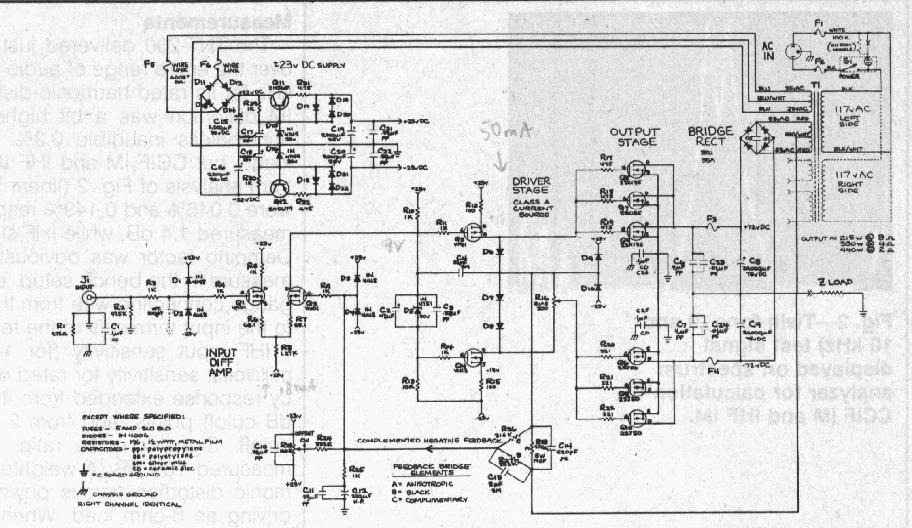

The original Hitachi Design.
Hi all
I found the original Hitachi datasheet which discusses the use of their power MOSFETS in amplifiers, and was the source of several designs including Maplin's. It's good reading for all those interested. If you would like a copy, then e-mail me, and I'll send it.

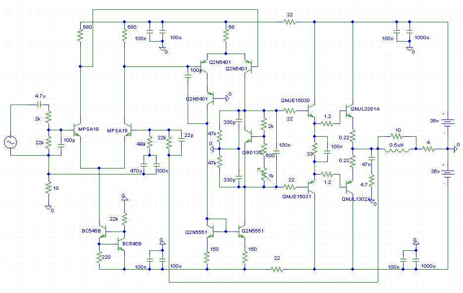

As I said, I've used a few of these modules, two for my stereo. I noticed that the heatsink case was getting warmer than usual, and while investigating it, I noticed very high frequency oscillations on the output. I thought maybe the caps had dried out somewhat, it runs at 40 degrees case temperature normally which is ok, but maybe it shortens cap life. It's a bit cramped in there. After a change of caps, I still had the same problem. I used a different amp and shelved the problem for a rainy day.
Months later;
My sub amps use the same modules, and while modding them to suit a new active crossover, I noticed the same high frequency oscillations but at a lower level. The sub amp has a different layout, not so cluttered. How could this be? Could they have been oscillating unnoticed from the start? I paid particular attention to the sub amps, so I could not have missed it. I scope all my amps, sniffing for problems, but maybe...?
So the amps were fine when built, but developed instability over time, and it's not the caps. So what has changed? Hmmmm
The bottom line;
It turns out that the zobel resistor had burnt out in all four modules. In a sub amp with no HF signals too. I replaced the resistor with a 4R7 3W WW and there is no trace of instability on a 100MHz scope at 5mV/div sensitivity.
I find this very curious, I used the resistor specified in the kit, again 4R7 3W WW, but it burnt out in a sub amp.
So to those who may have built it, look out for this problem.
Any ideas as to the cause?

Two modules were built as the kit, with the PCB as supplied. I thought that the Zobel network was to maintain stability with an inductive load. With no load, surely the amp should be stable without it? Since it isn't, then there must be some reason for the instability.
I will remove the zobel and see if I can stabilise it, first I will increase the gate resistors as you suggest. I have already increased the Miller cap, ( I used 22p polystyrene instead of 27p ceramic, but this is not the problem, since 47p polystyrene doesn't cure it). I will put 100n directly between the rails, I have done this in my own amps, but this was a kit, and there didn't appear to be any problems. There are two 100n, one for each rail, on the PCB but they are a bit far away from the output devices.
I am concerned because, in a sub amp, there should be nothing to cause the overheating, so it must be bursting into oscillations without my knowlege, invisible on a 'scope. Sneaky isn't it?
Thanks for your help, I'm glad I'm not the only one who has experienced this.:)

I disconnected the zobel network to try to stabilise the amp without it, it should be stable without a load.
First I grounded the heatsink to the power ground, still oscillated @ about 5MHz.
Then I used a 1uF cap directly across the power terminals of the MOSFETs drains, but it still oscillated.
BTW the oscillations stopped when the zobel was re-connected temporarily.
Next I increased the gate stopper resistors to 200 ohms-- no oscillatons.:D
I'll do this to them all now, I can re-connect the zobel and hopefully the resistors won't burn out again.

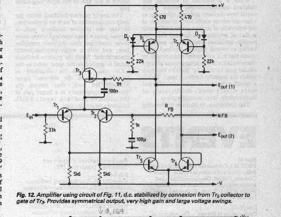

"The input stage cann't have a current mirror load, because of the differential VAS"
I think McLaren ampifiers have a current mirror load and a differential Vas. Maybe this circuit is due to Doug Self.
Much more ancient, John Linsley Hood has shown a circuit with a kind of symetrical mirror at the input which can be followed by a differential Vas (a lot lot of forward gain !), but he never used it. Instead, only once, he used a conventional differential pair which each collector was followed by a Vas with a constant current source load. One of the Vas conventionnaly drove the output stage and the other was connected to the inverting input through resistors : this was positive feedback (a principle having some similarities with a Dynaco preamp ?). It was Linsley-Hood's alternative to Hitachi mosfet amp (it's very simple too), intended to have a more stable standing current in the Vas. This is one of the most intriguing amplifier circuit I ever see and, to my knowledge, nobody, even its author, has tried to use it again. I built it, it worked ok from the start, it was very stable (I dismantled it a couple of years later to build the next JLH project, much more conventional, using the same mosfets). One feature from this amp with positive feedback was its offset wich was very low without any triming, around one millivolt. I carefully match the input devices.

Here is Linsley-Hood's double mirror stage used in the low power stage of a mosfet amplifier.

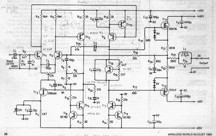

Good for discussion : first Transnova mosfet amp. Positive feedback too, it seems. The accompanying text says that path C creates an infinite "error" gain withtout prõblems of instability. I think a Dynaco tube preamp used such a scheme too.

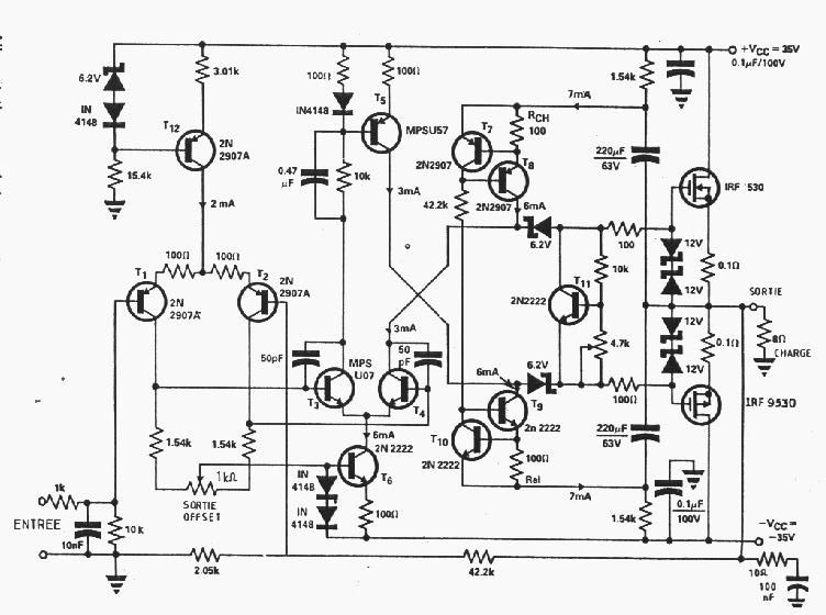

Here's another scheme due to Stocchino wich should do well with Vas current stabilty.
