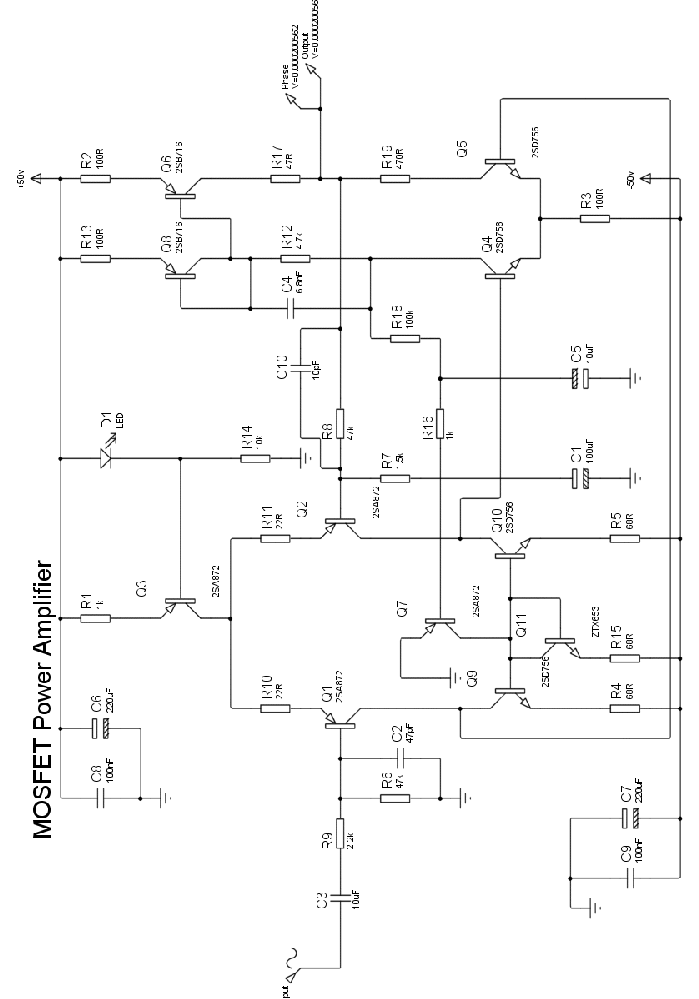

Sorry for resurrecting this old thread, but I have just resurrected a couple of the original Maplin amps that I built in 1984 and never got round to using - I've simply replaced the electrolytics and fired them up. I'm running them both off a single +/-50V PSU with 10,000uF on each rail. Yes, I have noticed a slight buzz if I put my ear right next to the speaker. How much of that is down to lack of PSRR and how much is just pickup from the wiring, inadvertent ground loops etc., I don't know. What I don't like the idea of is the two amps interacting, and larger PSU fluctuations bleeding through. The definitive test, perhaps, is to send a signal only to one channel with a dummy load and listen to the other - I won't be able to do it for the next few days, however. Bah!
In the meantime I've done a quick and dirty SPICE simulation - without the precise models for those exact transistors and MOSFETs, but it appears to work more-or-less as expected. Interestingly I found I had to set the output transistor bias 'pot' very much to the far (high resistance) end, which seems to be the case on the real amps - the designer could have drastically reduced the range of that pot.
I don't see a huge amount of PSU breakthrough, with PSRR at 57 dB (assuming I have calculated this correctly! 14mV p-p at the speaker with 10V p-p PSU modulation, or thereabouts). I can't imagine that that would be sufficient to cause an audible buzz when idling..?
I was quite excited to read of the idea of replacing the differential pair bias resistor with a constant current source, assuming that this might improve the PSRR drastically, but it doesn't (in SPICE anyway). 14mV p-p becomes about 10mVp-p. Someone earlier in this thread suggested that a disadvantage of this might also be an audible 'thump' at switch on..?
What does seem to work (in SPICE) is regulating the rails except for the output stage, using 40V zeners and 330R of resistor on each rail on each amp and reducing the differential pair emitter resistor to 39k (I don't know if anyone else has done this for real? Do these values seem about right? Any other component values need changing?) The circuit board appears very easy to modify, just needing to slice two tracks to the MOSFET drains, bypassing each with a stout wire direct to the PSU, and maybe adding some local bypass caps to make up for the ones now separated on the PCB. Still it's a shame to have to bodge the PCB in this way. In SPICE, the 14mVp-p ripple at the speaker reduces to less than 1mV.

I designed a similar amplifier and found I had to decouple the output power supply from the driver stage. This got rid of an annoying hum.
I am a fan of the Maplin amps having used their 225WRMS amp on a mobile disco for many years. The MOSFET amp just wasnt loud enough for disco work. The amp was one of my first electronic projects and it worked first time which was very encouraging.
Yes, just did the test with a single channel signal and a 5R dummy load. At an ordinary 'loud' volume there is a very faint breakthrough onto the other channel that disappears when you disconnect the dummy load, almost certainly coming through the shared PSU.
I have some high voltage regulators ready to do the job... but I would bet a million pounds that no one could ever hear it with both speakers connected or hear the faint mains buzz from more than 6 inches away from the speaker... Do I chop up the PCBs and wiring and bodge another little circuit into the box over this..?
