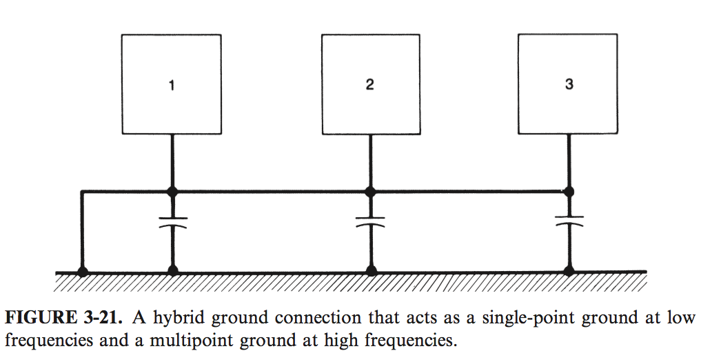

A very interesting approach can also be (not from Bruno's class) Chapter 3.2.4 from Electromagnetic Compatibility Engineering (2009 Malestrom) called hybrid grounds. Combine the ground-plane with the star ground. Obvious you keep your star-grounding as u do conventionally. Try as much as possible point to point. However ground the same individual circuits with a capacitor to the ground-plane.
In this setup, for low frequencies you control the currents, the higher frequencies choose the path of the least inductance through the ground-plane. As bonus the whole PCB is better shielded for EMI by the addition of this ground-plane.
I never tried out the above yet, but I like he approach.

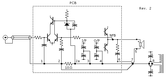

Thanks guys for your input :cheerful:! Bonsai, I drew the grounds in the sequence you list, and got puzzled. Are you saying a star point doesn't work well? I'm not sure about thinking of it as a series run- is this on a microscopic level? I am aware of voltage gradients on high current pcb pads (and even a bolt with stacked lugs), in practice all nodes can never be equipotential. Maybe this is the (lug or wire) sequence at the star point? That I can understand.
Overall, I find two techniques are popular:
1. The star point is on the amp chassis as a single bolt, with the amp PCB having two ground wires (quiet gnd and noisy gnd) tied to it. With 5-15 wires it gets crazy and I dislike the extra wiring inductance. I've 'scoped a lot fuzz, despite a using a big bolt or copper bus wire. The Leach amps use this technique.
2. The star ground point is on the amp pcb, with a single ground wire to the PSU. The loudspeaker and zobel ground also connect to this pcb star point. Silicon Chip magazine has been using this guessing 10 years, in the Studio 350 and ULD Mk2 etc. I like this scheme a lot and would only add RF bypass to it.
On the odd-ball ground point, my reckoning is AC on the cascode decoupling caps/zener ends up modulating the transistor's base, so I'm not seeing how the diff. amp doesn't react. It's not common-mode noise?
Hello prairiemystic,
Does the picture you have posted in http://www.diyaudio.com/forums/solid-state/168202-power-amp-pcb-design-grounding.html#post2211375 show the order in which the 0V signal can be taken from a "linear" trace instead of a star point? Does it mean that it would be better to run a single trace from the 0V filter capacitor "8" and branch it into several traces going to the different parts of the amplifier? If this is the case, it looks like the 0V branch going to the input "1" will have a different (variable) voltage than the 0V at the filter capacitor "8" due to the (small) resistance of the trace and large currents passing through common parts of the trace. Is this ok? Any comments are appreciated.

When you make a star ground point (on a PCB or chassis bolt), it ends up being a stack or line of things to connect. This sequential or "linear" view as drawn is from using a microscope to exaggerate things, as a trace a few mm in the wrong place can add distortion. You are right, the quiet ground "1" should have a dedicated return to the system star point "7", i.e. done in the Leach amplifiers. "8" is considered a dirty point due to the high capacitor ripple currents and so "7" is the actual system star ground.
Here is an updated pic of a (overall) grounding scheme that I see a lot. Two PCB ground wires are run (quiet and noisy). Other designs move the star ground "7" onto the PCB, instead of off PCB on a chassis bolt. I'll post a pic of a PCB layout that did that.
Do you have a reason why the shield for the input would go to point 1 rather than directly to 7 (the quiet star point)? As far as I can see, by doing it this way, the RF common mode currents on the shield get fed directly into the base of the LTP transistor via the input filter cap.

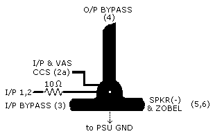

PCB star ground implementation
Here is my sketch of a power amp PCB star ground implementation, taken from Silicon Chip Magazine designs, showing ground point "7" (in my other sketches) moved onto the PCB.
My complaint would be having the loudspeaker and Zobel return connected to the PCB. This means high currents flowing in the wiring from the PCB 0V point back to the PSU, which is not optimal.
