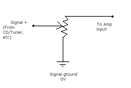

one simple method of hooking up the volume control pot.

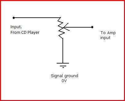

As to the 10K pot (any 10K 47K 100K will do) Stuart's description and Gains diagram I'm afraid are both incorrect (probably something in the water). It is the output signal that is taken from the wiper, the input from a C.D. is applied to the "top" and the "bottom" is earthed.

Hope Gain does not mind, I've swapped his drawing round. If you want to run both amps up together you want a 10K Dual gang Pot, and for testing either linear or logarithmic law. As you hold the pot in front of you, shaft toward you, connections uppermost, the wiper (the one goes to your amp input) is the middle one. The left terminal is the input (from C.D.) and the right is ground. It's all dead easy, check the input to your amp on resistance on your meter and make sure the pot swings it from 0 ohms (a short) up to 10K or whatever value pot you chose. If you got Left/Right swapped it would work wrong way round, thats all.
