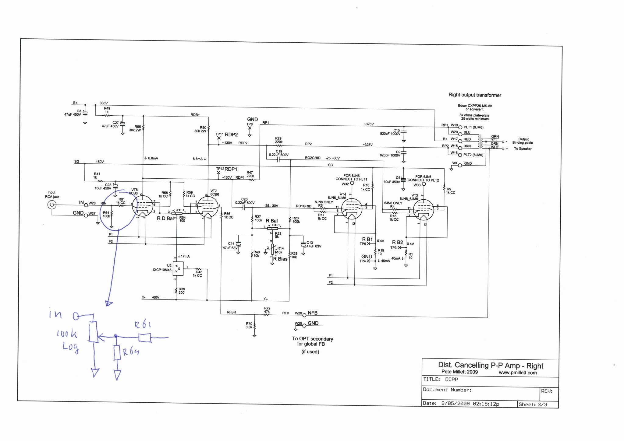

Remove R64. Or for safety in case the pot goes open, change it to 1M.Hello everyone,

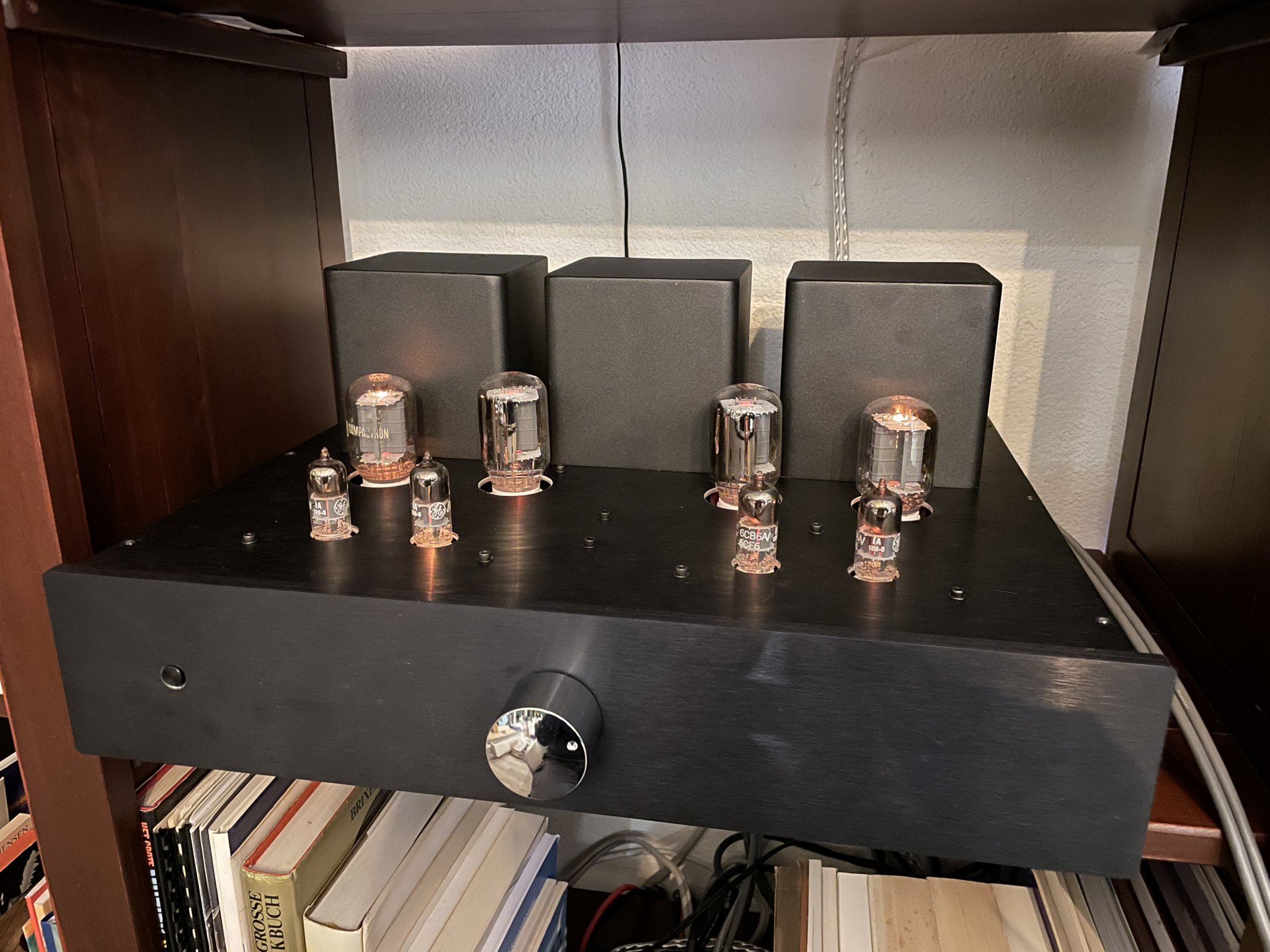

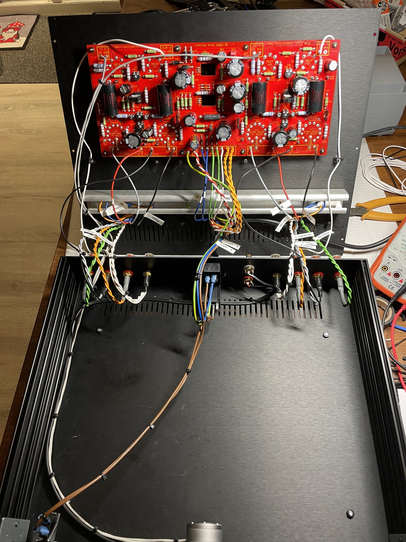

Ik have finished my build today! The amp sound really good. Ik have only one problem. I have added a volume pot. I have to turn the pot til the nine o'clock position to get enough amplification. Can you help me?
View attachment 1007207 View attachment 1007208 View attachment 1007209 View attachment 1007210

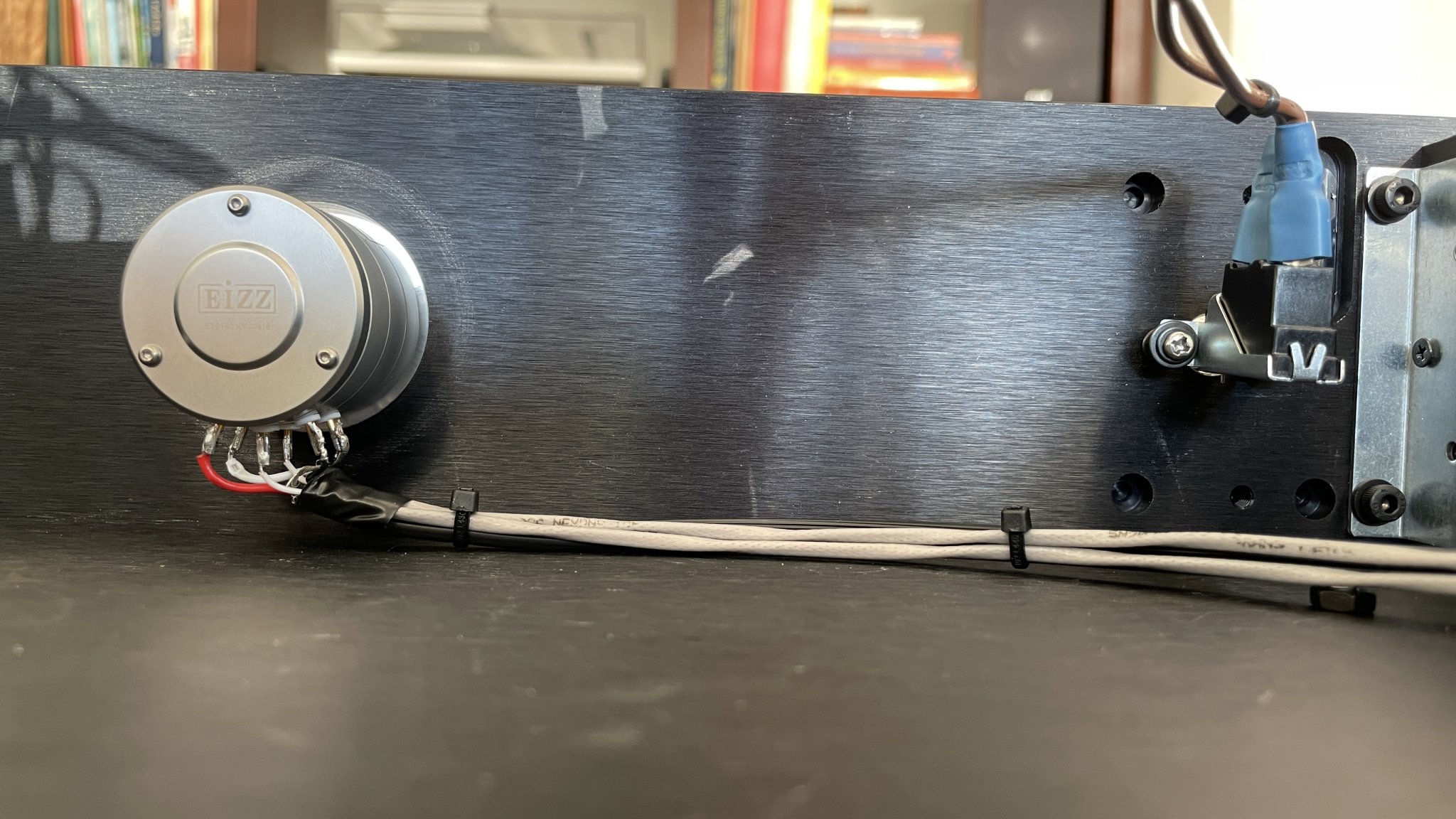

Very nice! That volume pot looks interesting. Could I trouble you for a part number please?
jeff
It is a 24 steps potentiometer from eizz.Very nice! That volume pot looks interesting. Could I trouble you for a part number please?

9:00 on the volume control sounds ok to me.
What is the voltage from your signal source? CD player, 2V rms maximum, or what?
How sensitive are your speakers; dB at 1 Watt at 1 meter?
If you consider your gain to be low, it is partly because:
1. The input pentodes have extremely high impedance plate rp (partly because you are using a current sink with the cathodes tied together; yes I realize you chose that kind of phase splitter).
I use a 12AY7 dual triode and constant current sink with the cathodes tied together, but I do not use schade negative feedback when using that kind of a splitter.
2. You are using Schade negative feedback. The input pentodes extremely high rp has to drive RL 30k in parallel with 220k feedback resistor.
3. You are also using Global Negative feedback which lowers the gain further.

Sorry i meant three o'clock position.....9:00 on the volume control sounds ok to me.

So you do need more gain. OK.
I think I listed some of the items in Post # 1749 that cause low gain.
In my number 1 and number 2 items in that post, I was partly wrong.
The gain is more dependent on the 'operating Gm' of the input pentode x the 'plate load of 30k in parallel with 220k' (not the pentode's rp).
And since you are using a CCS constant current sink in the parallel cathodes of the input pentodes, the 'operating Gm' is effectively reduced to 1/2 of what it would be with AC grounded cathodes (which that kind of splitter can not do, it does not work with AC grounded cathodes).
In my number 3 item in that post, increasing the feedback resistor's resistance to 2x its original resistance can increase the gain of the amplifier (by up to 6 db, if the open loop gain is large enough versus the closed loop gain with global feedback). (increase 47k to 94k).
