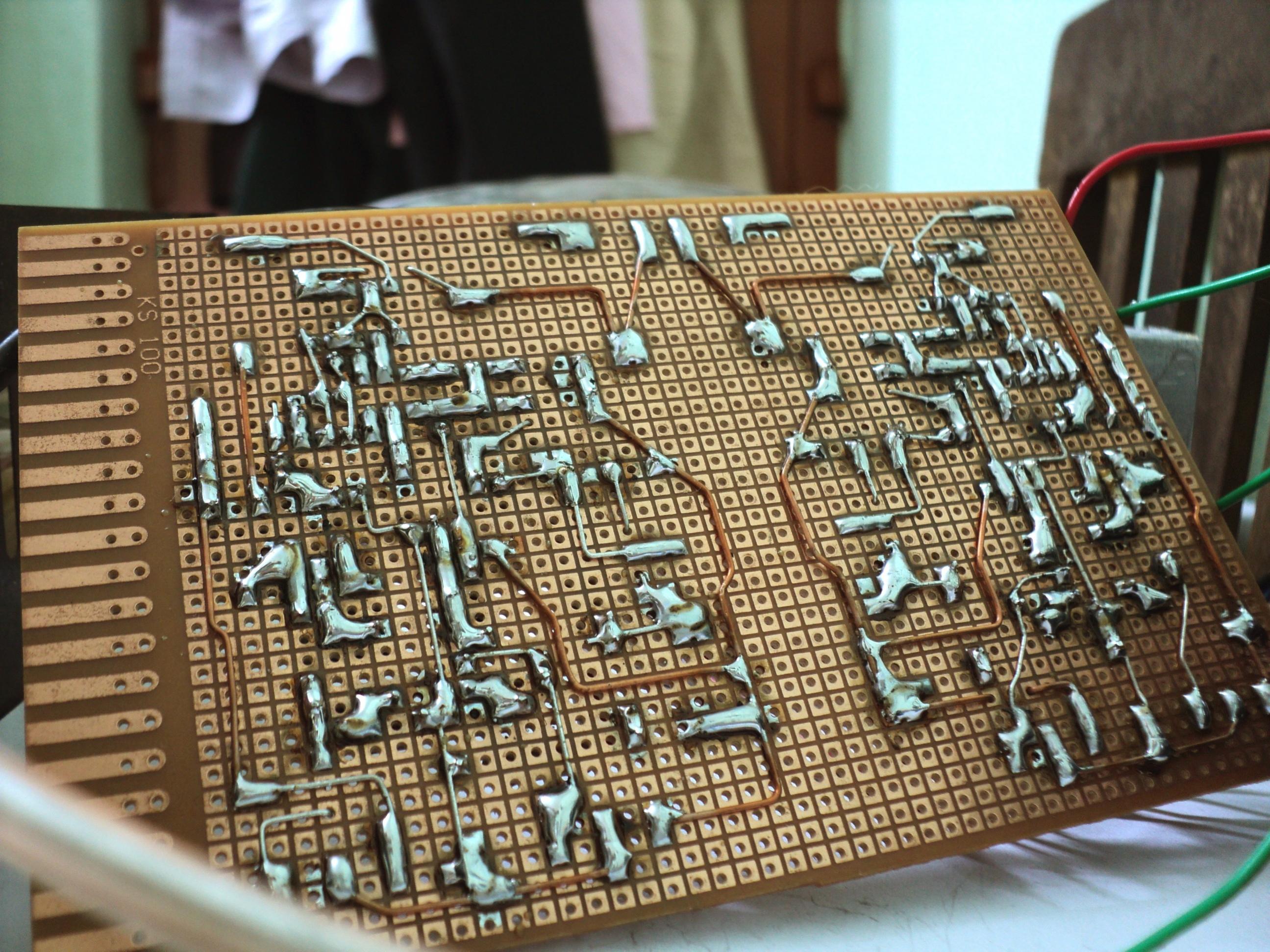

solder?
I thought from the top side pics, that you were using perf board.
Thanks again.
I am using Dot Board. Assembling is a breeze...

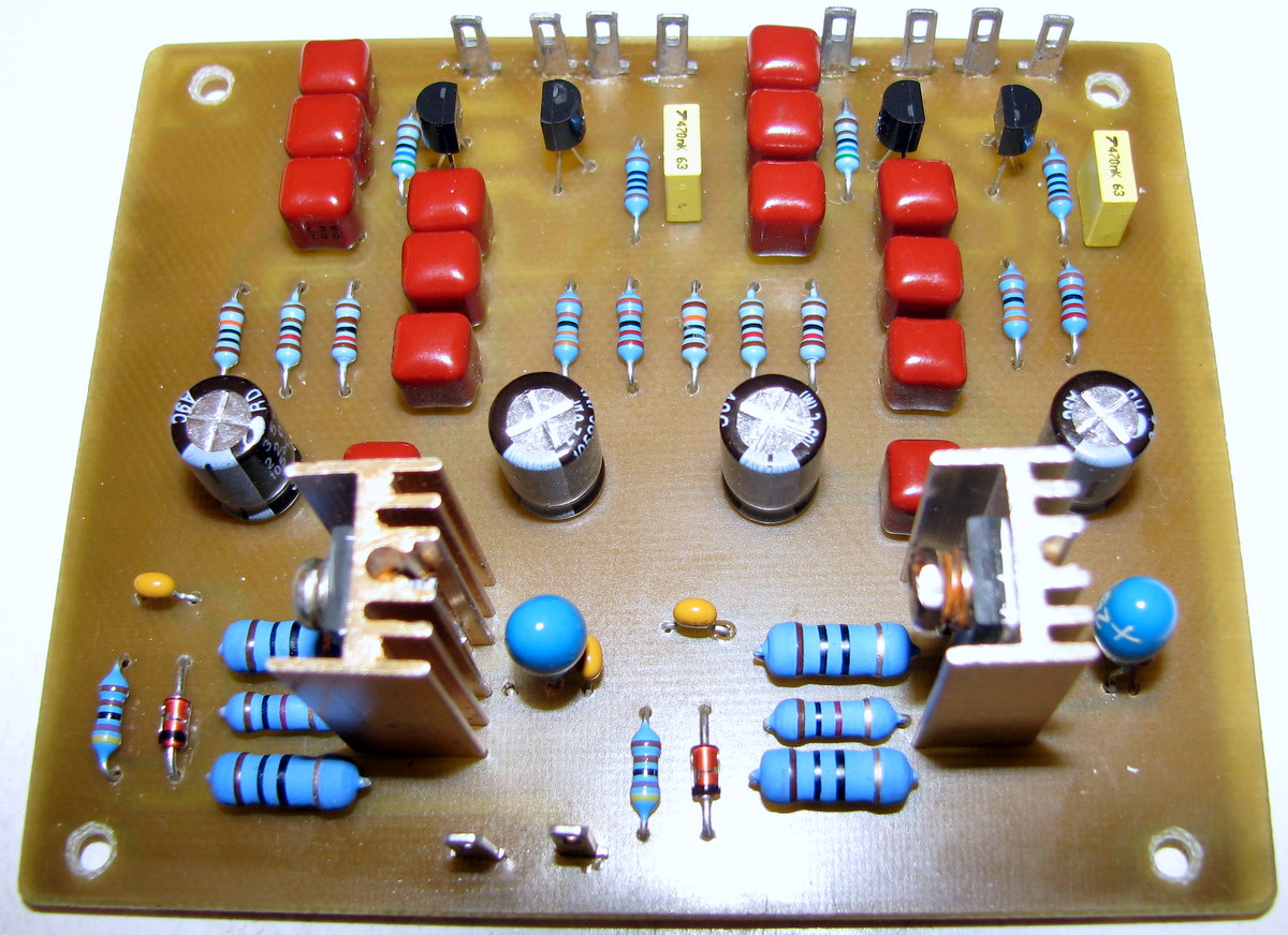

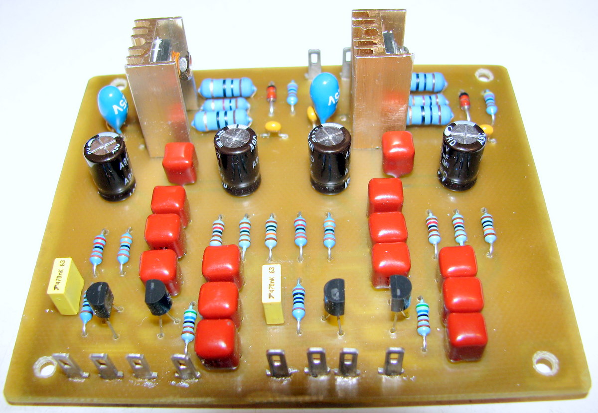

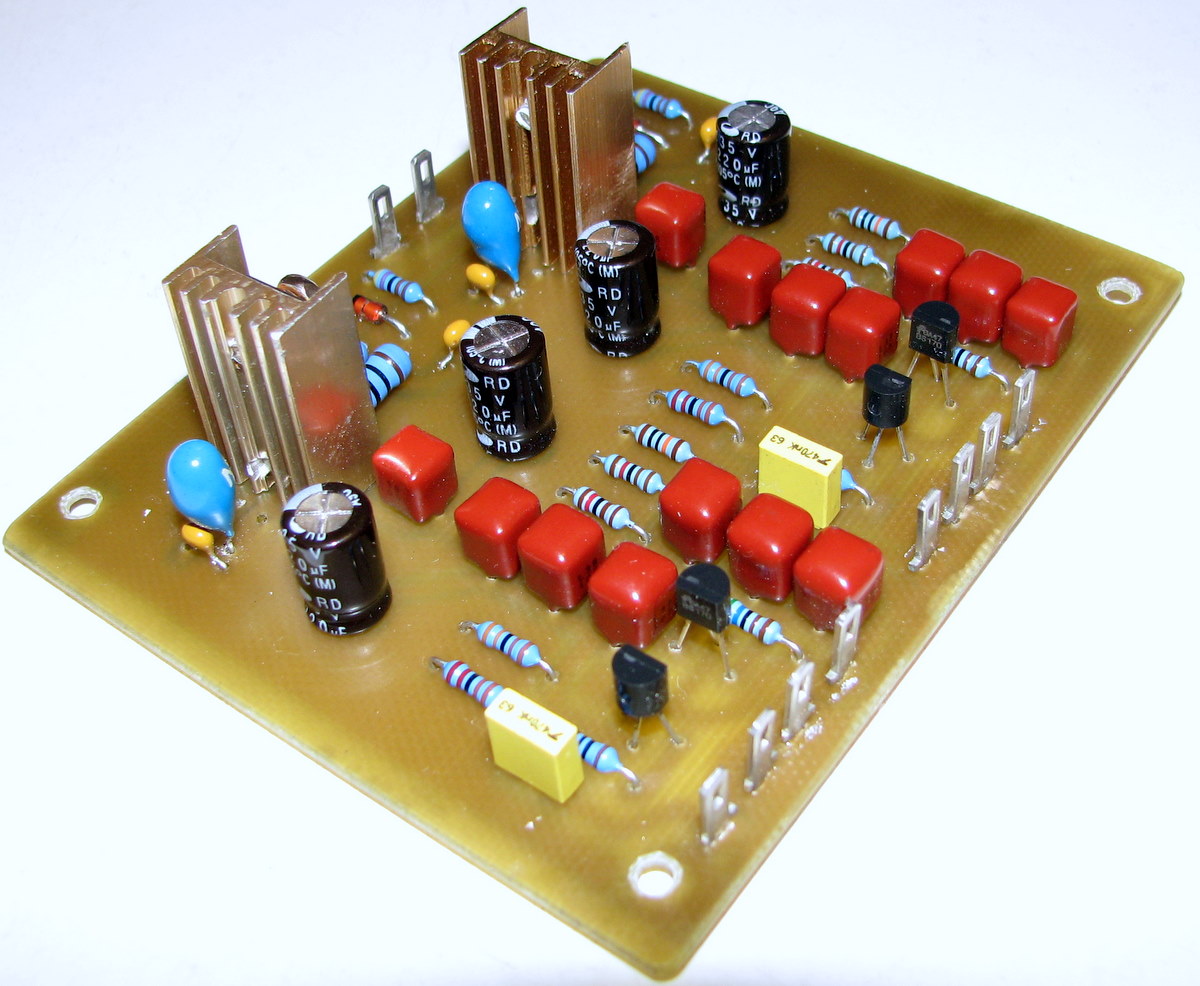

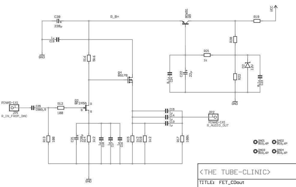

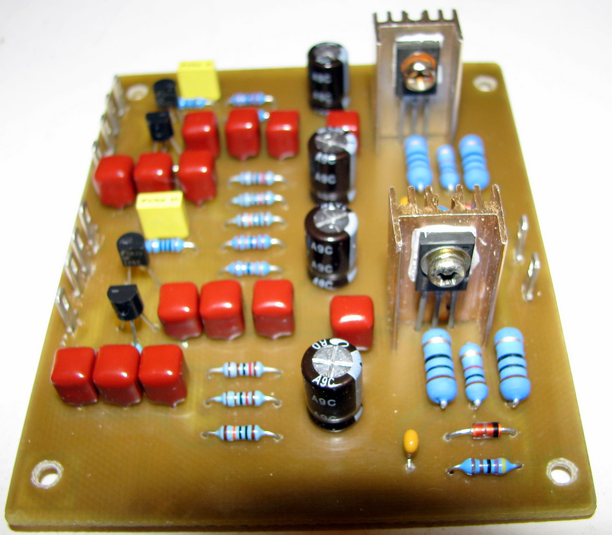

My JFET_CD out PCB ..... not tested , just assembled ;) :)

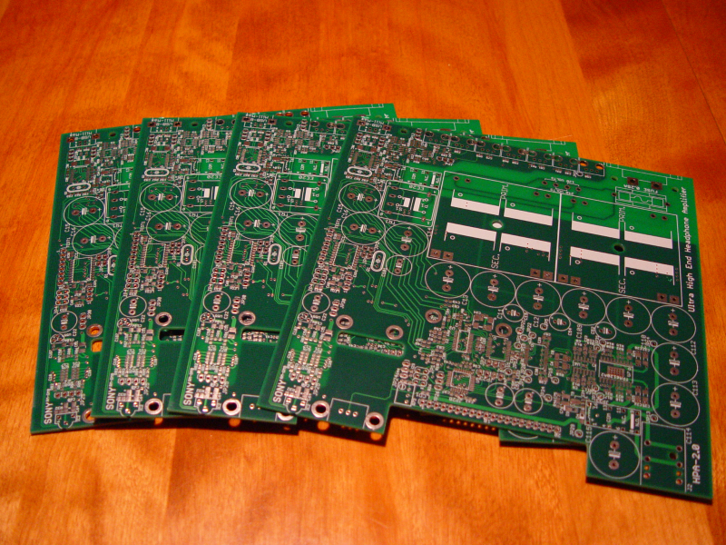

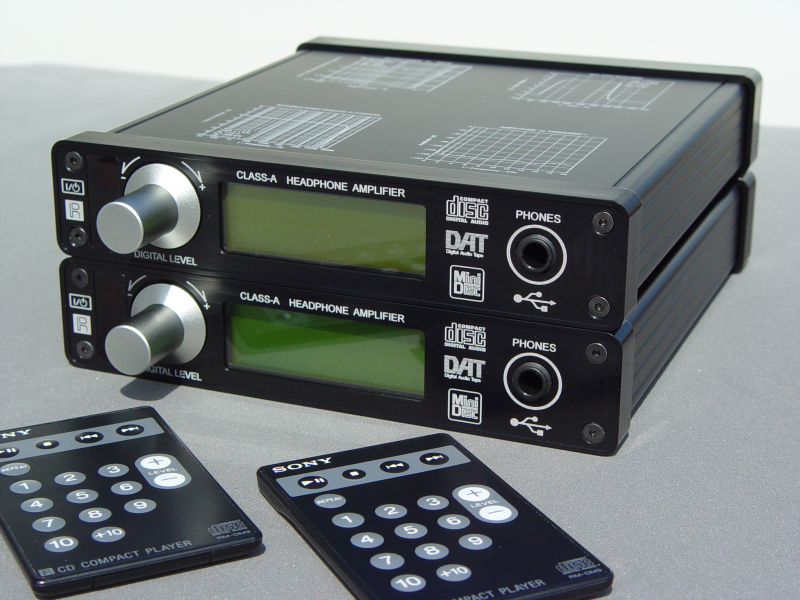

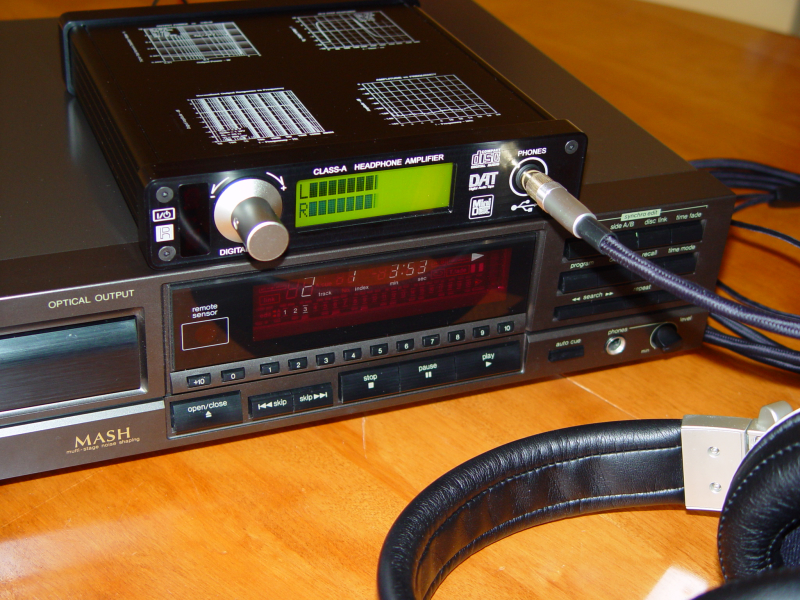

LOL thanks mate, 'si-bi radio station', that is a good one. You got it all wrong, it is a Toaster... :D:D:D:D
The basic design started out as a HPA by GMarsh and I just added a few extra features to it. Eventually I added more and more stuff until I run out of room. Features such as IR, servo volume control, a lot more inputs, LCD, VU Meter, QTouch ect.
Cheers

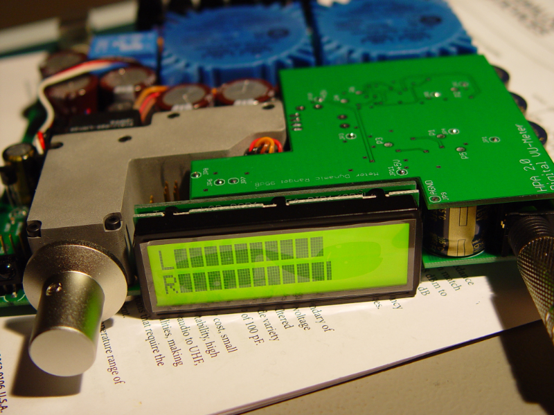

Nice looking volume control unit (2nd picture). I have seen for first time. Looking at the foot-print on the PCB (1st picture) it seems to be a motorized volume pot. Its brand? Thanks for any information.

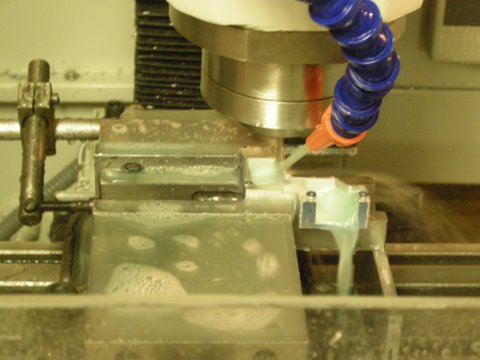

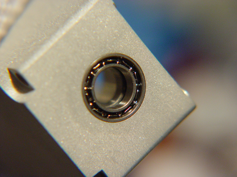

Thanks fotios, yes, it is motorized. The quadrature encoder is made by Bourns and the Aluminum (7075 alloy) is made by ALCOA and machined to my spec. ;)
Of course it would have been much easier to skip the servo thing and just do the remote volume control by software however I wanted moving parts in there
because I like clockwork :D:D:D:D
Cheers

Hmmm... So, is a custom made motorized encoder machined in a CNC milling machine. However, is a masterpiece of mechanical process. I like it very much, especially the ball bearing base ;).

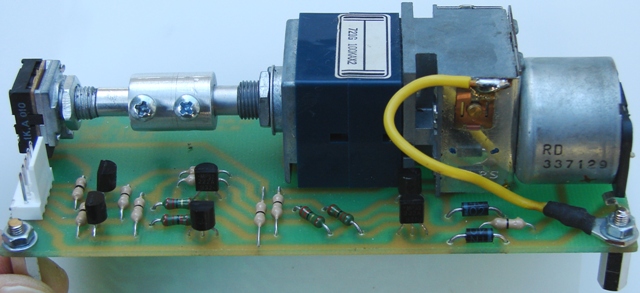

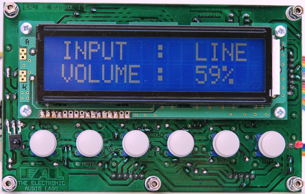

And here is mine volume control and the mcu unit.
Instead of an encoder, i use a traditional ALPS Blue Velvet motorized pot which of the shaft is joined with the shaft of a second 1KΩ mono linear pot thru a "couplier". The two pots are rotated simultaneously from the motor of ALPS. The wiper of the mono pot, is connected at the RA0 analog input of the (really excellent) PIC16F887 and its voltage level (proportional to the rotation angle of ALPS) is translated thru the program code in percentage which in sequence is displayed on the LCD screen.
