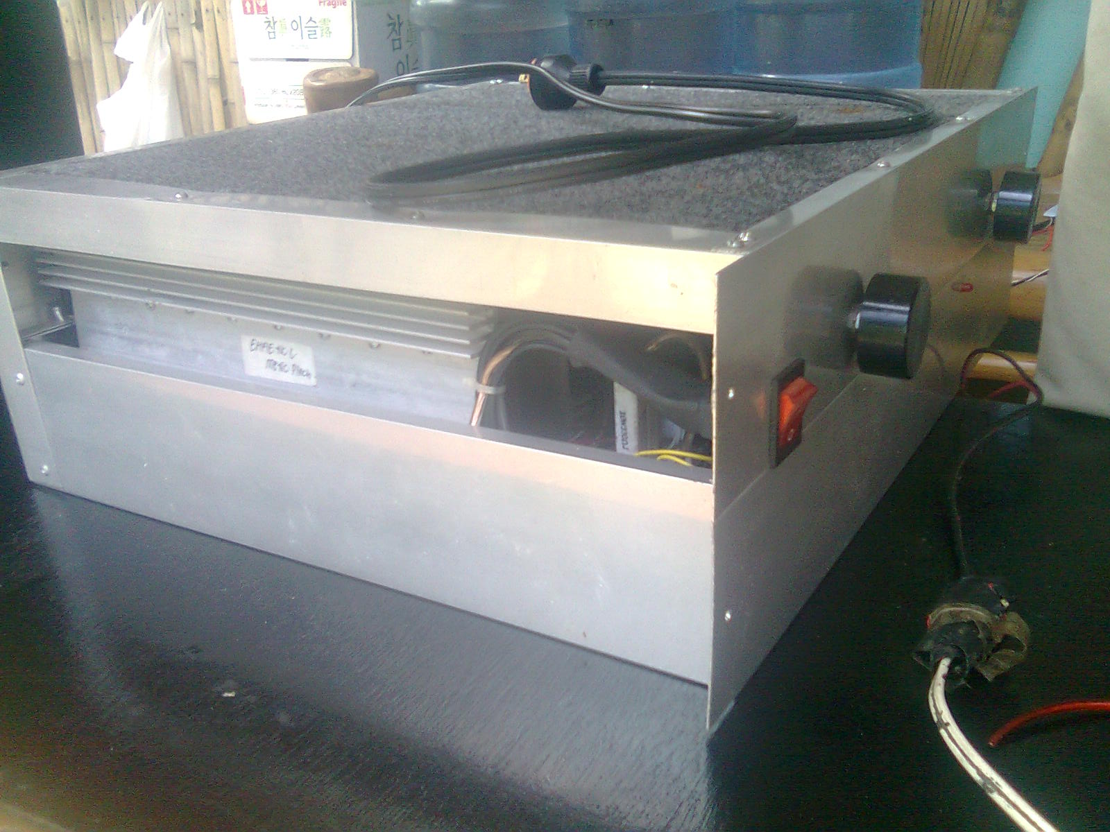

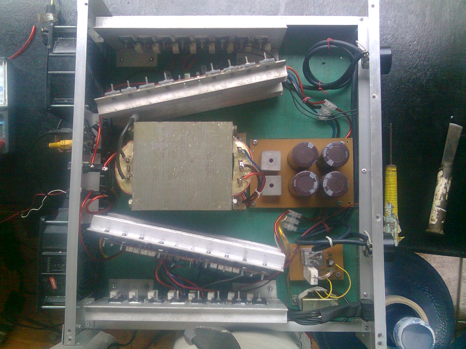

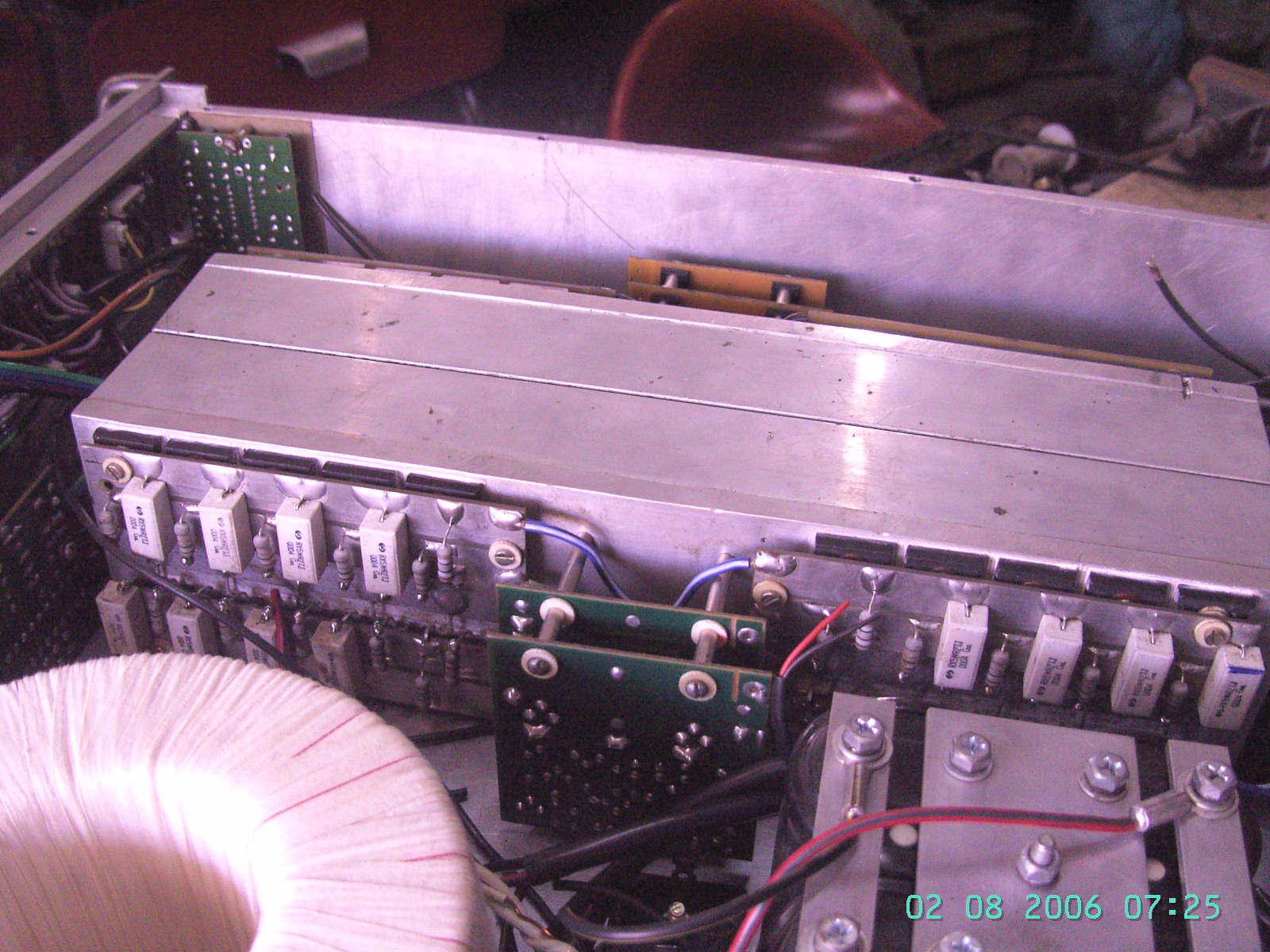

hi biyiers

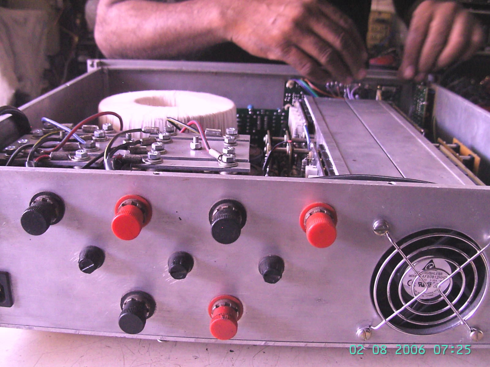

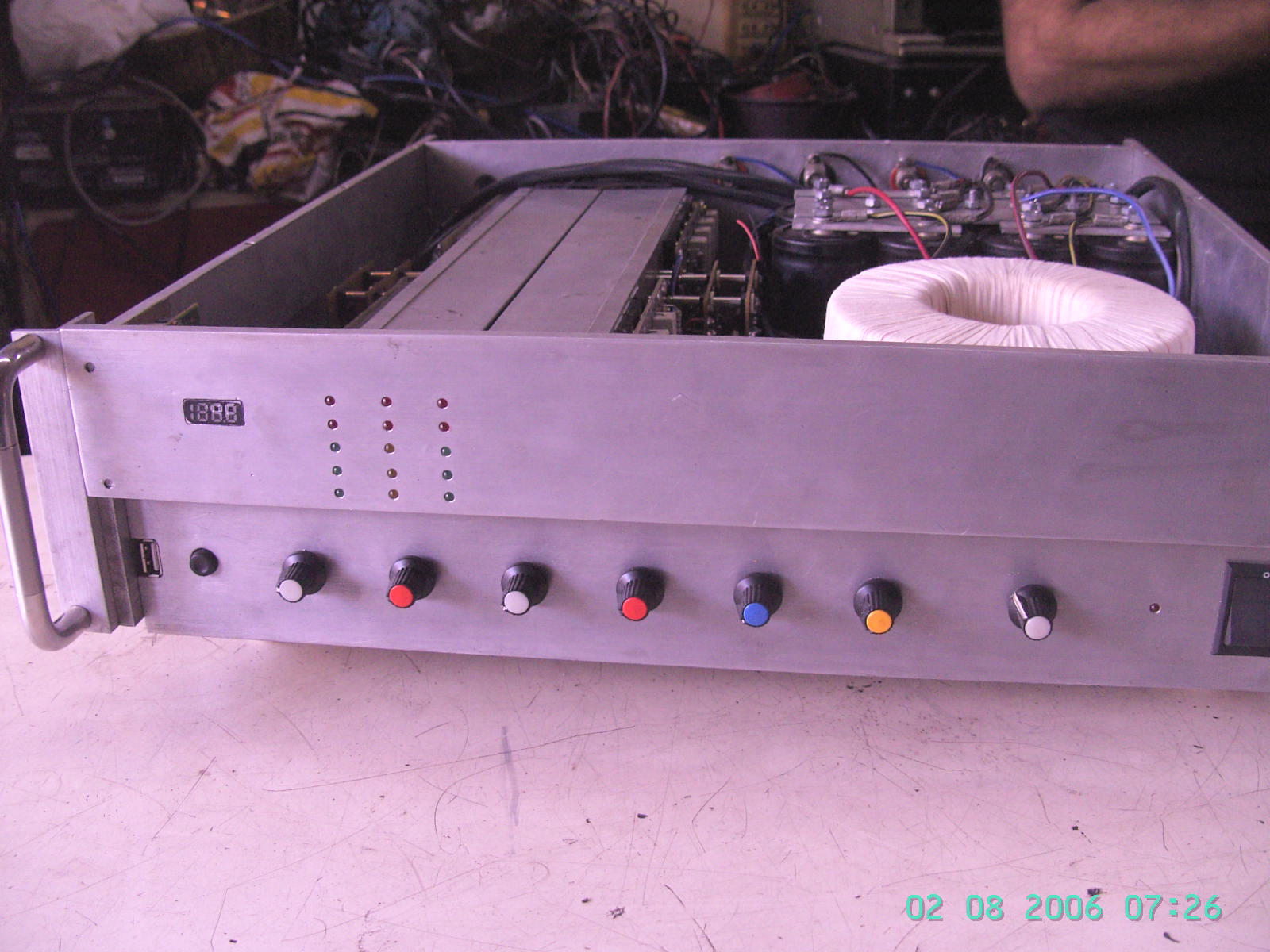

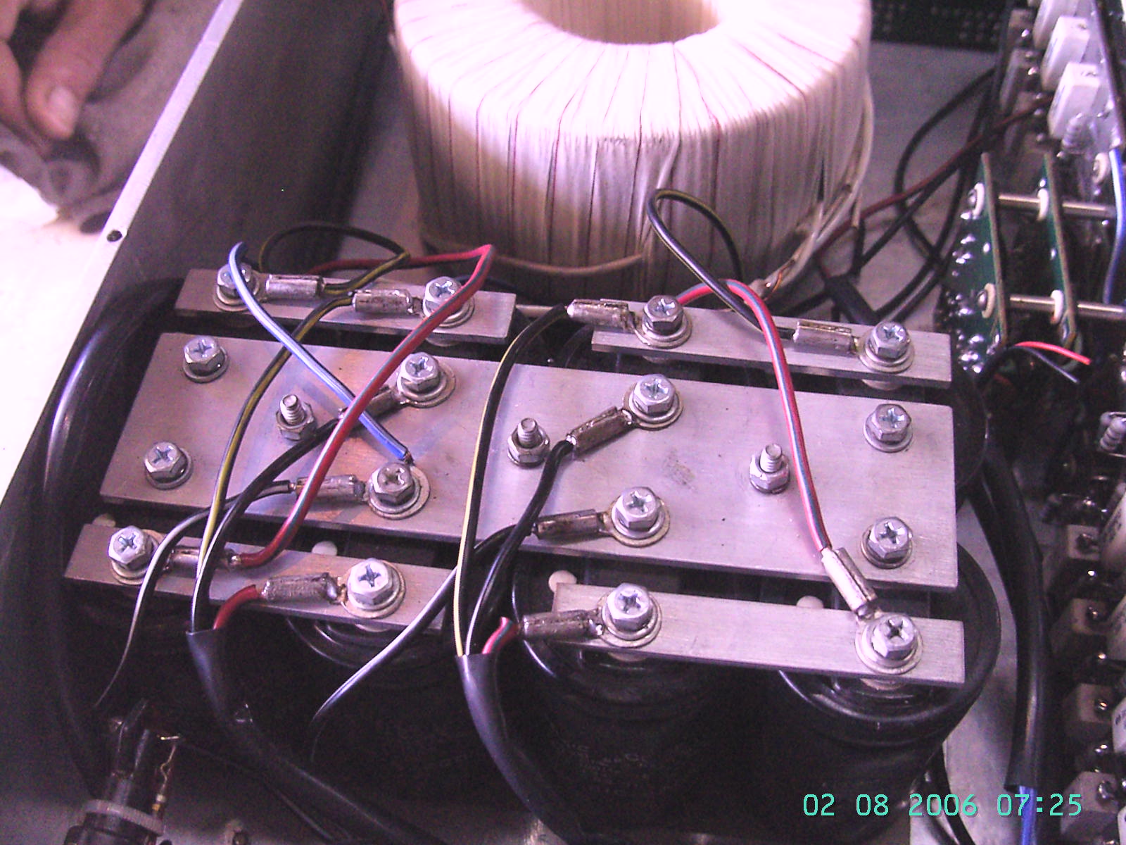

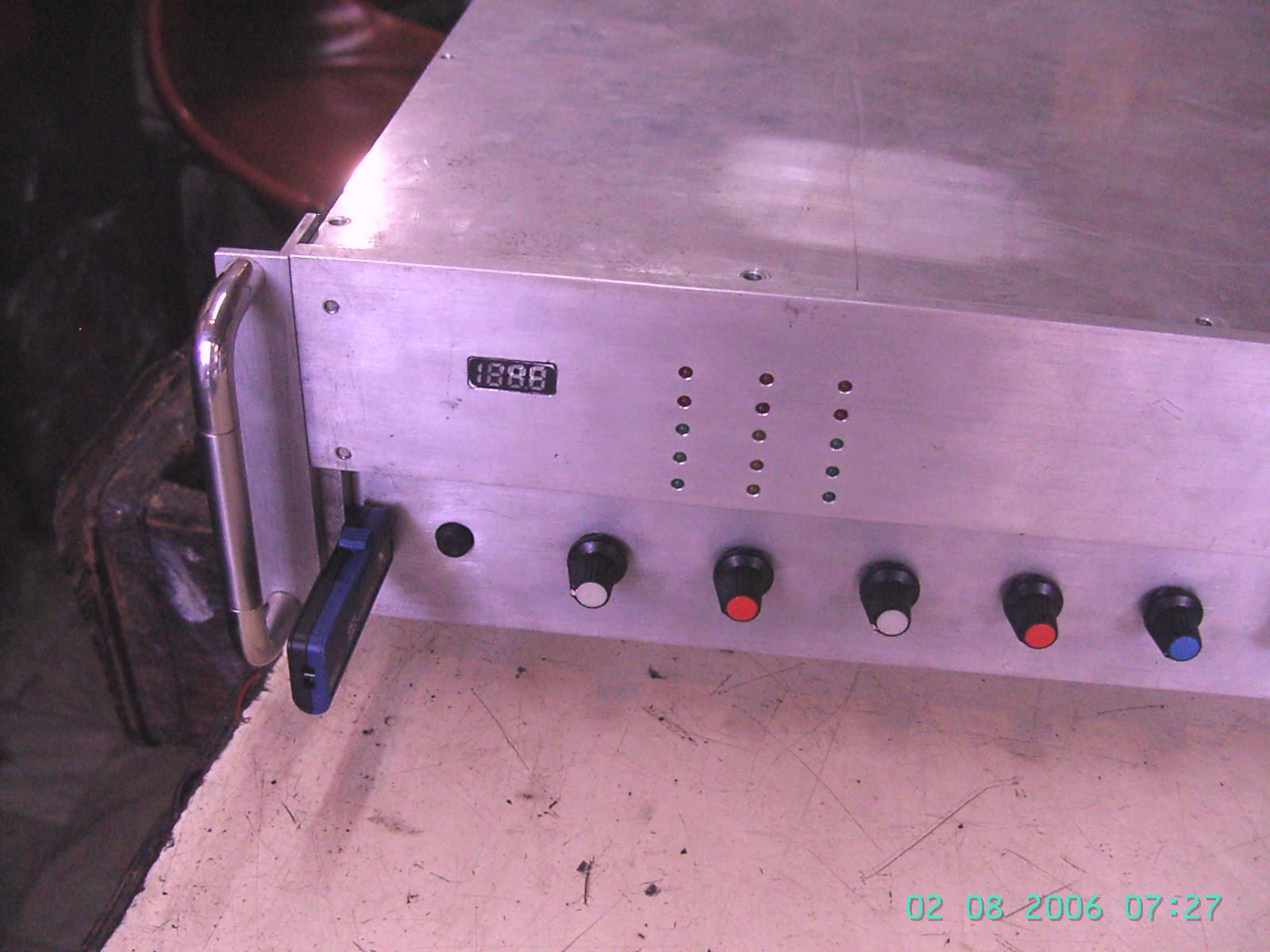

greetings my 2.1 amp winding my toroidal primary complete my aluminum cabinet with usb input 2.1 amplifier 300 watts each + 600 watts 2 channels bridged
thanking you
Andrew lebon
