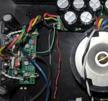

150 watts ska (other channel cut in picture) with soft start, and couple of secret modifications

" ... and couple of secret modifications ..."
My secrets:
* silver wire on all audio pathways ... between connectors and modules, inbound and outbound from panel controls ... It may not do any good, but it sure does make for interesting conversations. :cool:
* Extra caps for PS rail filtering ... plastic (poly type) bypass caps in parallel with PS caps, across the rails to ground and as close to the action as possible, close to the amp / op-amp power pins/connectors/traces. (Ask Bob Pease.)
* Gold plated connectors on the audio pathway and the speaker output. In the interest of economies, only one of a connector pair needs to gold plated. Gold to copper or gold to silver is better than just gold to gold. (Discussion?) If the amp or pre-amp module connections are not gold, then I use gold connectors on the wire side.
* ... more ? :smash:
*Silver is better than copper, if you keep it good gauge size, it's also lot more durable in long term.
*filter caps is good to filter high frequency artifacts. Closer means less charge spikes and possible antenna effects
*Good, if you have couple hundred $ buy silver ones, they are a lot better. Depends on your system ability to show details.
" *filter caps is good to filter high frequency artifacts. Closer means less charge spikes and possible antenna effects ..."
Yes! I usually spec these poly plastic caps at about 1/100 to 1/1000 of the values of the main power supply electrolytic capacitors ... Ex: 20,000 uF electro caps on each PS rail, then plastic bypass caps would be about ~20 uF mounted "close coupled", very close to the power supply pins on the amp modules and/or pre-amp module power supply input points and if possible right across the op-amp pins. Got +/0/- 15 VDC pre-amp rails? Spec the caps to > 35 VDC, two required from negative rail to (signal/power) ground & + rail to (signal/power) ground. (I call this the TI trick, because thats what Texas Inst. and National Semi (and some others) do to get those great specification numbers on their op-amps. In fact TI even explains this in their docs.) :smash:
