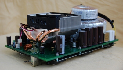

"Post some more pictures here ... "
OK! Another one unpublished:

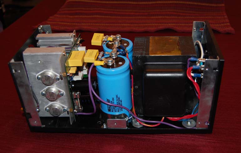

My first project amp photos......
For everyone’s perusal here’s my new Hafler XL280 clone monoblock. With specs of 145watts continuous, mosfet outputs and a tested design I decided this was the best way to make a robust center channel amp.
The case is a gutted Dayton APA150, the only thing I kept were the binding posts and shell. I cut down the stock heat sink for space reasons and drilled holes for the mosfets. Transformer is a 110v/63vdc Hafler unit, the board is a Musical Concepts PA3D. Caps are Mallory 12,000mf/75v with a 600v 25a Vishay bridge rectifier. Three Exicon EC10N20 and three EC10P20 mosfets were used.
It powered up perfectly, no smoke or hum, sound is dynamic and articulate. The only problem is the heatsink is really too small to run the mosfets at 100ma each which is the stock setting (330ma). The stock chassis had a 12vdc 80mm case fan on the rear (behind the heatsink) so I just put a new ultra-quiet fan in that spot. This lets me turned the bias up to about 80% of optimum and the heat is ok.
Not sure if I'm posting a photo correctly, so my link is HERE
Thanks everyone for your Exicon tips on my earlier thread.
-Bryan

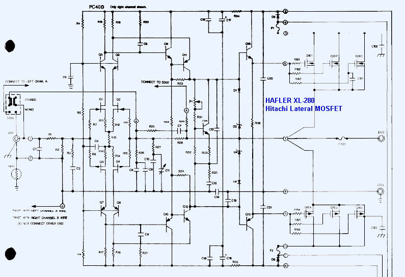

Three pairs of Exicon EC10N20 + EC10P20 MOSFET per channel were used
:) Exicon EC10N20 + EC10P20 MOSFET are some fantastic FET-s :cool:
I have setup some great Class A Amplifier using them in my Spice.
HAFLER XL-280 looks like original use SK134 / 2SJ49 Hitachi Lateral MOS.
The input stage of HAFLER XL-280 is a symmetrical dual differential
Complementary NJFET + P-JFET: 2SK147 + 2SJ72.
This is an amplfier with Symmetrical JFET input and Push-Pull Symmetrical MOSFET output.
:) A great amplifier design and should be one amplifier to LOVE.
I understand why you can be very :checked: :eguitar: :checked: happy with your amplifier, reiver
Lineup
http://www.hafler.com/techsupport/pdf/XL-280_amp_man.pdf

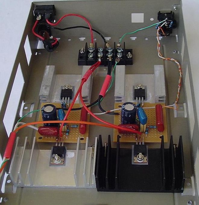

Just had to put the Wooden amp on here. Still going strong
after a week. P4 (frugal)heatsinks are VERY good , full music power without forced air (400ma idle current).
That's the way! And no so much talk as in your original thread.
This is work and not words!
It is not so pretty, but it works just fine!
Which is finally the circuit that you are using in this prototype from the lot of versions presented?
And only one technical question:
Without load, with a square wave of 5Vpp in input, how much is the output rise time in 10KHz and in 20KHz?
I ask because i use almost the same circuit in my current project.
As for the RC network between the collectors of LTP, a well known company in your neighbourhood at Missisippi, knows better from us.
Bravo OS for your effort!
