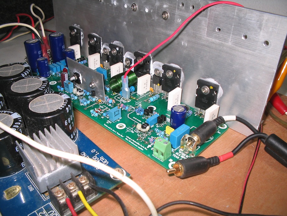

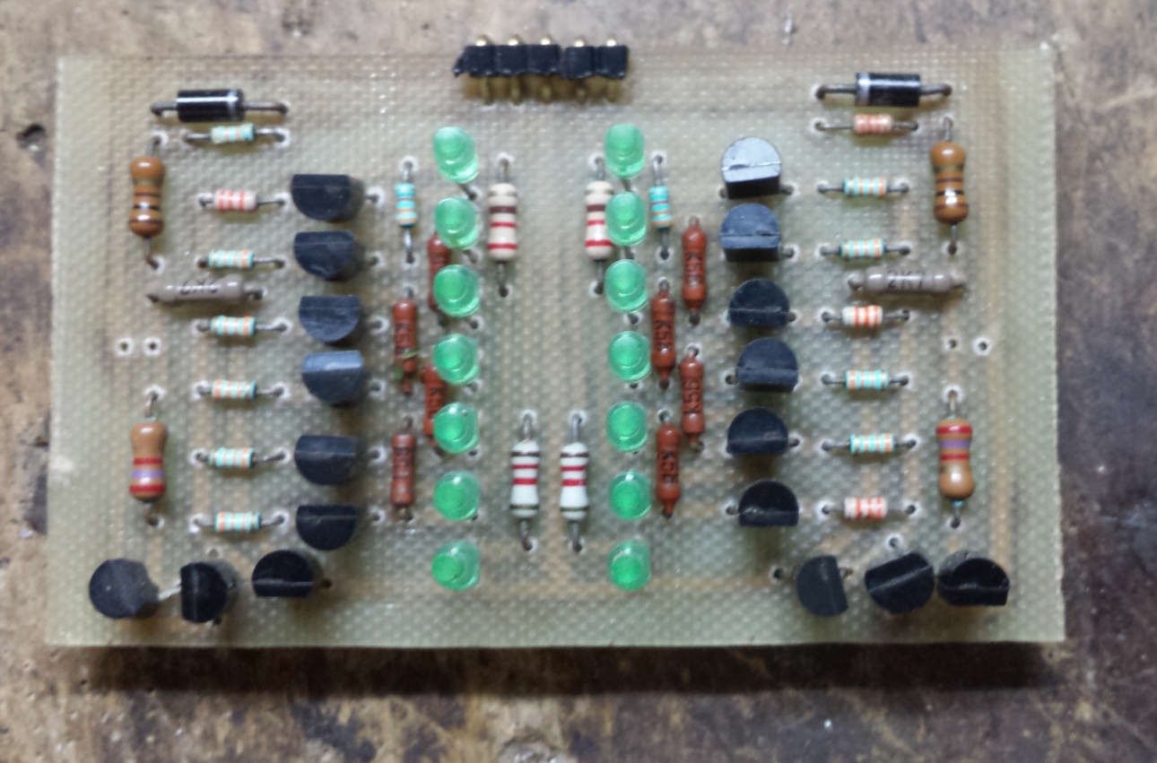

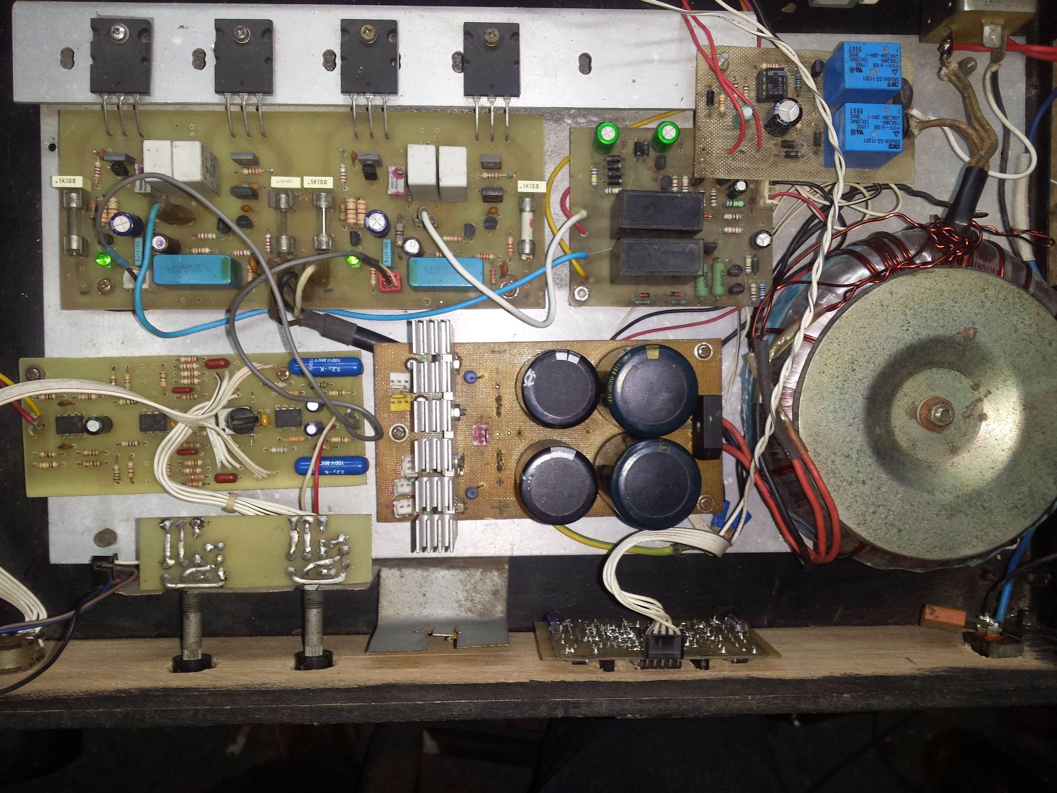

finally finished...., all recycled, handmade boards
very good sound

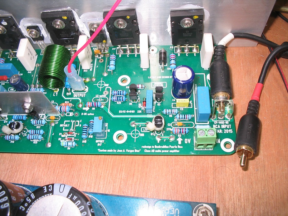

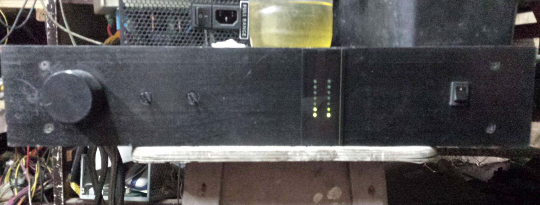

Can you post front side picture?
my custom Honey I just add the RCA
Looks good, except you have them pointing the wrong direction.

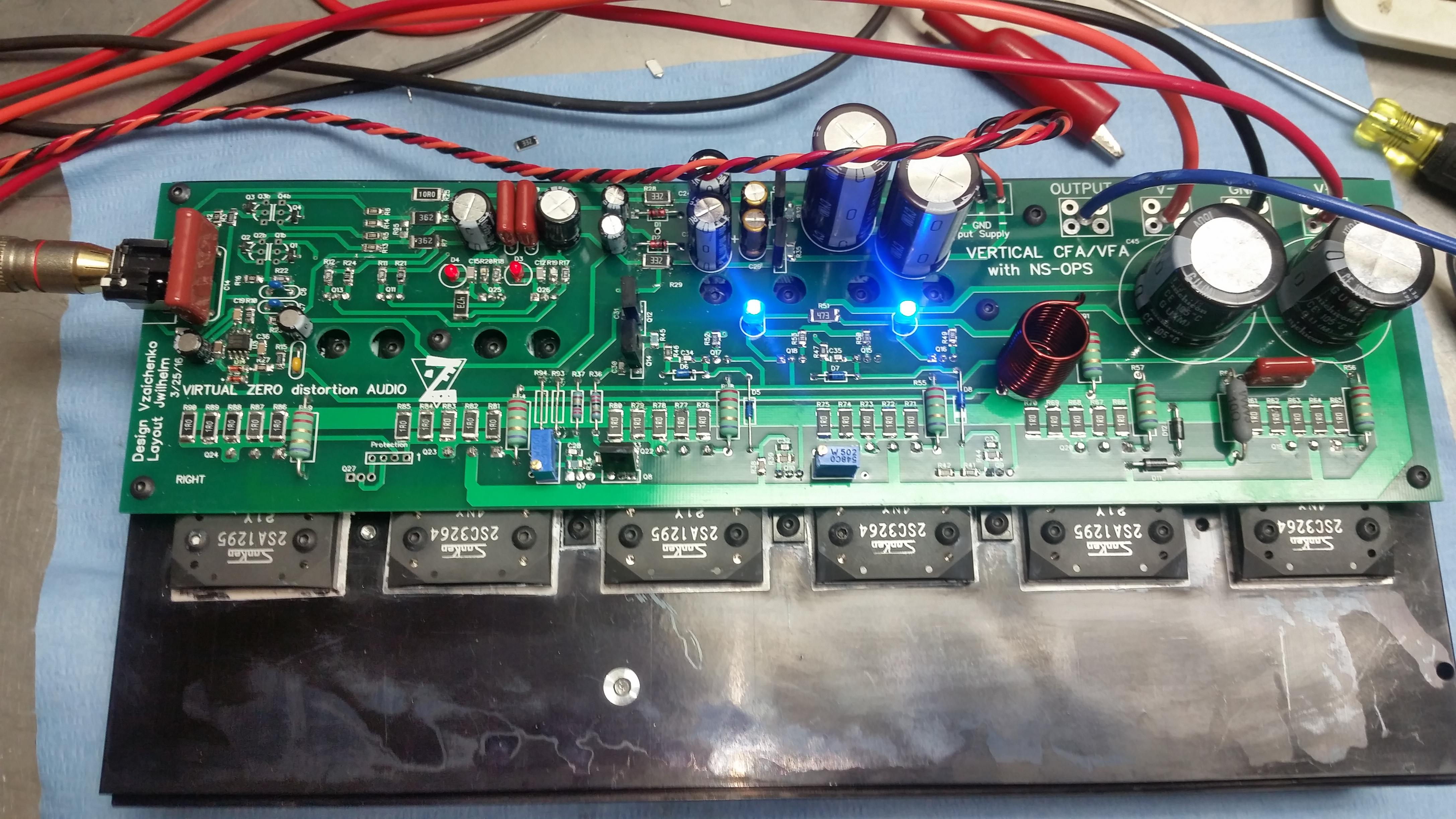

Here's now I did my NS-OPS boards. The RCA connector mounts to the rear panel, so there's no input wiring inside the chassis.

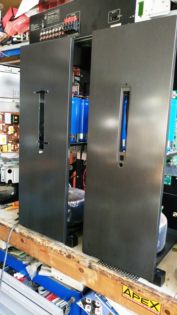

Here's some images of my USSA2 amplifier. It is a fantastic amplifier and the design is from Fab (on this forum), a highly respected amp designer on the French Canadian forums.
You can find the schematics here for version 1 but version 2 is easy to change to:
Amplificateur USSA 15W - Conception
You can find the schematics here for version 4 which I'm currently working on :
Amplificateur USSA-4 : hybride entre version 1 et 3 - conception
The build manuel is in English and can be requested to Fab

I see you are using toroidal transformes from SumR - Richard Sumner Technology.
What are their prices?
I believe they were around 115$ CAD each
They're 300VA each with shield and core band, four secondary (2x 20.4Vac 280VA and 2x 12.9Vac 20VA)
Beautiful!
Thanks! I'm really pleased with this amplifier, sounds really good!
yes I know, I just figure that out lol

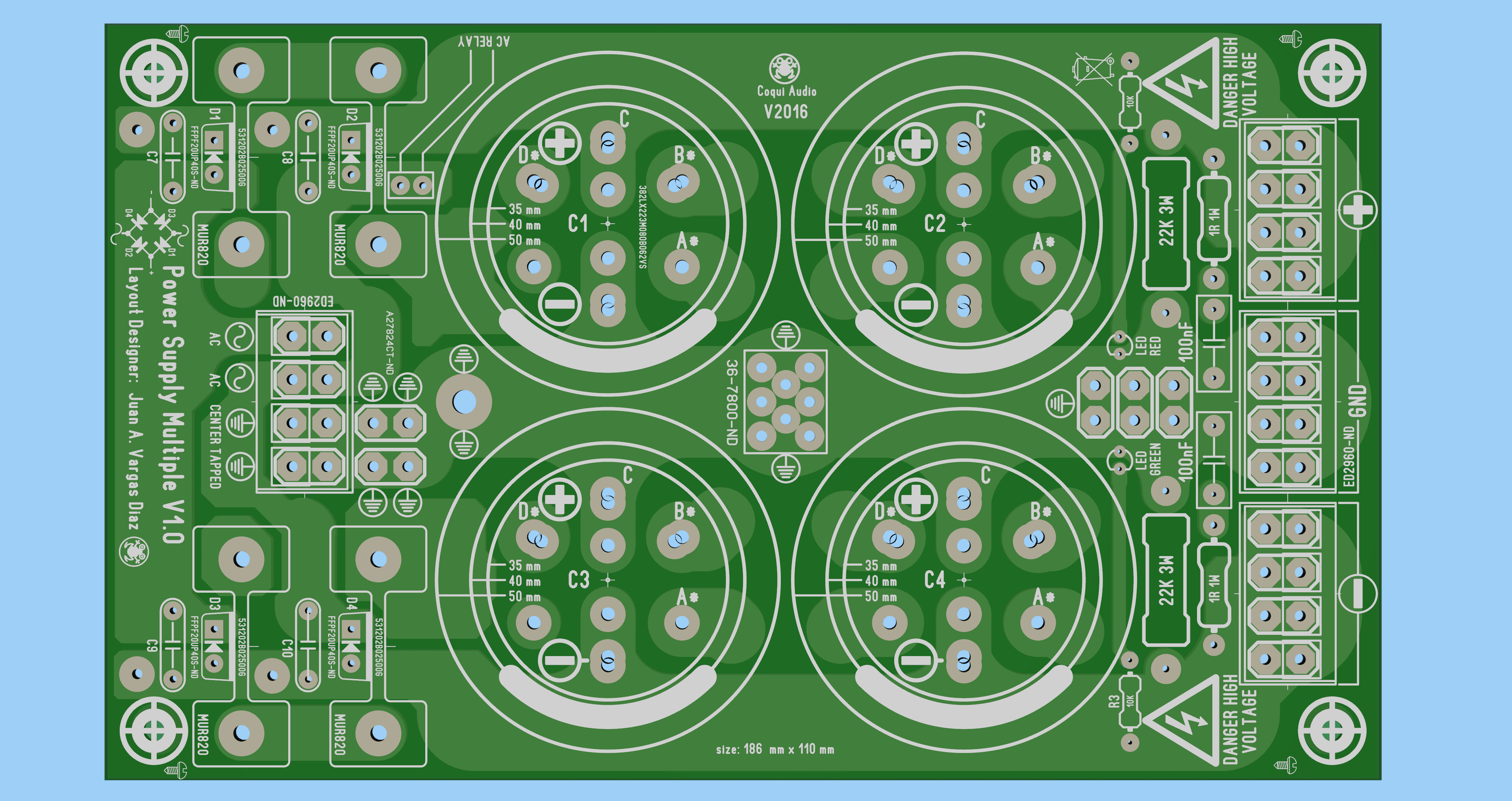

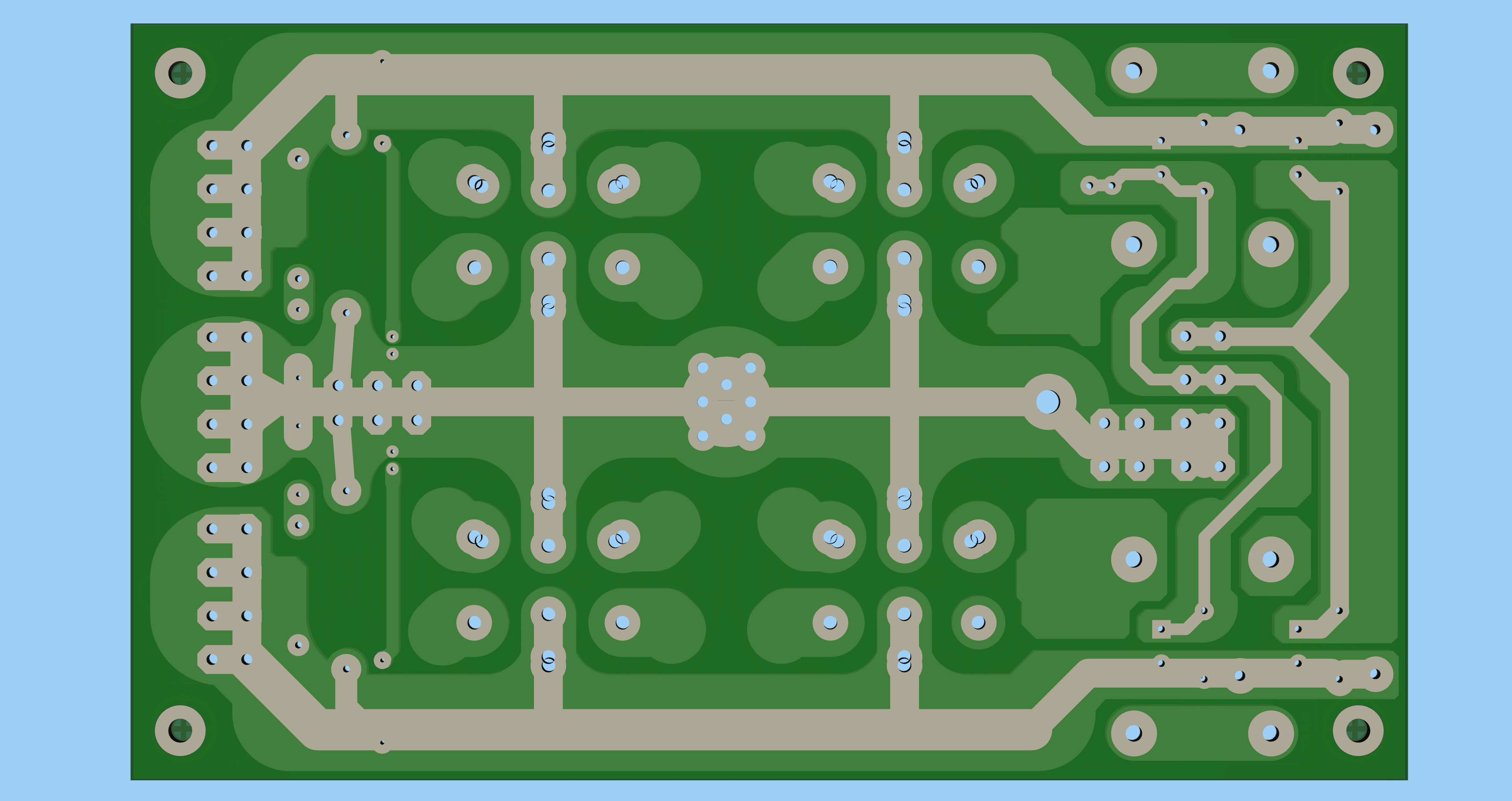

I have plans to order my own power supply design is just a simple one, what you guys think ?

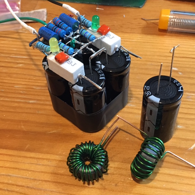

Nice PCB but I discovered that they can be made point to point in 3D and they save a lot of space that way and work great.
This one is about 1/3 the real estate it would have taken on a PCB. These are all 4700uF caps and the whole thing is tiny.
Awesome design! Point to point is a good choice sometimes.
I would be interested in a few of these boards...
