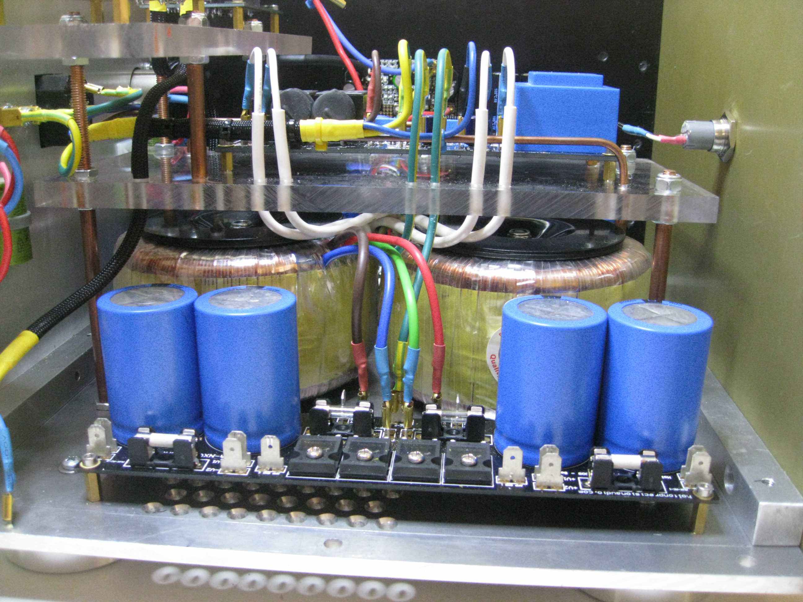

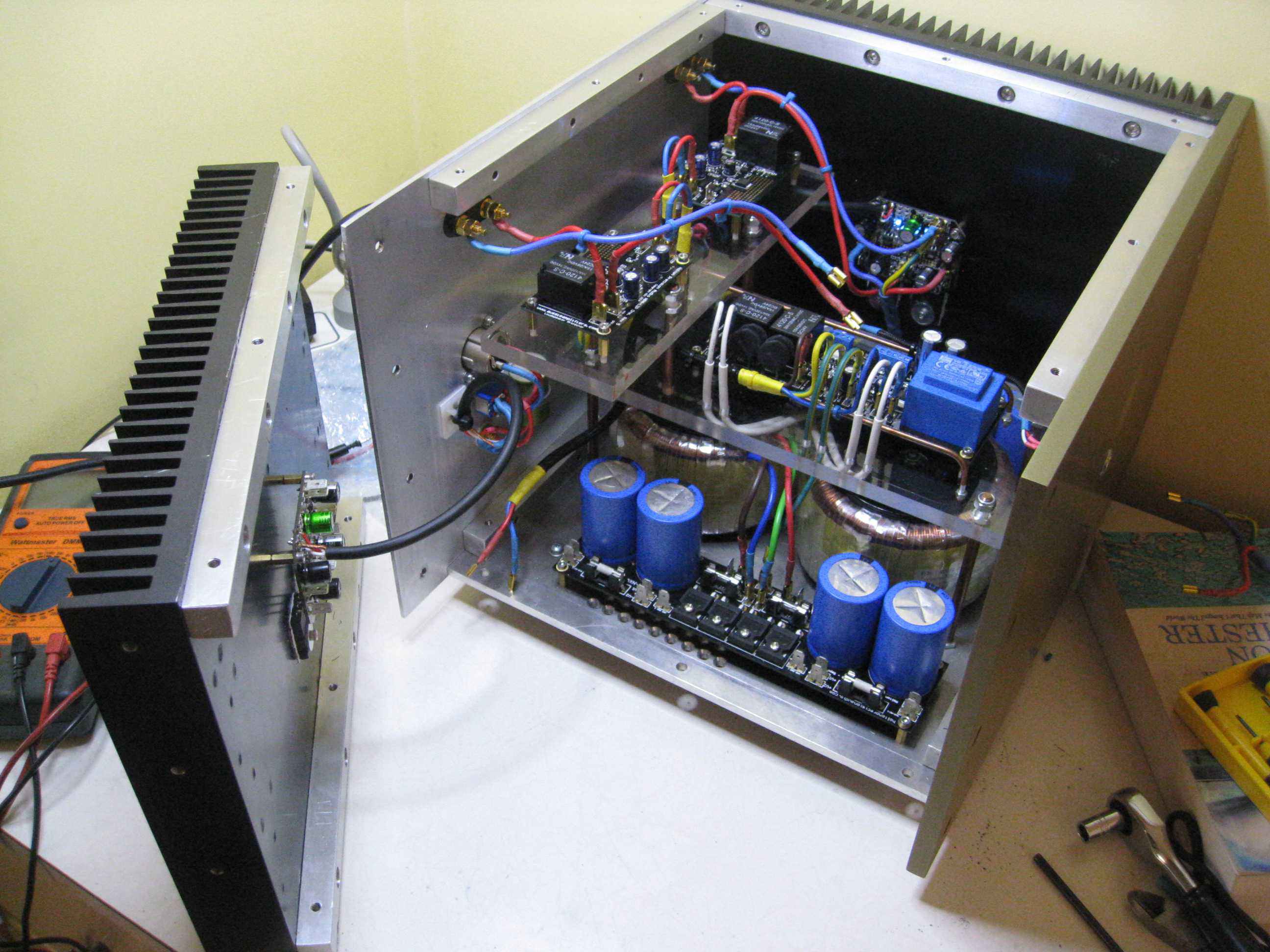

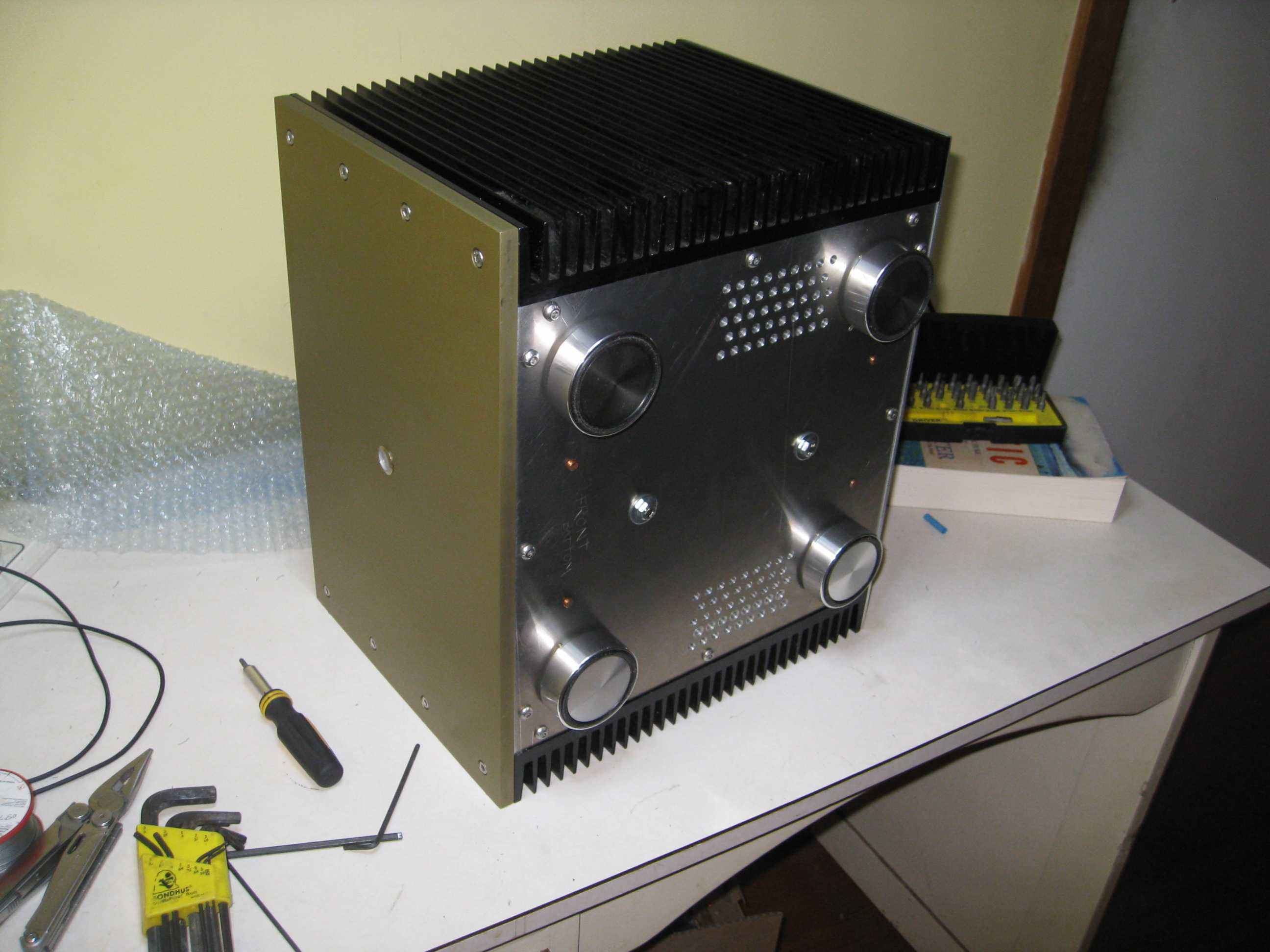

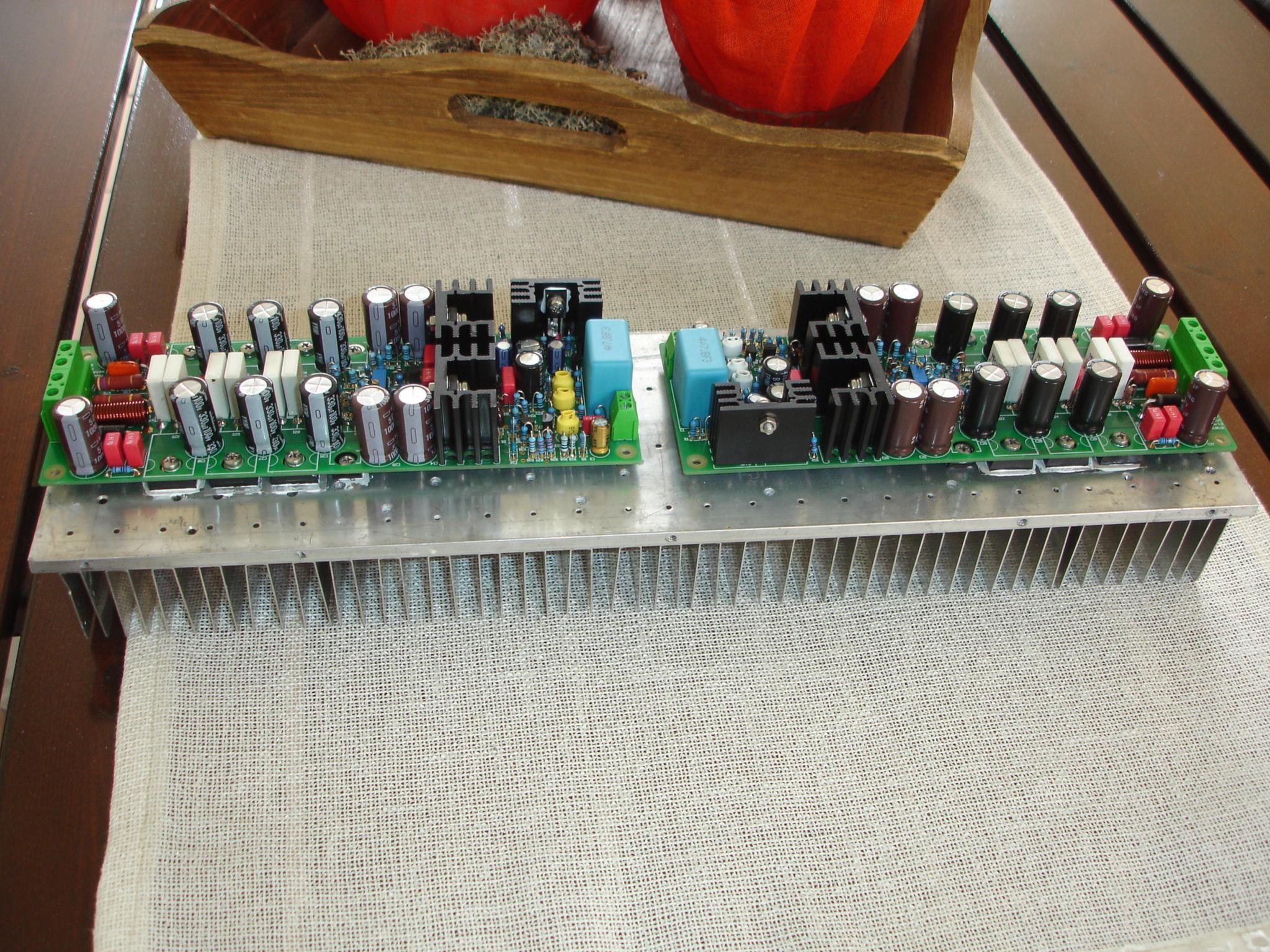

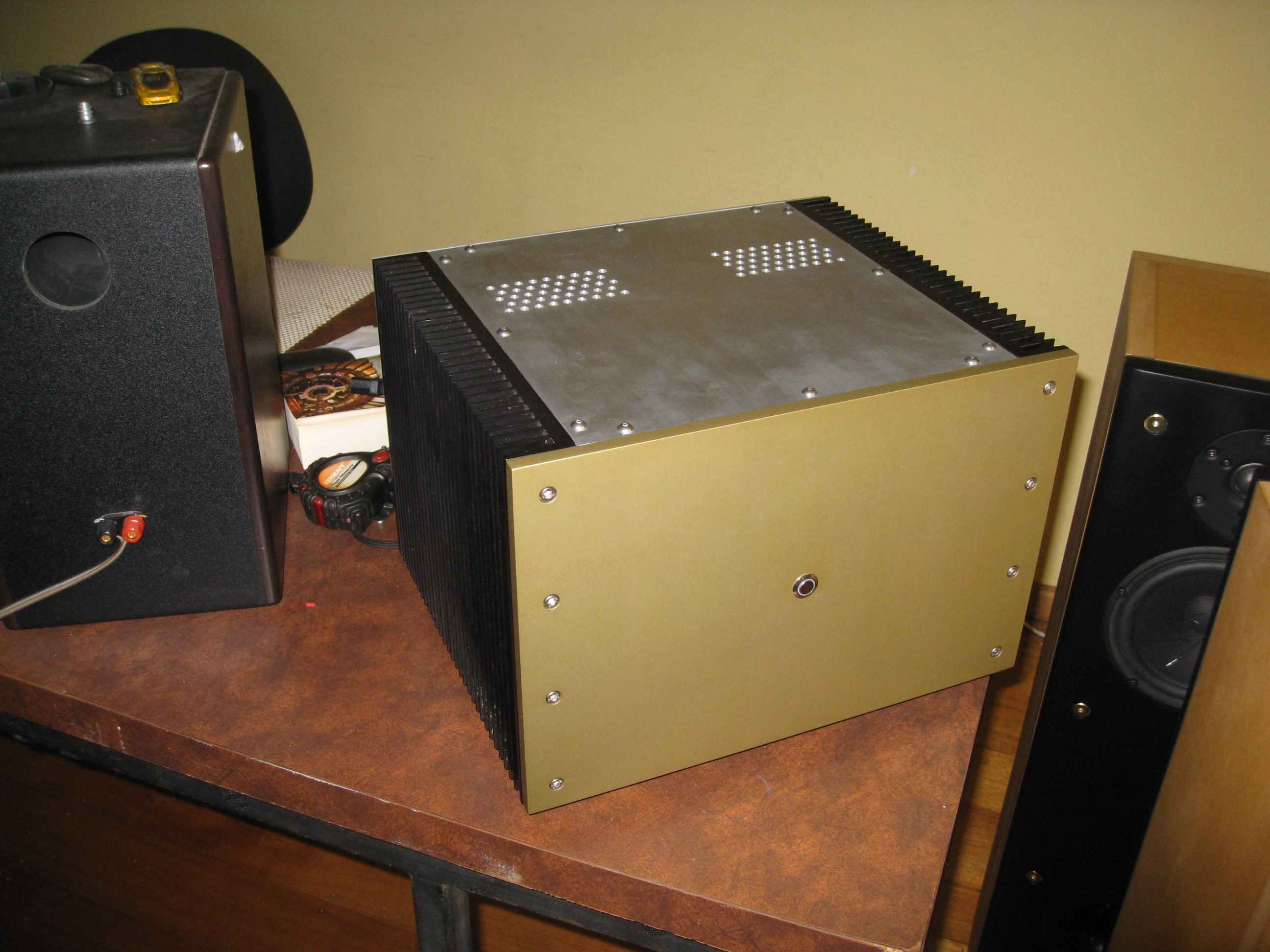

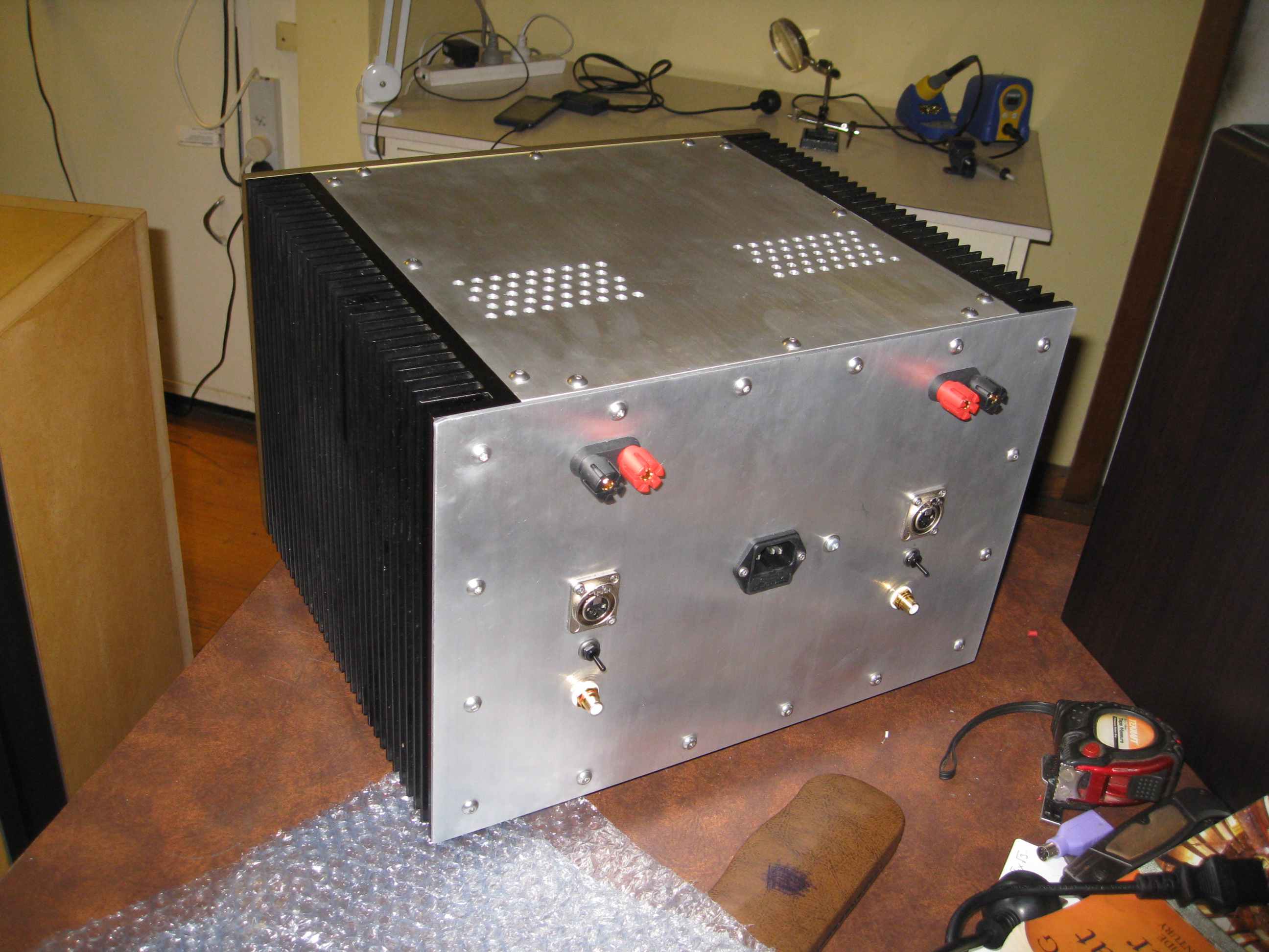

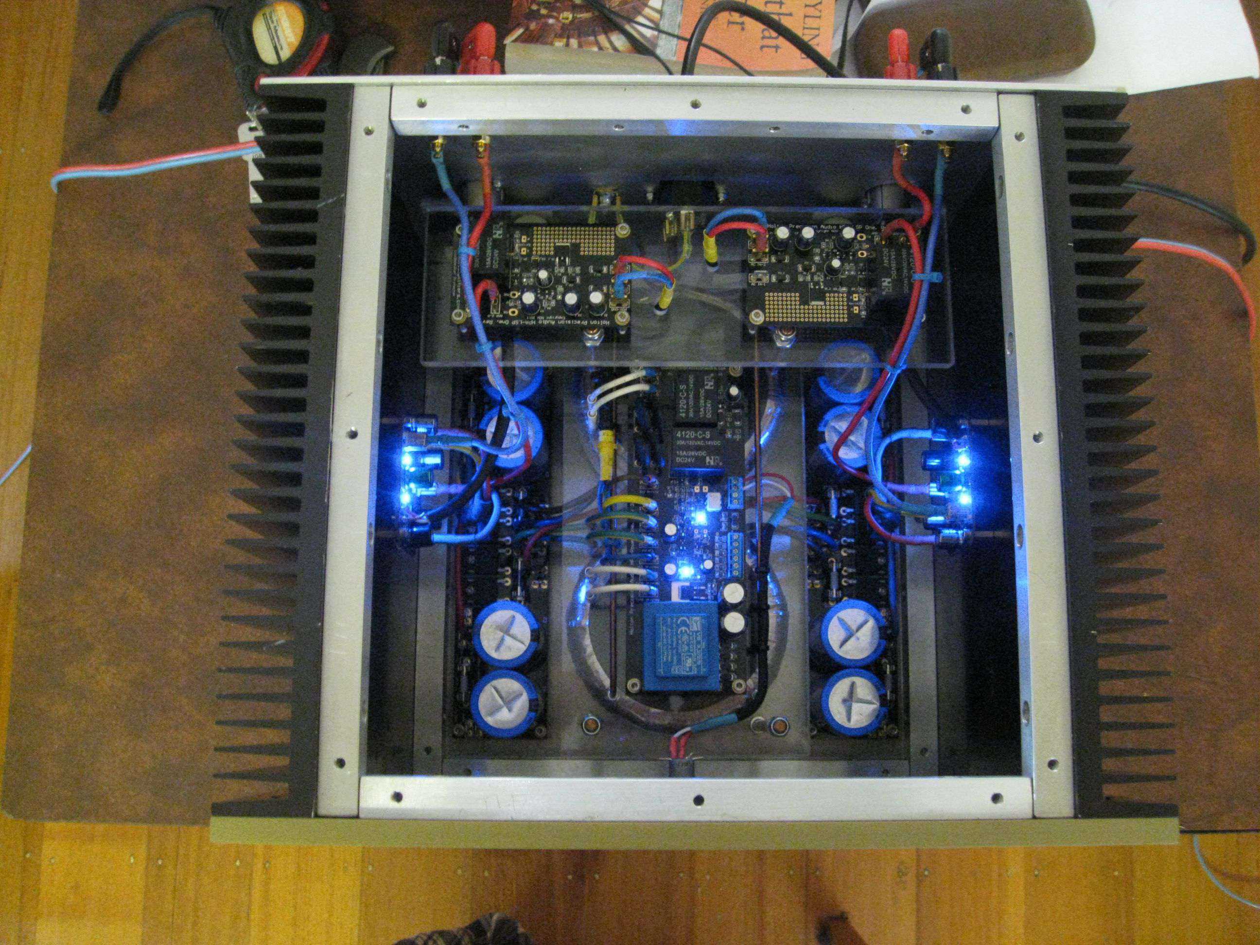

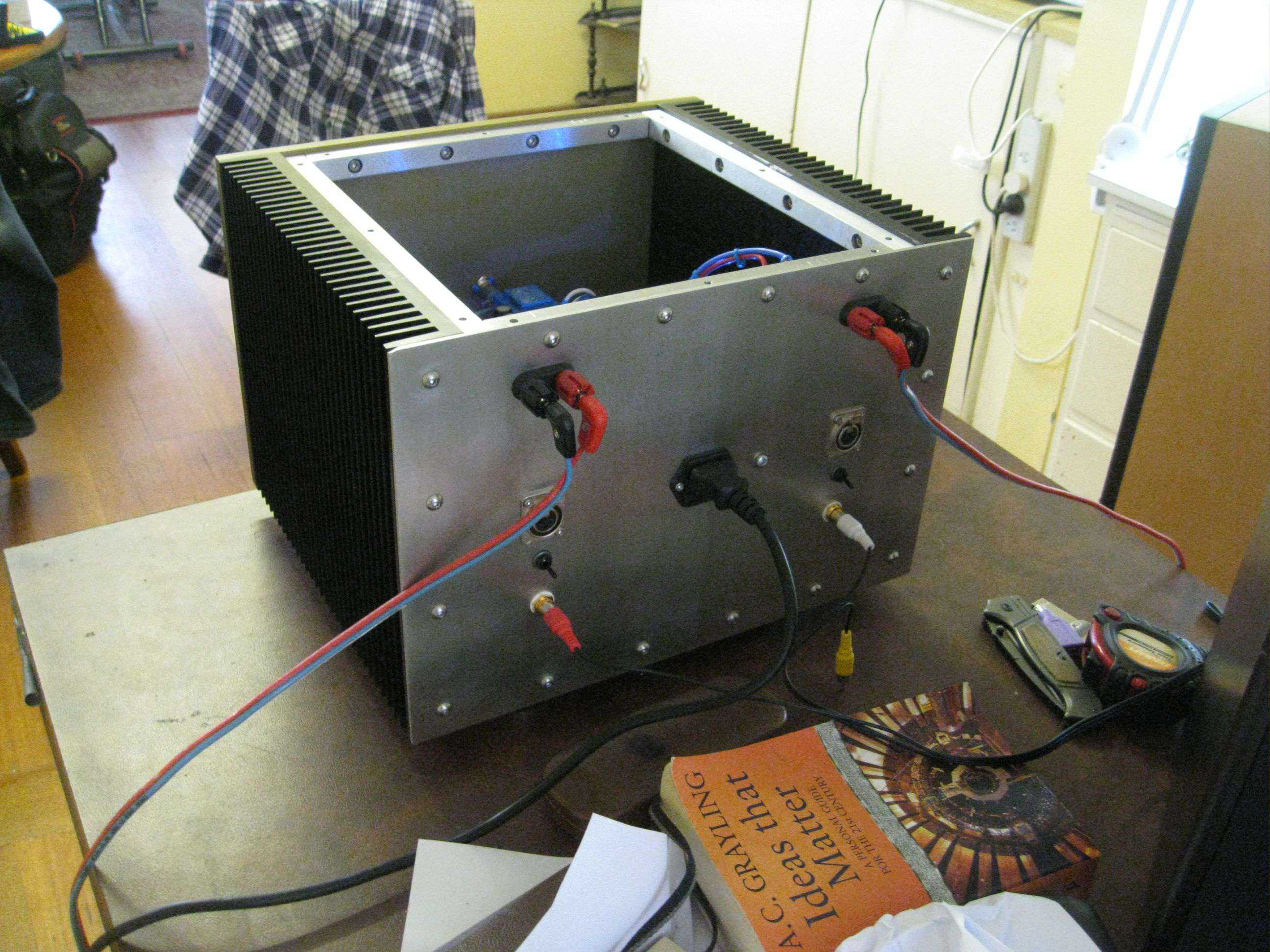

here are some photos of my first amp built up around some old heat sinks that were being thrown out at work - a work colleague brought them to my attention and that's when I decided to pull the pin and do an amp and speakers..
The amp modules are NXV200L R4 from Anthony Holton in Tasmania together with AC controller and LSPs. Overkill heat sink for the modules but I wanted to build an enclosure that can be used again for more powerful dual monoblock builds.
The layered look is just repurposing of clear polycarbonate sheet I purchased to build a circle jig for the speakers - ended up getting a perfect circle from the U.S. (which really hurts in Oz with the exchange rate) but is a great jig that I adapted for my makita. I fitted them with threaded copper rod and also put in some cable management lacing type bars...I might develop that technique because I think it looks OK.
The amp sounds great with the Zaph ZRTs I built which are elsewhere on this site...burning it all in now...the ideas and tips on this website are much appreciated.
This is where I come to learn.

Nice work! That chassis would be perfect for my next build.

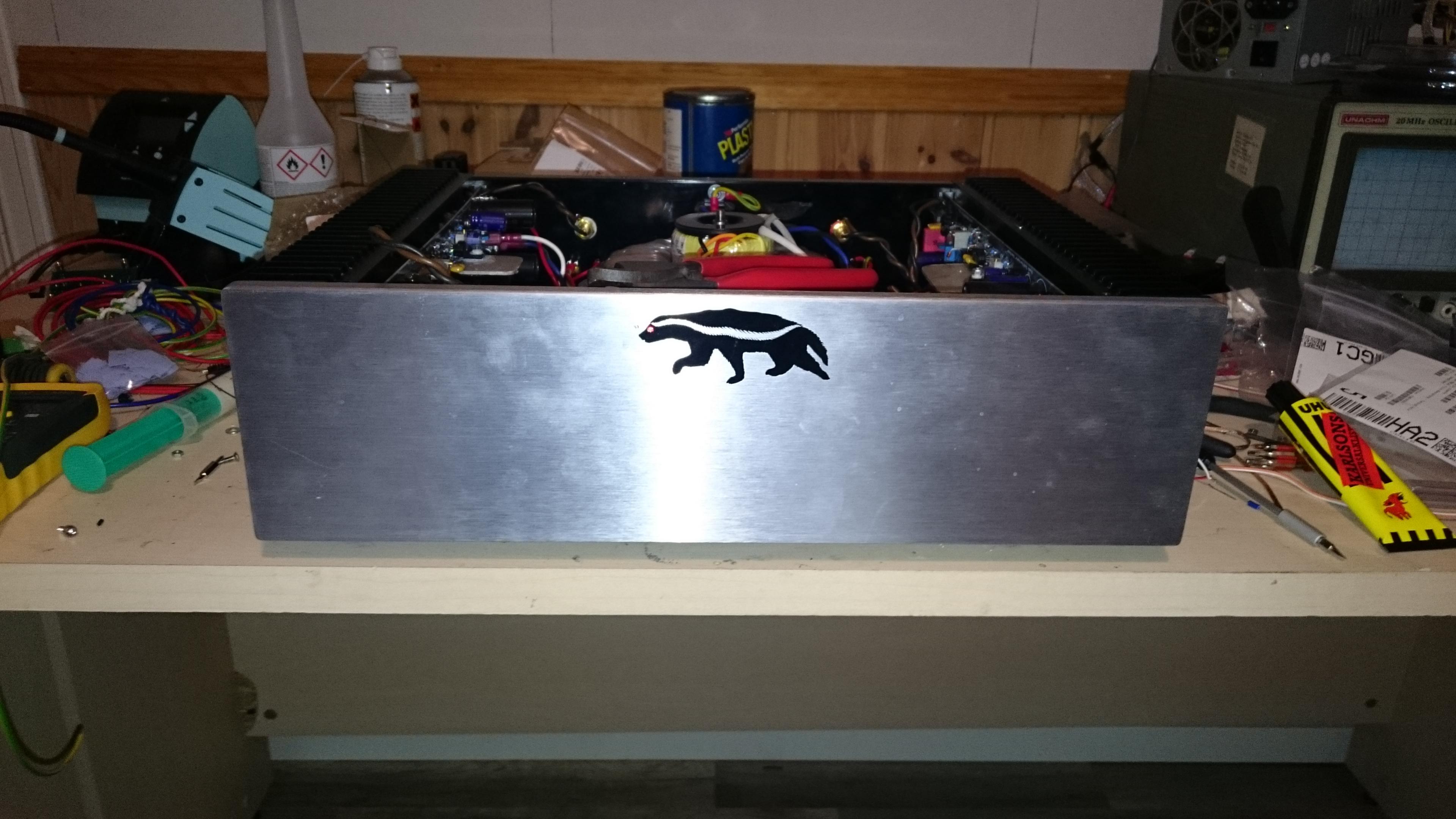

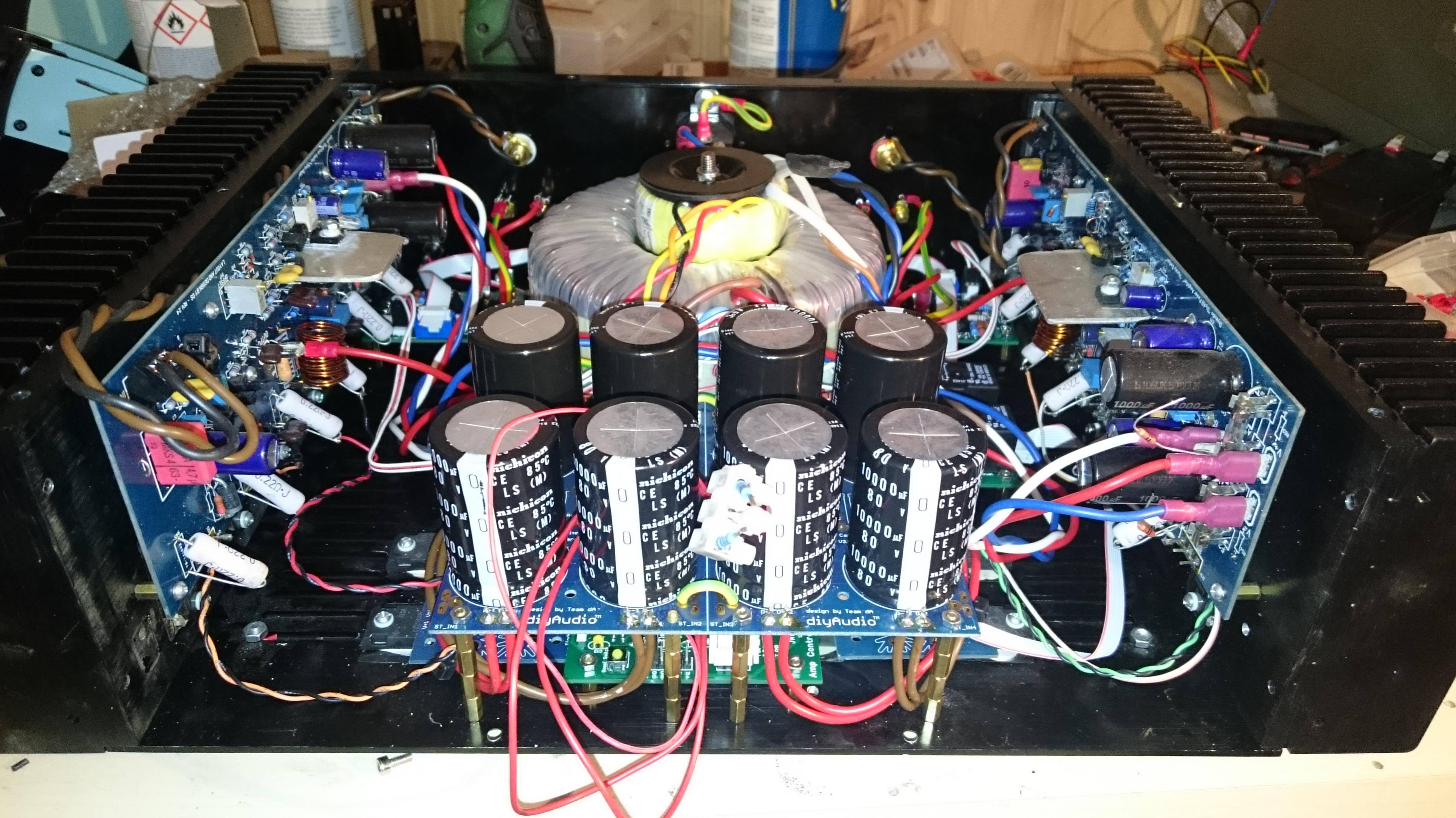

Just finished rebuilding my HB today after I tore it apart to install the 21st century protection boards.
The front panel led shows red for standby, amber during startup and green when the speakers are connected.
Alarms are flashing in various combinations of red, amber and green.
