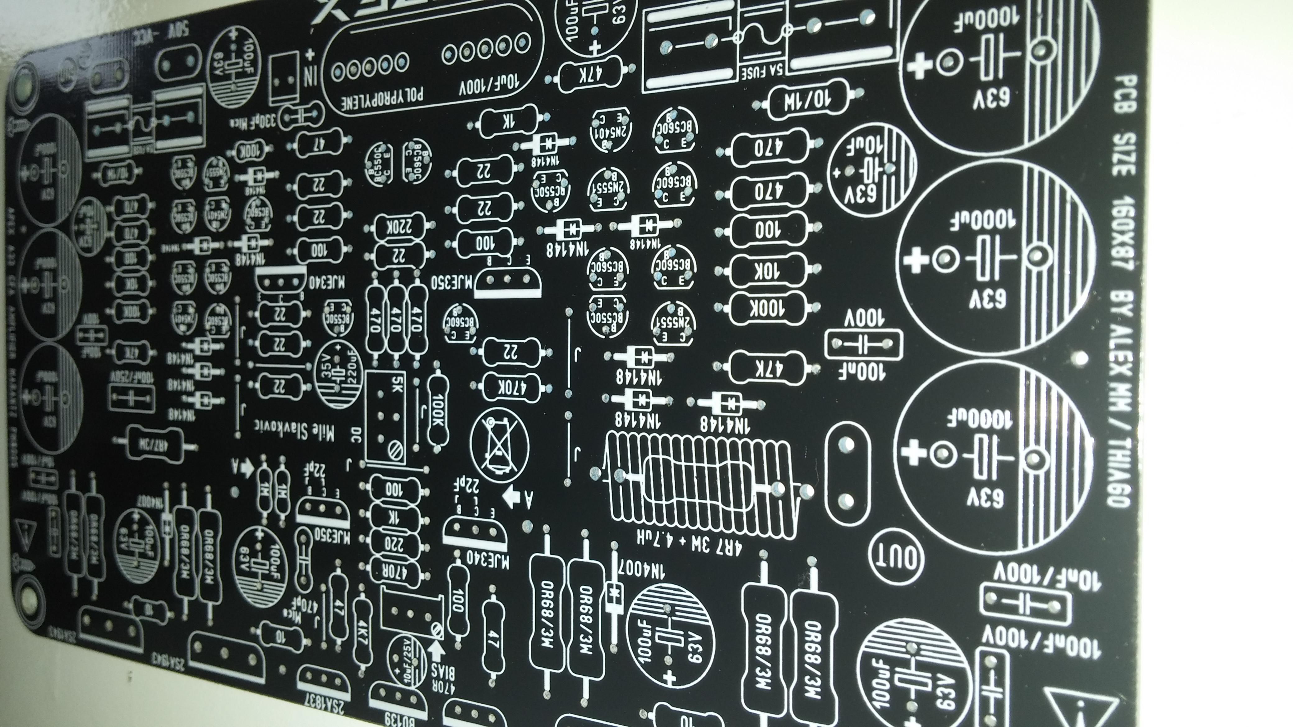

It seams they are familiar to me ..... BTW very good sounding amplifier .
Regards,Alex
Credits Alex MM and Mr. Mile.

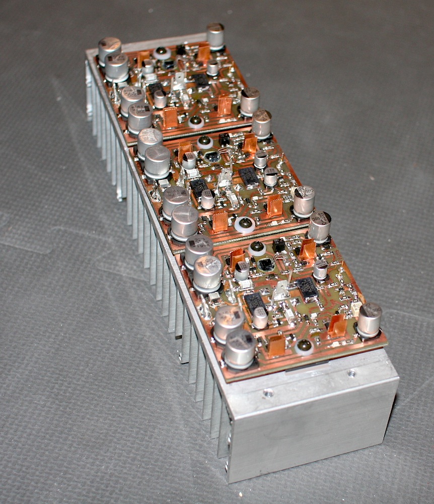

Simple amplifier design by me It called Emprit Amplifier.
Heatsink is undersize but only for testing.
Some of my friends built it and they like it verry much.
emprit bravo....

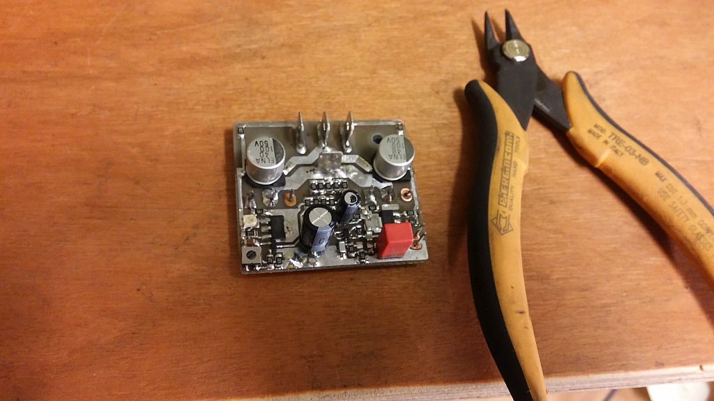

Only a few semiconductors in audio path. Current feedback, CFP input pair, simple VAS stage + latFET output. For now supplied +/-44V drives 4R load very nice. Dominant second harmonic, very smooth top end. Need only a spare time to upgrade the board a bit.

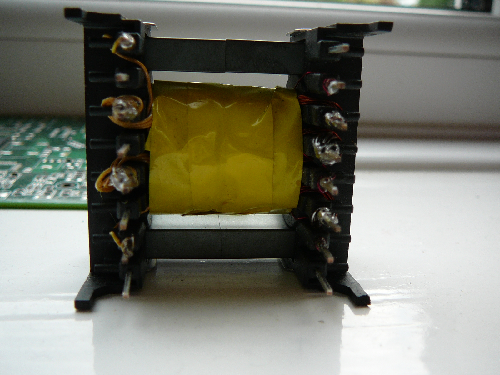

125Khz ETD34 400/800W half-bridge 60-0-60V from 240VAC input transformer with aux winding for control and 15-0-15V aux output winding. Constructed using TIW wire to avoid creepage and clearance problems and REDUCE leakage inductance, most windings are home made Litz. Presently under test and working ok, yes the fill fector could be higher but in a prototype better to have underfill than overfill.
