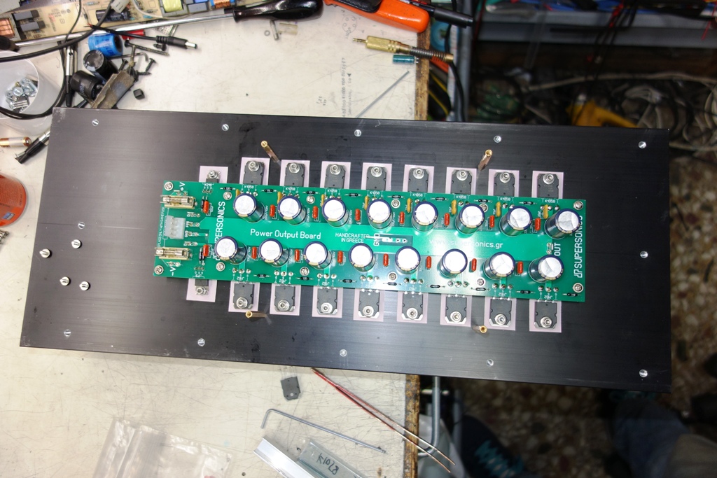

What are your temp readings top and bottom of the sink, or more importantly, the temps at the area where your outputs bolt to the heat sink?
This kind of configuration makes it difficult to get an even temp on all output devices if your running a high bias?

thanks awverk
amp hasn't powered up yet
but
thermal consideration took in mind when designing
as you can see output devices are spread as far away as possible between them,and asymmetrically to the heatsink(more near to the bottom as the heat spreading to the top and the output air is colder at the bottom of the heatsink
mosfets will rapidly dissipate heat thanks to keratherm reds
so I think that thermal difference between top and bottom will be minimal
and yes bias is high( first 25W@class A operation)

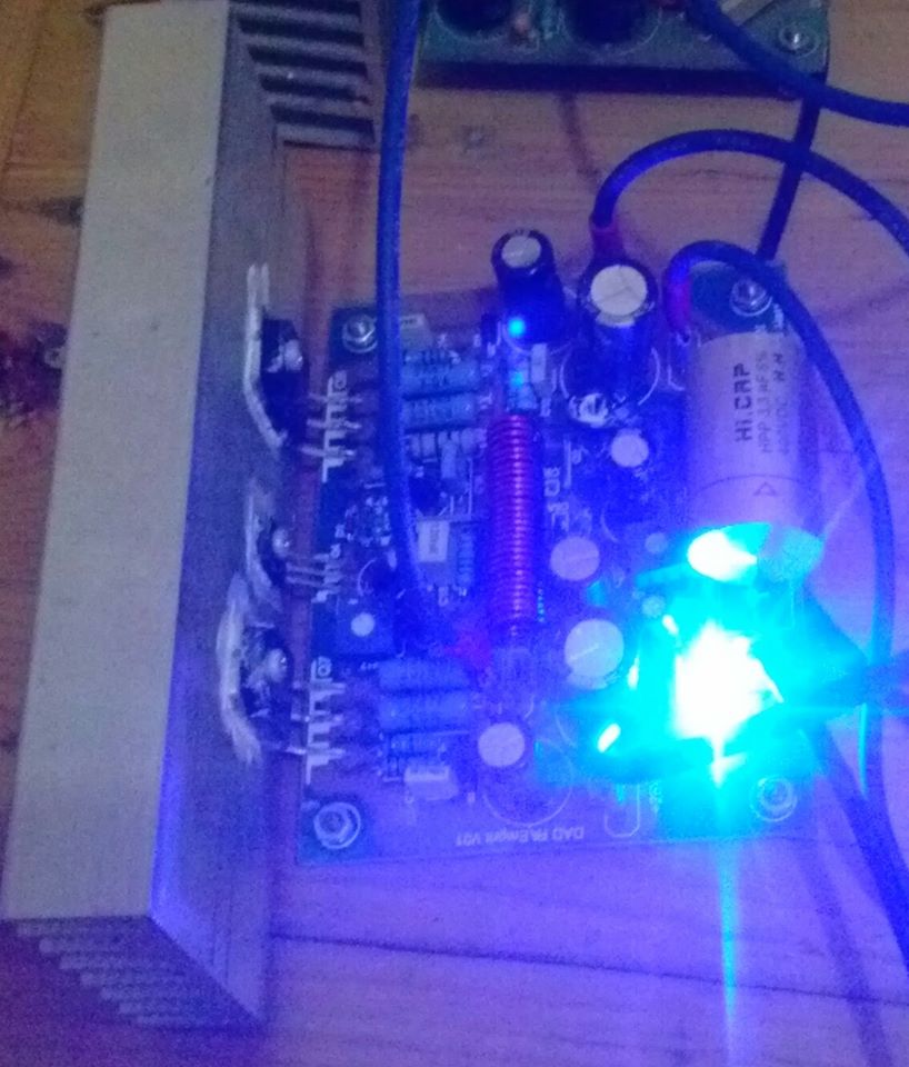

A few pics of my most recent build which is a Colin J Wonfor(Incatech; Magnum;Tellurium Q designer) little class A amp the sound quality of which I am blown away by. The amp was first built with the basic amp board and a single supply for both channels before going dual mono and adding in the regulated tracking power supply which made a very worthwhile lift in sound.This is single ended class A amp which outputs about 14 watts but sounds far more powerful.

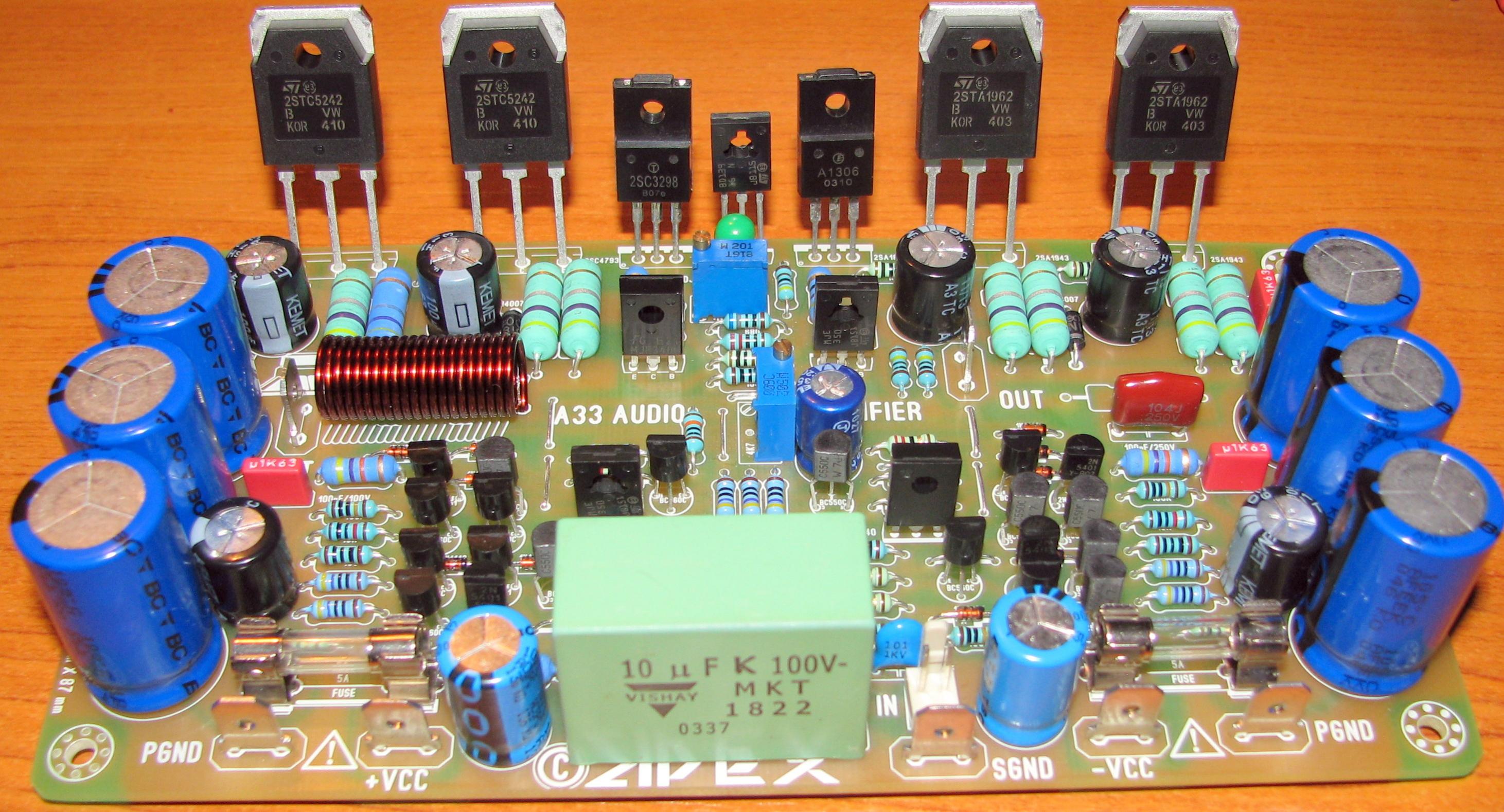

It seams they are familiar to me ..... BTW very good sounding amplifier .APEX A33
Regards,Alex
Made in Brazil!It seams they are familiar to me .....

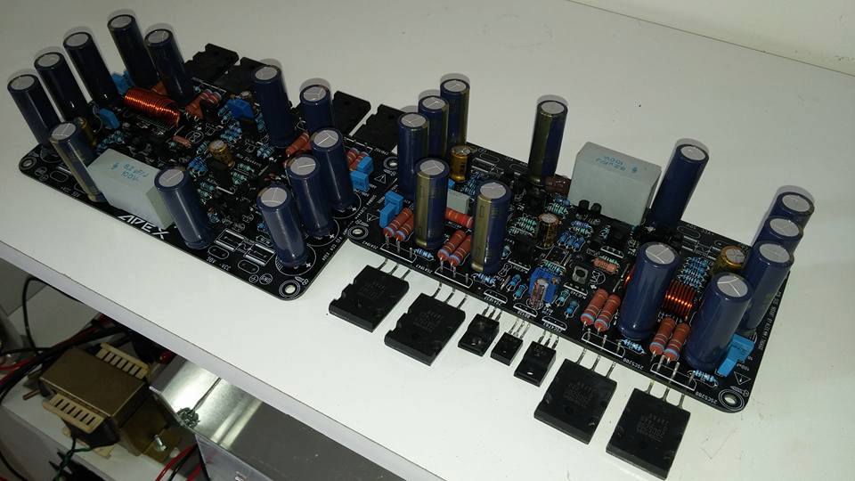

Emprit Amplifier
Simple amplifier design by me It called Emprit Amplifier.
Heatsink is undersize but only for testing.
Some of my friends built it and they like it verry much.
