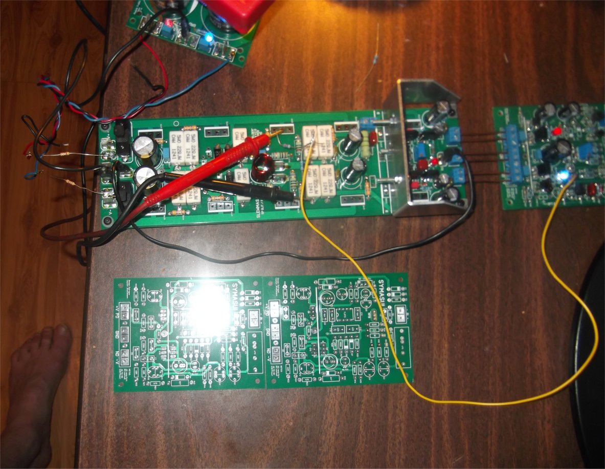

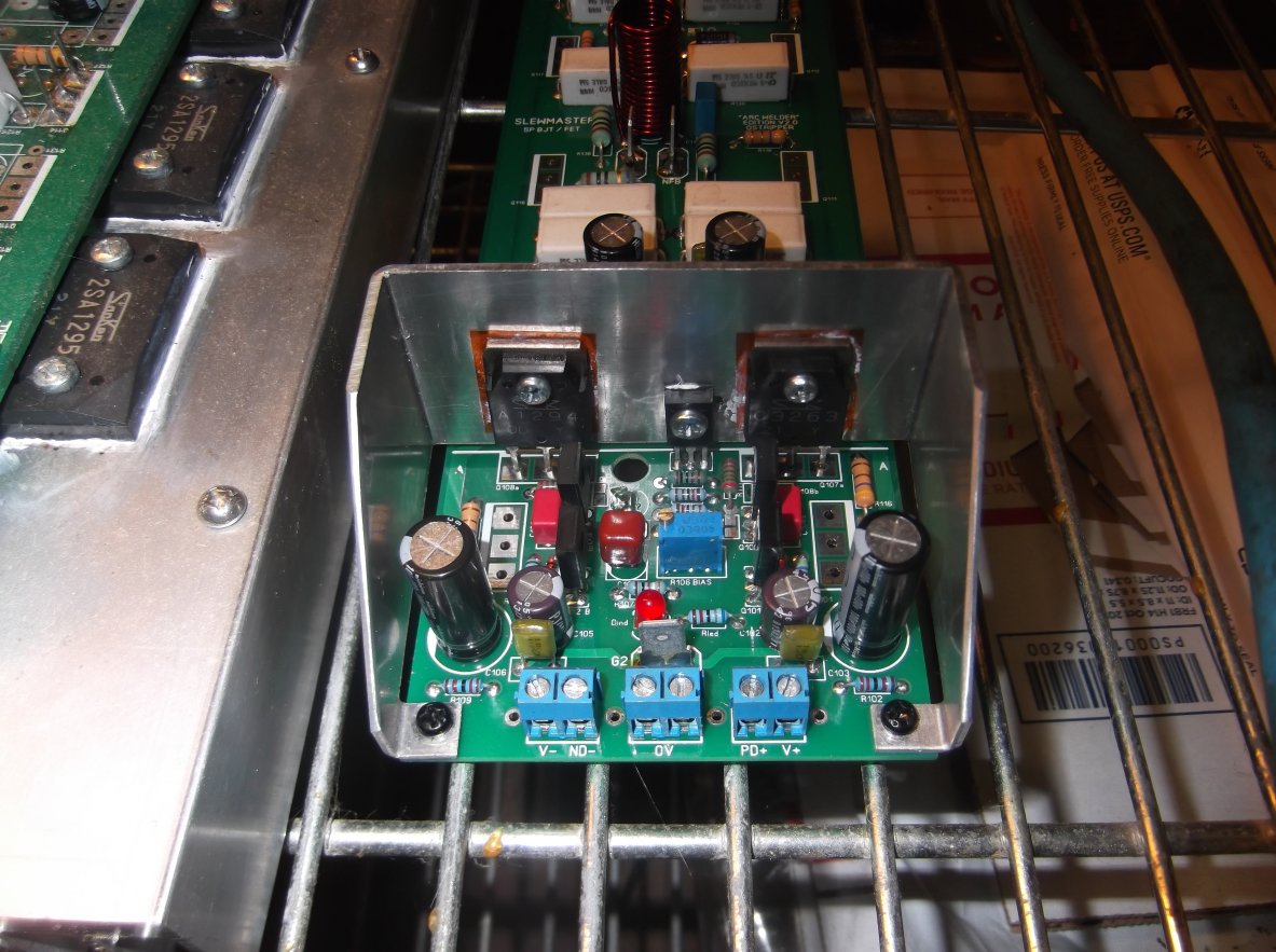

I have the new symasym (below small board), chris. Same compensation options but
with a servo and "fancy" cascoded wilson CM VAS.
This sym loves to belt out 140V p-p waveforms.
(below - big board) is the {new} V3 slewmaster EF3 , able to handle 5 pair ! MT-200
sanken output devices. The 30ma / per turn was with IRFP240/9240 , the new
boards can also use 5 pair of them (by popular demand).
I'm more conservative , just 5 pair MT-100's for me :D.
The OPS I have now does 10ma per turn , set it at 60ma 180 days ago , just
measured 59ma (it's a lot hotter now 38C in tennessee).

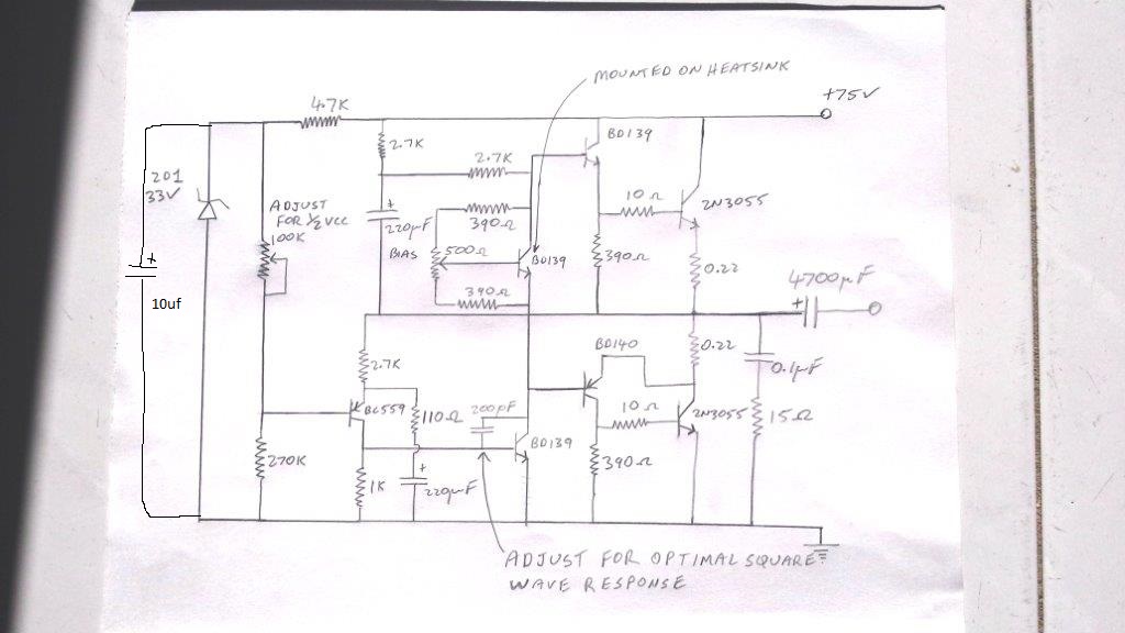

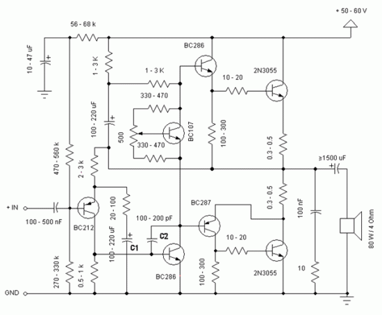

2N3055 Amplifier
Hi all. I built an amplifier based on 2N3055. I wanted to use 2N3055 transistors as I have a swag of them in TO3 form. I used this CCT below with some minor changes. I am also running it at +75 volts single supply rail. I wanted to use both NPN output transistors so this is why I used this CCT with a single supply rail. And also its simplicity! All other transistors are BD139/BD140 except the front small signal gain stage which is a BC559c. The amplifier works quite well with a continuous output of 50 watts RMS into 8 ohms and over 65 watts into 4ohms. Gain is set at 27db. For such a simple CCT I managed to get a distortion reading of about 0.07% at 50 watts RMS and down to 0.05% at all other power levels tested at 100, 1k and 10kHz frequencies . Here are some pics. Please note. I found this CCT on the web.The hand drawn CCT is mine. So I do not take any credit for it.
Regards
Billy D...

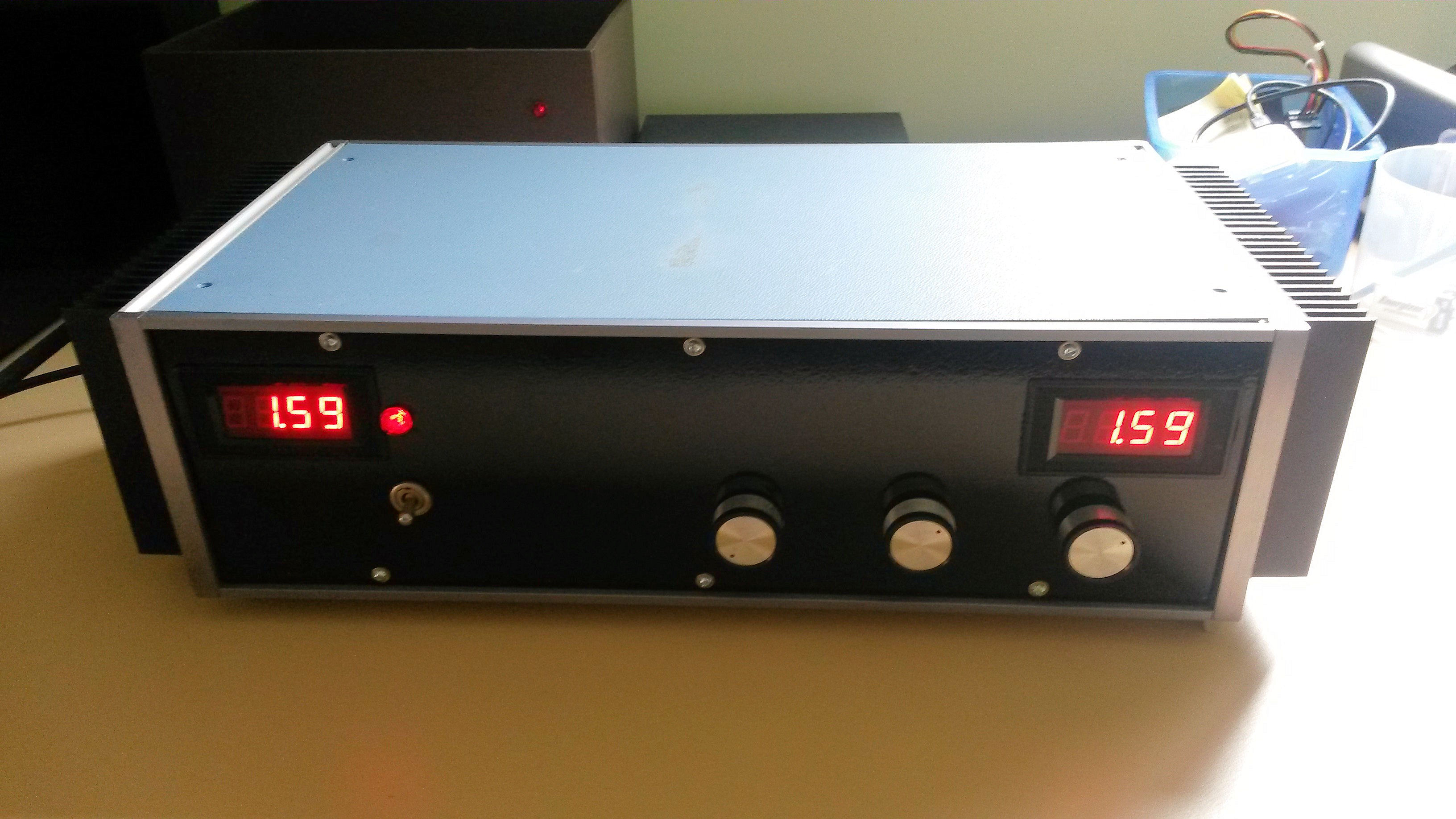

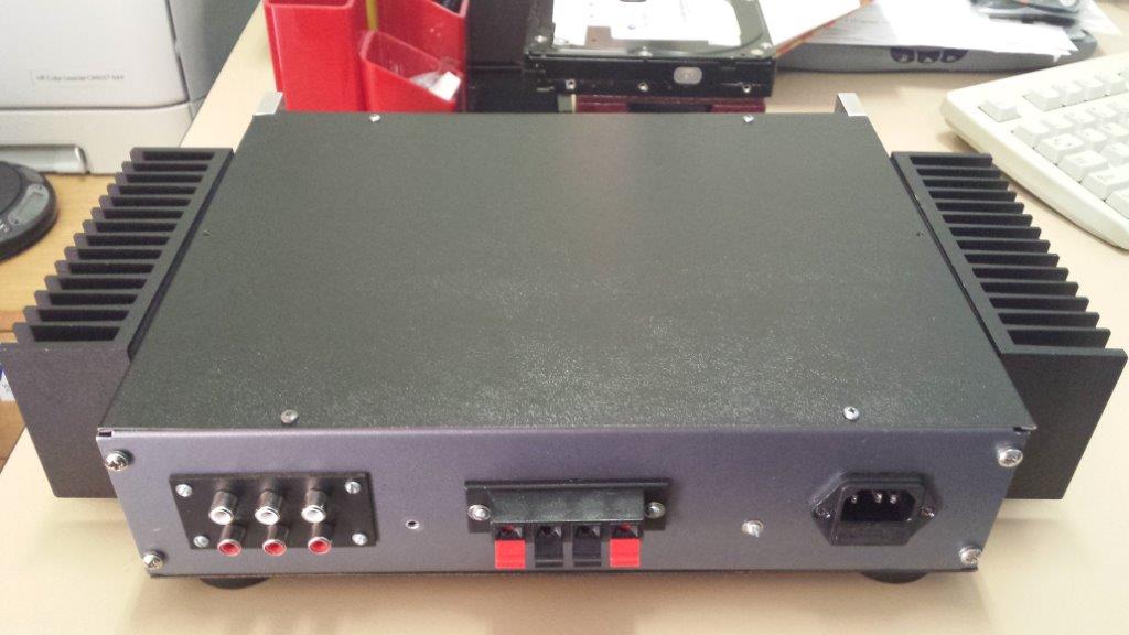

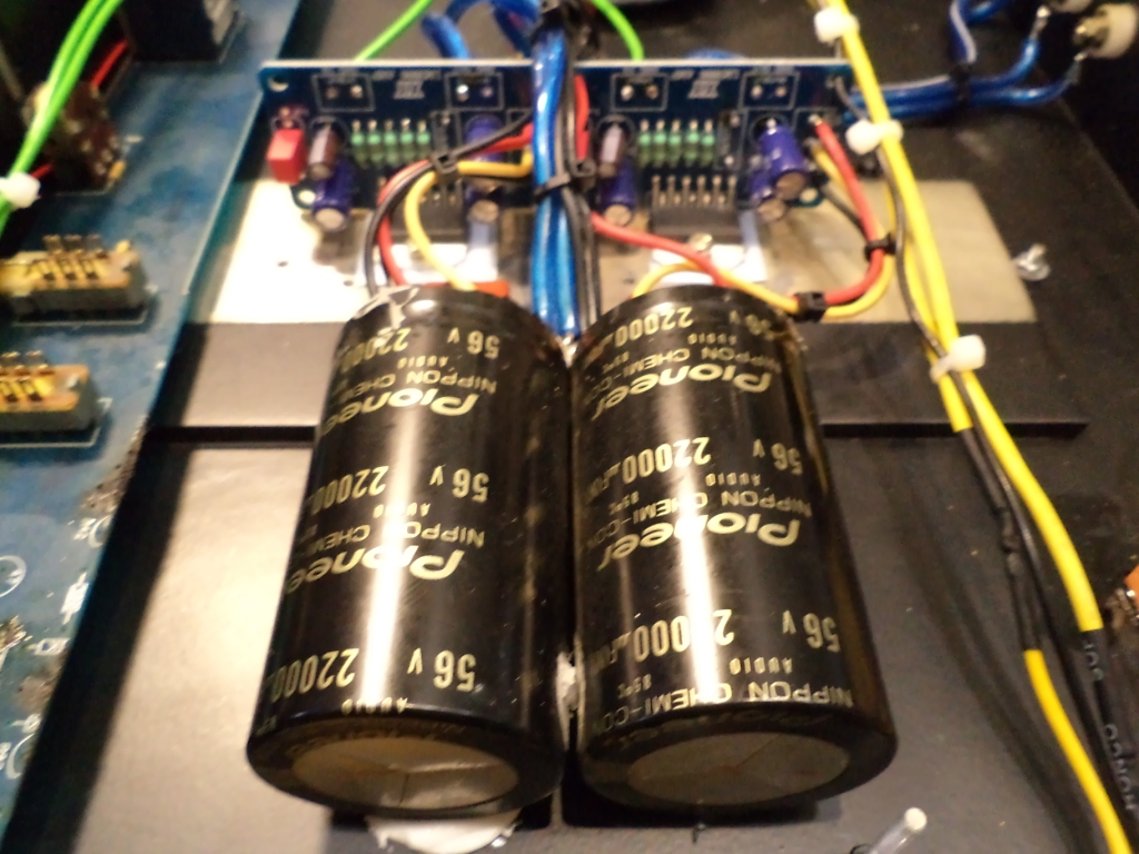

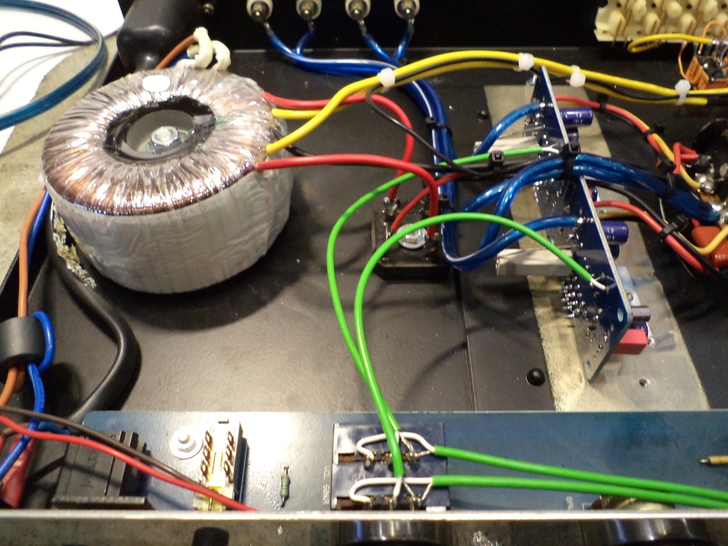

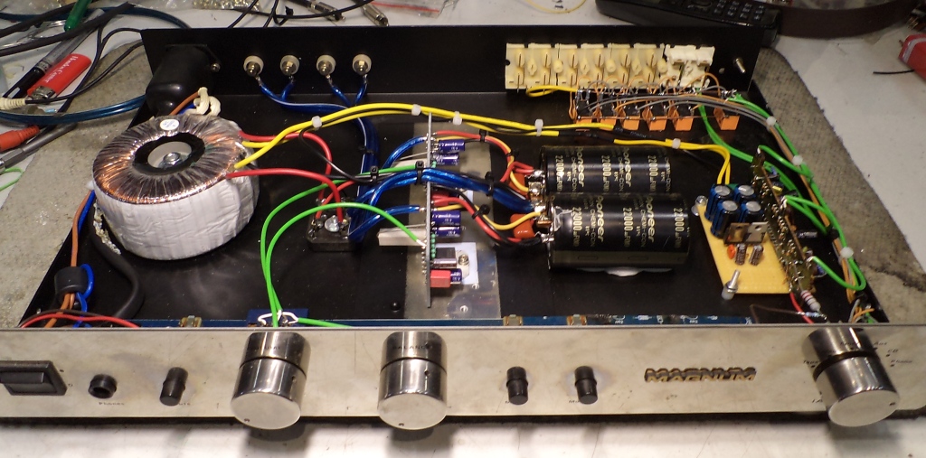

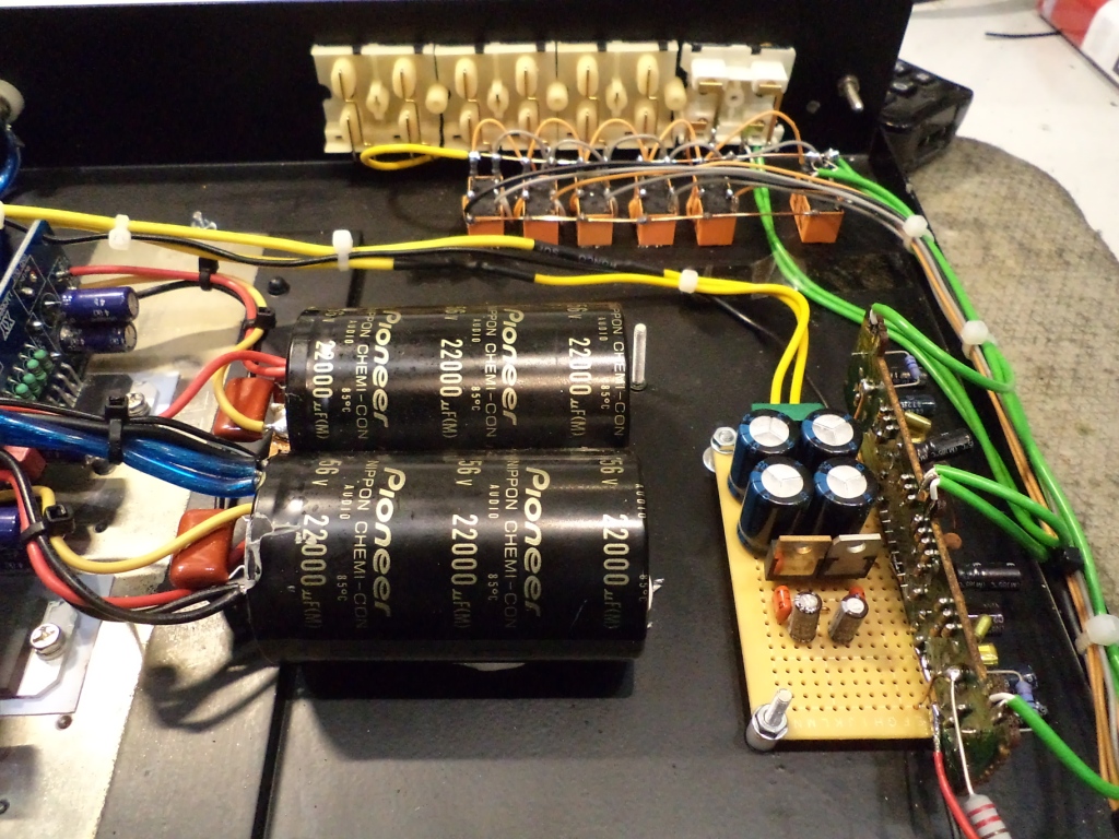

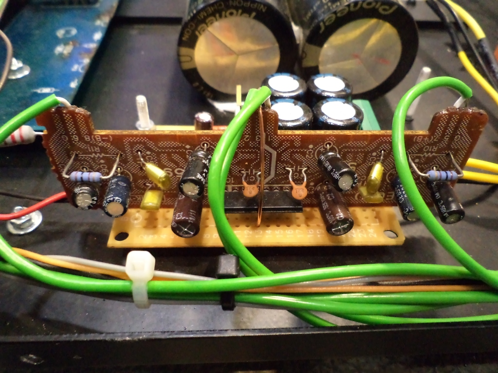

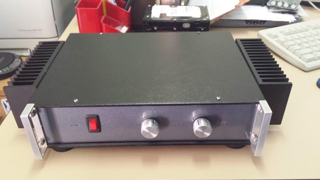

Surplus Magnum
Magnum IA 170 burned beyond repair as usual but i got to keep the enclosure for a few euro
So i made a surplus model
case burned magnum
Trafo from a broken DB technologies active monitor
Caps /relays from burned 7+1 Pioneer ( beyond ..any repair )
Pot from a Luxman surplus amplifier
LM 3886 x 2 from surplus Behringer monitor
Phono stage from broken Sansui A700
3 hours to make ....plays fine for a 3886 thingy

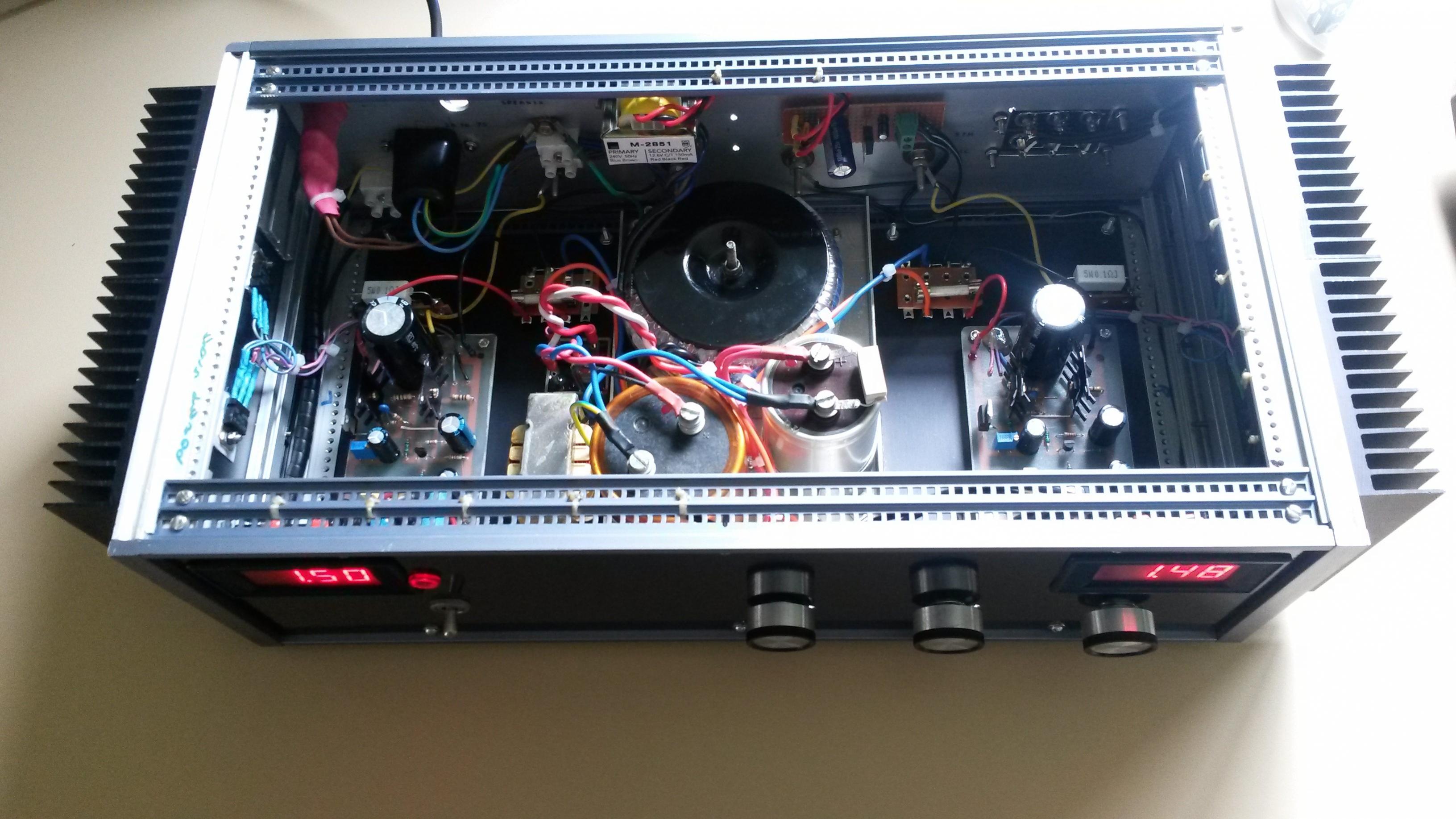

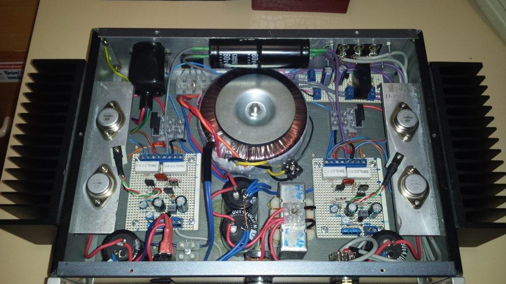

Addition to my class A amplifier
Pure class A based on the "death of zen " 54 watts dissipation for 15 watts rms output into 8 ohms per channel. I have incorporated a pre amplifier made of miniature 6418 tubes which runs off the same power supply via a regulator. I found I did not have enough gain due to the amplifiers slightly lower than usual gain and also the passive balance control which i included which I lost much more gain than anticipated, so I made up this pre amp. The amplifier sounds more lively with plenty of volume. I have set the gain to 26dB. Incredibly the hum and noise is practically zero with proper routing of the power cables. Panel meters do not affect the amplifier at all with noise etc. I could of made a descrete solid state or even an op amp pre amp but I thought I would make a little different since I have some of these little tubes in my parts bin.
Regards
Billy D...

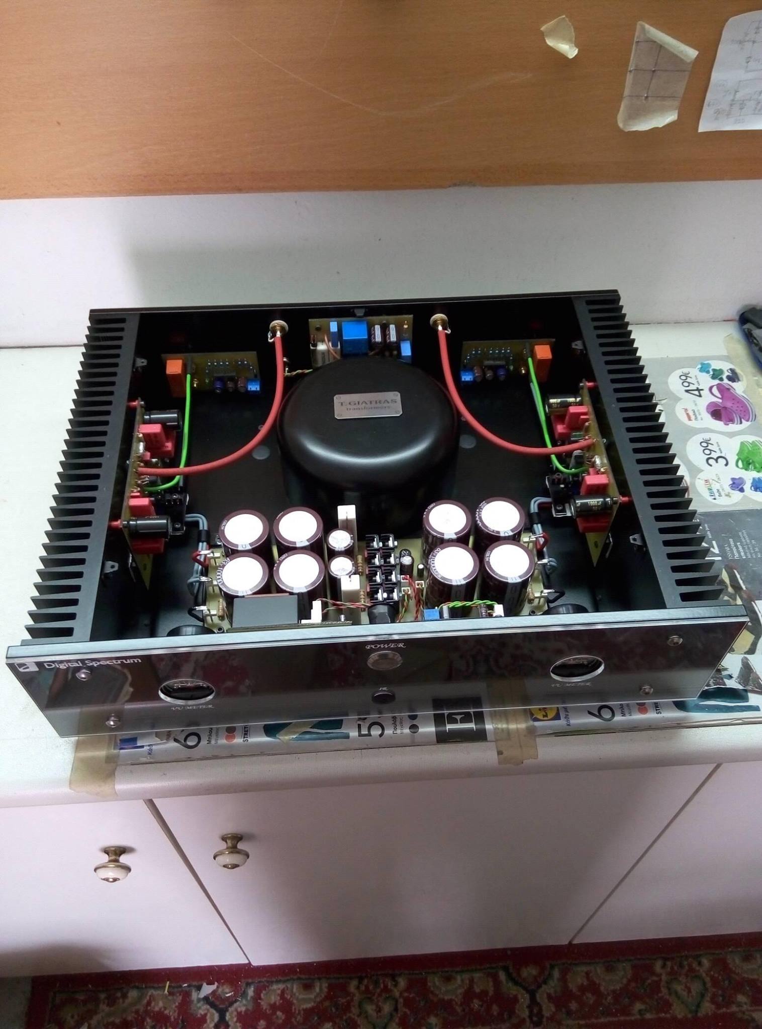

So proud to present one amplifier P3A that is made from a friend under my guidance PCB is made in cooperation , and in total amplifier features 8x10.000 ufd fast rectifiers slow start shielded transformer 500va analog VU meters with logarithmic drive and DC protection
Detailed pictures to come in the feature
So proud for "my boy "
Looks great, shame you didn't have twins :)
