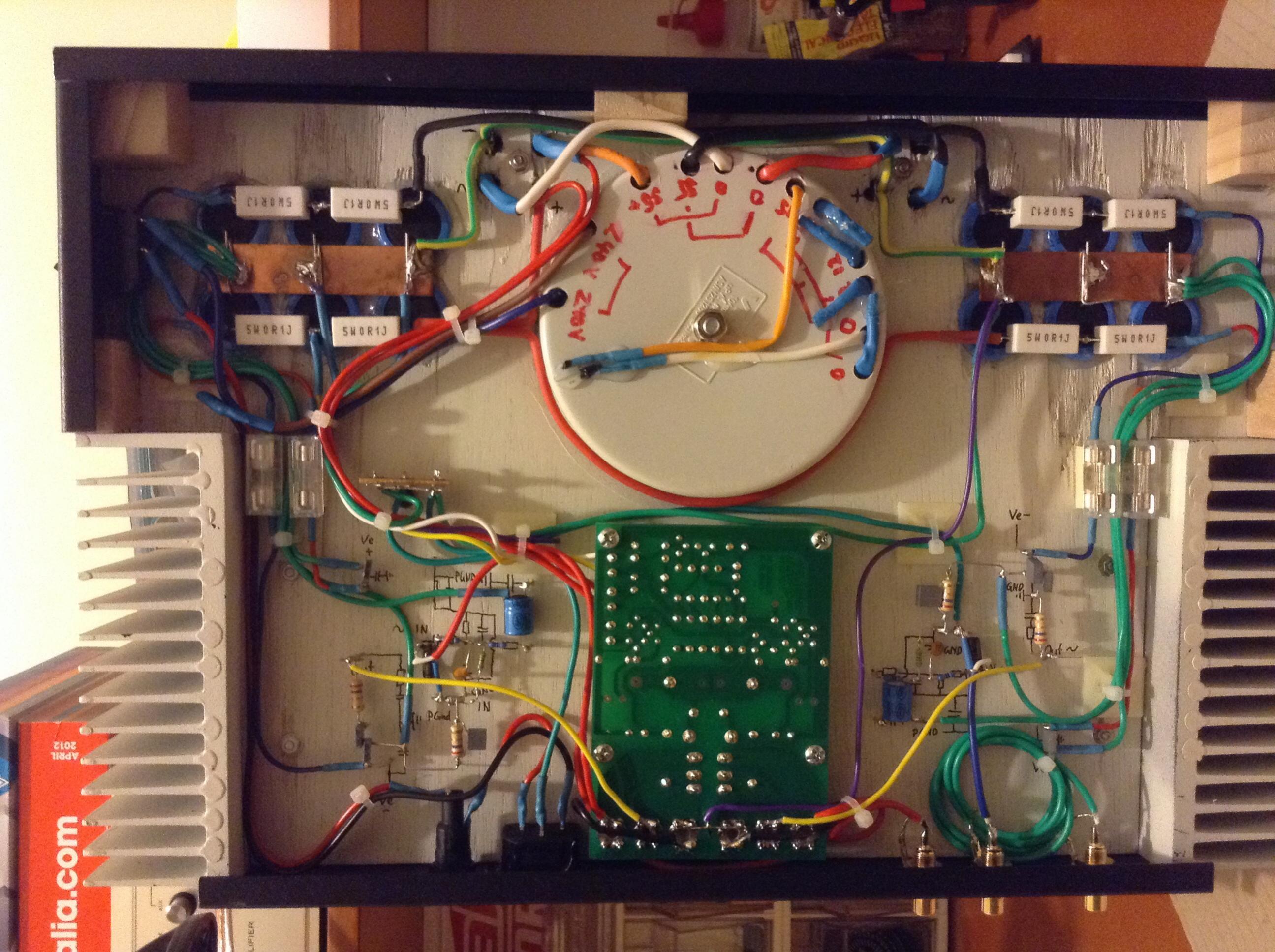

Lateral MOSFET Power amp based on Rod Elliot's p101.
Aa you might have noticed (from past project as well) I am not fond of black boxes.

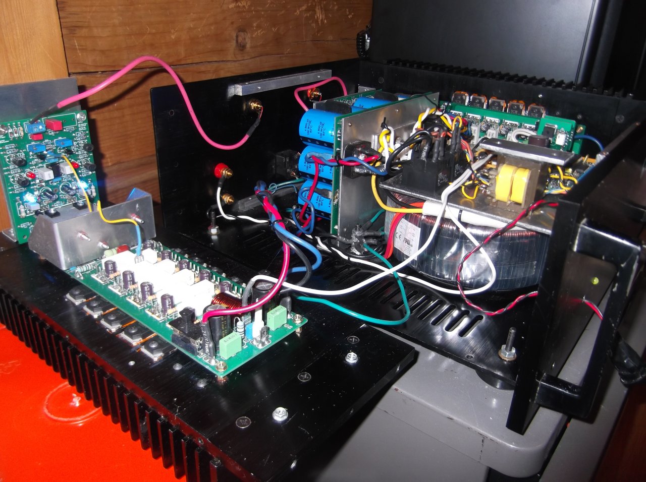

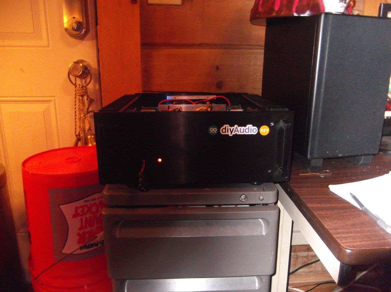

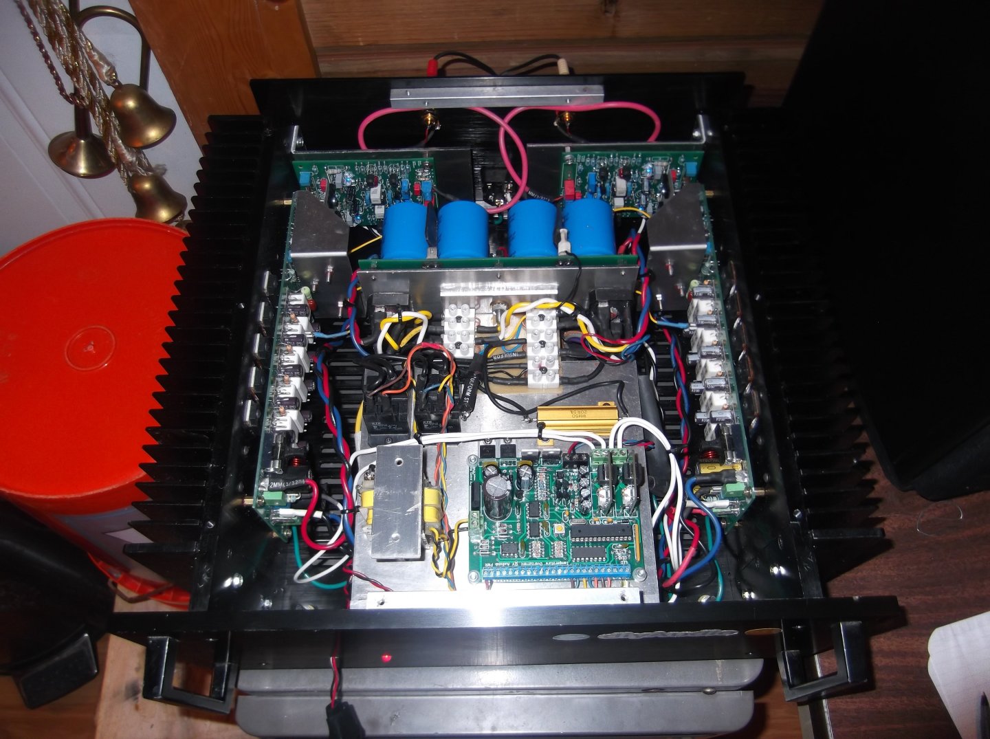

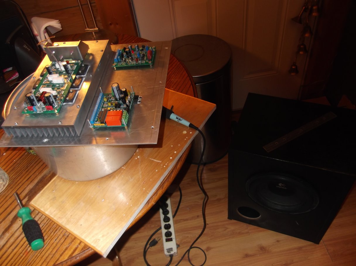

Finally got the "beast" fully done ...
Screwed up on my first build post - outputs to one side and a control board
that took up too much space.
(attachment 1) - "guts"
Grounding with a 35A bridge ground loop breaker - most silent amp I ever heard.
(attachment 2) - Full top view
That smaller AC/inrush/ speaker protection PCB allowed for ALL the "dirty"
works to be right over the trafo. SS relays are front right with the white wires
(amp outputs) - Infineon 180A units X 2.
(attachment 3) - front view
Not too big - about the same as the H/K680 it replaced but weighs 25KG !!
Listening impressions - the Harmon 680 is audibly inferior and definitely dynamically
inferior. My pioneer SX series classic amp is a joke (barn amp now) .
The only amp that comes close is the HK990 , but this even has a bit more
"grunt" than even that did.
I repaired a 990 but could never afford one - now I have something that actually
beats it ! DIY rules !!

Are all the thermal issues solved now?
I can hook 2 pair speakers parallel and shake the house all day - just warm...
but not too hot to touch (50C?) . Outputs ALL stay 14-16mv (60+ma), no
matter what I do .
ALL issues solved - very well behaved.
PS - the Chinese extrusions seem to have slightly less conductivity than pure
"virgin" Heatsink USA extrusions. More like roadsign Al/Mg alloy.
Mount your devices right in the middle on the "recycled beercan" chinese stuff.

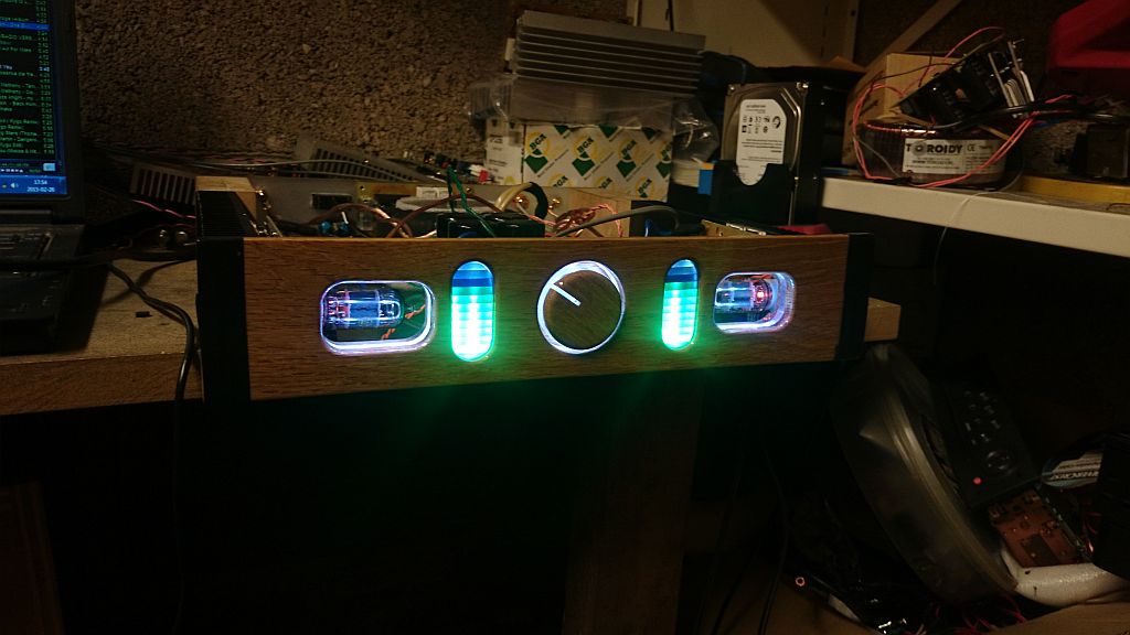

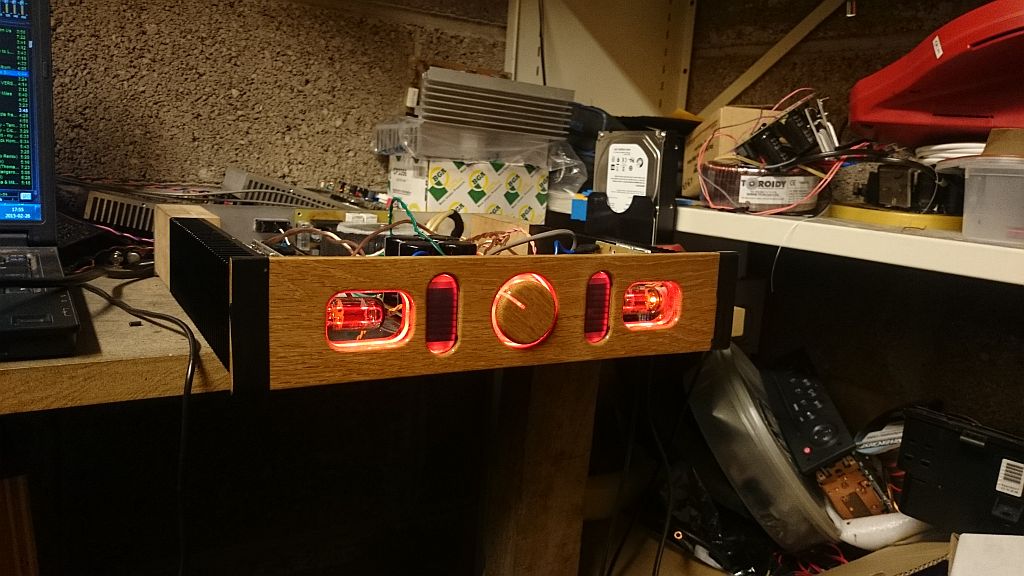

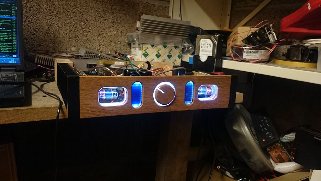

Small VSHA update, no sparks, no explosion and I am alive (huh) !!
Nearly fully furnished, just cosmetic job left..
The background light is RED when amp is heating up (protect relay OFF), after 15-20s the background light is WHITE (protect relay ON). Bargraph is based on standard LM3915 aplication.
Few phone made postcards and movie
May the force be with YOU !!
https://www.youtube.com/watch?v=9ex-W2tPhBw&feature=youtu.be
More postcards soon...
I can't guess what amp that is ! What is it ?
Looks great !
Looks great !
Thanks , I'm only beginning to unleash it's full potential.
My PC's smps was putting some garbage into it. The amp itself is
silent , but I could hear HF and some buzz. A straight PC
connection sucks !
Does not do this on my CD player ...
Temporary jensen audio trafo to isolate makes the soundstage just
get "eerie".
Ultimately , a full optical Toslink + DAC (this amp deserves it).
PS - you don't know ? Slewmonster with a leach front end (spooky).
But , tomorrow it might be another forum amp (modular) ... just plug
it in .
Edit - next "victim" is the "Beast" sub amp (below) I want that lowest
octave !!

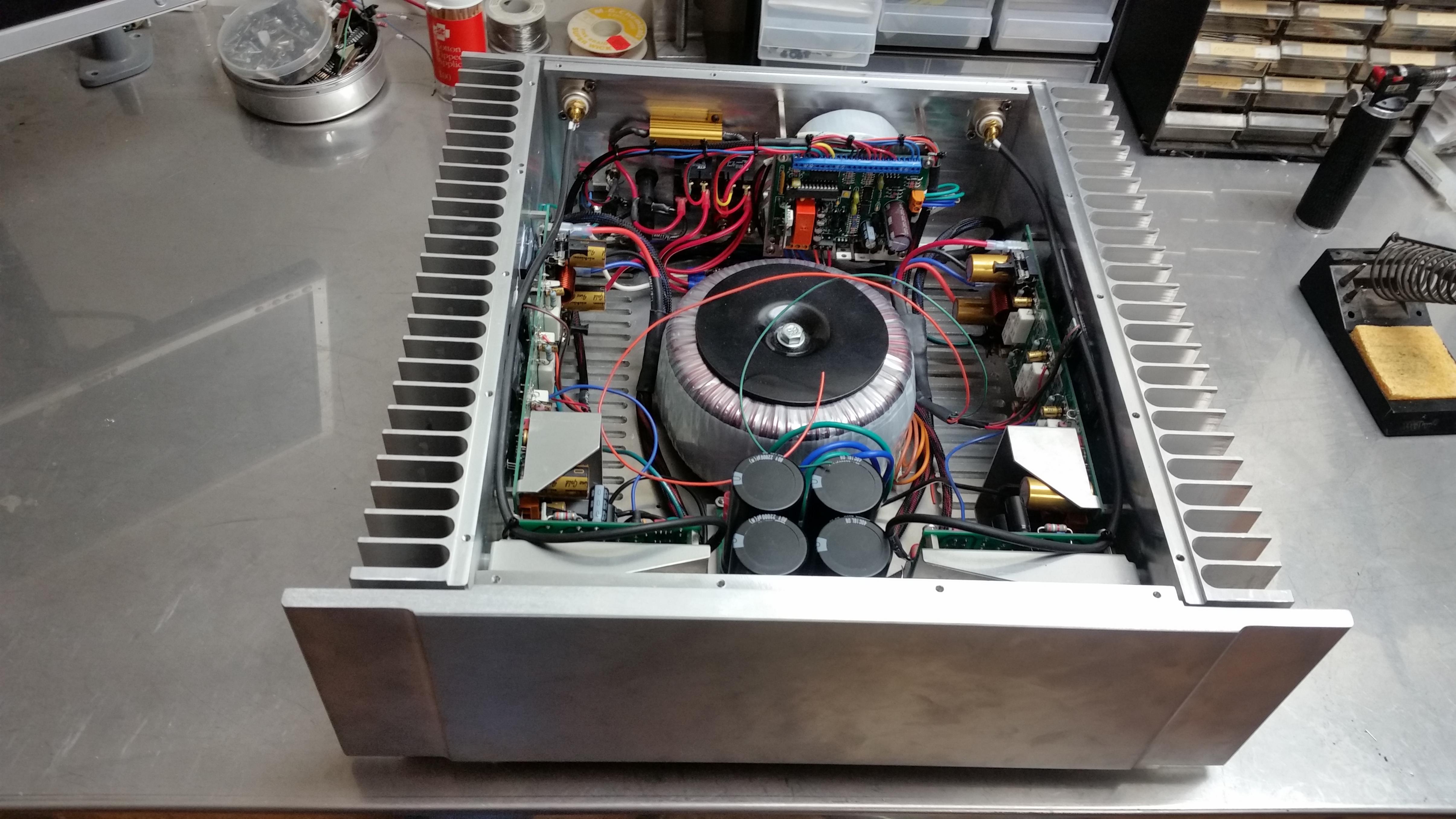

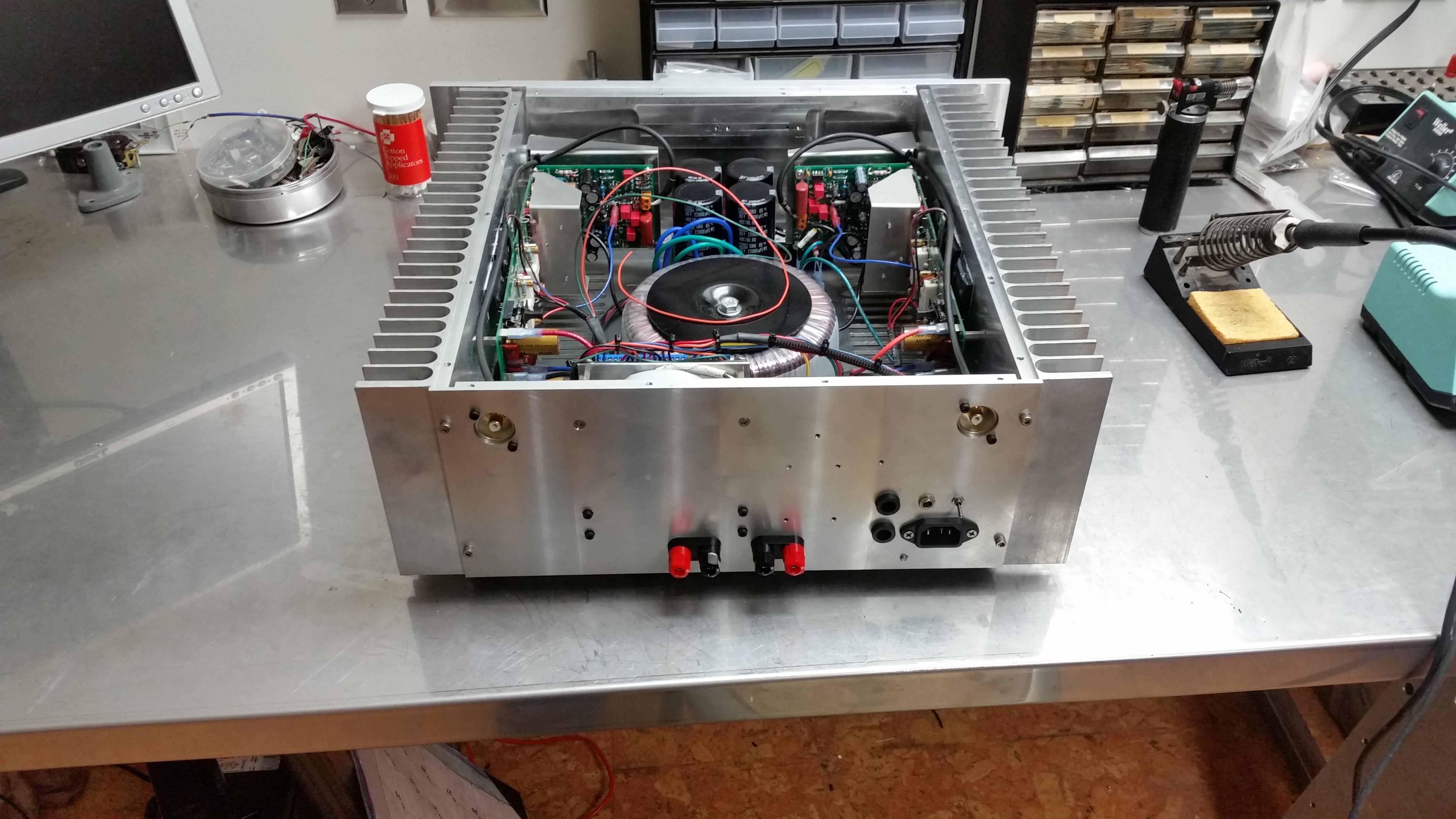

My Slewmonster is finally ready for a test run.
I knew your milling skills were impressive ... WOW
Borys - a single Vbe for a combined driver heatsink setup. Simple 2 x vbe reverse
co-efficient .... but relatively "slow"
The Slew is two separate Vbe's/heatsinks , the driver one will "second guess" the main
outputs Vbe and overcompensates the driver co-efficient until the outputs can
"catch up". HK was brilliant in this design , sort of a"poor man's thermaltrak.
I ran the big Daytons today - 1812 overture hit Xmax on the woofers - need that sub!
Dang ports are messing up my hair...
