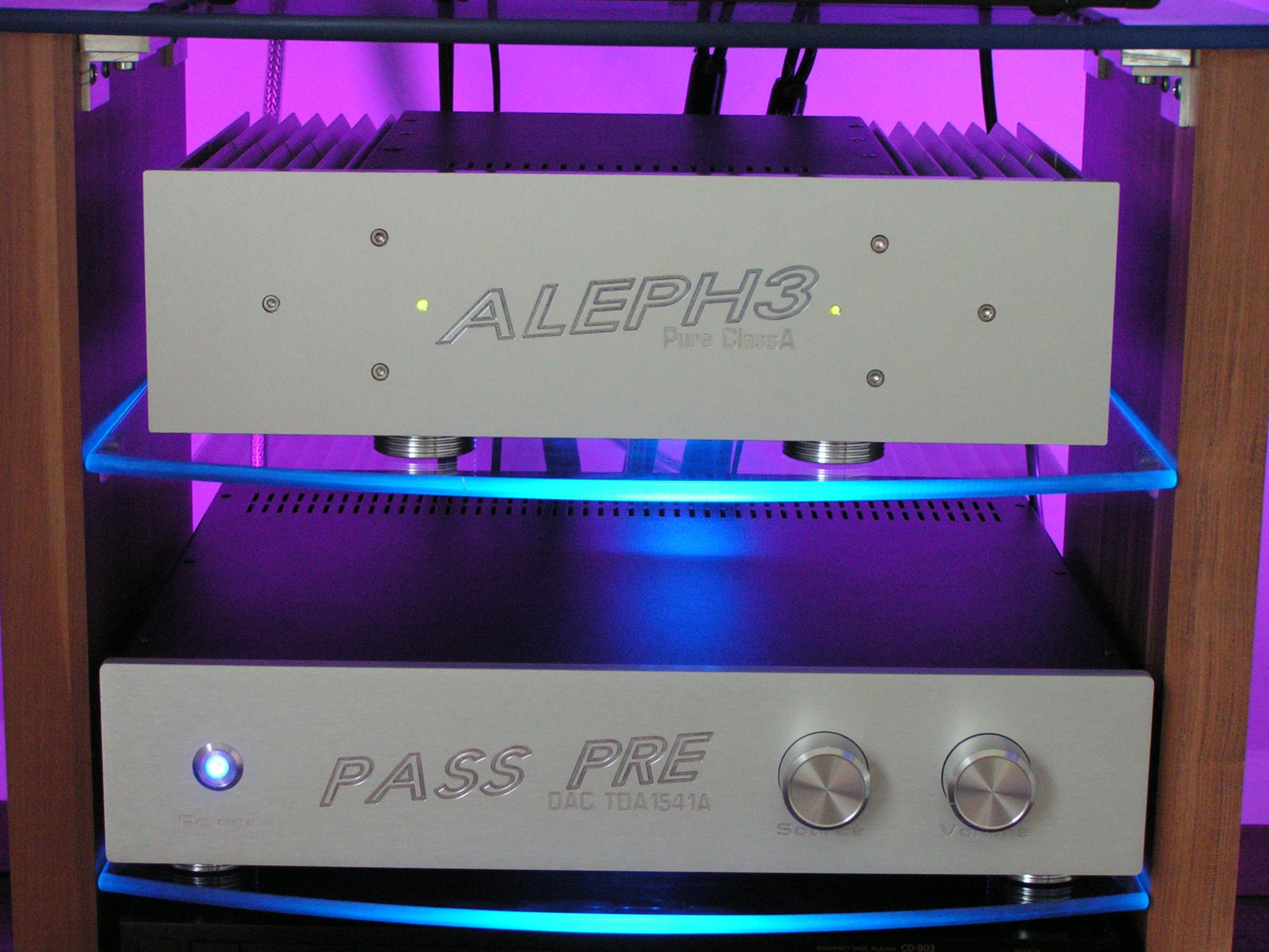

Hello valvesound,
here are some inner details of the aleph (of cause it's very tight...)
I build it as a double mono construction with two transformers and two power boards.
I also integrated two separate soft start with separate speaker protection.
you see, every space in the amplifier is well filled... :D

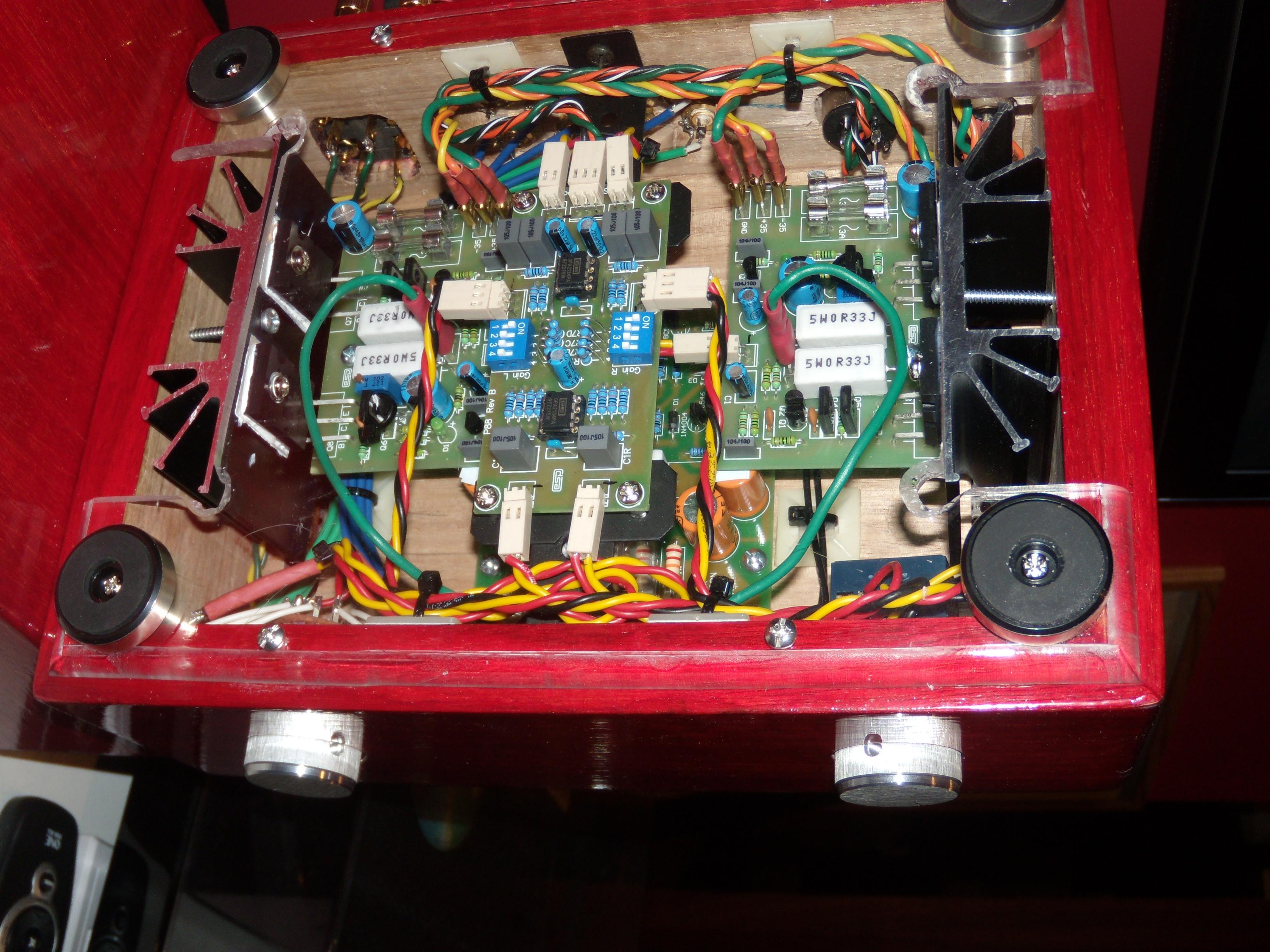

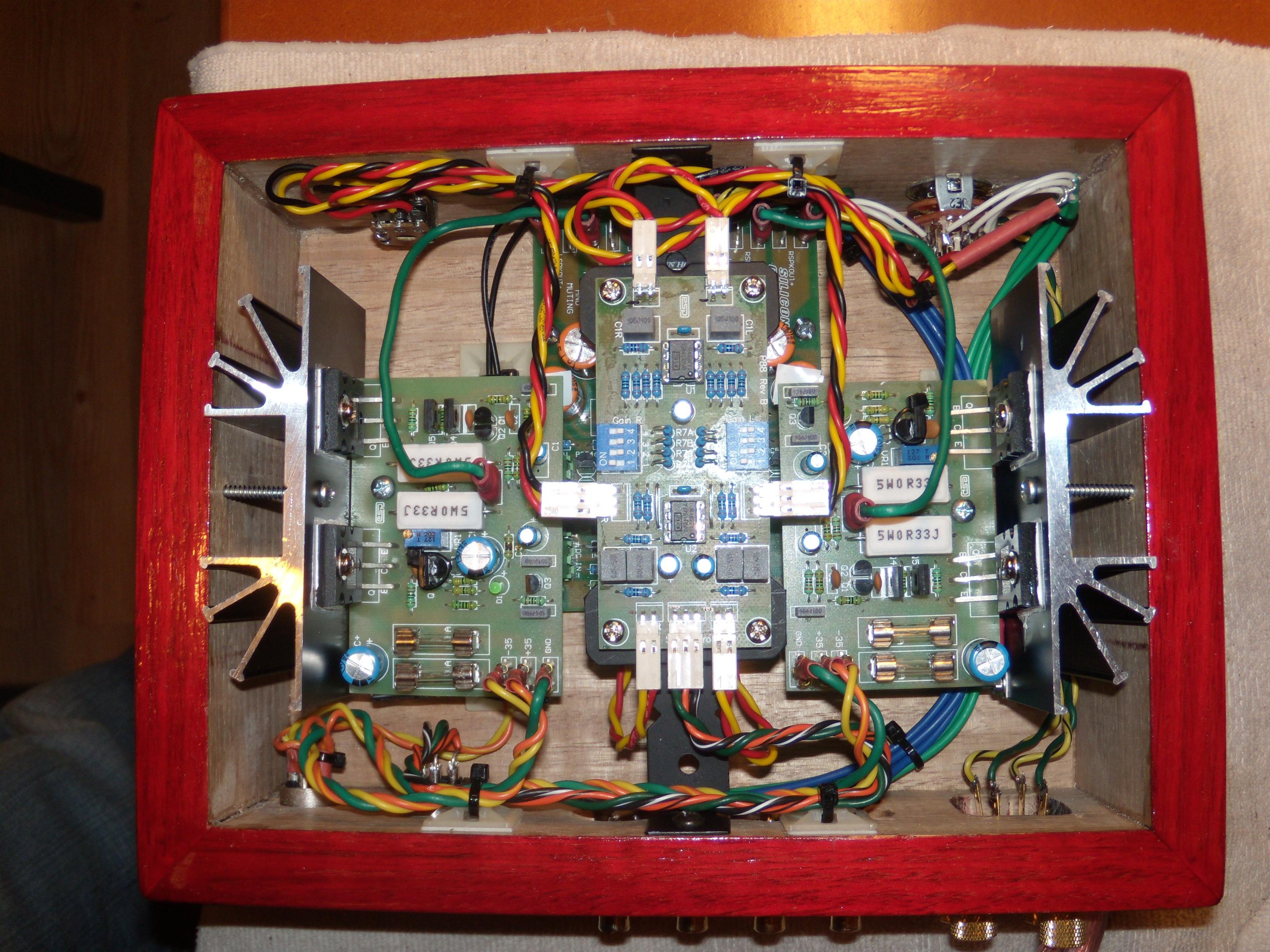

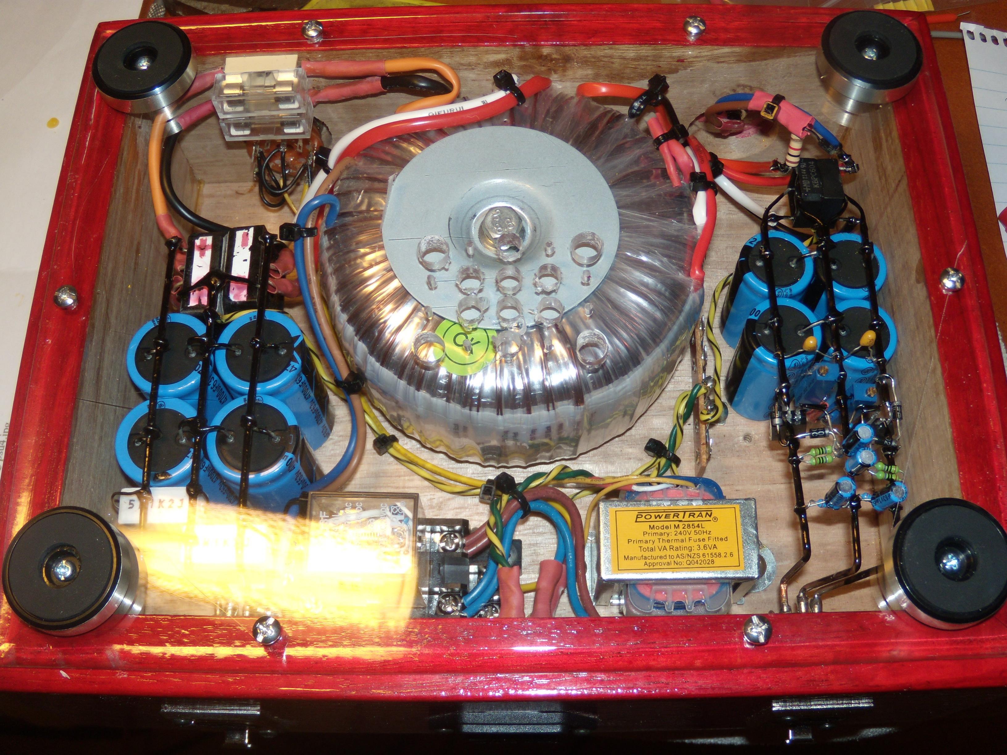

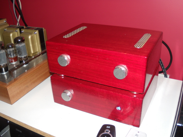

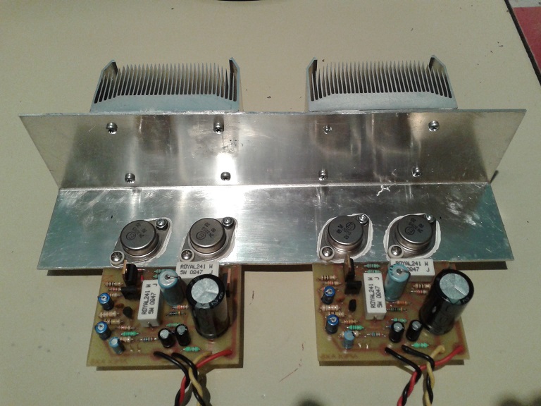

My first effort into SS amplification
Here a few pics of my first effort into building a SS amp.
The amp is based on Rod Elliots P3A 100W power amp and the P88 pre amp. I added a speaker protection kit from Altronic.
The power supply is point to point wired, 42+/-DC unregulated for the power amp and 15+/- DC regulated for the pre amp. All run of the mill parts were used except for the Alps volume pot.

Very nice, please consider drilling some holes for ventilation, maybe more heat sinking (depends on whether you hold house parties:D)
kind regards,
Harrison.
42 volt rails ..... minimal to non existing heatsink ....no ventilation you are on the very risky side my friend
I hear you, and Harrison. :(
The heat sink is on the small site. It has been playing on my mind as well.
Bear in mind that the bottom cover is cut out around the heat sink and that there is a corresponding air vent on top of the amp. So air can circulate.
But yes, when I made the enclosure I did not think ahead far enough. I did run the amp for a few hours keeping an eye on the temperature and at the listening levels I run it, there has been no issue.
I certainly take some learning from this amp build and I look forward to the next project when inspiration hits me.:scratch:
