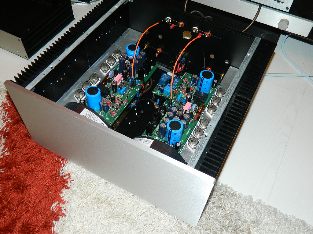

Much ado about nothing. When I look at the pictures I see the only wires carrying a dangerous voltage have extra sleeving fitted, and given that the wiring looms will not be subject to constant movement I can't see the problem. I am more concerned about location of the gate stopper resistor for the mosfet closest to the front panel.

I can not beleive the comments about my amplifier, I am actually a fully qualified electrical engineer. To say that this chasiss is electrical unsafe is wrong.
1st of all the 230v cabling is double insulated above the chassis and below, The unit is fully PAT tested and the Earth fault loop impedance is checked as well (Yes thats correct I have part P cert as well)
secondly the the main 230v connector is a correct Neutrik connector not a speaker connector as it may look like one from a distance.
All the fuse holders and mains relays are insulated and the correctly insulated with the correct type of Crimps used, with double insulated cable used.
I will accept all feedback but to say is unsafe is wrong, I have had a look around this site for other builds that I would say are very unsafe! I have seen at least ten builds that have exposed mains voltage terminals every where in the enclosure, thats why I try to increase my standards so others can follow. Perhaps other people can show their builds so we can all learn instead of being constant armchair critics who build nothing and bring nothing to this forum.
I accept the feedback about the holes but they are countersunk both ends, and where the mains voltage goes through the chassis it is again sleeved with heat shrink tubing. If certain people think this is unsafe, then you clearly have no knowledge in electrical engineering and should stick to civil engineering. I have been apprentice trained since the age of 16 (now 47) am have worked for Ford Motor Company and Procter & Gamble for all this years as a senior engineer ... so please I know when something is not safe. For example how many people check the Earth loop imedance and prospective earth fault current! well I do ... enough said before I loose it.

I've just been looking at your construction photos in detail. It's just possible that there has been a misunderstanding regarding your cable routing. The fact that you've used brown and blue insulated wire to carry mains voltages, DC supply rails and speaker output connections has led some to believe that the visible wires passing through the unprotected chassis holes are mains wires.
If you were to confirm that no mains voltage wiring passes through any chassis holes (without suitable grommets installed), then the concerns might change from that of a safety issue to that of a reliability issue. It appears to me that all of your mains wiring is confined to the upper side of the internal chassis plate and is well insulated.

currentflow, there is nothing wrong with nicks build from either safety or reliability aspects. The wires carrying mains voltage through openings are sleeved and no wiring will be subject to movement. I see far worse in my day job (Industrial and Commercial electronics and automation).This is DIY not aerospace.

srh, I wasn't criticising Nick's build. On the contrary, I was attempting to defend his construction method based on the concerns of others. Of course, in practice, the wiring should be stable and, from what can be determined from the photos, there should be no problem.
That said, I also believe that safety should be of paramount importance where mains is concerned and shouldn't be of less importance to DIY as it is with the "aerospace" industry, if only to comply with Murphy's Law.
