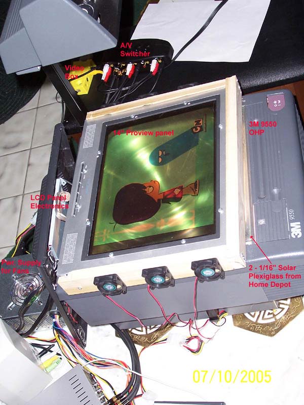

my setup
I'm using a polaroid polaview 3000 via vga to my computer. I bought some screen material off of ebay which i wrapped around a 4 x 8 board and am using a dukane 4003 projector. I've been very satisfied with it but I wanna upgrade to a dismantled LCD monitor so I am waiting on a viewsonic vg150 in the mail. I am also thinking about building a wooden frame so i can stretch the screen material more to get rid of some wrinkles that are in it.
telex m2x (640 x 480)
dukane 4003 with enx bulb (3000) lumens
dimage z1 camera taking a 99% acurate picture
baer silverscreen paint (home depot)
7.3333 ft screen size in dark room
Over all, the quality is awesome. The only - is the sde if you get within 5 ft. of screen.
