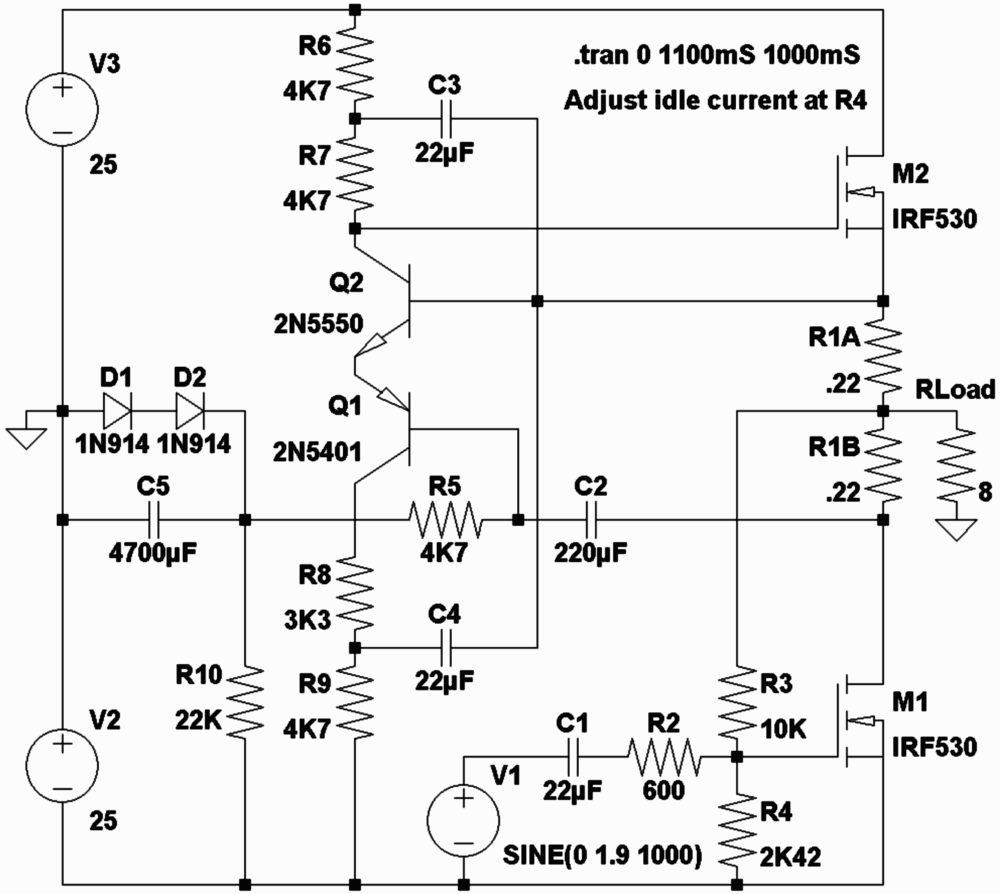

Possible improvements for Aleph?
I thought the point was merely to keep you entertained?
I was actually about to make a point regarding the mirrors.
But I'm afraid my mind has gone and wandered off again in
another direction. Something cool enough it might just be
worth the temporary distraction. We'll get back to it soon.
Born of several nutty ideas tossed about this tube thread:
http://www.diyaudio.com/forums/showthread.php?s=&threadid=140699
Aleph with DC servo!
At DC, its a voltage source.
At subsonic, its a Gyrator
of increasing inductance.
Above 20Hz, its an Aleph.
Go figure...

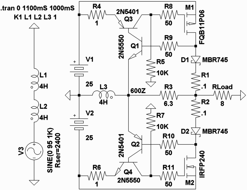

This drawing isn't clean as I wanted to show it.
But will have to do for now... Time is short.
The emitter coupled Aleph is a base follower,
not a source follower. And the voltage gap
between bases can be partially spanned by
other voltage drops besides Iq set resistors.
Schottkys here tighten the damping factor.
In the old drawing: currents into the gates
look like dErAnGeD squiggles, not sines...
The collectors were overshooting the mark,
and the local feedback was not helped by
bigger gate or base stoppers, nor extra
miller cap.
R3 and R10 are new. They put the bipolars
into a zenlike state without the miller cap's
phase shift. And the gate currents now look
like clean sines through the full audio range.
High order artifacts in the output FFT have
been quieted down considerably.
This added control also makes it possible to
smoothly shut off either gate without the
transistor overreacting. Before, they would
latch into deep saturation. Overdraining the
gates, making them harder to recharge later.

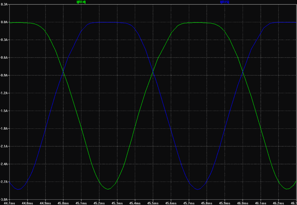

To show what I'm talking about:
I've deliberately biased this one into Class AB.
Sim this one, how smooth the crossover is!
Would have made a total mess before...

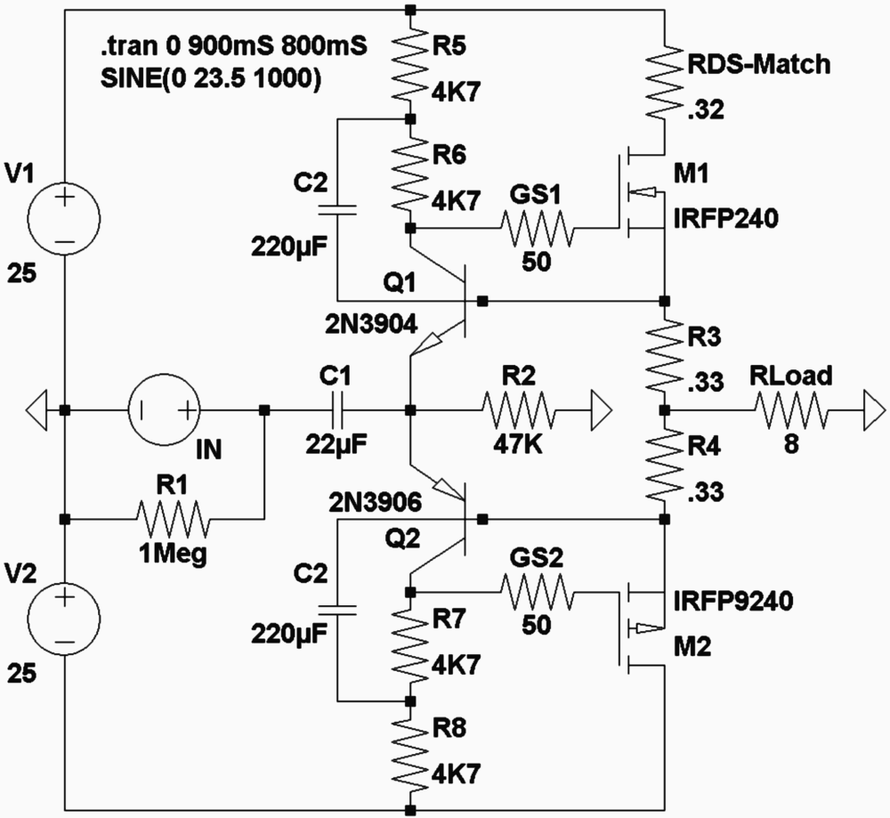

Well, it seems after further study, that the Schottkys and
drop across the base resistors were 90% the magic bullet.
I don't think Schading down the collector voltage gain (Zen
style) had all that much effect...
The real deal was shimming the voltage gap, such that the
load had tighter interaction with both Aleph's inherent local
error corrections. The AB crossing then couldn't be anything
else but smooth.
I'm wondering if there was any cancellation of the Emitter's
nonlinearity in the corresponding drop across the Schottky?
They aren't exactly the same sort of diode, and I don't think
it would work if they were. Needs some resistance to set Iq.

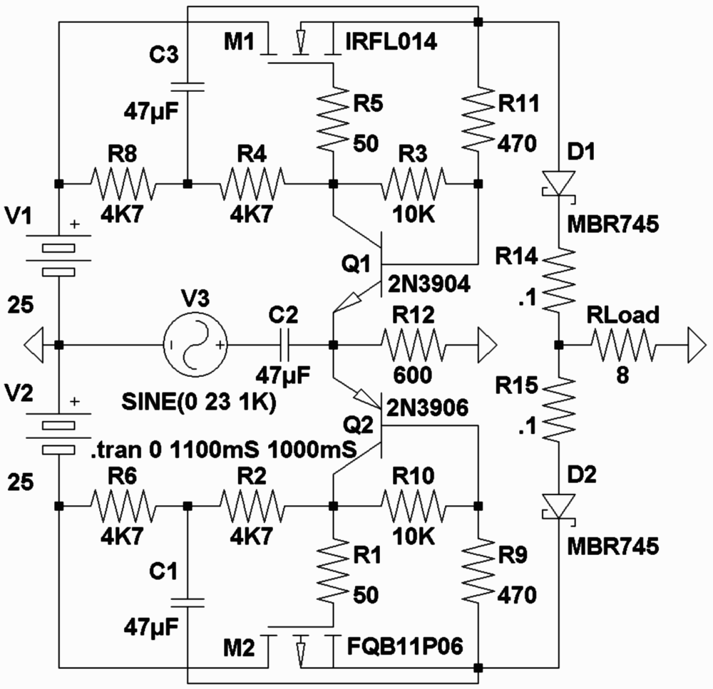

Anyways I got a tangent to explore first (act surprised).
Suppose I put a unity buffer between collector and
gate of the Aleph? And separately bootstrap the buffer
that does the actual gate driving. The input impedance
at the emitters should be HUGE.
Now supposing the buffer on the bottom is an inverting
type? The MOSFETS can now be identical. But this isn't
quite so simple as it sounds. The bootstap voltage swing
required is just as big as the top end's. But in exactly the
opposite phase and direction as the output.
What to do? What to do????
Wasn't quite what I had in mind or describing earlier.
But it gets the job done. LOOK MA! NO CAPS!!!
Seriously, there aren't any. Rail to rail too! Go figure...
Note both MOSFET channel polarities are now flipped.
If you made only one end this way, and the other Aleph
traditional, I suppose both output MOSFETS could then
be identical twins.
But I show you today a capless, bootstrapless version,
both ends... Probably needs a few stability parts thrown
at it, sprinkled around, ground in with a heel. R5 and R7
could also be merged into one resistor. This stripped
down, yet functional version, still gives the basic idea.
And of course, emitter impedance is now way up....
Though I've chosen to cut it down to 600 by sharing
a portion of the real load back to the driving circuit.
(as yet unspecified, pick your poison...)
