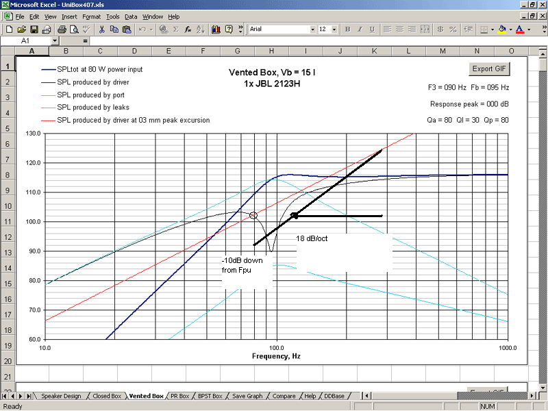

Can we move the port frequency down?
I think you could play with your box tuning to optimize it for a lower Xover freq. (110-150 Hz). Try a smaller box with Fb just below Fr. The box response will roll-off a bit slower, better group delay, and the port unloads a little lower? This will result in tighter mid bass, sacrificing F-3dB. Compare your results to an EBS design and the responses should meet arount F-8 dB or so.
See if you can tune the box to move the port unloading down in freq. Maybe EBS is best, I don't know without playing with a Box program.
Now you can determine the Xover filter frequency.
Once you have the box alignment you want, print the two charts like I posted. Find the frequency where the port unloads (Fpu). (Xmax vs Freq chart). Then on the other chart, use that freq (Fpu) and a slope of 18 dB/oct to find the corner freq. based on how much attenuation you want at Fpu.
Once you build it, you can adjust the port length by measuring the impedance. Find a Zmin between the 2 peaks, Zmin is the Fb.

I have been trying to use Unibox. I am modifying the cabinet tuning and size but I m not sure of the objectives. I have a few questions;
1) How do I use the electronic crossover feature? Can't seem to get it too work.
2) Infinia wrote 'We are talking about hopefully getting 6-10 dB of out band rejection by fine tuning your port and box alignment to the HP filter corner.' At what frequency am I supposed to be 6-10 db down? Is it the point where the cone excursion exceeds the xmax? In your plot I think it was 80 db or so.
3) Infinia: What are my calculated measures that my midbass tightening up my midbass (transients)? Or conversely what are the measures that my midbass is getting looser? I read this in another tread by Chris8 'Transient decay response is directly related to frequency response. The smoother, more gradual roll off will always have better transient 'response' than a steeper roll off. How much? Well, if you want specific software simulation to view step response/tone burst simulation....you can use the Unibox excel spreadsheet from the frd consortium'.
I one point I was trying to get a similar response curve as a 2204. I thought that by modeling the response of a good performing midbass that that would be a good start.

See attached image>> calculate the corner freq to get -10dB at Fpu
Using the plot for the old alignment, Fpu at clear circle.
draw line 18dB/oct from (Fpu-10dB) read corner freq at black circle.
Use Xover set at 120Hz to get 10dB down at 80Hz
edit> Transient will be based on total response of HPF plus driver in box. So for this case I think the HPF dominates and will determine the transient response. ( ie 3rd order cheb. at 120Hz)
