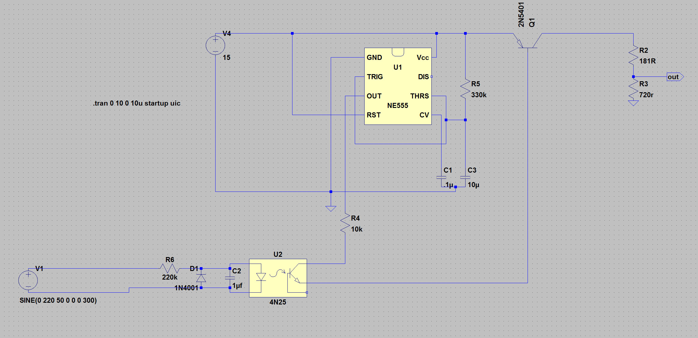

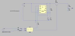

you might well be right, but i wish to cover all possible abuse/ child button pressing /power cuts etc etc..
and its not only the amps, ive got a minidsp, a bluetooth module, and an htpc. the minidsp and bt module startup from the same psu.
idea is the amps switch on after all the other junk has had time to settle down, and off before any of them start to be power starved.
however id note that as it stands that circuit does not function in spice. im a noob and it keeps banging on about floating nodes, of which there are none that i can see. .
also, i would use an ac opto, not a dc one with an extra diode. i looked at importing an specific opto into spice, but it seemed way more trouble than its worth.. surely in 2018 it should just be a case of dropping a file in a folder..

thanks, it seems your system is very similar to mine, apart from i use a 555 for the delay, and a small mains transformer for the cut-out, you use and arduino for the delay and a usb supply for the cutout.
its good to hear a usb supply will ramp down faster than the main psu, but i guess that depends on the load its connected to.
in my case, since ive already got a system that works perfectly, im looking for something to replace the sense trafo on the same circuit ( 555 based) with minimal modification.
id also like something as compact as possible as that area is quite congested in my amp and not only is the trafo getting (very) hot, its also blocking most of the small amount of airflow that reaches the aux voltage regulators on the psu. those too are getting very hot, despite a tiny load. partially due to blocked airflow, and partly due to being 1cm from a 90C trafo in a confined space!
seemed to me an optoisolator and a couple of external components is a common way to sense mains, and can be absolutely tiny.. but im not getting much encouragement for this approach.. maybe there is some issue im unaware of.

yeah thats definitely better.. i could probably fit that in. but.. optoisolator not a better choice in my case? sorry im banging on, just seems more elegant, and tiny, and cooler running, and quicker to react, than any kind of power converter... i really dont need *any* milliwatts! if there is some reason why i should not use an opto, please educate me, as almost every suggested "ac line sensing circuit" i see online uses an opto, and it seems it would be relatively simple to integrate into my existing circuit, could probably remove half the components and make it even smaller.....?
LTV-814 Lite-On | Mouser Europe
this is an ac one, just needs a big resistor between it and the mains (apparently)
the output side can be used to switch the output of the timer to the relay.
as per this suggested circuit:
opto isolator - AC detection for microcontroller - Electrical Engineering Stack Exchange

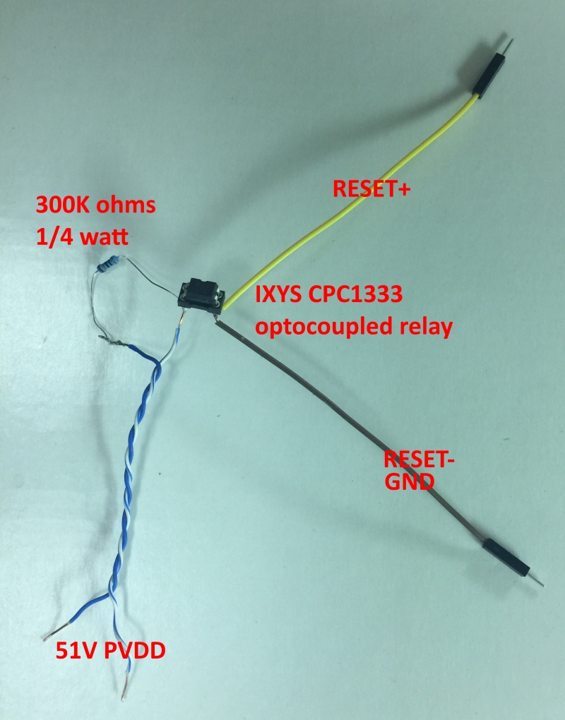

I've been studying the schematics trying to determine why the onboard voltage supervisor doesn't engage RESET in time to eliminate shut-down pops. Here's how it works (this is all on pages 18-19 in the evm manual):
Main voltage PVDD comes into the board and there are some filter caps.
PVDD then goes to a LM5010ASD step-down converter that outputs 15V.
15V then goes into a LM2940IMP-12 voltage regulator to create the 12V rail.
15V goes into a TLV1117 LDO to create the 3.3V rail.
The voltage supervisor is a TPS3802K33DCKR which draws from both the PVDD supply and the 15V supply.
This part resets at 2.93V, and that is where the problem comes from - it takes too long to drain PVDD and LM5010ASD before dropping to 2.93V to TPS3802K33DCKR.
Perhaps it was done this way because the board supports a pretty wide voltage input of 18V to 51V.
To address the issue, 2 strategies to speed response time:
1. Move voltage detection before the 15V DC converter
2. Tune the circuit to respond to voltage drop at higher voltage
So today I proof-of-concepted this using an opto-isolated relay, the IXYS CPC1333. This is a combined opto-coupler with *normally closed* MOS relay in a single package. It is very power efficient at around 0.25mW.
Pulling from 51V PVDD through a 300K resistor to the CPC1333 allows the part to switch RESET in before the shutdown pop. It works perfectly, and I have no power-off POP. You can tune the sensitivity of the circuit by adjusting the resistor value.
Here's a pic of the simple p2p circuit:
EDIT: Note that I'm pulling power from the PVDD (DC) power line, not AC power. This is necessary in my case because I use an external power supply, and there's no AC going into the amp box. Should also add that the circuit is incredibly simple because driving an optocoupler is pretty much exactly the same as driving a LED - no extra components required. And having the optocoupler and relay switch in the same package helps too.
