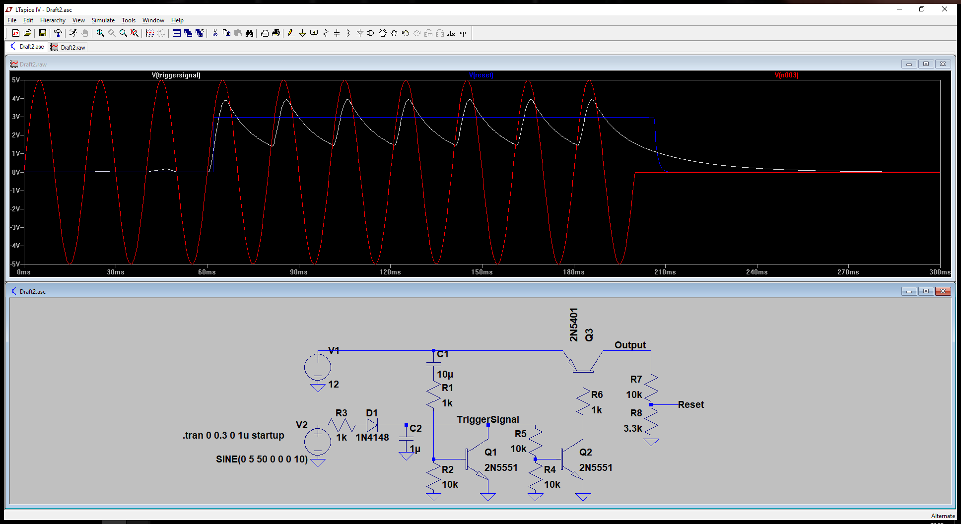

I tried to stick to "standard" component values, and as few different ones as possible, but here would be a starting point.
C1 controls the on-delay, and C2 the off-delay.

thats very very helpful.
so, the small transformer.. any specific voltage i should be aiming for?
something like this ok?
http://www.conrad-electronic.co.uk/...mer-1-x-230-V-2-x-9-Vac-045-VA-26-mA?ref=list
also, where you have written output, there is just a resistor to ground. i assume the relay is driven from a connection at that corner there before the resistor?
one other concern, if i run this circuit from the 12v supply for the minidsp, this is basically bringing an unregulated raw ac connection (from the "trigger" trafo) into the regulated dc side of the amp.
is there any potential to introduce 50hz hum into my system?
What's the miniDSP board supplied with? 12V DC or AC?
Either way, if you look carefully, there's no real (direct) connection between the trigger signal and the 12V itself.
And weren't you saying you'd want to use the "output" to drive the mute signal on the 3255 chips?
Regarding the "trigger" transformer, the smallest (and cheapest) one you can get is plenty, you only need something up to 1mA tops. Worst case, you might need to adjust that R3, depending on the voltage, but that's about it.
You need SOME capacitance there to have some reserve "juice" to keep Q2 and thus Q3 "open" so that current can flow through them. Otherwise the "output" signal would be bouncing on and off, 50 times a second. I assume that would be an undesirable result :D
Or are you implying that 6ms (6 thousandths of a second) is somehow not fast enough? ;)

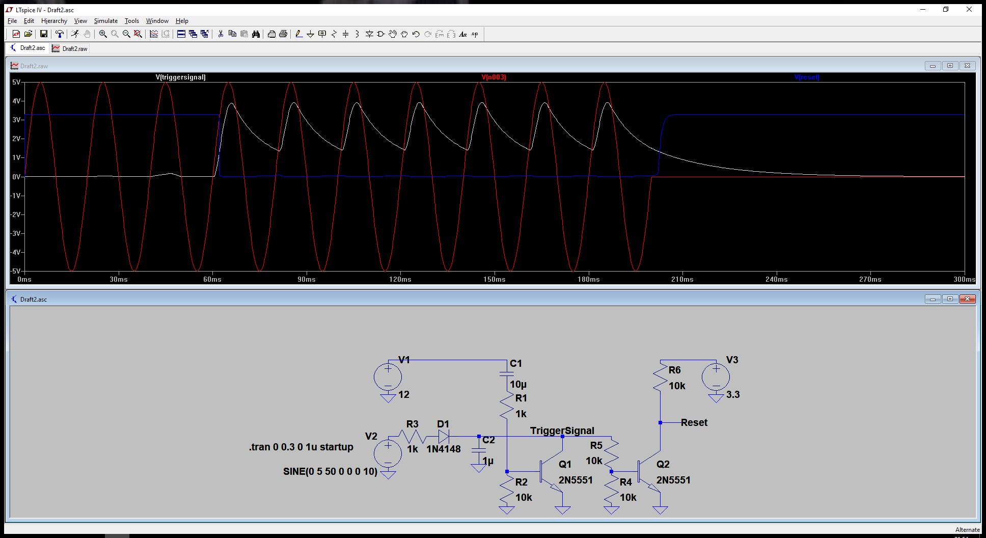

wrt driving the "reset" of the amps, i was imagining using a small relay to do this.. keep the amps isolated from the other supplies around. if i understood the datasheet well enough, the reset pin needs to be grounded to put the amp into standby/off.
and yes.. i think 6ms is probably fine :)
You're being a bit (too) "paranoid" about the potential for hum induction :)
There's no reason to galvanically isolate the simple pulling-down of the reset pin of the chips. "Guilding the lily" would be a gross understatement :D
If anything, apart from being pricey and overcomplicated, using that DC-DC converter would actually risk INDUCING noise into the line-level stages ;) As if the electrical noise from the amps themselves wasn't enough...
There's no real need to have a particular voltage there. If the reset pins need pulling down, all you need is two more 10k resistors and an NPN transistor; job done :)
Or if i think about it... You might actually only need to eliminate Q3, and use Q2 as the pull-down switch itself :D

PS: The 3.3v "V3" voltage source, along with that 10k resistor there were meant to play the role of the (internally?) pulled-up reset pin, inside the 3255. I haven't browsed the datasheet in great detail, but i remember the internal "Vreg" of the (possibly closely related, but older) TAS5630 chips was 3.3v.
Would you prefer through-hole, or SMD? :p
ok.. nope, thats not the only thing im confused about. looking at the scope above your schematic, it seems the reset is going to ground when the amp should be running.. this is the opposite of correct behaviour. i *think* the reset should be grounded when amp is off or shutting down, and floating when amp is on.. or possibly at + but im not sure from the datasheet.
