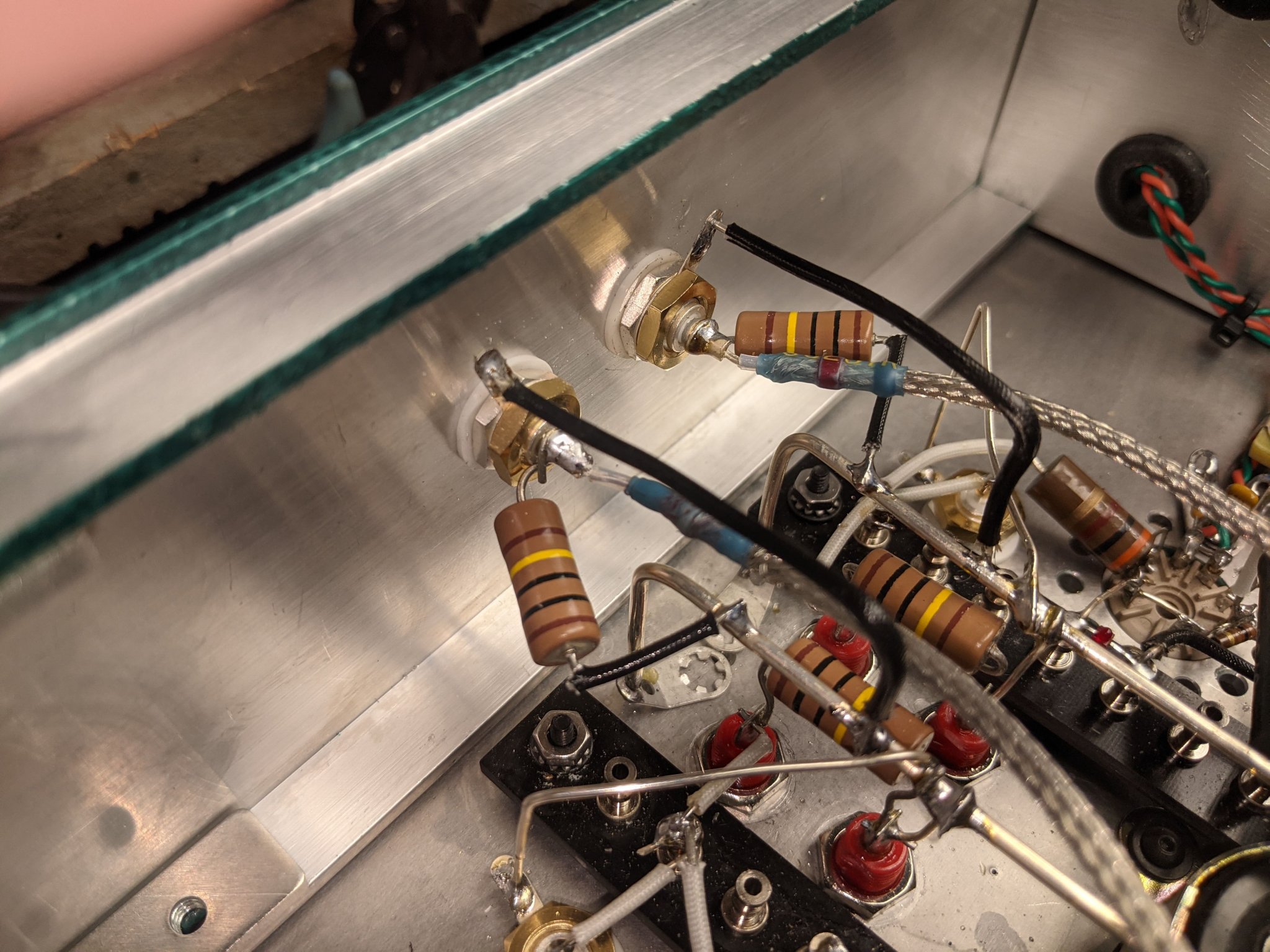

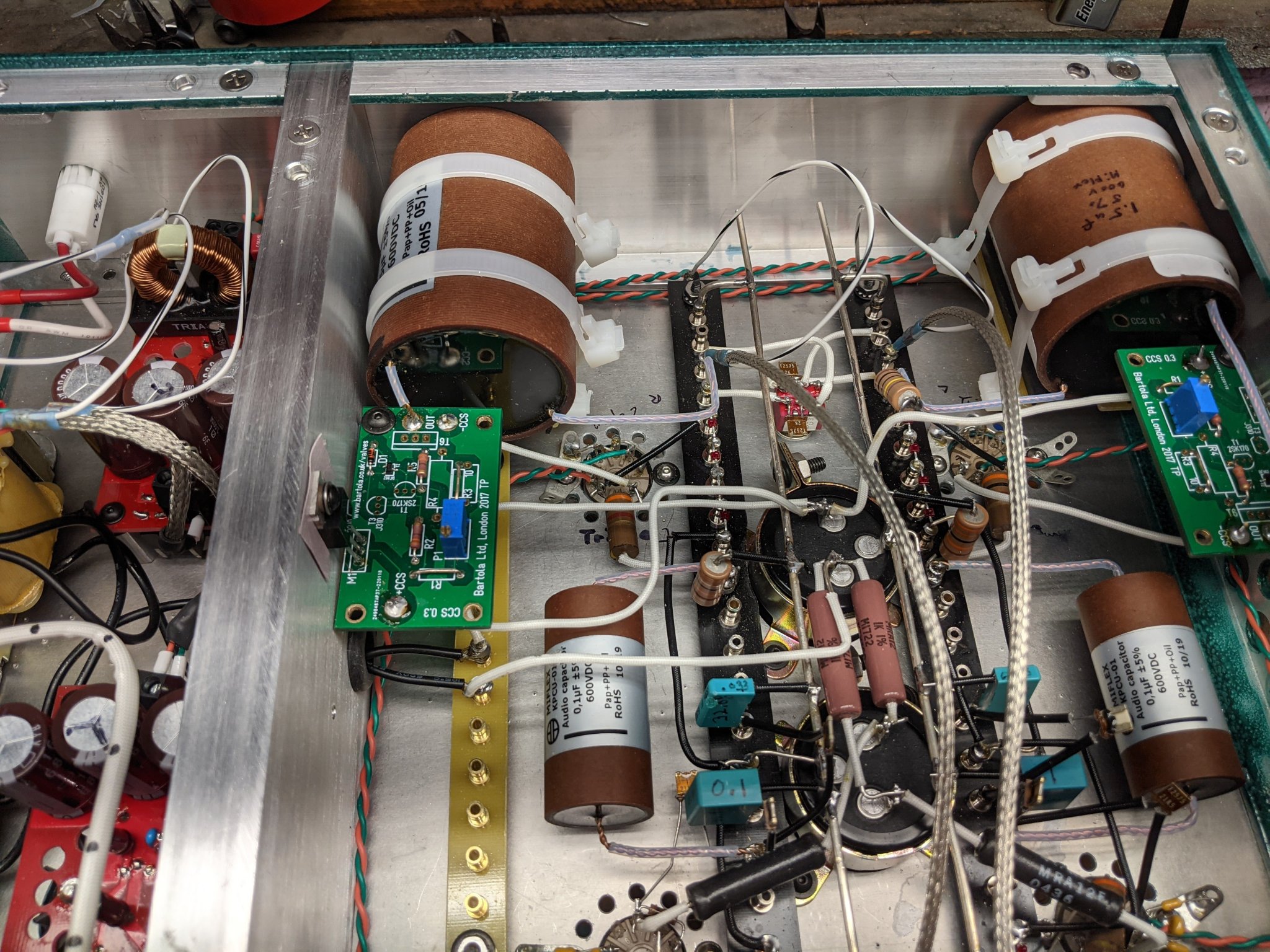

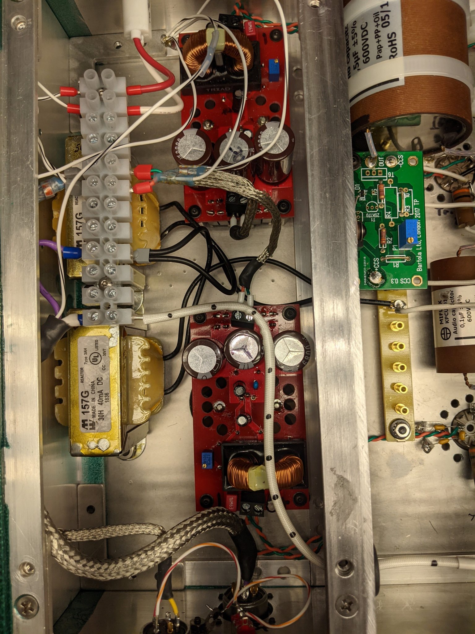

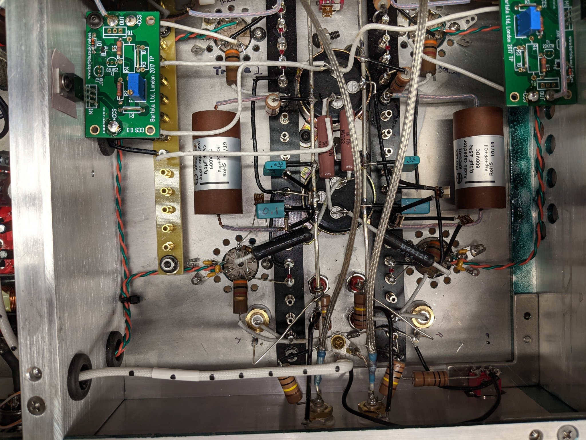

Recent phono-stage build using solder for glue.
Sharpie dots for extra black background? I'm not convinced diyAudio threads are like fine wine.
A 2002 Texas Point-to-Point, now, that's a vintage worth dusting off.
The dots were just a way to keep track of which wire was which since I used white fiberglass tubing as insulation. Just marking the ground buss.
Not getting the fine wine reference.
And yes, the backgrounds are quite black.
