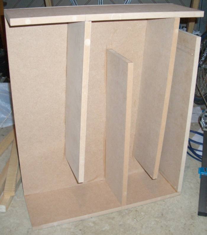

Ok, a bit of progress. All simply glued and clamped together, really nice and effective.

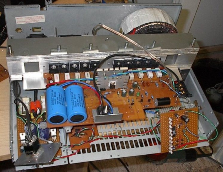

Got most the bits for the amplifier which is the ESP P101 design; high power version since this is 4ohm

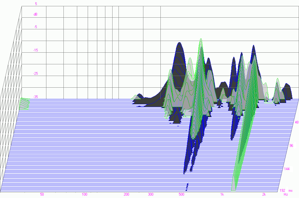

Here's a like for like accelerometer tests of unbraced 18mm MDF:
And the same testing conditions applied to 18mm Birch Ply:
Seems like swings and roundabouts to me. The MDF has a lower Q resonance at just under 200hz. The birch fares better here but not without comparatively worse issues at 600hz with a higher initial decay start level and more energy storage.
Now with modest bracing:
MDF:
Birch:
Birch is noticeably better here save for a narrow Q and rather diminished resonance at 1.2Khz. You probably couldn't even hear that at the level its at. Point is both are quite acceptable and this isn't even with serious bracing or lamination techniques ie. 10cm inter-spacing. So expect further improvements for both by doing so.

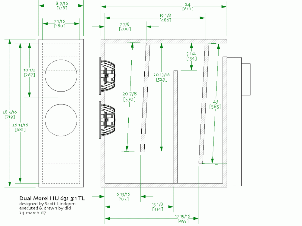

I'm using a 24db active filter at 70Hz and the TL itself provides moderate internal bracing so doubt I will encounter any real problems with this design.

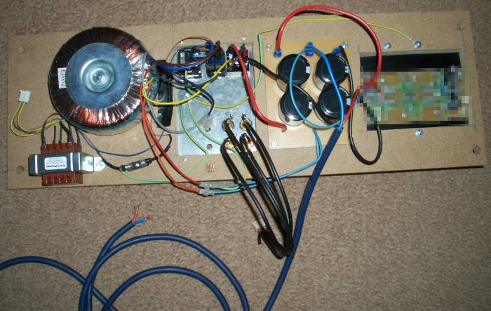

Just a quick update since the thread has become more active again. I've been working on the amplifier for now since my drivers still arn't here (do Wilmslow normally take ages?).
The amp is working as planned, its an ESP P101 board populated as the high power version. This is powered at +/-42VDC by a 300VA transformer with 20,000uF capacitance per rail; it will be driving the 4ohm load of the 2 drivers combined.
It tests well with an old passive sub I have but that one bottoms out very quickly, well before any distortion appears on my scope, so no higher power tests can be performed properly (it is 8ohm anyhow, one of the cheap Audax 8" drivers).
Filters are half done, they will naturally run from the smaller laminated transformer. Using OPA2134 chips for the high pass, they are working fine, cheaper TL084 chips will be used for the sub filter and phase controller.
