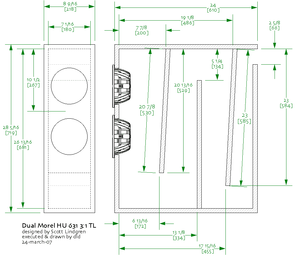

Thanks. Ok, no problem; so sticking with your original design Scottmoose, i'm trying to figure out some box dimensions.
With a tapered line is the tapering linear? I assume it is, meaning halfway down the line we have 2sd area. That also means the average area is 2sd. That is 0.476m squared. If I multiply that by the line length of 2.54m I get an internal line area of 1.209m cubed (I think). I'm not sure where I'm going after that. I thought i'd need to divide by the cabinet width (say 0.22m) then by the cabinet depth (say 0.6m) to leave my cabinet height. That doesn't seem to work though. I know there will be some deviation for the area occupied by the internal dividers too.

I think I must have done it wrong, the design doesn't actually come out to that size does it :eek: :D . I realised after multiplying the PMC dimensions gave about 0.05 it must be wrong. How would you actually do it, rather to fit that line into a box as-is? Planet 10's design is more or less the sort of size I was thinking of, a bit smaller would be nice though realising I have fairly limited space :eek:

Scott already did that (and Scott knows how to use the software as well as anyone). I drew the box Scott simmed, folded down into a shape approximating the PMC. The width is determined by how wide you need to fit the drivers, and 3 folds is practical given the target shape.
If you'd like me to move the drivers to the front, and add dimensions so you can build it, that is not a problem.
Gross volume is about 96 lites.

If you could re-draw it with the speakers on the front that would be fantastic! Starting to think I should have found somewhere to put it in my room before doing it, because it's going to turn out fairly large (though still slim, about 22cm wide I think would be nice). Anyhow, it'll be as big as it needs to be and i'll figure out positioning afterwards :D
Here you go...
dave

Big thanks for that design planet10! I will be building this project according to it :) . Big thanks to every one who has posted in this thread too, given me a lot to take in :eek: :D . I have the drivers, veneer and stuffing on order now too, leaving me with the wood, some heatsinks and some tools to get (already got most the amplifier section components; nice 300VA toroid, 20,000uf per rail and 35A bridge for £22 or so :D ).
