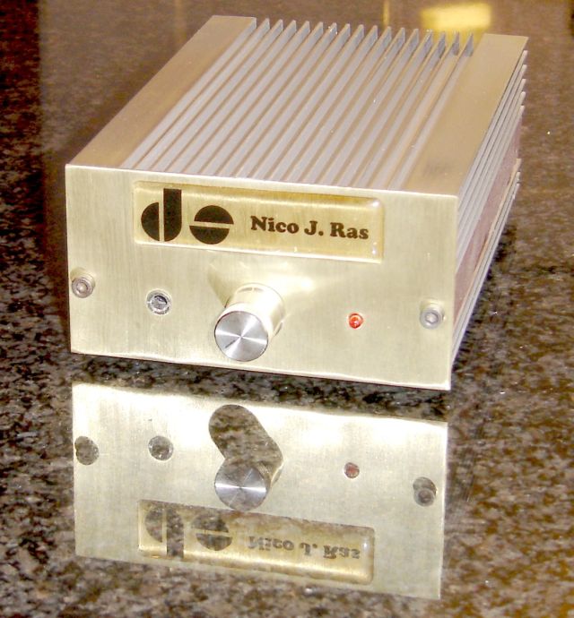

The question that may be asked next is what does it sound like? Being the "designer" it is difficult to describe how a product performs sonically.
All I can say is that I have achieved every objective that I specified of which the most important for me was to be able to distinguish the different character of similar instruments. This means that the amp must be capable of faithfully producing the signal it receives.
My design motto has always been and remains: "Listening to Reality"
Now one must also keep in mind that I designed the amp around what I had: A pair of Senn HD650 and HD 595. Whether you would experience what I do with different phones I cannot tell.
I am very pleased with what I hear and I think the majority of people that knows what music sounds like in real life will have the same appreciation for this simple design.
Thanks to you all for putting up with my presence here on the forum, kindest regards to you all and may those of you who celebrate this festive season have a smashing time.

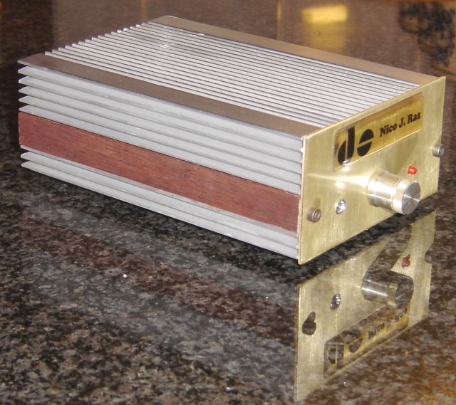

I have done a fast job with a cheapy, but enough, box for a first attempt to make myself a "Reference 1 unit".
Here are some pictures to cheer this text mass up a bit
The output coil is a DIY coil measured 1.4uH, parallelled with 3.9ohm. The zobel is 470 ohm in serial with 100nF.
The volume knob was in the "knob box" and the volumepot is from a slaughtered carradio (An ALPS pot)
