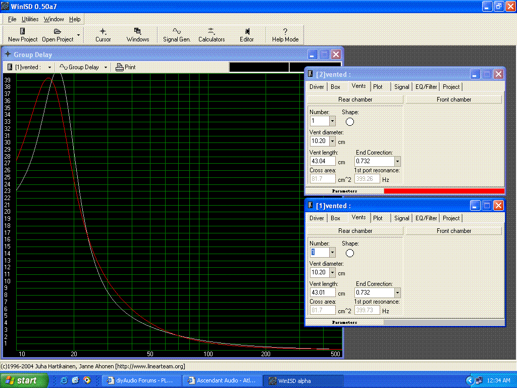

Yeah, it's true that the curve looks nice. I prefer mine because I think it's closer to room gain so flat in room response but your idea with the resistor is good too. If you look at the SPL curve, it's similar anyway.

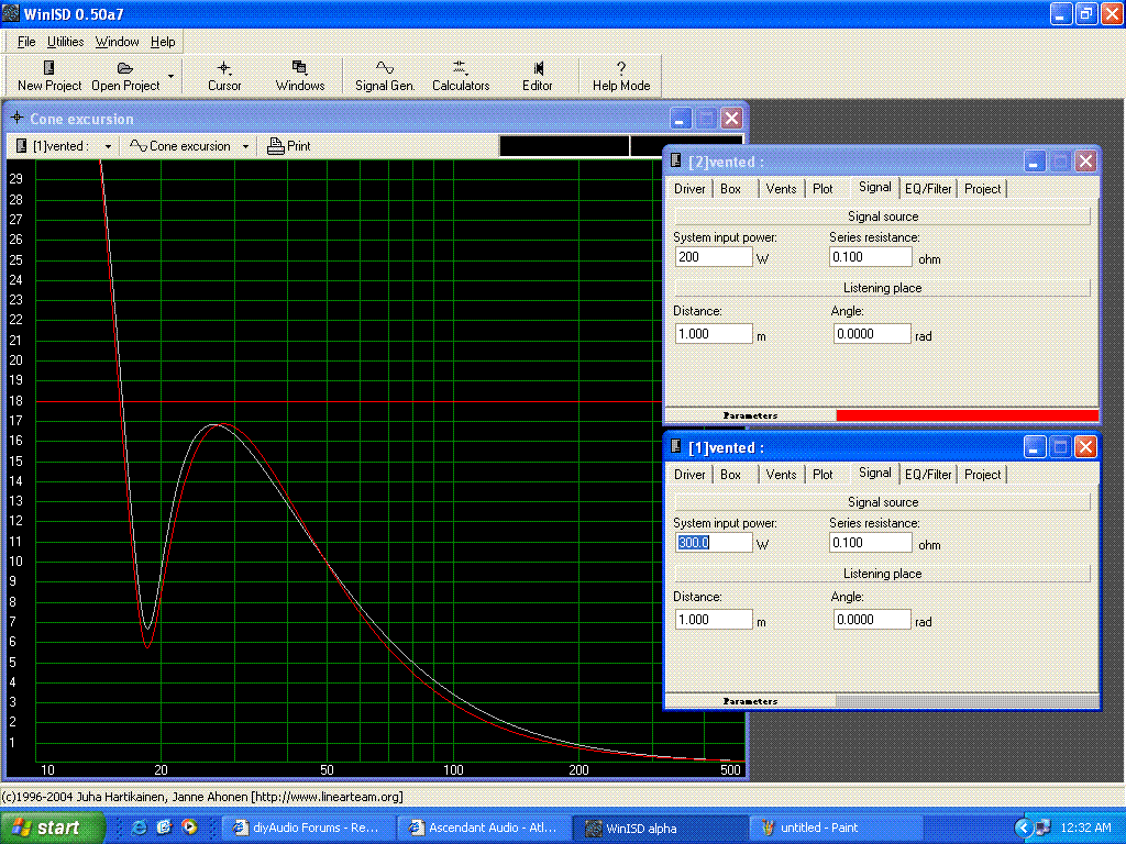

I guess your idea or mine will be good. Your idea need a little bit more excursion than mine.
The driver can't take as much power, and the output is hindered a bit at the low end, but it has a lower group delay. Interesting option. Room gain might pick up a bit of the bottom end, but I'm not so sure -- his room is pretty big. I think the mid Q option might rob a few dB, which has probably not been calculated into the equation, but for the price of a 1.5ohm resistor how can you go wrong with a bit of experimentation?

I'm a bit new to WinISD, but it looks like it doesn't have a room gain calculator, and I haven't found a nice one on the net. Adire LspCAD has one as I recall, but you can only use the loaded drivers. Reviewing JiggaD's room substantial room size (30x15), I guess the extra dB of the low Q design will help out, at least with home theater. Could set up a variable Q switch, but I think overall the low Q will probably work out for the best. I was trying to squeeze out a bit more SQ (original design criteria) with the lower group delay, but the difference may prove to be negligible.

In WinISD, I guess you could approximate this room gain curve with a Parametric Equalizer, with fc at 10 Hz, Gain at 6 dB and Q at 0.4
You need to remove this equalizer before checking excursion because WinISD will take this filter into account when checking for excursion.
