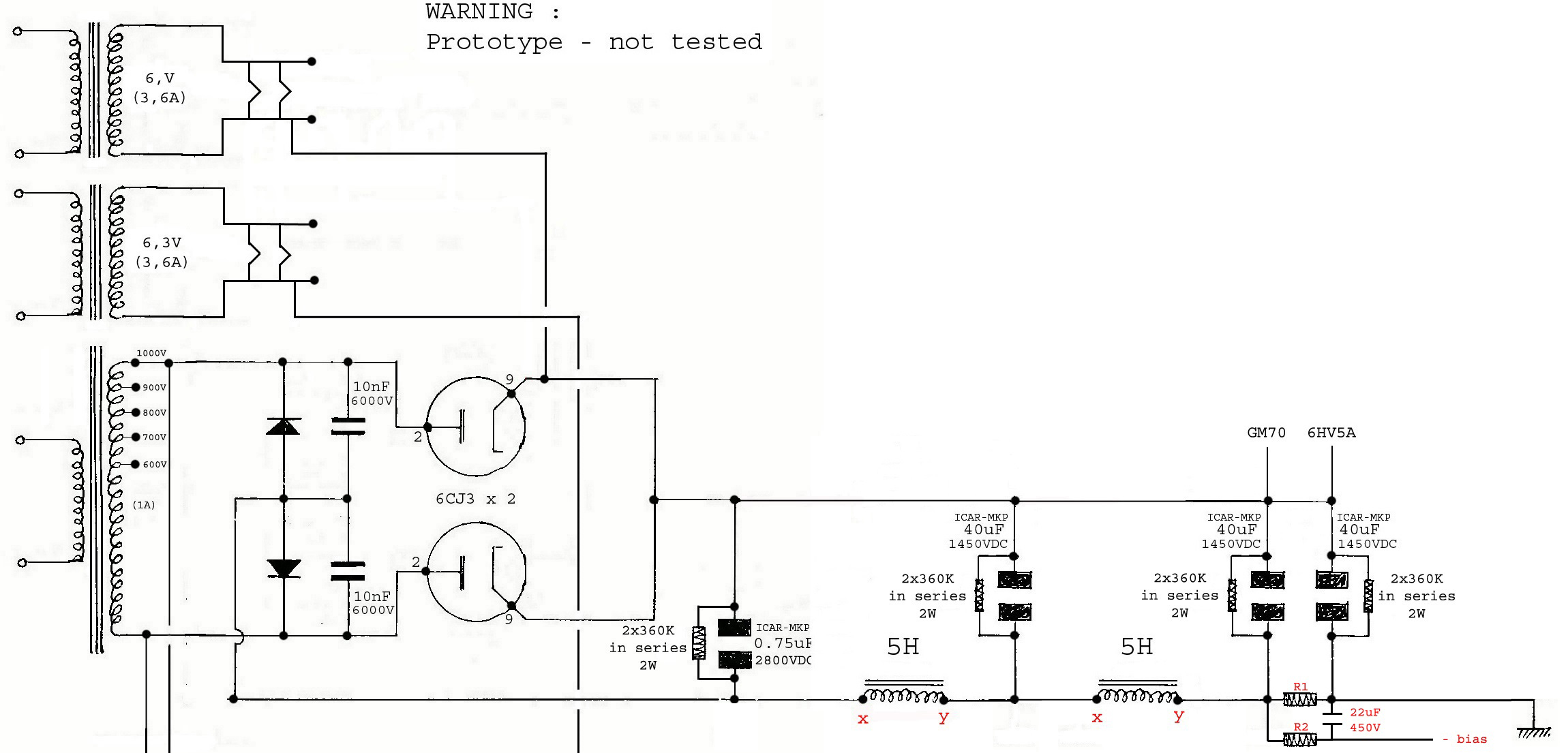

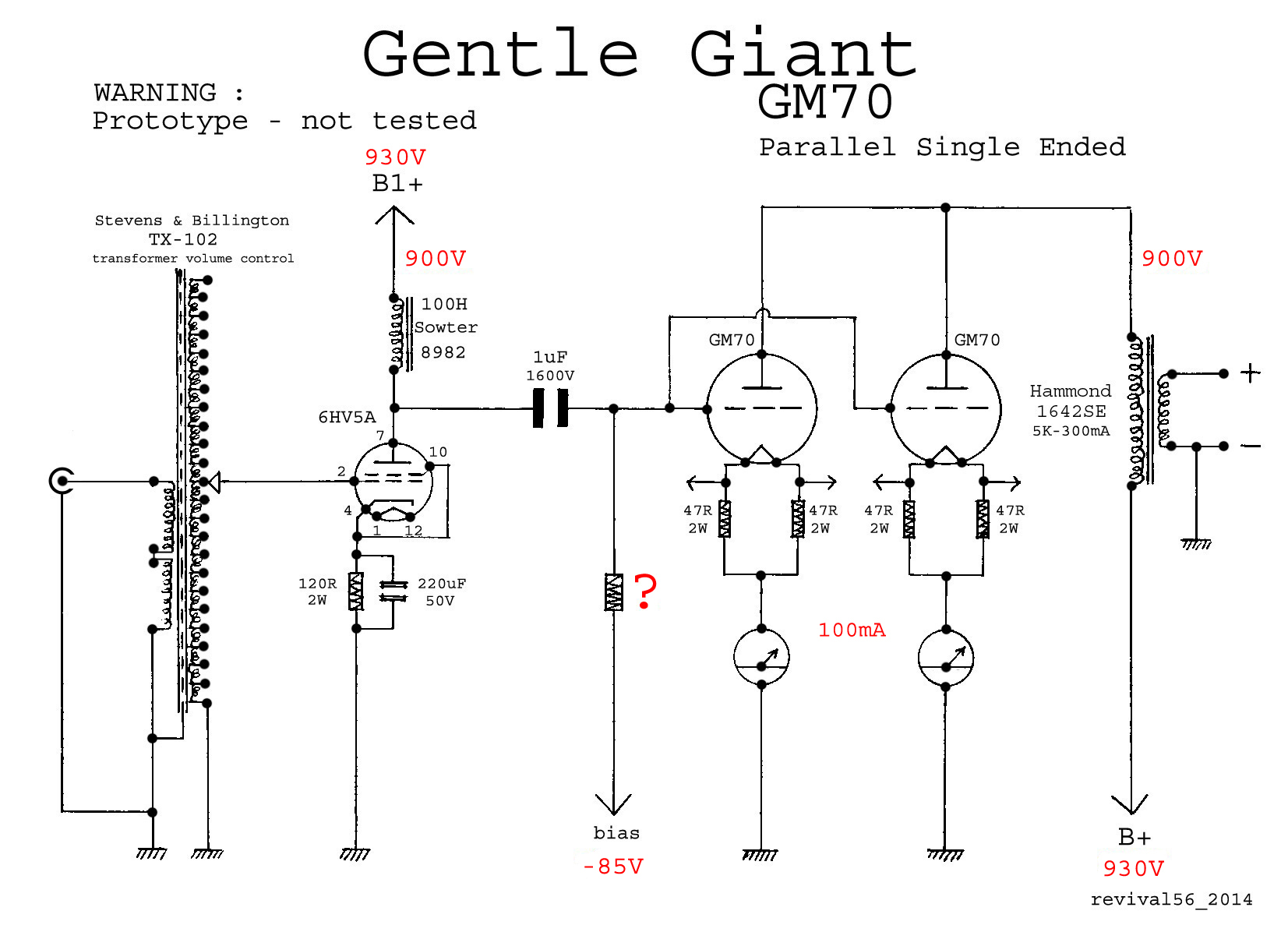

Thanks to the collaboration of many fans, in another thread DIY, I finally managed to figure out exactly how to connect the tubes 6Cj3.
The preliminary design of the power supply has emerged after many interventions and that's what the public here. I'd love to know what you think Thomas and Eli of this solution, both being very experienced in the field.
Any other contribution or criticism or suggestion will be appreciated and welcome.
Best Regards
revival56
