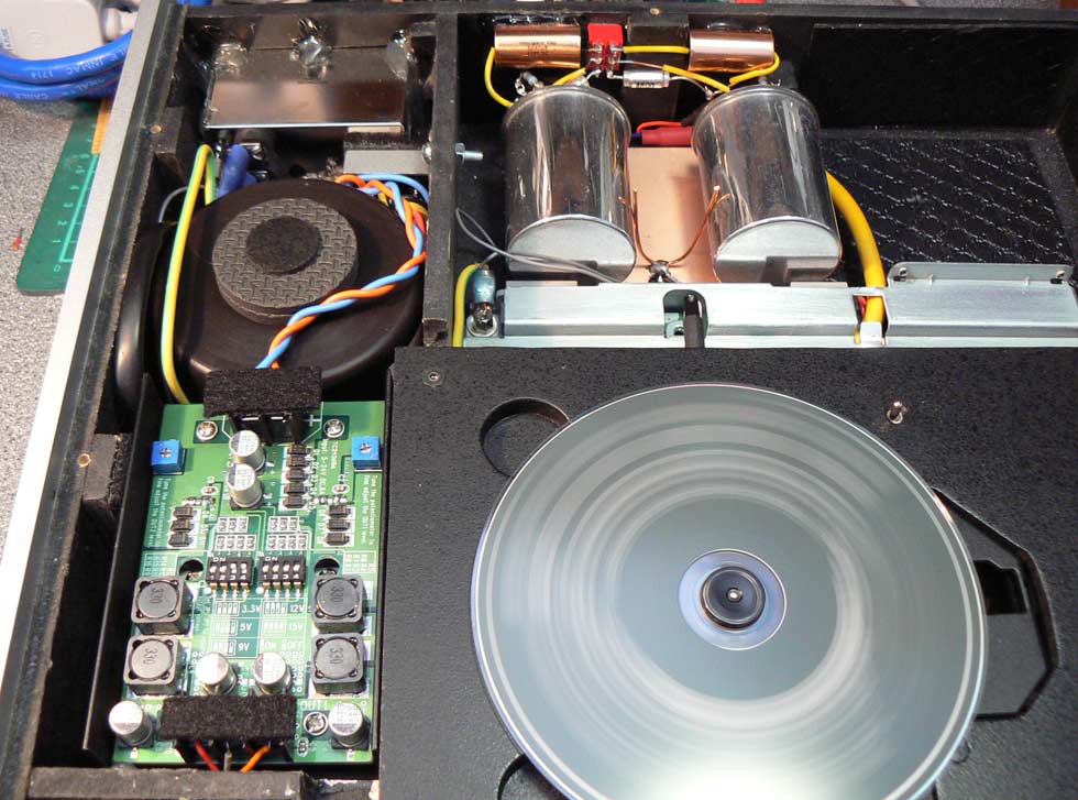

I am using the voltage regulator with a 12v toroid and a cheap bridge, which gives about 17v DC . Could also be used with a 12v battery.
As pointed out by "joydivision", it is still a switcher..It uses the LM2596..
The thing is, it still sounds better than the original SMPS..(IMHO).
Here's a picture of it cut down and in my CD player, still doesn't get warm..

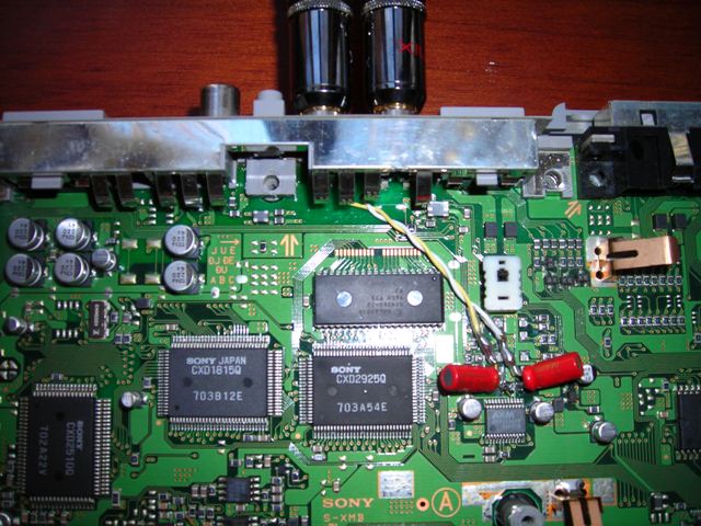

Just finished my output stage mod
I followed Mick Feuerbacher's output stage mods. I used the 4.7uF/50V Black Gate N electrolytics, 22k/0.5W PRP metal film resistors, Mundorf 24 AWG Silver/Gold hook-up wire, and WBT Silver solder. I guess you can say I like boutique passive components. I'm listening to the modded player and it sounds good. The difference between this and the stock unit is small. The modded player sounds just a bit more refined in the highs and more detailed. The mids still sound a slight bit congested. It does seem to have more punch in the low end. I suspect that the modded player will sound better as the Black Gate N electrolytic capacitors burn in. The soundstage is larger and deeper with the modded unit. Overall, the qualities of the PS1 are retained and slightly more enhanced.
In the photos with the caps, it looks like the soldered joints between the Mundorf wire and the capacitor leads are uninsulated, but they are both insulated in clear heat shrink. I also twisted the wire in a pair in case RFI might be an issue. In hindsight, I should have bought some Teflon tubing for those joints and for covering the exposed bent leads on the PRP resistors that are underneath the motherboard.
The mod is an improvement over my tweaked stock unit (PS Audio Power Punch C7 AC power cord and Isoclean 2A fuse). I still think the tweaks really enhanced the performance of the stock Playstation and the output stage mod has taken it to a higher level.
Compared to my existing player the PS1 is not bad but not really better. Soundstage is smaller and sound is not so clear and detailed.
If I have too much time in future I will put a new output stage behind the AK4309 with own psu and LM4562. All other mods seems a little bit esoteric to me.
If you change some resistors or caps the sound will vary. If it is always that big improvement is the question. Some mods can make it worse.
My big hint: buy a Panasonic DVD-S75 at the bay for about 50 $. You'll get a really fantastic CD-player with display, remote control and DVD-function. Before bothering compare it to the PS!
