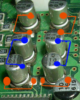

I think what others here have said is that you can bypass the AV caps (the middle pair, for improved performance). Is this correct or is the AV out preferable without jumping the capacitors ??
Dragonmaster, I knocked out every second "louvre" on the power supply side and drilled a few holes on top of the case , just to help keep it cool while experimenting. Eventually I will rebox it all, the power supply in it's own enclosure.
In my attachments (modded pictures from others), Red is for pairs #1 and #3 (RCA out?), Blue is for pair #2 (AV out?).

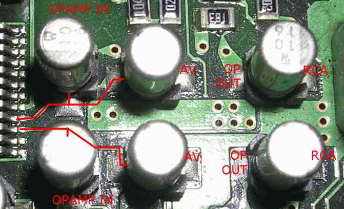

Thanks Nanook, your diagram really clarifies this topology. Because of the microscopic scale of SM technology and the tiny tracks it's not as easy to figure out.
However do the Cap polarities make sense to you ? Maybe I'm missing something but the AV cap appears the wrong way round ? It's fed from the same track as the +ve end of the 1st RCA cap ?
DragonMaster said:
And here's how they are connected. Use Nanook's scheme if you can't identify the RCA ones from the AV ones.
Sorry, it's just a cheesy JPEG but the file limit is just 20kb less than what I would have needed.
Maybe I'm missing something but does'nt that make the AV caps the wrong way round i.e negative toward the DAC rather than positive toward the dac (as per circuit diagram )
