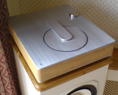

Well then ……. between starting a new job, going on holiday and installing new windows in the house I have managed to get my PS1/amp combo up and running ……… and it sounds absolutely superb. It may not be complete but the way things are panning-out it never will be! The remote volume still needs to be installed and the CD cover’s release/opening mechanism is still in my top drawer!
As you can see it is minimalist! I didn’t really want to have a volume knob on there so when the remote’s installed…… the knob will disappear. There aren’t even any connectors on the back! Everything goes through the base in a way that keeps all connection short and direct. It’s fabricated from 5mm Ali-plate with 5mm wood veneer.
It’s sat on foam at the moment because the sprung feet I have machined up still need fitting, it needs plenty of dampening due to where it resides!

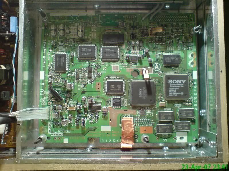

The PS1 board is stripped down to its bare bones (all connectors removed) and I have jumped straight off the DAC pins to a 50K pot and then through 4.7uf Obligatto’s directly into my heavily modified Charlize amp. There is a strange Phenomenon with this arrangement but in the interests of purity I have left out all non-essential components.
I did try Jurgen's Jfet buffer and although it sounded good I didn’t really need any more volume and it seemed to colour the music somewhat. My FE207E MLTL’s don’t need much driving. This is also on the test bench to replace the alps blue…

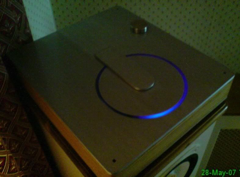

The SMPS is stock except for the new blue LED of course!

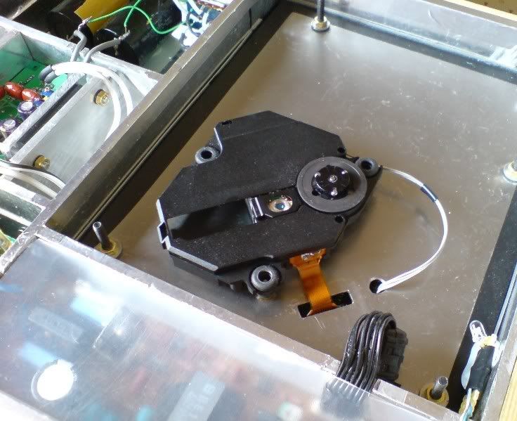

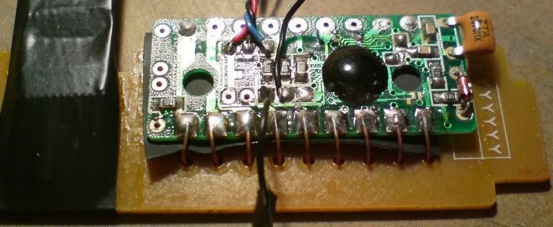

The CD remote is stashed under the board in its own protective case with the ribbon cable shrouded in copper tape to ensure the signals stay clean. The LED and sensor are then located on the underside of the case to keep the discrete clean lines I wanted. The original ground schematic has been retained using that new steel top cover which is isolated from the case.
I did have an issue with it a couple of weeks back on the test bench but after investigating further I found that I had inadvertently connected the boards ground to my safety earth through one of the fixing bolts… not recommended!
For those interested in the amp….. Input caps replaced as above and servo’s on the inputs that completely remove all DC, the feedback resistors 0603’s are soldered directly on the pins of the TA2020 (damn fiddly but I’m getting the hang of these SMD’s now). The output inductors are homebrew ferrite toroids that are mounted under the board with a separate ground plane in-between to isolate them from the rest of the board. Input wires are shielded and I may shield the speaker cables. The chip bolted/sandwiched between two sections of aluminium.
The 20V SMPS has a regulator board after it (currently set @ 13.4V) to smooth things out and a relay circuitto soft start the amp after the playstation intro has finished. I did try different stiffener caps in here as well but there was no audible difference at my listening levels.

Very nice work. It looks good.
Can you show a picture where the top cover is open?

I'd love to take a picture with the lid open but the mechanism is still in my top drawer so I can't keep it open

Wow - great job. it looks fantastic. I particularly like the blue light emerging from under the hood.

Thanks Jives, it's emerging through clear casting resin that's slightly opaque but I'm going to have to paint the inners white to get an all-round glow... a bit localised at the moment.Wow - great job. it looks fantastic. I particularly like the blue light emerging from under the hood.
