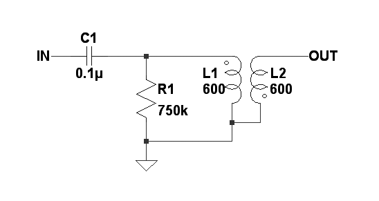

I finally got around adding the output transformers. The PSX now does this scary thing. Faye Wong sounds like she stands right besides me singing into my ear.
I have a major issue, though. There's no bass. It should be no problem. But I don't want to spend hours fixing and experiment when somebody here might have the answer. I don't think I have the stuff needed anyway.
I guess I should replace the coupling cap with a higher value cap and subsequently use a lower value grounded resistor. But, as said, I'll wait and hear what you guys here have to say.

Replaced the 0.1uF cap with a 2.2uF cap and the bass returned. But since I used a 750kOhm resistor, the 0.1uF cap shouldn't make a difference.

I dont exactly understand what you need the transformer output for. DC is captured by your high-pass filter and the trafo has a 1:1 transmission. Hence, in the best case, it should not affect the sound. Do I understand you correctly that it sounds better with the trafo than without, i.e. with the filter only? In that case, the only conclusion can be that the trafo adds some coloration to the sound which you prefer over the unaltered output signal.

I would need to do an A-B comparison to know for sure what the changes are, if any. I have nothing to compare with.
I use cheapo metallized Solen caps this time, 2.2uF and 220k resistors. And, of course, transformers.
I don't know what does what. All I know is that I'm impressed. This is possibly the best bass I have heard in my system. And I don't even have my tube amp any more.
All Shindo preamps come with "CD muching" transformers. They reportedly remove the "digital hash" (whatever that is). The huge Western Electric 101C repeat coil is highly sought after as a CD trafo. Again, I don't know.
I like what I hear and will look out for more PSXs. I hope to add 600:600 trafos that can handle DC. They will need to be relatively big so I will then need to build a new cabinet for the PSX. Or I will get low-mu triodes and use output trafos. That's for the future.
You could scout some cheap 600:600 trafos on eBay and try yourself. I will not be able to answer since I'm happy as it is and will not disassemble the PSX.

First. I got the wrong transformers for the job. I need transformers that can handle DC. The idea, as mentioned in some earlier post, was to get rid of the coupling caps.
I cannot say what does what. I don't know if the transformers bring any other change than the impedance. Nor do I know what role the Solen caps or the 220k grounded resistors play.
I BELIEVE the transformers are the difference.
