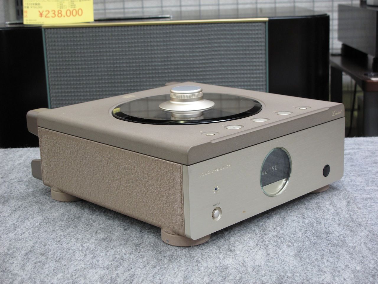

I dream to design something near the look of the Marantz CD transport (see picture)
Hi TYM, Like me you are late to the party. I don't think many people are building PS1s anymore. the best source of help is still Mick F's site: Mick Feuerbacher Audio Projects Rather than build a new PSU I bought a dual output LT1083 PSU that I put in a case (had to mod it slightly to get it to work).
I've also replaced the opamps with a stand alone valve buffer using a 6H5C or (6080) valve.
Next I will integrate the remote sensor. Eventually, I intend to build a PS1 using two ECC88 valves in the case. (with a separate supply). I wish you luck with your build and I'm happy to help if I can. I wish I had the skills to build one that looks like that Marantz.:)

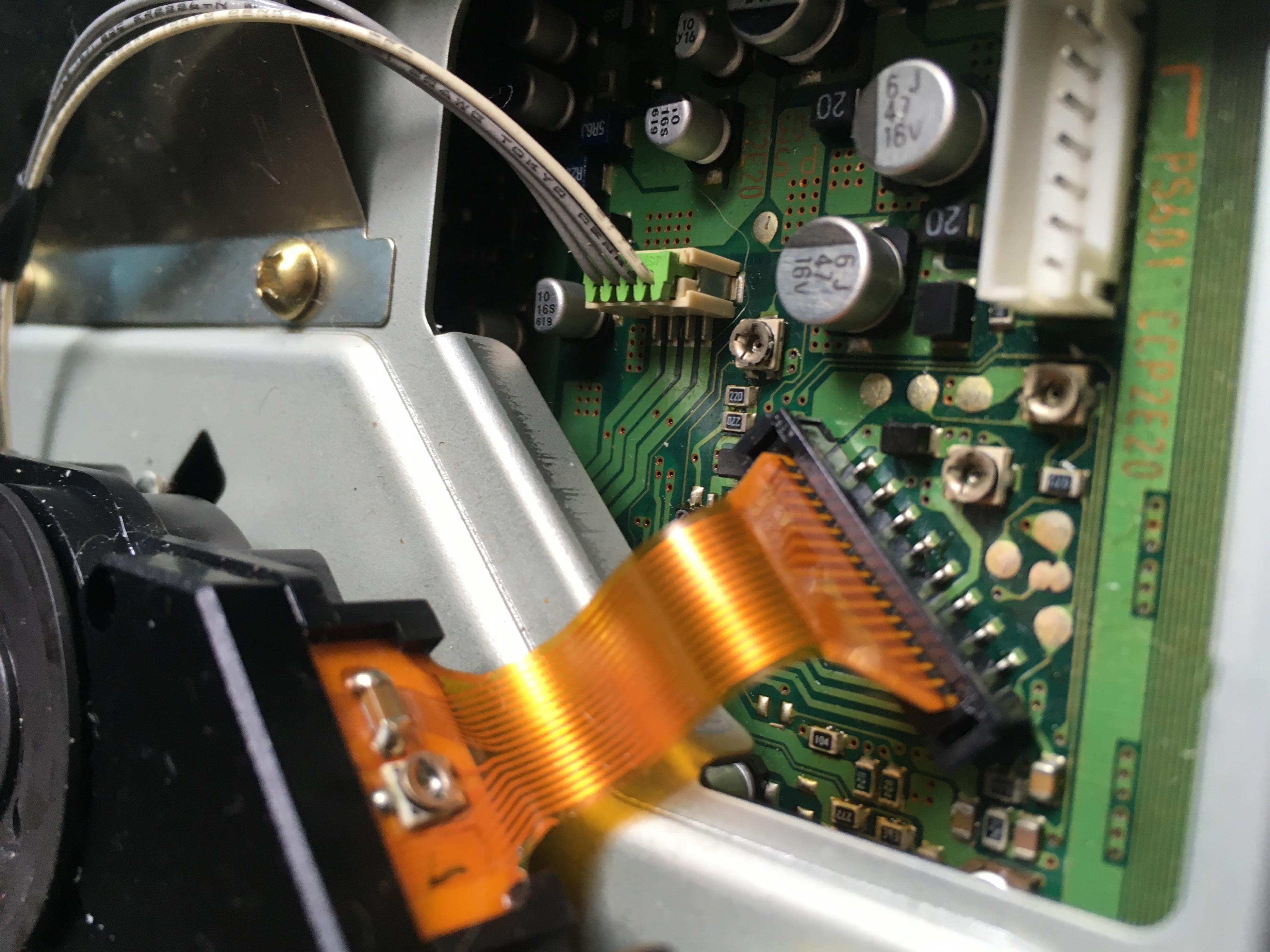

I had two 1001's packed away for a rainy day, dug them out a few weeks ago as I am still on furlough. Don't plan to go too mad with them but at least take the crap out following Dogbreath site mods.
I can't disconnect the ribbon and power wired to laser, I assume they can be unclipped like I have managed to do with the power.
Can these be taken out easily without breaking them?
The ribbon goes through a slot in the black plastic socket. This is the locking bezel.
Gently pull the black plastic surround upwards (about 3mm) and the ribbon should come free. Be very gently with the ribbon. I've cracked one myself. Refitting it is the reverse.
The other cable should come out easily but pull it by the green plastic - not the wire.

Thanks for reply Datun
I managed to raise the top of the black plastic a bit but bottled out taking it any further not wanting to break it. So the ribbon comes out as just a ribbon, none of the black plastic remains attached to it?
Thanks very much for clarifying this Datun. Successful, now its time to desolder :)
