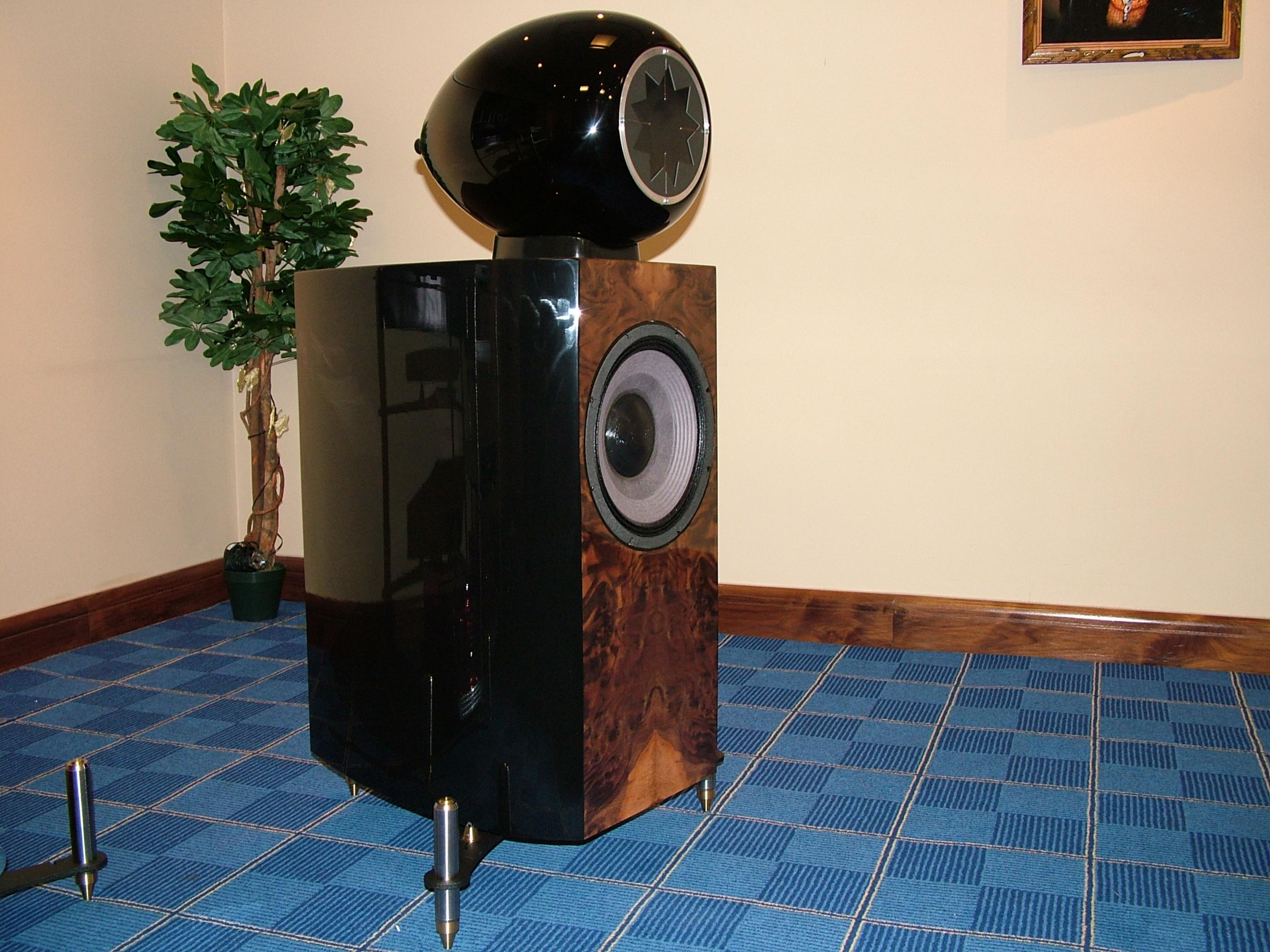

The attached photo's are of a Manger based two way using a 12 inch Beyma driver the 12LX60 in a sealed bass cabinet of just 50liters. I crossed it over and Eq'd it with the fantastic DEQX unit, 60dB per octave Linear Phase slopes at 330Hz....It was and remains the best two way I have ever heard.
At the London Audio show in 2005 I demo'd a pair of these playing The Gladiator soundtrack Battle scene...They filled a packed room with a tidal wave of instruments and the floor shook with the low rumble of the Kettle drums as the track fades...Most systems barely manage to suggest the drums are even there!
