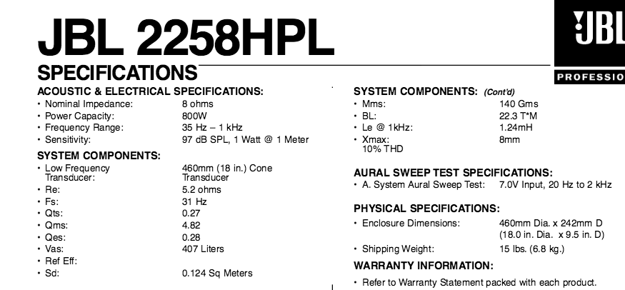

The 2258 HPL displacement (only 8mm Xmax) has not been considered "huge" this century.

The pair of 295-120 offer more displacement for less $$ than the used JBL 2258 HPL, but don't have an orange badge and have not been "broken in" for ten years ;^) .
Art
The 295-120 offers about 10% less displacement.
The big advantage of the JBL over the Dayton is the motor; that massive heatsink will allow it to play louder with less power compression. And the differential drive motor flattens the BL curve, which ALSO allows output that's consistent whether loud or quiet.
Plus, for my application, low weight was a big part of the criteria. Ferrite fifteens are freaken heavy, as my Gedlee Summas demonstrated.
But I *do* agree with you guys, the differences here aren't huge. Which is why I'm modeling an enclosure with a Alpine SWS-15D2. That might be a nice compromise between the huge box and high tech motor of the JBL, versus the low-tech and affordable Dayton.
