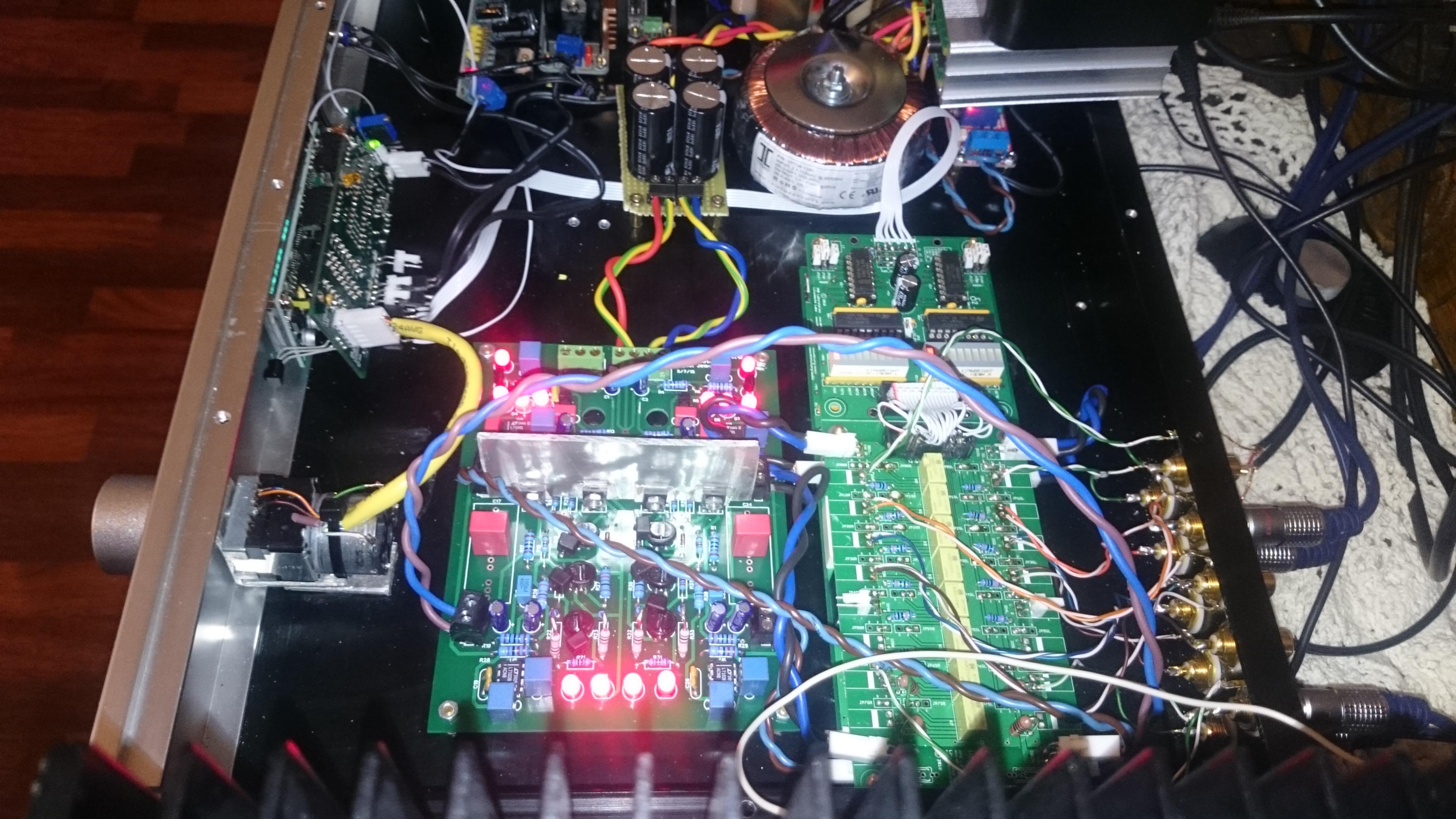

I put 100r resistors in series with r22, r23, 32 and 33. Now the heatsink run stable at 59C. That's more then I'm comfortable with, but it's ok for testing.
It plays music through spooky ips and 5p Slewmonster and works fine. It seems to be more neutral then the dcb1 buffer, but it's hard to say since I haven't listened to my stereo for a couple of days.

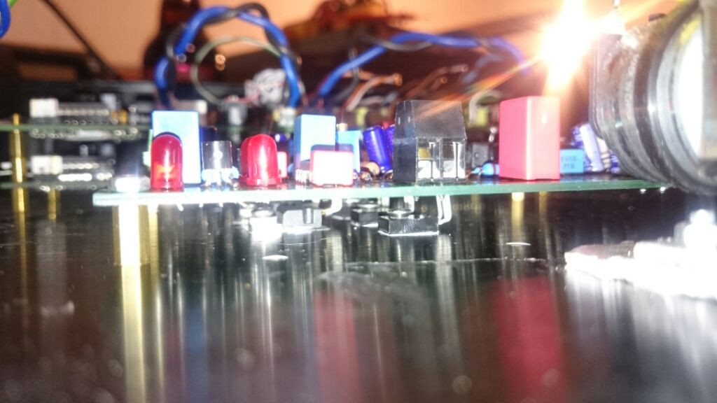

I finally got around to mount the transistors on the chassis below the board. Now it runs cool and I can put the lid on.
How does it sound? Is your volume changes still pop free?
It sounds great! I have been using it for a while using a big heatsink clamped to the small aluminium sink before I relocated the transistors, no pops or other noise.
It took a while to get used to the sound compared to the dcb1 buffer, the pitchfork sounds more transparent.
It really brings the slewmaster to life when I crank the volume.

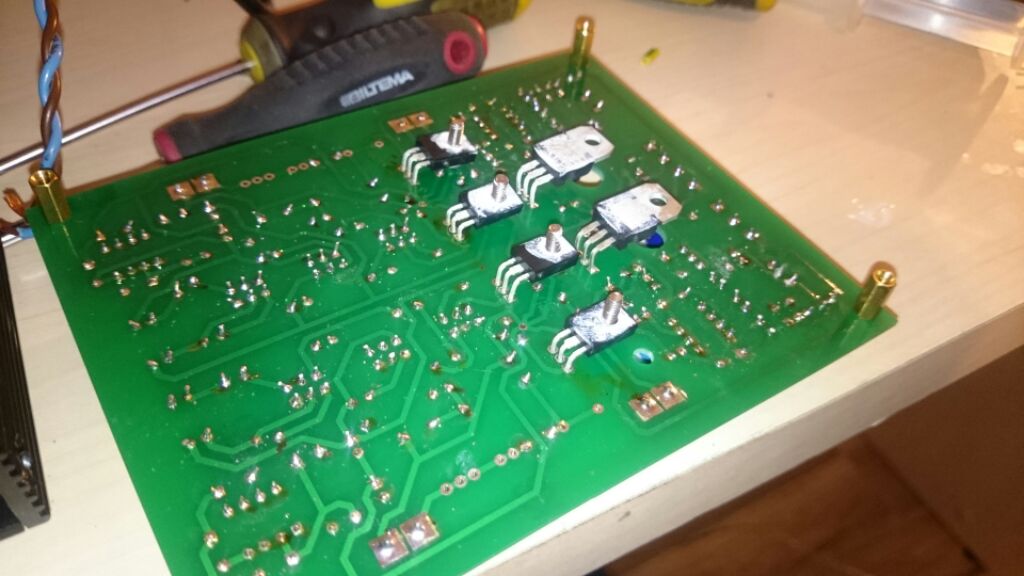

I'm not really happy with the layout of the linestage. It works great, but it's hard to cool the output transistors. It's going to get changes to make it easier to mount it to a heat sink.
To have a new layout you may start with this ..single sided ..
Power suplly in the center an audio on each side .. an a few jumper
THere is also a track at ground level to work as a gard betwen sections
All power transistor in a single line to fit heatsink.
