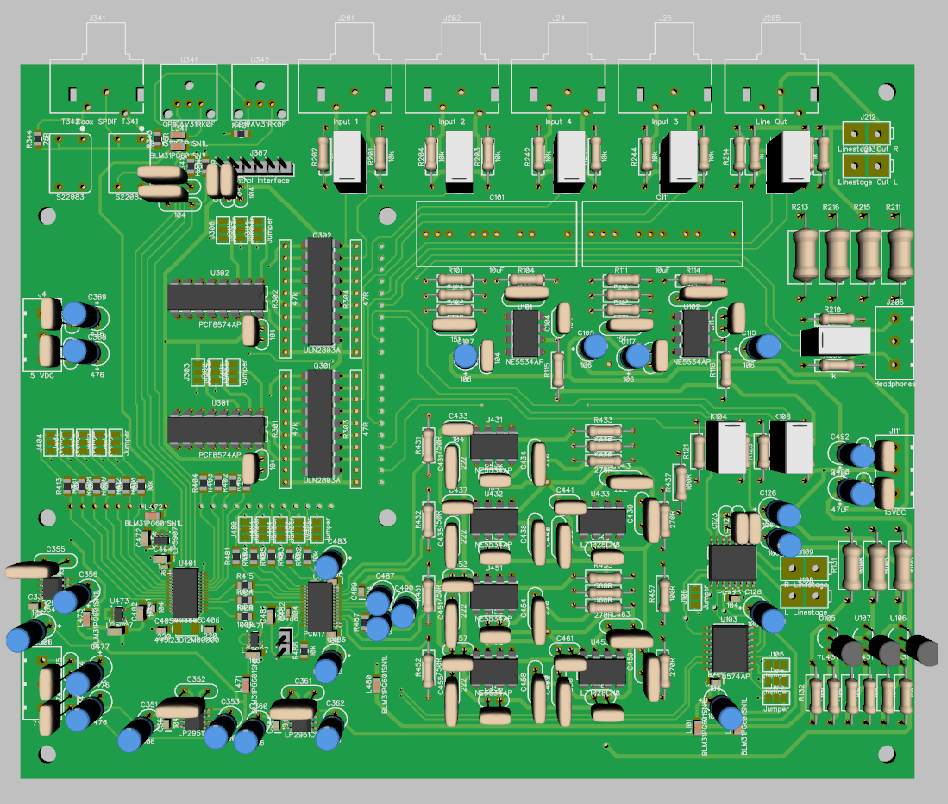

I've had to switch to a larger single board design. The modular design was sprawling out too far with the large board to board connectors required to make it work. Here is the latest schematic and boards in progress.
I know Rsavas doesn't like the shunts on the last page of the schematic for the 15 - 5V conversion. OS, can you look at this and give me your opinion? Would you prefer to go a different direction with them?
I'm also looking for direction on the output of the linestage. I've set the output relays up with separate series 1 watt resistors for the line out and the headphones out to attenuate the power levels. There is also 1 watt resistors to ground to keep a load on the output of the linestage when output relays are open. Are these required? These relays will open every time there is a change in the input selection so there is no popping as relays switch.

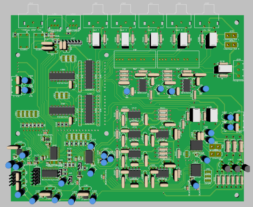

I've updated the schematic. I've removed the resistors at the outputs, added two outputs from U103 to the daughtercard connections, and have added an optional I2S switch for another I2S input.
I've got a daughtercard designed for running in hardware mode with the Arduino front end. It has indicators for relay operation and a driver for bi-coloured LEDs to indicate flagged functions of the WM8805(lock, non-audio data, ect.). I thing it would be better to design different optional daughtercards for different controls. In software mode the bi-coloured LEDs would br useless. The Arduino controls can be left unpopulated and all relays and devices can be controlled from the daughtercard connections.

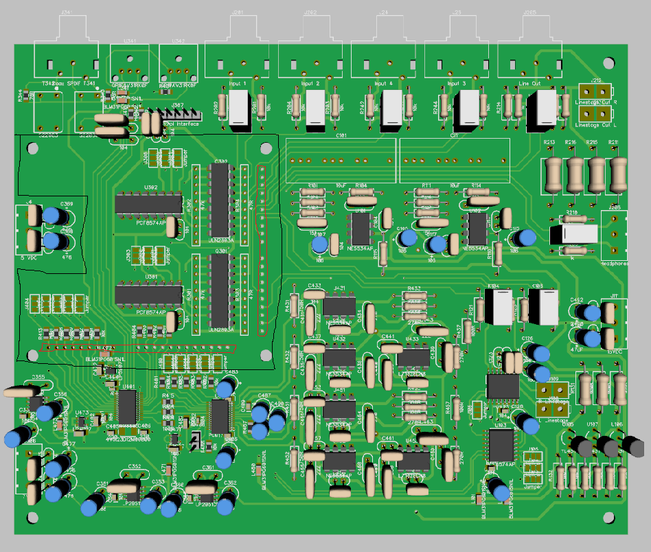

The PC board is layed out. It just needs the silkscreen fixed up yet. The only part I see possibly being an issue is the relay coil traces running under the input caps and between the buffers. As is the relays are latching so there will only be current flow present while inputs or outputs are switching so I don't think there's much possibility of inducing noise from them.
U341,342(GPIF...) should have 104 mlcc caps at the power pins!
It is the transients that get coupled, even if it is momentarilly it can be heard in sensitive ckts. Running digital signals in an analog only area is in principle a no-no. If no other option, use ground plane shielding of the digital signals.
Well I guess the proof will be when you test it out butThe only part I see possibly being an issue is the relay coil traces running under the input caps and between the buffers.
Good catch! I missed those caps.
I don't see another way to power the relays without running digital traces through the analogue section without external wires. That's the crappy part about relays switching analogue. Is a digital ground plane a good idea under analogue? In a normal circuit I wouldn't think twice, but analogue layout is fairly new to me.
