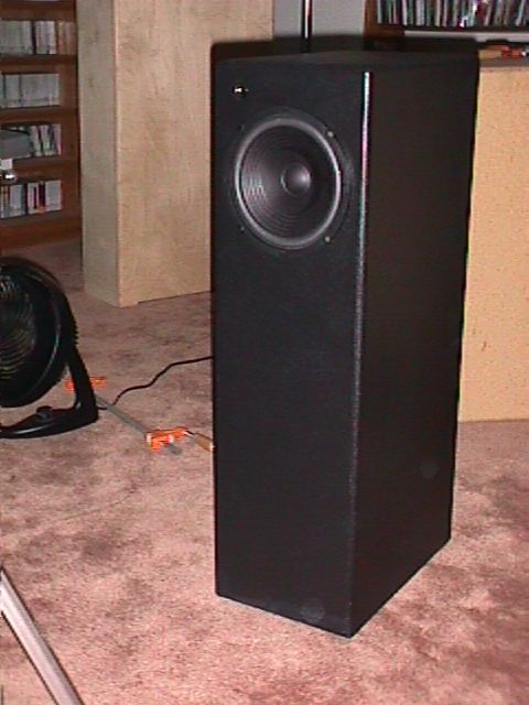

Today I got to work on these a little bit more. I cut the hole for the vent, not easy when going through 1.5" and now I have hooked up the tweeters. The bass is much more full and the tweeters add a ton of detail that the woofers miss. I just started listening, but the bass is very powerful the the vent somewhat open, but the bass is much more loose. As soon as I try my bass cd I'll be able to give more feedback.
I also got to use my flush trip router bit quite a bit and all the edges on the boxes are nice ans square.
Does anyone know how I can get my vent to be nice and square? My flush trip bit won't work when the wood is 1.5" deep.
I'd like for it to look something like the picture below (from my wr125s)
Thanks,
Josh

For 42L, a 2" dia., ~2-4" long vent near/at the bottom front is required depending on actual net Vb, driver's specs and how acoustically solid your corners/wall are. Since they're not evenly boundary loaded, the corner unit will in theory require a lower Fb (longer vent) to tonally balance it to the mid wall unit's midbass, so tune it last.

edjosh23 said:PS: Any suggestions on cutting my vent opening?
Greets!
Make a template to guide your router and use a 1.5" spiral downcut bit:

I wanted to use a flush trim bit so I knew it would be perfect. I was thinking something more like what is on this page
R47126-2
$66.69
FLUSH TRIM XTRA LONG. 1/2" CUT DIAMETER, 2" CUTTING LENGTH, 1/2 SHANK, 4-1/4" OVERALL LENGTH.
but that is too much money.
Any other suggestions? Or router bit companies that are inexpensive?

Then why didn't you tell us what you really wanted to know? Anyway, I imagine there's some inferior bits available, but even if I knew a supplier I wouldn't recommend them since I've seen what a broken bit can do to the human body (fortunately not mine). BTW, what would the roller ride on?

The problem is yes that it would have to be long and because of its length more unstable.
There is a vent piece and the bottom of the enclosure. On my enclosure for my wr125s I used a flush trip bit again using the vent piece and the bottom of the enclosure as guides and it turned out very well (I think) (the picture earlier). The endges are a little bit rounded, but all the lines are perfectly staight and I think they look really good. by the way, the sides of the enclosure are the other guides for the bearings.
