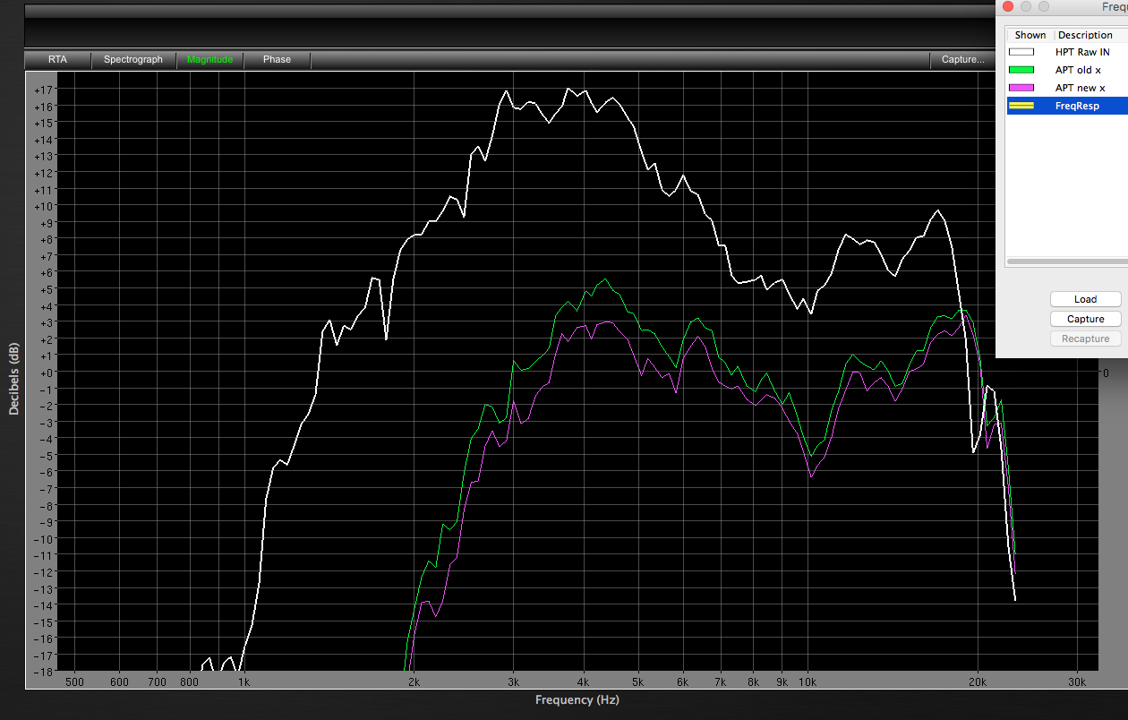

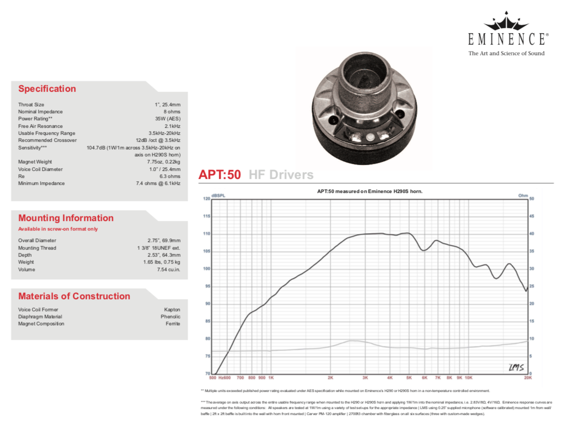

Caramello,
I have used the APT-80 in a number of loudspeakers. Decent driver for the price, but I don't think the UHF output would be near that of an array of KSN 1165.
I would not use KSN 1165 for any "Hi-Fi" use, but for annoyance factor, they rate very "high" ;^).
1) Since the KSN 1165 is around 30-50 ohms at 20kHz, around 8 volts would be needed for "1 watt", the "93dB sensitivity" is more equivalent to 100 dB. Using 8 drivers would increase on axis sensitivity by around 9dB, near 109 dB.
Some good information here about similar piezo drivers:
Pulsar Developments Ltd - Piezo Tweeter Application Note
2) The relatively high VHF sensitivity is due to narrowing directivity.
3)All of the dozen or so APT-80 drivers I owned had rapidly falling response past 17kHz.
The look more similar to the APT50 measurement on the H290H horn, which has around 95dB sensitivity at 20kHz after the 17kHz peak.
The measurements below were of a APT-80 with no crossover (raw) and of two different crossover designs used in stage monitors.
4) Fairly typical, though other manufacturers "sensitivity" may use 2.83 volts for lower impedance drivers. As mentioned in #1, Eminence would use a much higher voltage to measure a driver with equivalent impedance to the KSN 1165.
5) The APT-80 VHF dispersion is similar to the KSN 1165, the throat angle of the APT:50driver itself being roughly the dispersion at 20kHz. In fact, the horn used on the driver will have no effect on the VHF response, for use at 20kHz the phase plug assembly virtually is the horn.
6) The APT-80 coil will burn if used much more than it's rated 35 watts, about 17.75 volts RMS at 20kHz. The voice coil heating will raise it's impedance considerably at that drive level, reducing sensitivity, "power compression".
7) For wide VHF coverage, an array of either driver would be needed.
