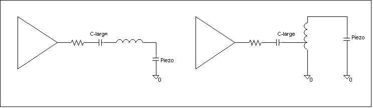

Sorry for being a bit mean but I already hinted at possible solutions before.
If you don't need a wide frequency range you can use the piezo's property of being a lossy capacitor to transform the input voltage to the desired level.
One possibility is a series tank circuit (left) and the other one is a parallel tank circuit with a tapped inductor (right). C-large is there to block DC and might not be needed in some cases (like bridge topologies). Another possibility, though very static in terms of output frequency would be the push-pull oscillator that I once posted within another thread.
Regards
Charles

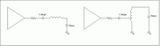

Regards
Charles

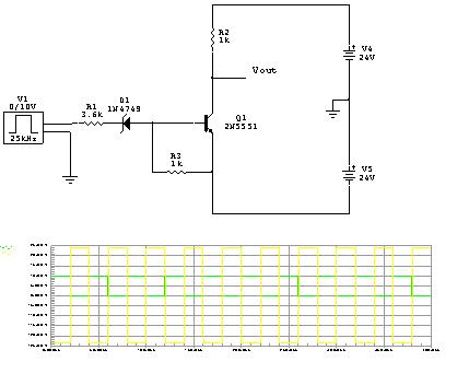

Graham Maynard said:Only there as an example !
Puts 24V square across the piezo without transformer.

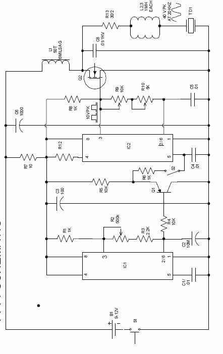

I built the PCB for the attached schmetic of goldxyz with the power supply of +25 and -25 volts. It works fine up to 8kHz
and both transistor pairs remain cool but if you increase the frequency above 8kHz, the output waveform across the load(piezo or resistance) is no longer symmetrical. The negative portion of the output becomes longer than the positive. Also the NPN transistor extremly heats up at frequencies higher than 8kHz.
Still trying to get symmetrical output across the piezo with both cool transistors.
ml342001 said:I built the PCB for the attached schmetic of goldxyz with the power supply of +25 and -25 volts. It works fine up to 8kHz
thank you a lot, ml342001!
you have saved me to build a not good working project.
I'm trying to contact the original maker to see if it has improved his project.
Thanks again
