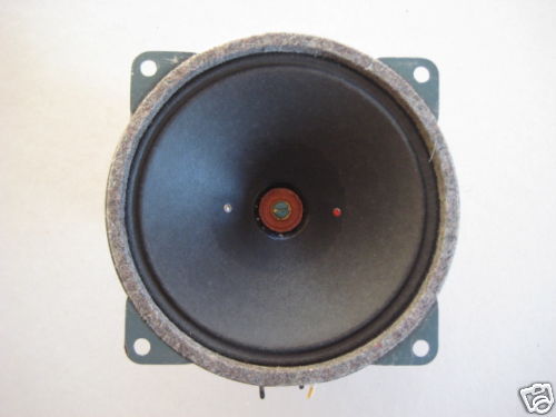

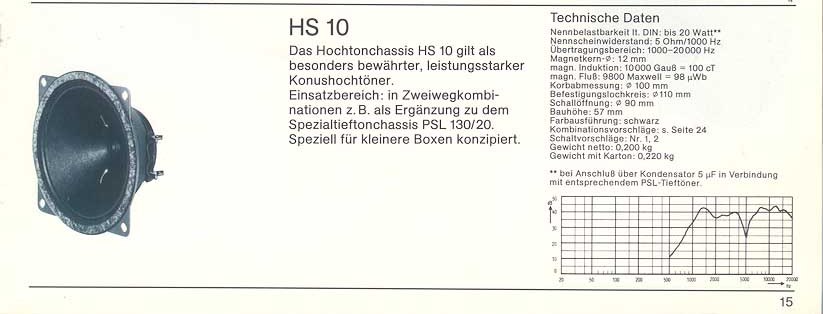

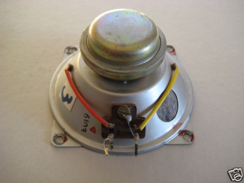

Some people say, this old Isophon HS 10 Tweeter
worked at least partially as a bending wave transducer.
Since i owned (and disassembled one) in my youth,
i think this is plausible:
The rather large cone was made of thin paper, driven by a small
coil from the apex.
Operation without breackup is fairly impossible.
The notch around 5Khz may be due to coincidence frequency.
Maybe the notch looks different off axis, but i havent got any polar
plots.
The tweeter had a high upper frequency limit and less beaming than
the size would suggest.
Sound was somewhat "nasal" as far as i remember, but also rather
brilliant and detailed.

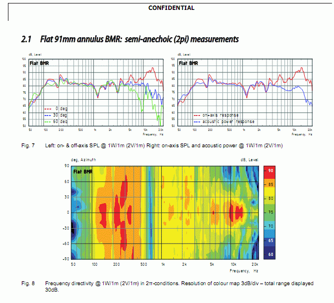

I was quite far off axis when I listened to the BMR, no loss of highs.
I have previous (cheaper) BMR and funny thing is if you measure off-axis then you will see typical roll-off but if you integrate all angles then response is flat - this is modal behavior. I don't know how calculate power response (directivity function integral) - measuring software offers only the power average which is fine for room measurements.
