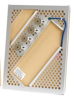

FWIW, I found the attached photo of the rear of a wall panel speaker; any thoughts on why the drivers are offset rather than down the middle?
My answer is: "Because a well chosen excitation point away from
the middle results in a more evenly distribution of excited modes,
which in turn leads to a more flat frequency response and better
transient response."
When the edges are free, excitation from the middle might be
an easy way to get more bass from the panel, but the price
to pay in terms of quality loss is very high ...

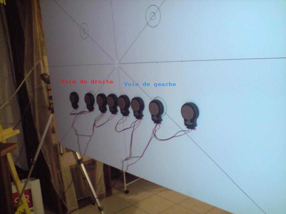

Hello
I have done quite a lot of tests, and, as usual there are some compromises to keep in mind
We want the most of bass extension, the best output per Watt, the widest bandwidth, and as little ripples as possible...
Best bass comes from the center, best highs comes from a single exciter, best output from the lightest panel, plus big number of drivers, best bandwidth from ... I dont know exactly !
today my best compromise is with 2x4 drivers in one single stereo source at 1/3 of panel width.
the main quality of this configuration is "coherence"
but I must admit that I dont like the sound of the panel itself
it is what we call in french "carton-plume"
something like "lightweight carton",
great output, 2x4W is enough to drive my neighbourghood crazy,
but not so nice sounding
I have to find a better panel, here in my Island, a not so easy task
