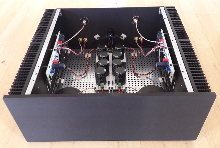

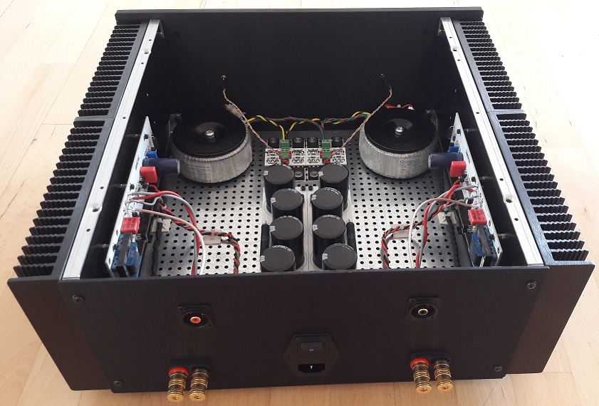

A few pictures of my finished M2......maybe a bit boring in standard case, but then easier to finish the project. My first diy power amp. Now I'm just in need of a DIY preamp......it never ends :scratch2:

Absolutely beautiful!!!!
You don't want to stack the enclosures like that in use, I've found the Pearl is genuinely quiet only when the power transformer is 1M away from the RIAA boards. But it's eerily silent. :yes:
I am trying, thank you :p
Very nice tanwa. Where did you get those cool enclosures?
I got them from seller in China. You may easily search in Ebay.

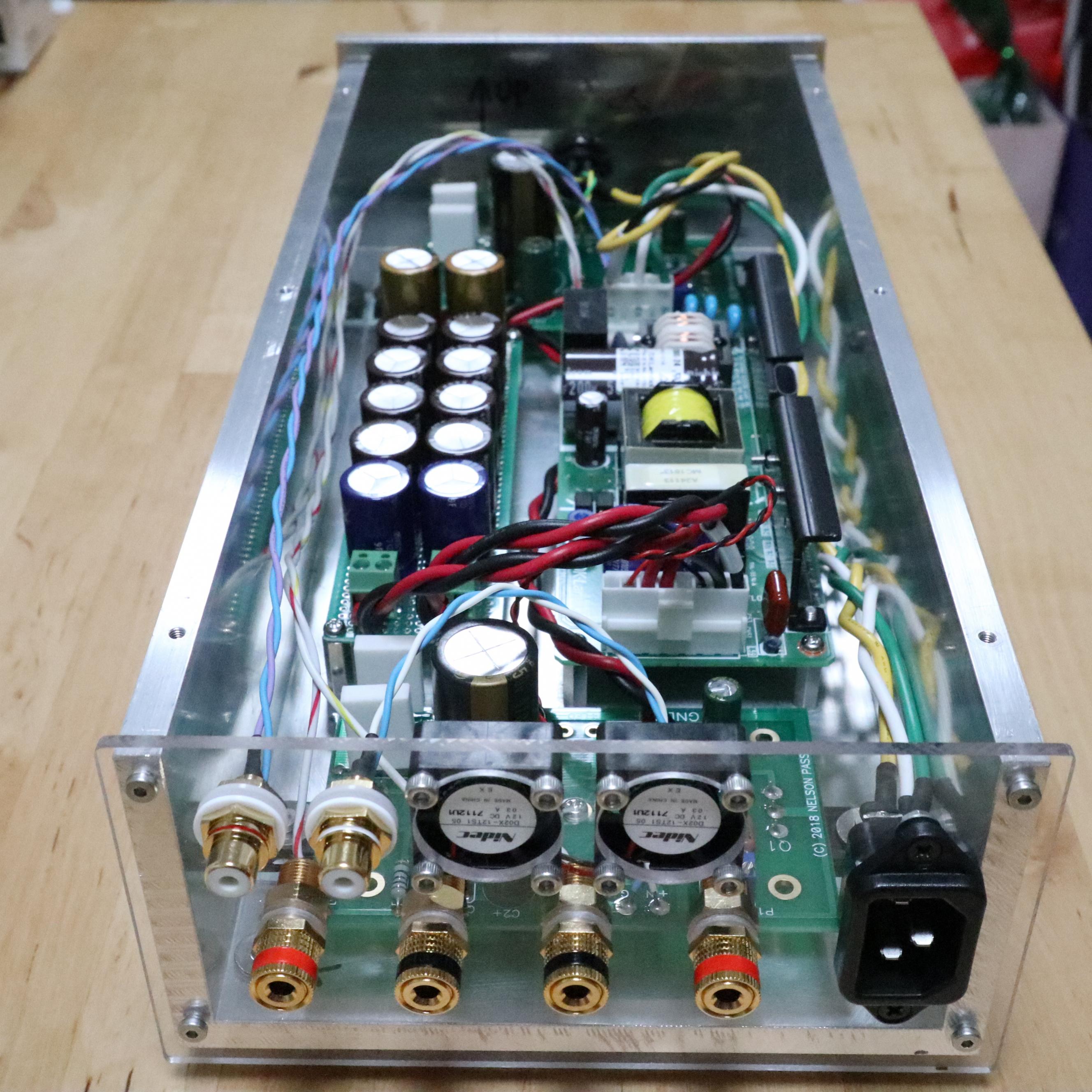

ACA

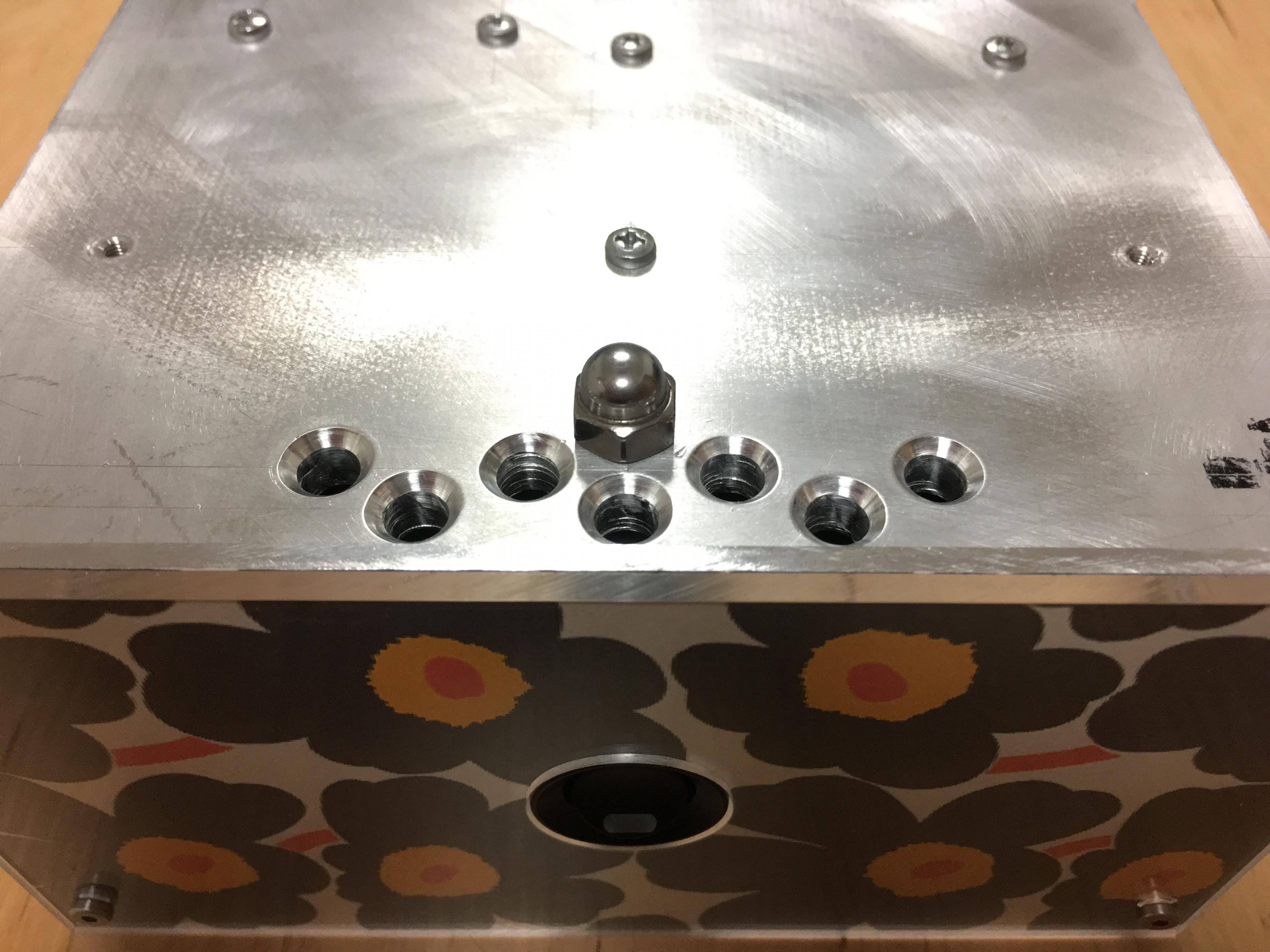

This is an ACA packed in a small case.
I bought the PCB from the DIY audio store, and I chose the other parts and switching power supply by myself.
I do not like the appearance of heat sinks and fins.
So I chose extruded aluminum (150x75x320mm,thickness 8mm,2kg) as the case.
I installed two small fans to improve heat dissipation.

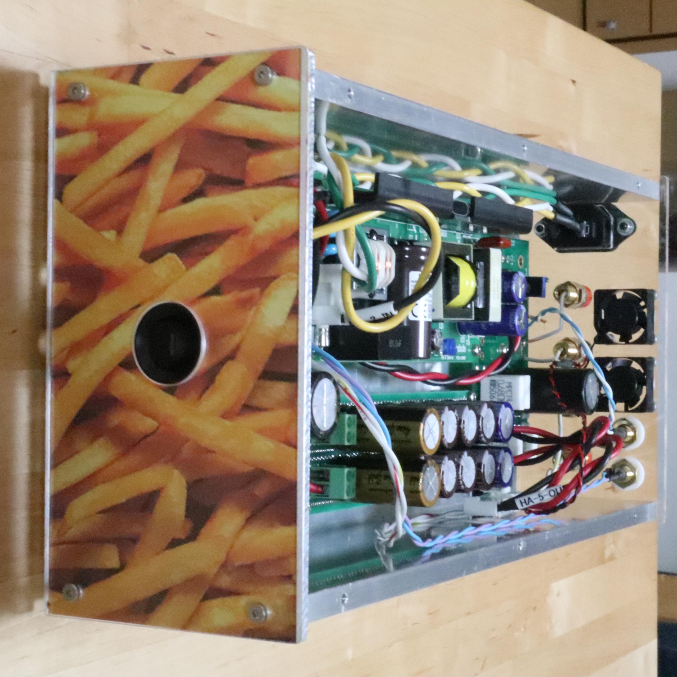

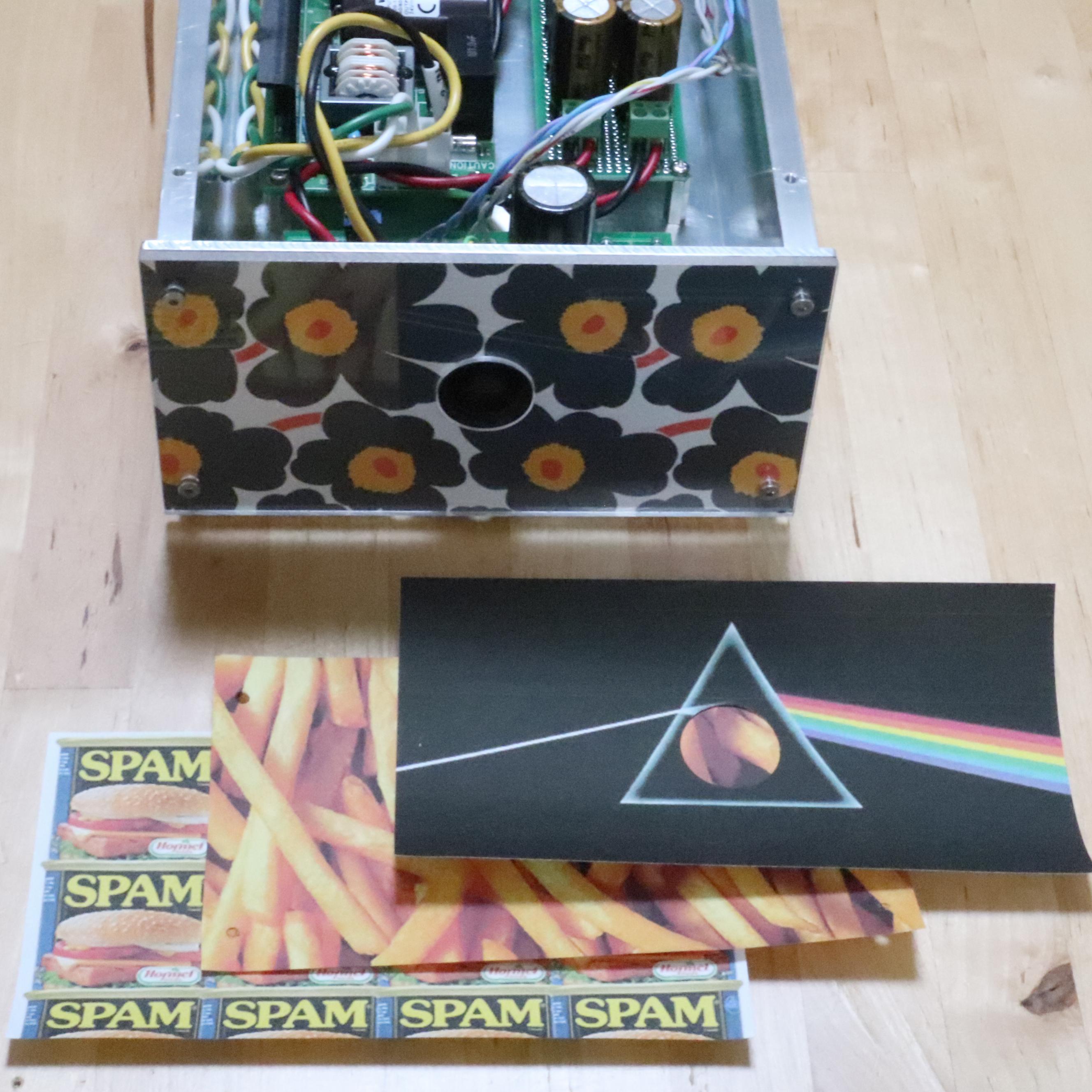

The front panel has a two-layer structure of aluminum and transparent Plexiglass,
so I can change the face by sandwiching photos or something between them.

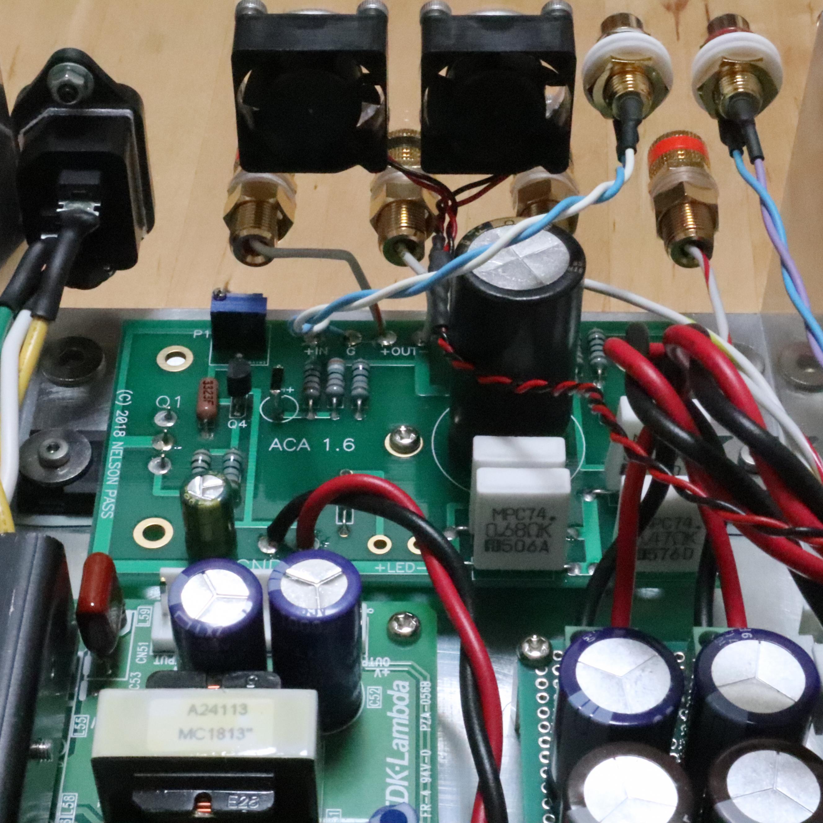

Many CRs are Japanese audio grade.
Resistance: Takman / REY50, Futaba / Metal Plate Cement (R1-4)
Cap: Nichicon, Rubycon / PMLCAP (C3)
I increased the Cap of the power supply (28000uf). There are no other changes.
I am satisfied with the sound quality very much.
But, as expected, the case gets terribly hot (~65celsius?).
I think the internal parts are fine as the fans circulate cold air, but I am not confident...
Thanks to Nelson, 6L6, the community for making this possible.

yoshida, your amp is lovely. But you are not circulating the air, either pressuring or evacuating the box. Make some intake on the front floor of the box so the air can be drawn or blown over the base plate.
You may want to try a better thermal coupling with the side panels and use a bit of silicone grease and even two more bolts couple harder in order to increase that heat sink surface area.
Your front panel explains your concerns. :D
On the other hand 65 degrees centigrade is not that hot, only the cooler the components, the longer they last and prevents you from dropping the amp when it burns your hands after picking it up. :(

I believe that those Aluminum side panels would make 'Good' heat sinks.
IF you fixed the output devices onto them... without using fins and Fans

Wonderful enclosure! Beautiful construction!! :yes:
The advice to make more ventilation is very good - Perhaps the easiest is to add 3mm washers in between the top of the side rails and the lid; this will give a large opening for air to move freely. The fans can only move as much air as the aperture!
