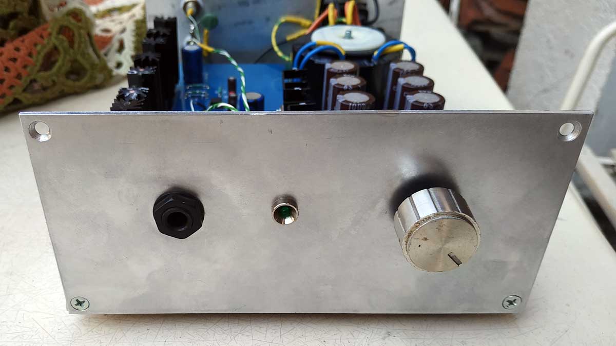

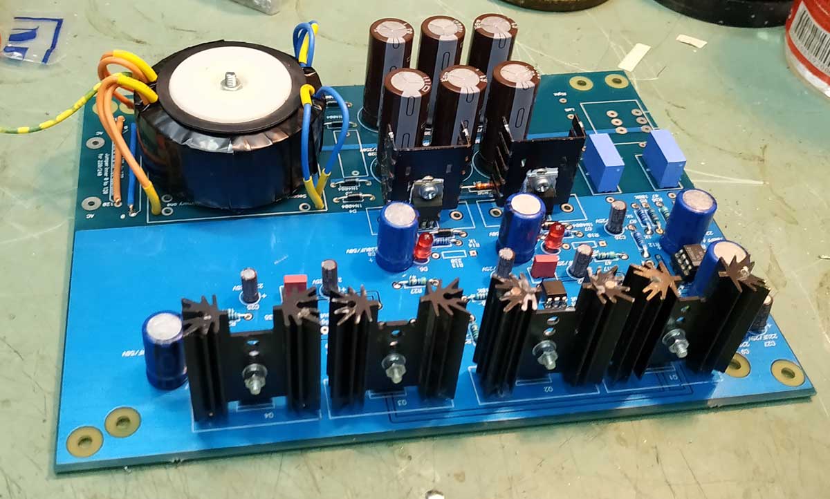

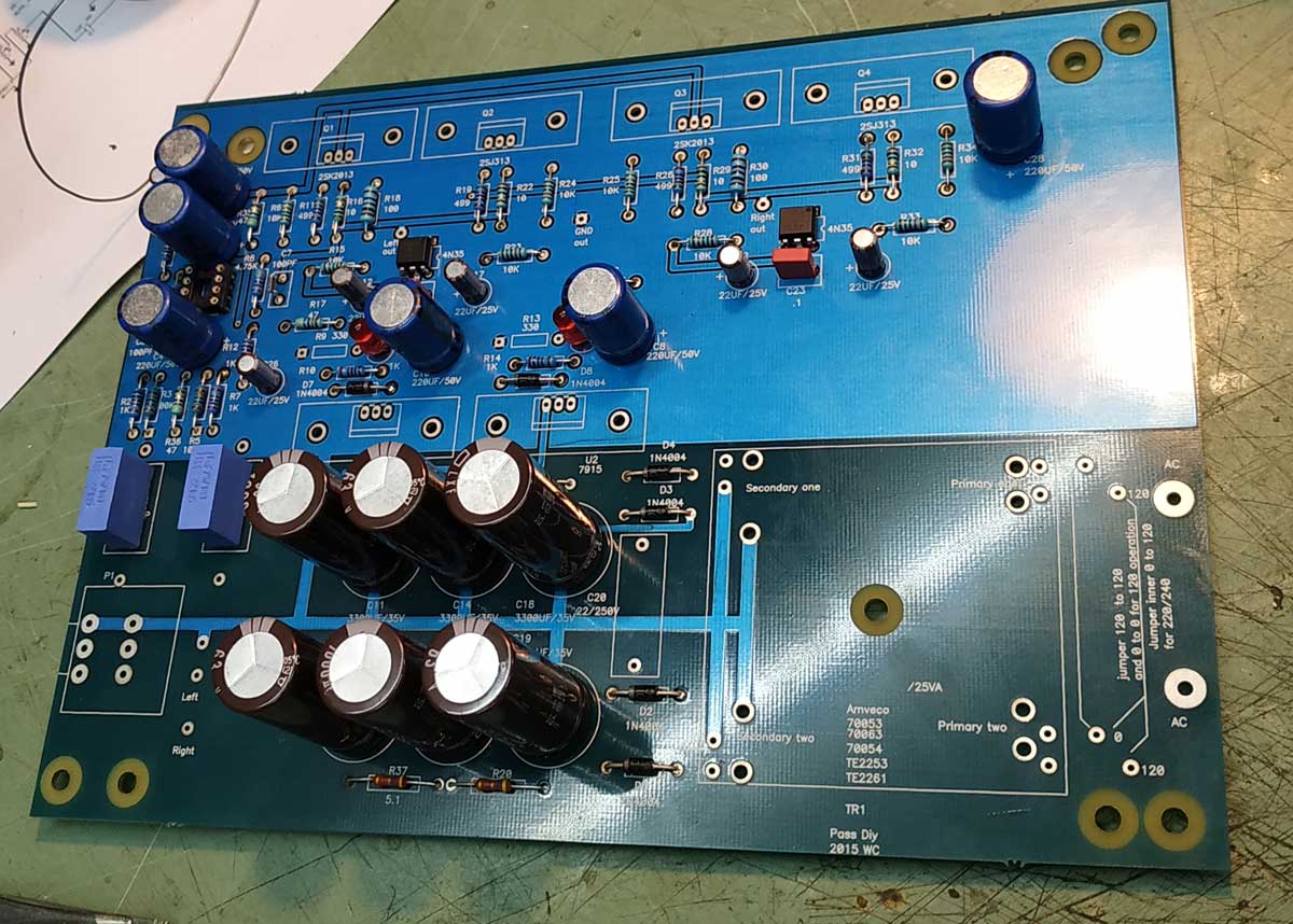

Wayne's headamp for Kiddo

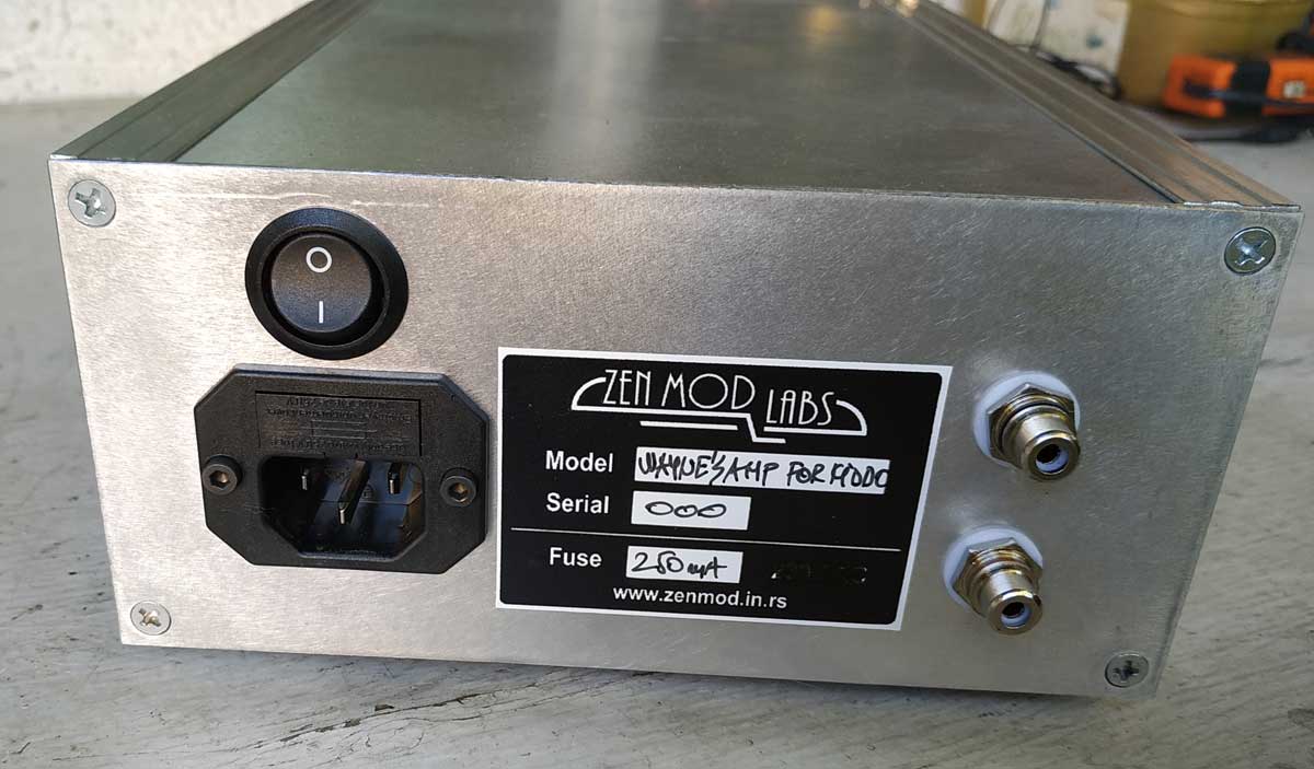

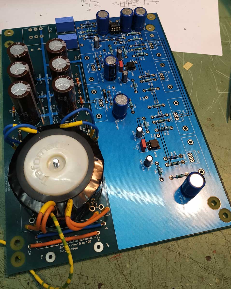

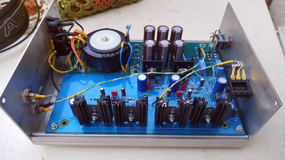

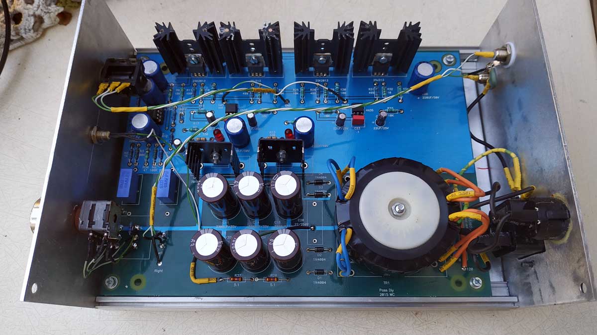

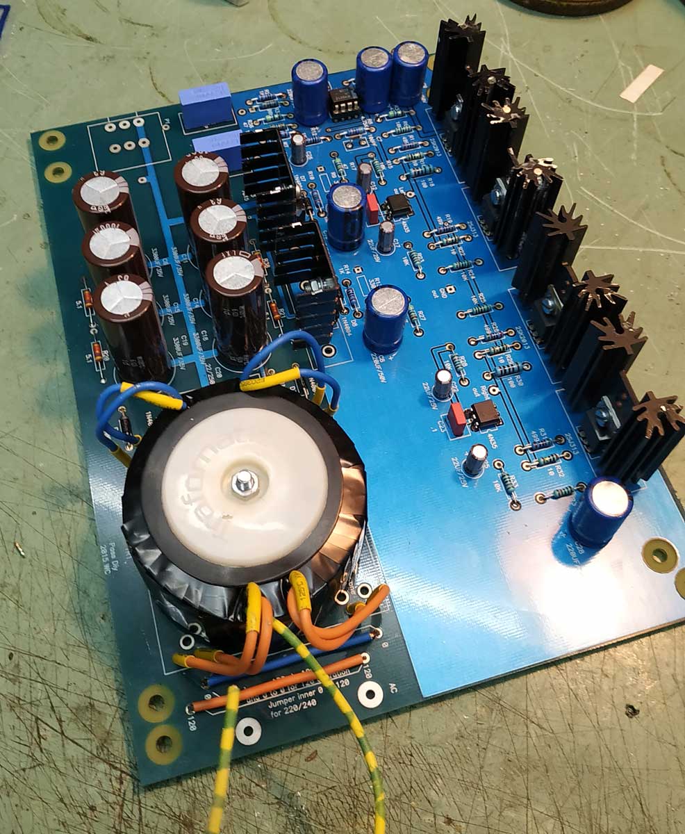

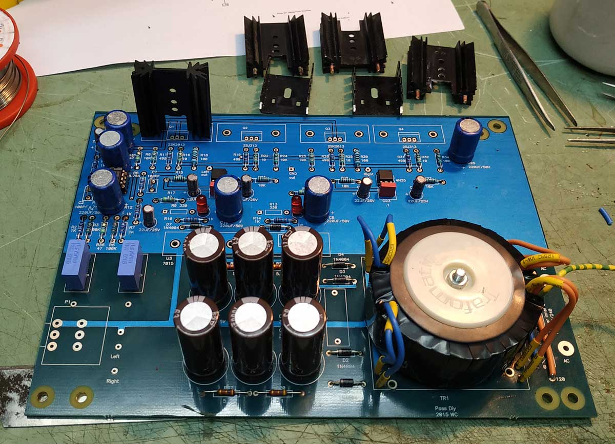

Have a Nephew moving to States in few days ,he was there for a year or so and succeeded in complicating own life , falling in love in Florida
So , I promised to make him head-amp to bring with him.
'nuff said , except - Kudos and Thank You - to Wayne , straightforward and easy , of course that you can't expect anything else from Funny Firm

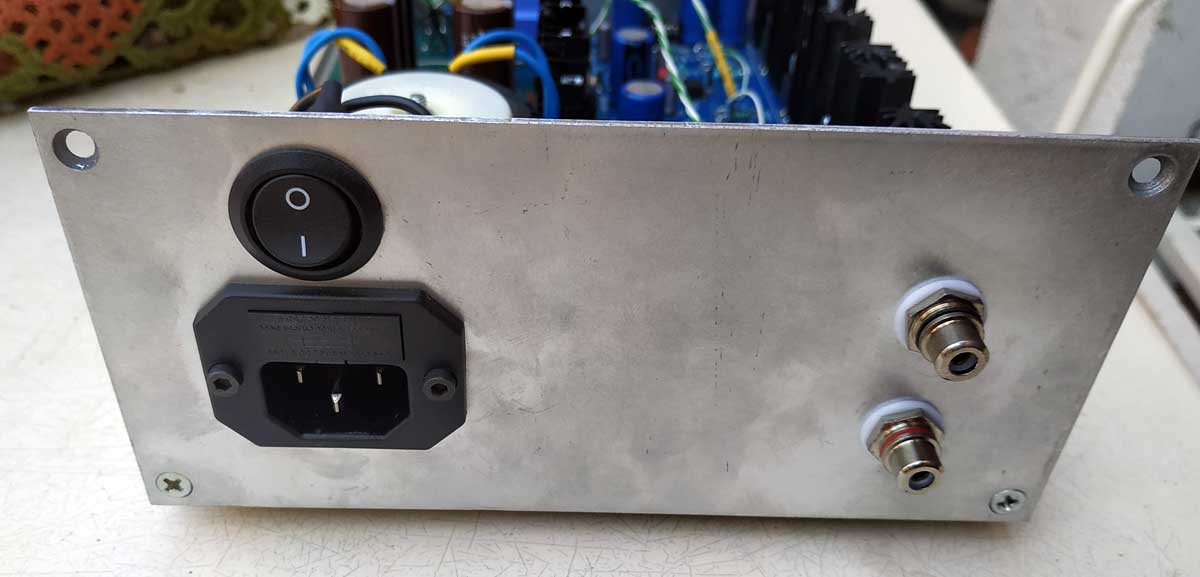

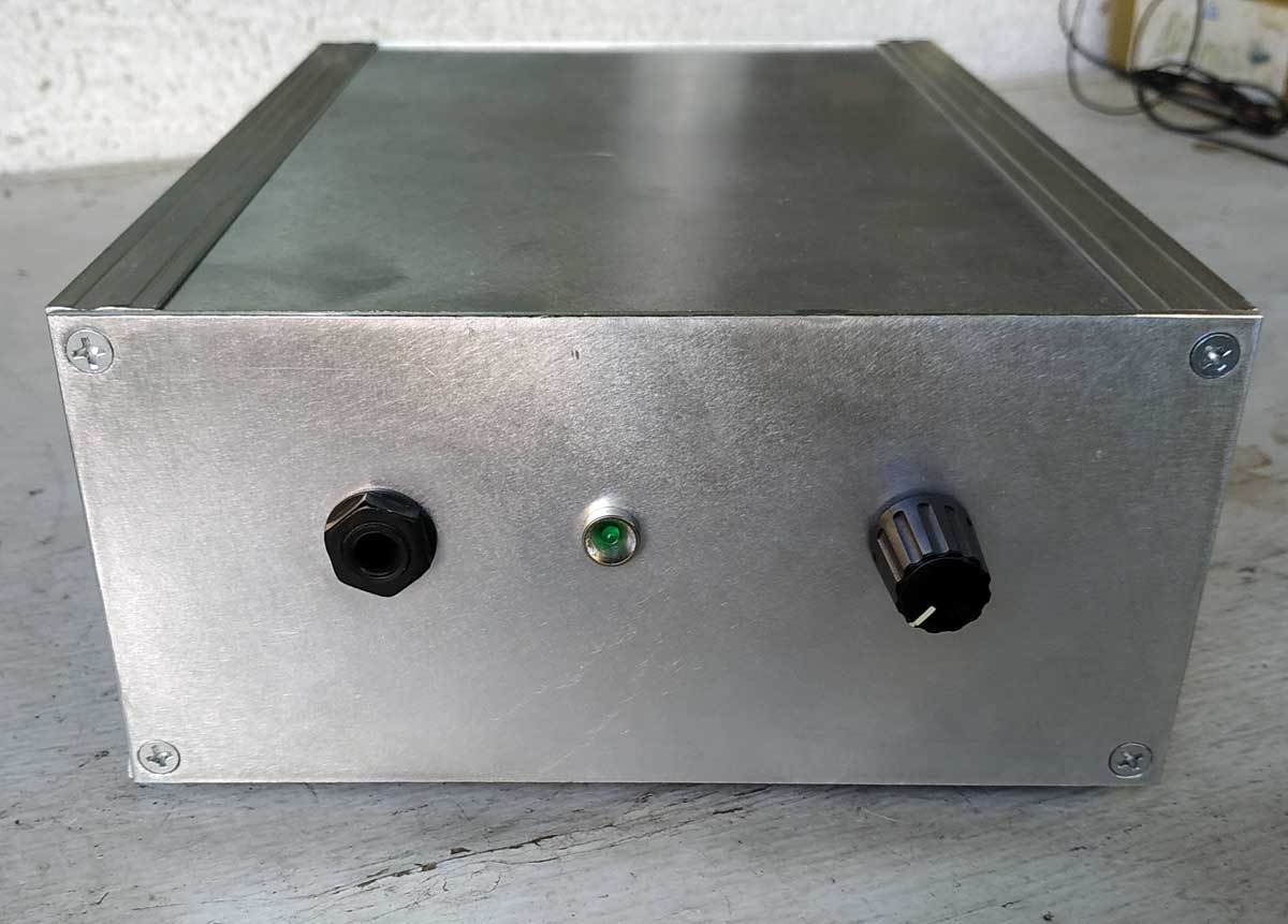

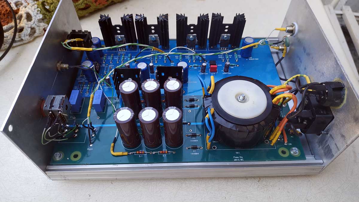

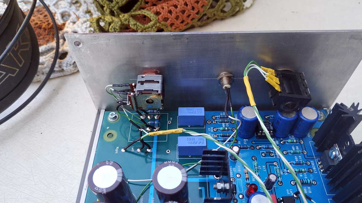

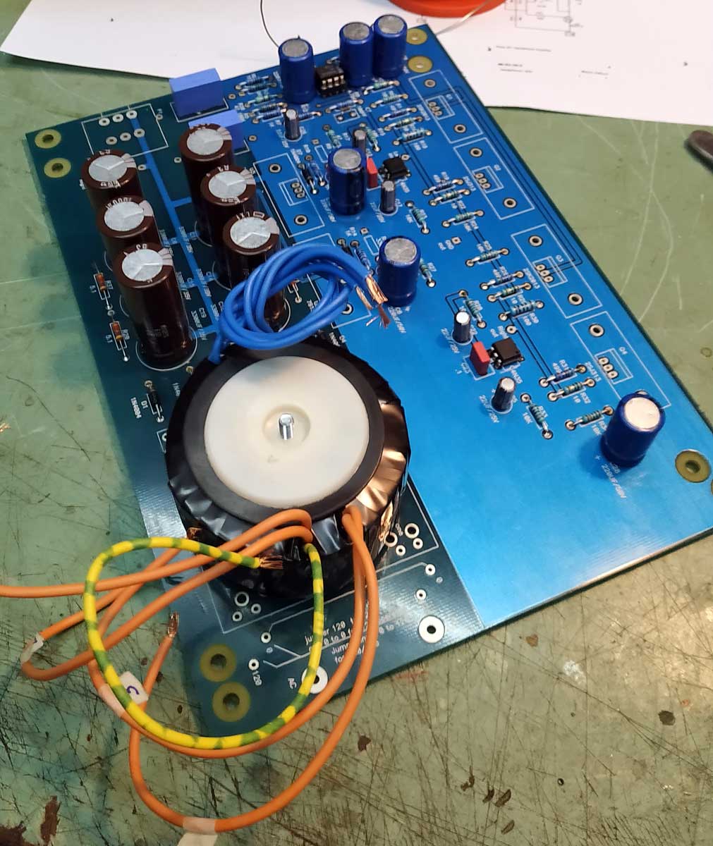

My build is , in fact , pretty much quick'n'dirty approach - changes on the fly .... somewhere smaller caps , somewhere larger caps, regs ditto to 15V (Donut is dual primary wired for 115Vac , but secs are nominally 15Vac) , pot is clickety 220Klin jobbie , shunted with 33K so pretty nice log law with precise channel balance ... old heatsinks , raw case etc.
sound is good , everything stable , no problems

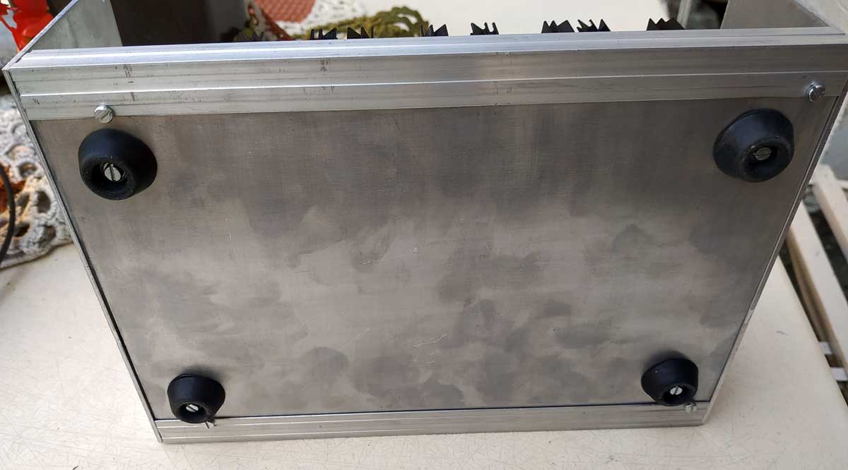

believe it or not , Al knob (4mm shaft , so that causing troubles with knob choice ) is from olde Korting A100 integrated
hm, even mentioned 220Klin pot is from same amp , superduper quality , seen low action , being either treble or bass
salvaged several of these amps during the years , mostly as trash bin parts donors
however , they had nice potted Donuts (one per amp) and 2 of these are proudly powering my DEFiSIT now
will change vol button for something nicer , as soon I find where I left small bag of 4 to 6 shaft adapters (sleeve, practically)
