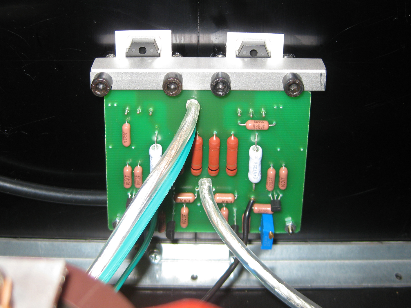

why you choose to use styrofoam between your mosfets and heatsink ?
Your heatsinks get not so hot!!

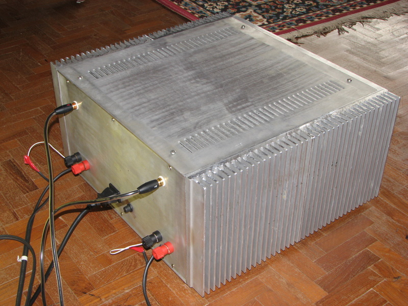

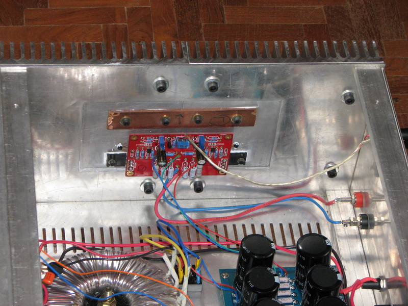

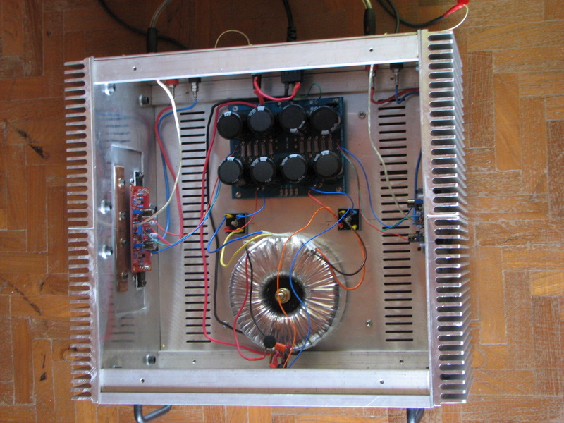

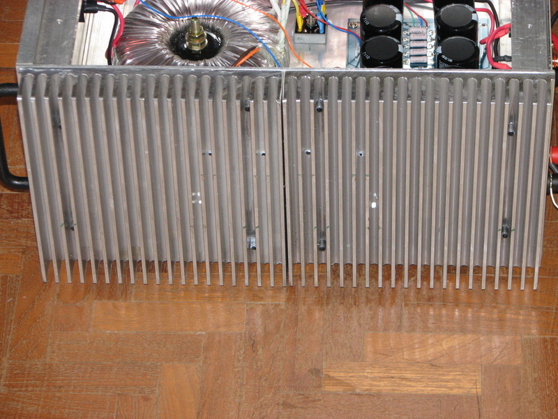

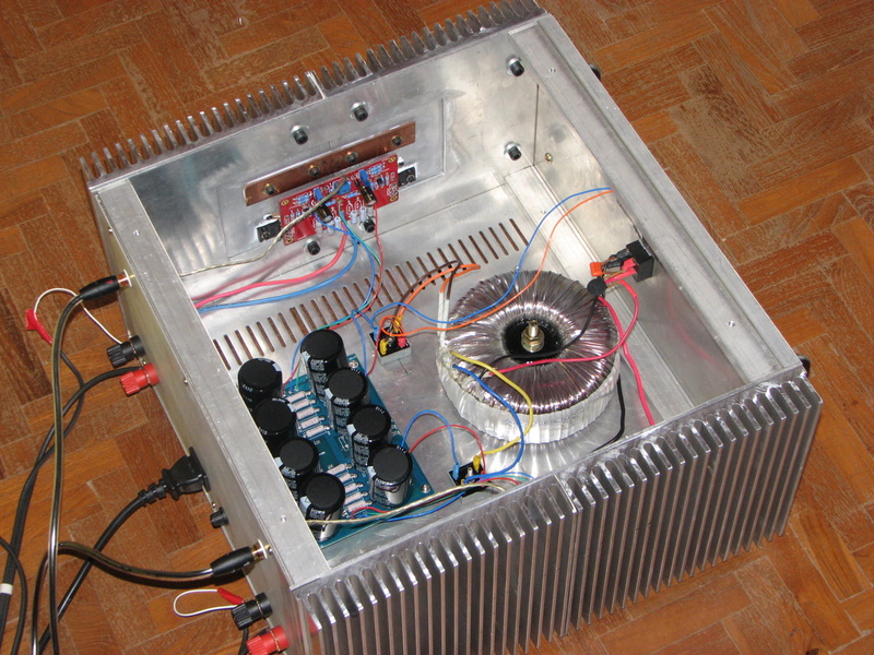

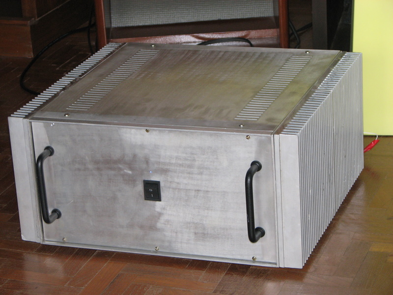

My F5 clone effort
After more than 6 months, I have managed to bring the F5 clone project to a closure. Very satisfied with the outcome in terms of sound quality and experience.
Totally new level of sonic experience listening to this amp through my FE206E back loaded horn fullrangers. Though I am getting used to signature F5 clarity in the middle and upper frequencies and slightly weaker bass.
The entire design is fully to the spec and no mods. Set up was a breeze. Heatsinks are extra large (two of them coupled by a copper flat for each side). After 2.5 hours the amp gets moderately warm and I can touch the heatsink for a long time without burning myself.
Thanks to Mr. Pass for this great design and all the experts on this forum, whose posts have helped me immensely in executing this well.
Cheers.
Cheers.

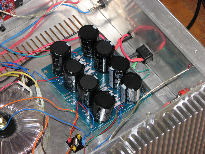

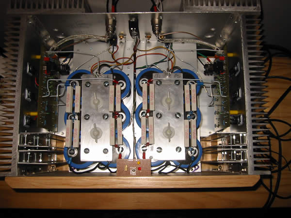

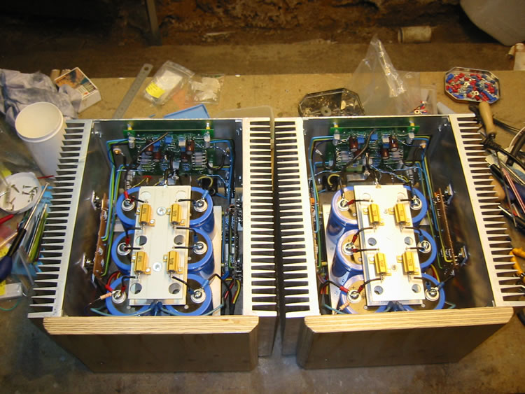

F5 clone

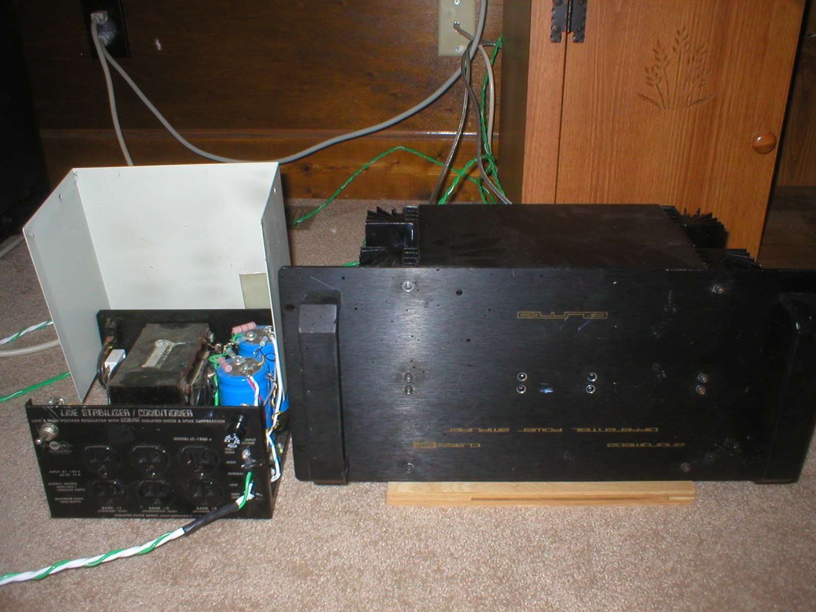

I reused a Sumo Andromeda case for my F5. I use a 1/4" 4" x 8" block of
copper as a heat spreader on the heatsinks and used high preformance
insulators. I used the case from a bad power stablizier for my external
power supply. The external power supply has a pair of 40,000uf caps then
in the amp case I use a pair of 15,000uf caps for each chanel decoupled
from the external power supply with .1ohm resistors. Thanks Nelson for
letting us have this fine design!
RE: My F5 clone effort
Hi Anil,
great work, I bought the F5 PCBs long time back but never had chance to finish it. Given the parts and resources availability in India, your build is great. Just one comment, tidy up the internal wiring, route the wires along the edges it looks even greater then. Have fun.
Thanks,
Routhun
Hi Anil,
Thanks,
Routhun
Show us the porn, we all want to see that copperI reused a Sumo Andromeda case for my F5. I use a 1/4" 4" x 8" block of

Thanks. I agree, I need to tidy up the wiring. Now that the amp has stabilized, I will use some cable ties.
Cheers.

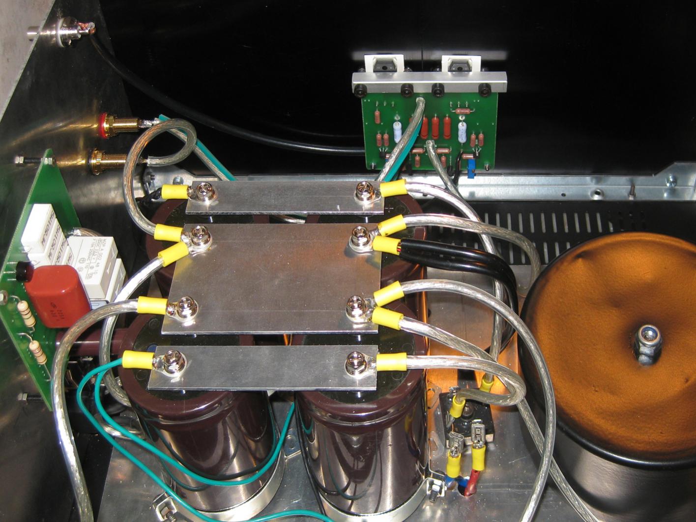

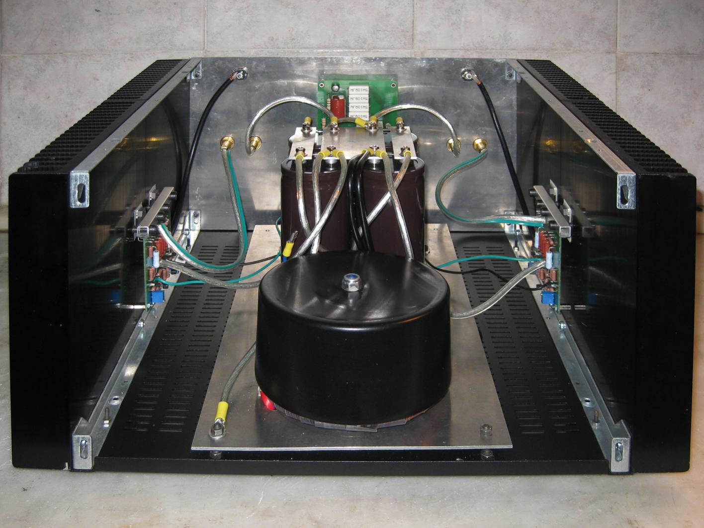

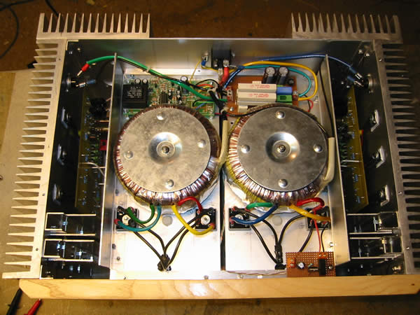

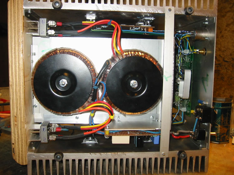

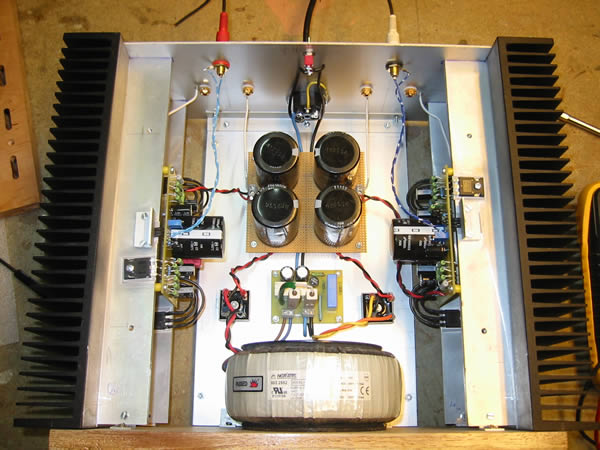

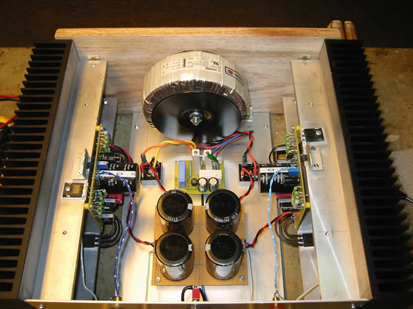

Under the capacitors you find the two 600VA transformers.
You can see it on the picture.
The complete weight is 51,4 kg
The torobars are cooled because the high current (7A).
They are thermally coupled with the U-shaped Heatsink. You see it grey between coils and the Heatsink.
The black heatsinks over the coils are for the softrecovery rectifiers. They need good cooling.
