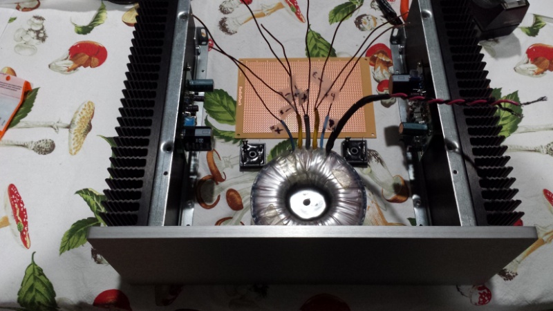

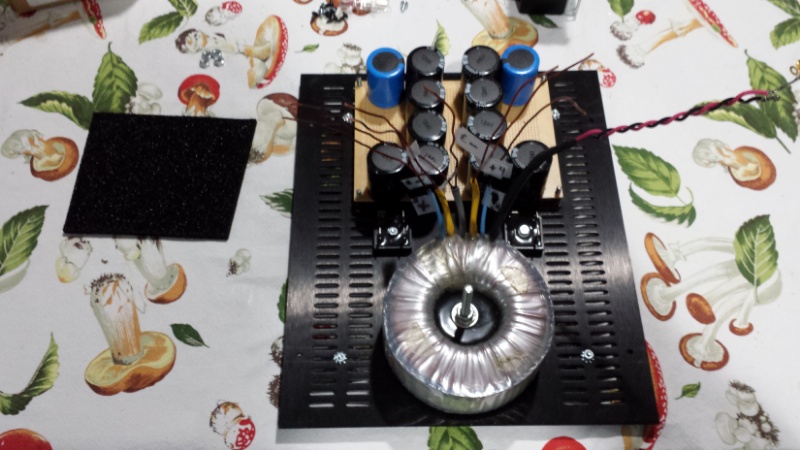

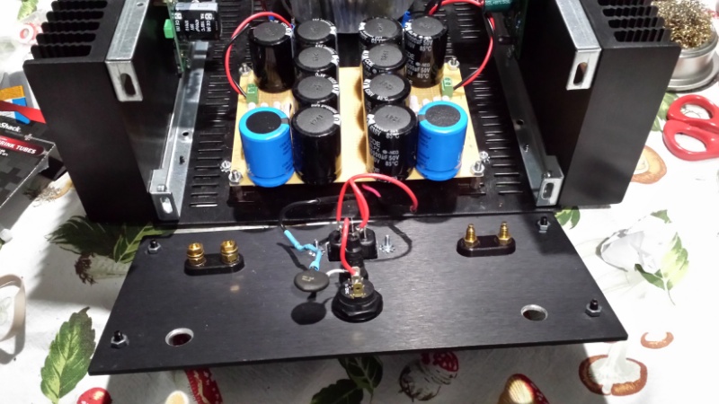

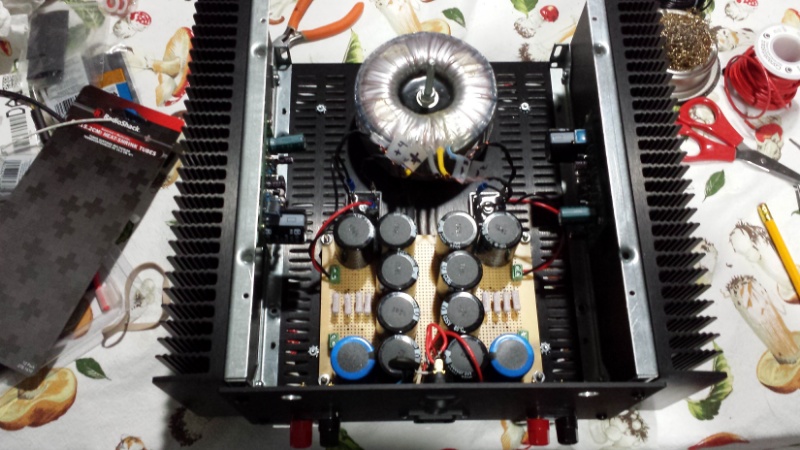

Some pics of my ACA build.

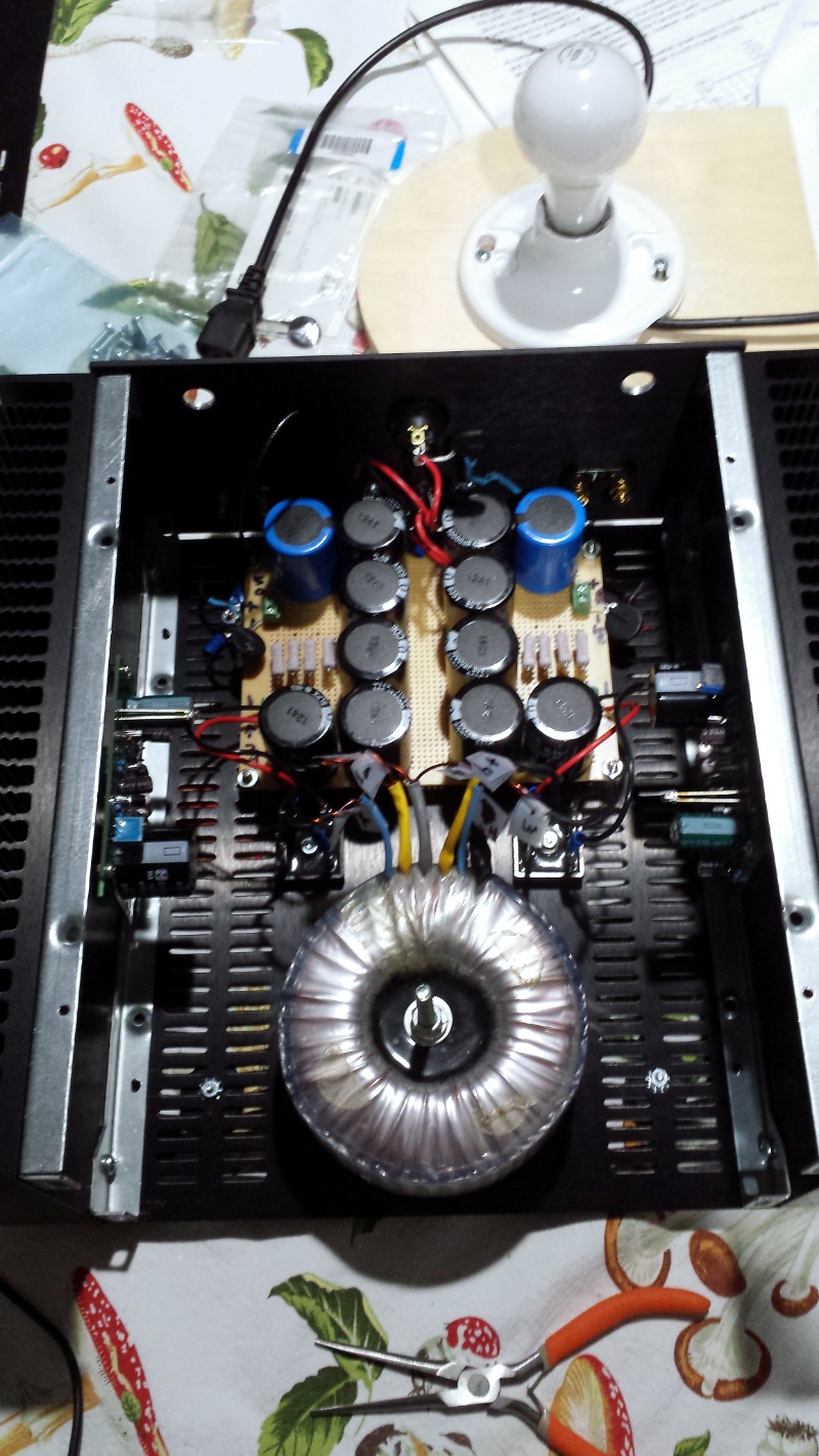

The transformer has 4- 15v outputs. They were not labeled. Its 286VA or so. Had to use a variac to find the polarity of the secondary. Primary only has two leads for 120v. They were easier to detect correct connections.
Secondary pairs are in parallel.
The case is a 3U mini-dissipante from the store.

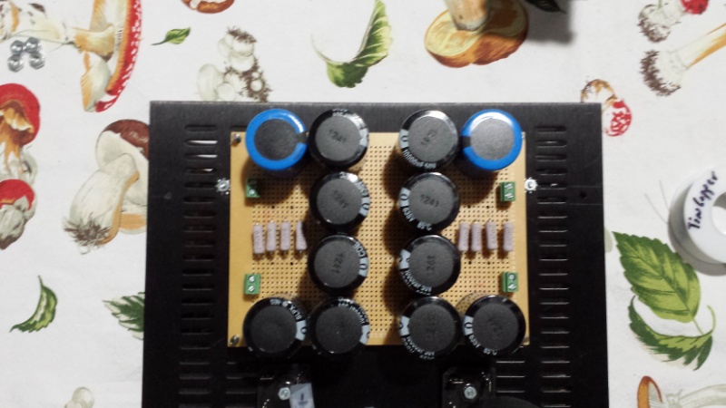

Power supply used 60k uF CRC per channel. Blue cap is the same size, voltage and temp capacity as the black filter caps. 21V unloaded and 17.9v loaded power supply output.

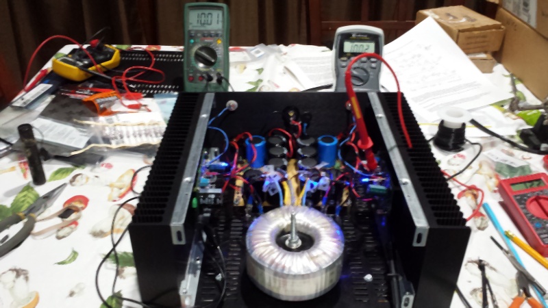

Used irfp140 mosfets. I first mistakenly installed irfp9140 on Q2. I checked 3 or 4 times before installing but got confused anyway. Once the washers went on, there was no more checking... the power resistors burned and had to replace them and both mosfets on both channels.
The input and output caps are bypassed with Vishay/Roederstein 1uF caps.
Used standard bridge.
Vince
