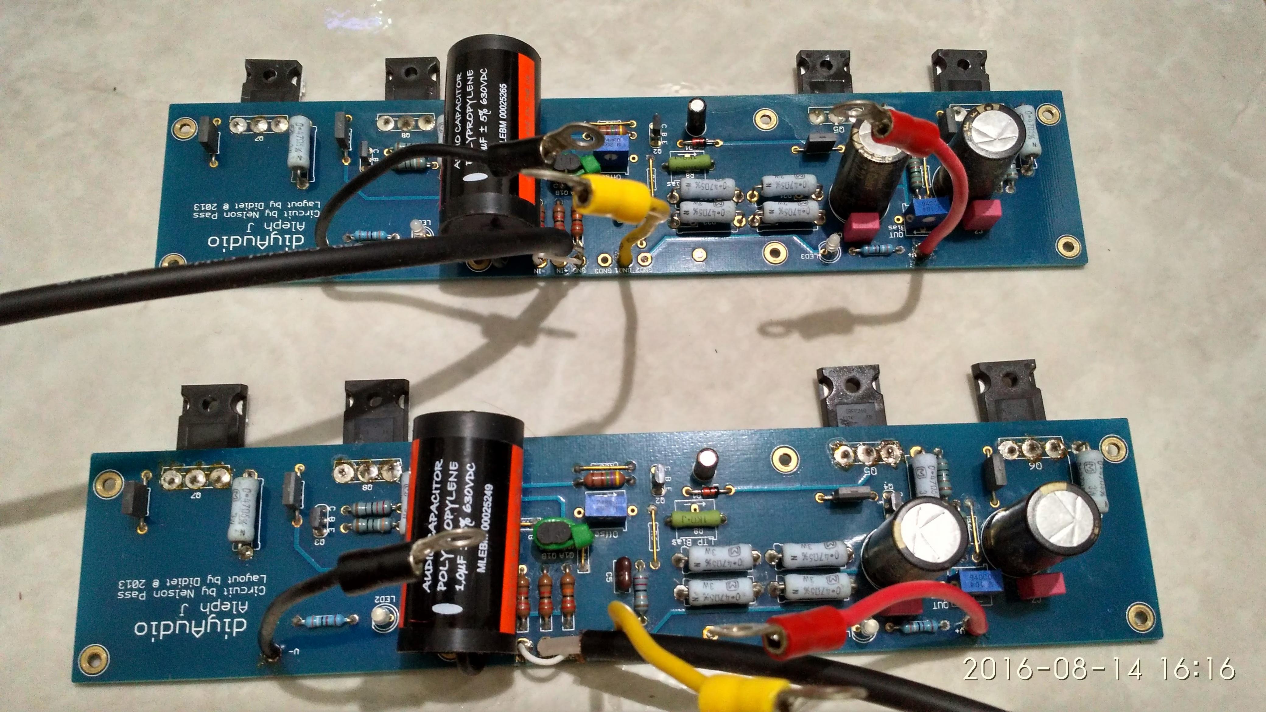

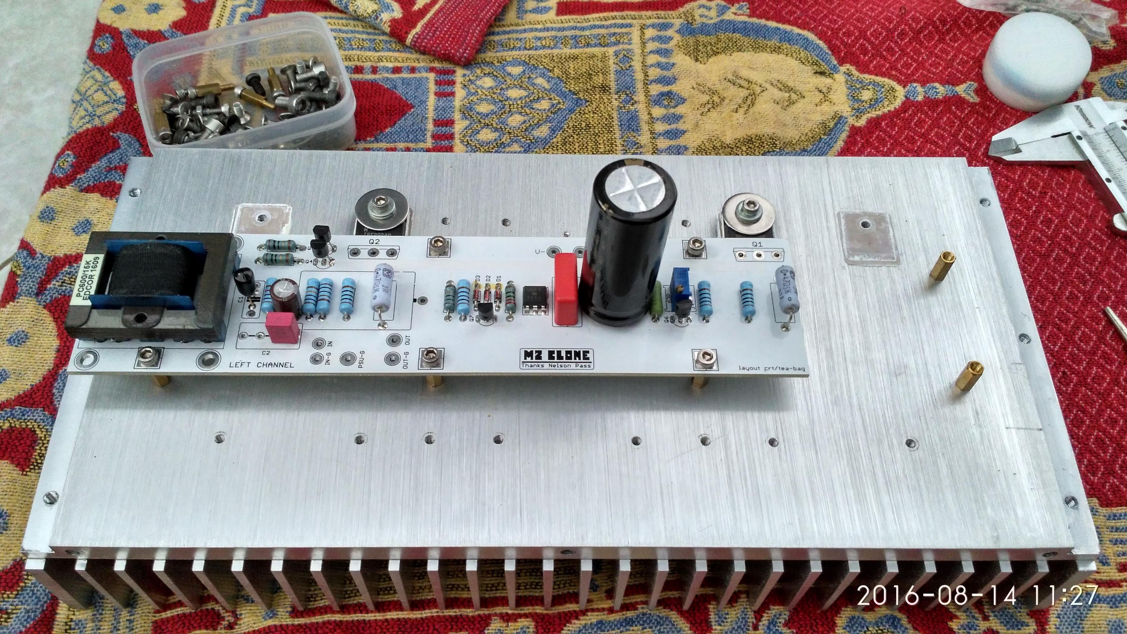

I have populated M2 boards months ago, but too lazy to take out AlephJ board from chasssis. I thought M2 pcb need extra holes, but today I realize that i was wrong, I can put M2 directly to the same UMS holes that I have drilled :p

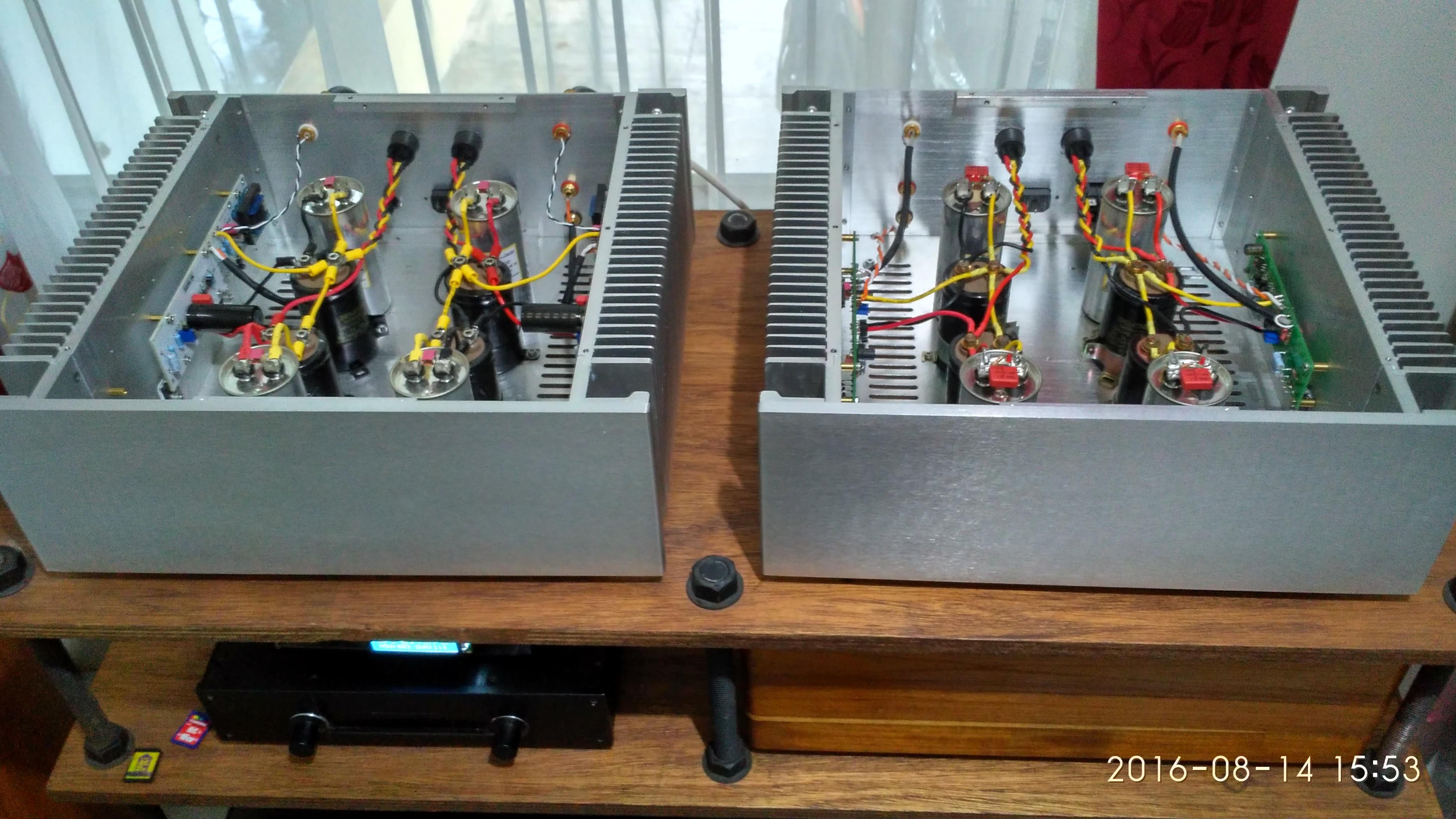

Before taking out AJ to be replaced by M2, once again I want to compare AJ and J2 side by side where AJ is connected to left speaker and J2 on the right side. my ears say that AJ has a sharper high, where J2 has a smoother high, and J2 produce better vocal. J2 is the winner here. Now AJ will be an orphan board without chassis.

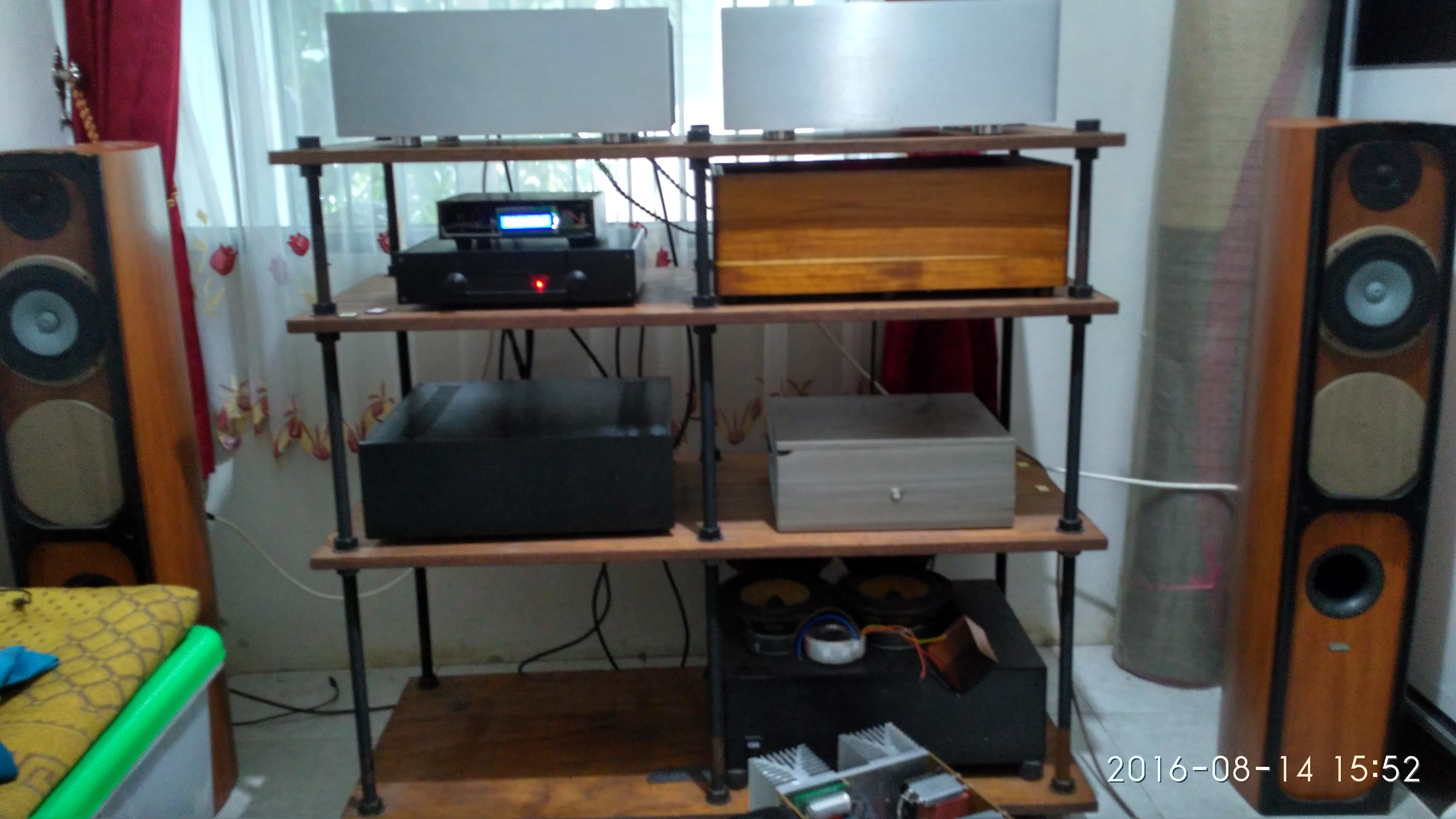

Now it's time for the moment of truth, J2 vs M2, SE vs PP. my speaker is Alpair10 using temporary floorstander box, tweeter is used with 1uf caps in series.

I played several Audiophile songs, for sure they are good recording, I switch between M2 and J2 for several times (that's how separate chassis play his role, I still can't find why I should keep M2 :bomb: J2 again wins on impressive and smooth high, nice vocal, low bass seems on the same level.
I think it's time to change the songs, play non-Audiophile recording.
Started with Coldplay (Ink & Sky full of starts), now with fast beat music, M2 give better low bass control, J2 seems lagging.
played Offspring (Want You Bad & Why Don't You Get a Job), with faster music, M2 wins here :D

Such a beauty Gadut.
thanks, eventhough the pictures are ugly using smarphone in low light room. I wish i still had my Nikon D90+fix 50mm which was sold to start diy years ago 😞

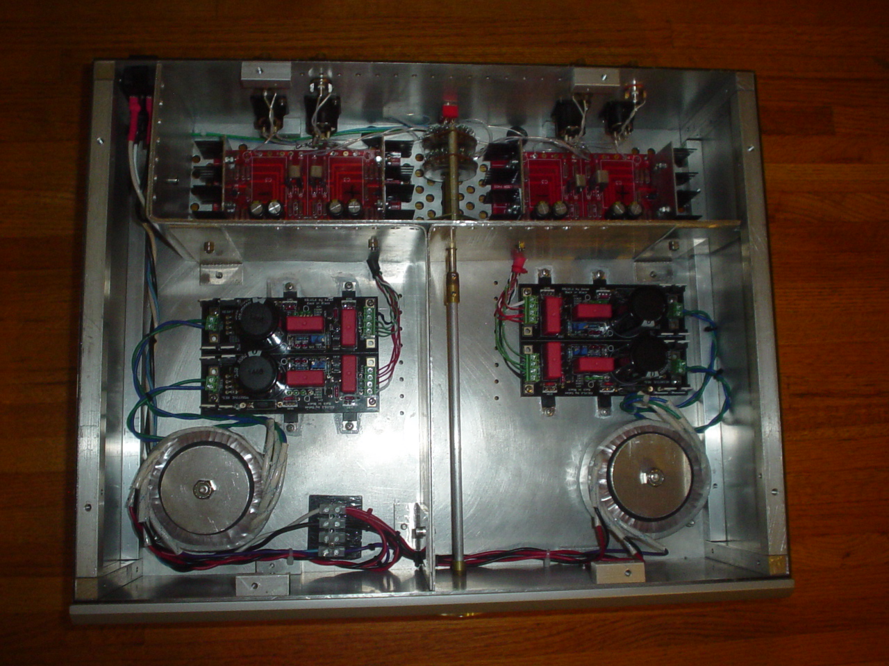

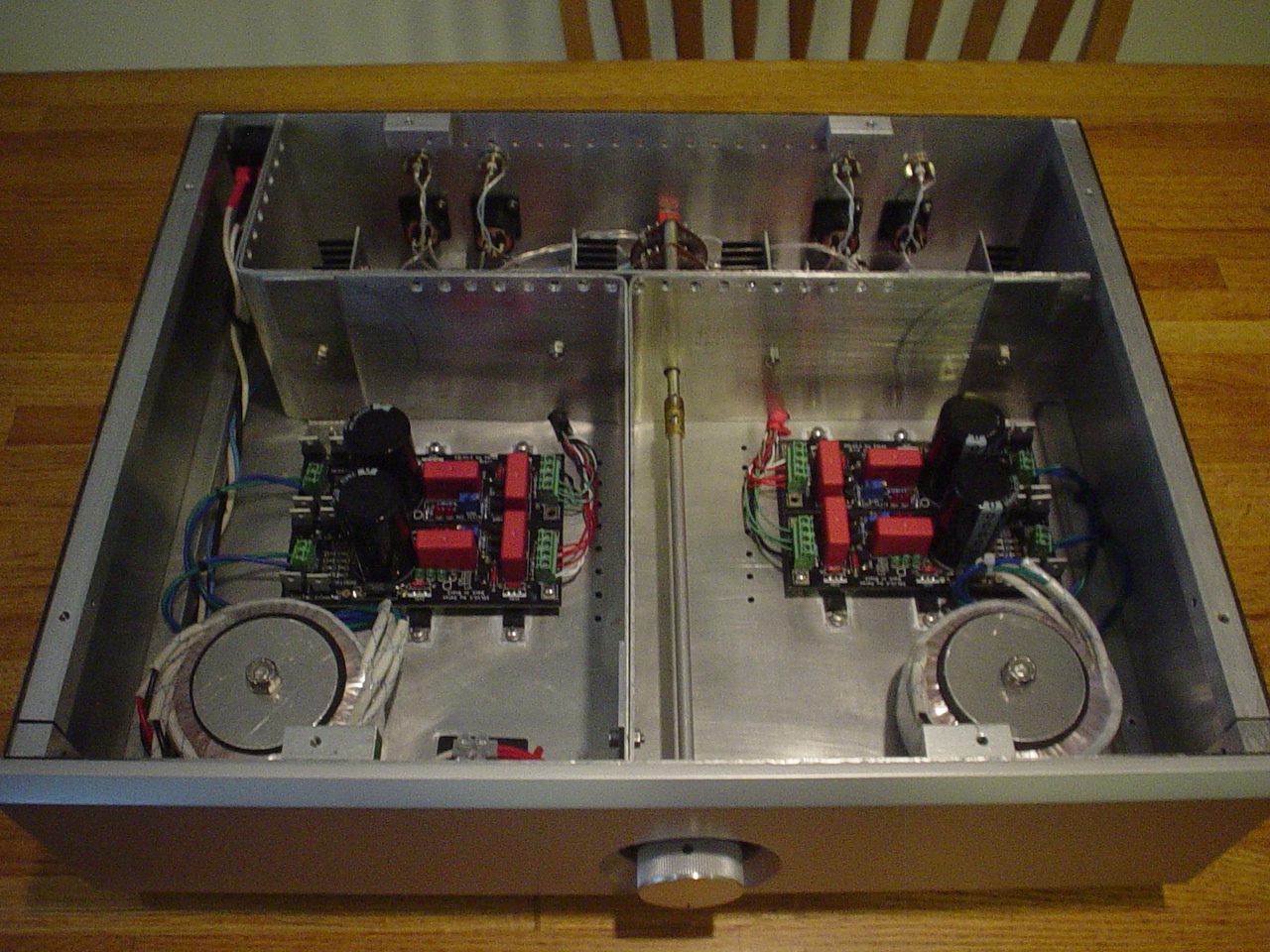

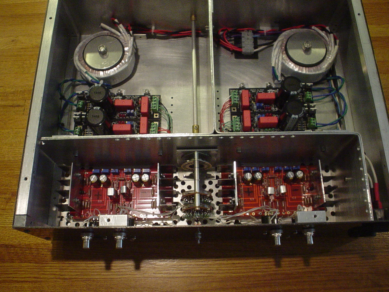

BA3 Balanced Pre
Some highlights:
Dual mono everything separate except the AC power
Salas BIIB regulators
Series/ shunt attenuator with shunt deck in between + and - phases of each channel inputs of board.
SE is selected by switch that grounds - phase of each channel. You may observe that I do not have a series resistor wired to the - phase since I am using it in SE input mode as of now.
There is no output capacitor since I am using a Jensen JT11P1 input capacitor at the power amp.
I thought that my Dave Slagle based AVC was very good but this is better in every respect.
Thank you to all who have helped and especially to "The One and Only".

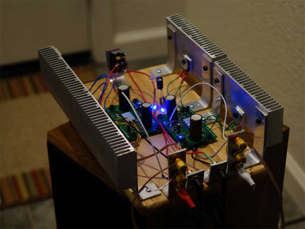

Amp Camp Amp
I roughed it out on a cutting board just to hold things in place so I could hear what it sounds like and the look kind of grew on me. The sound is really amazing and I'm a tube amp guy but really just like building anything.
Now I just have to rearrange a room so I can fit speakers and it and work on the next project... F6..?
As a followup note for any considering the amp camp amp: My concern when building it was if the end quality would be worth the expense of buying the full kit, to me it definitely would have been. Buying the full kit not only saves from the 'woops, I forgot a part now I get to wait and pay more shipping' but also would end up with a really high quality looking amp.
